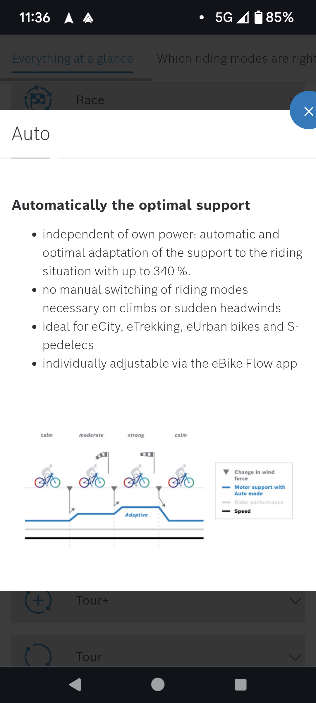

That is correct, Auto provides support up to the same level as Turbo.
Thanks... so before this update I had .... Eco, Tour+, emtb and Turbo. Would a more balanced set of 4 be...
Eco, Auto, emtb and Turbo?

Depends on how you currently use the bike. If you use eco I would keep it.. Definitely more balanced with Auto replacing tour+ as they are both variable modes depending on rider input

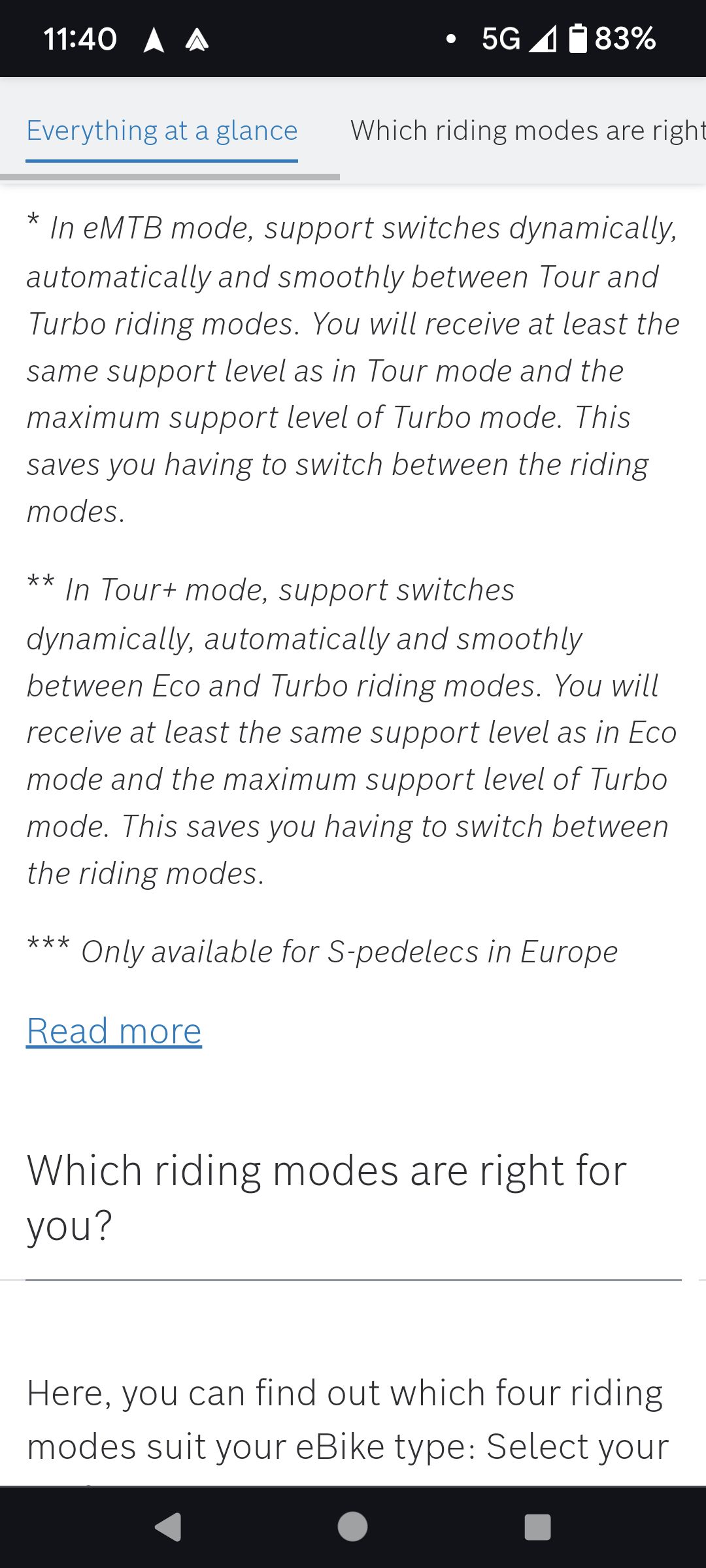

I’ve found the following to be great
- Tour+
- Auto
- EMTB
- Turbo
Can tune Tour+ up or down to reduce the assistance / increase if needed. It’s like a mini EMTB mode, same characteristics- so you get a bit of extended boost etc, where as Eco is just slow and weak everywhere 😂
Auto is great for long boring climbs and fire roads.
EMTB for going down trails. Turbo for when you want to embarrass Shimano owners.

I just Googled 'Bosch ebike auto' and looked for the latest article;
The Tour+ modes looks better (IMO);
