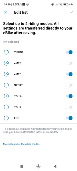

Could you select all modes like Sport? Wich bike?
Whyte E-160 29er
yea under customize riding modes, at the bottom theres an edit button for me.

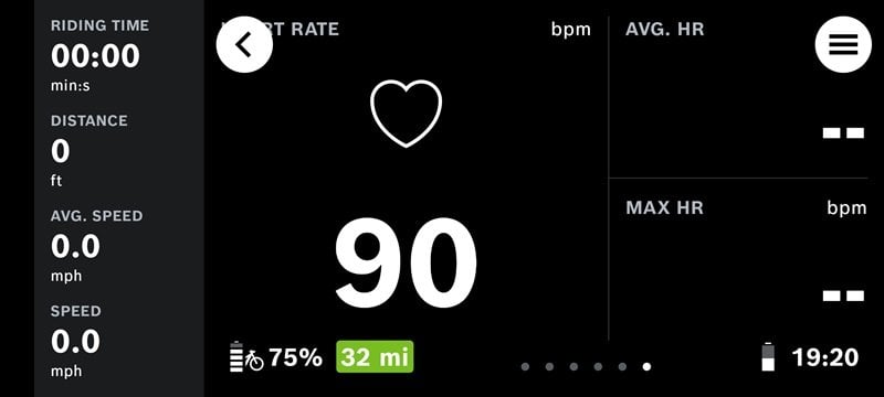

Tasty update added my watch easily under components whilst it was in hr broadcast mode.
Screenshot_2024-02-14-19-19-35-969_com.bosch.ebike.onebikeapp.jpg Screenshot_2024-02-14-19-20-05-914_com.bosch.ebike.onebikeapp.jpg Screenshot_2024-02-14-19-20-47-227_com.bosch.ebike.onebikeapp.jpg
How come I have 2x EMTB mode though? one is pre tuned for the bike by Whyte or what?

I had heart rate showing on my Kiox 300 display when riding... all good but when I look at ride analysis I can't see any heart rate data. Did I need to do anything to make sure it was recorded, not just visible when actually riding. Btw, I created a ride screen which had Speed, Cadence and heart rate.

Some more info from EBIKE24 Blog that might be useful. I seem to have found the answer to my question regarding not being able to see post ride heart rate data.
EBIKE24 say " As welcome as this innovation is, the fact that the values are only displayed while you are riding is disappointing. Neither the displays nor the app save them in the tour recording. Unfortunately, you can’t see afterwards how much physical exertion you were under at what point during the ride."
Thats a shame

Quick question: I have two versions of eMTB both have same icons and wording, how do you know the one is for shorter cranks? I run 155mm so keen to select the short crank version. Thx
Do you have an Android phone? It seems this is a bug of the Flow app under Android. The iPhone app will show two different eMTB modes.
