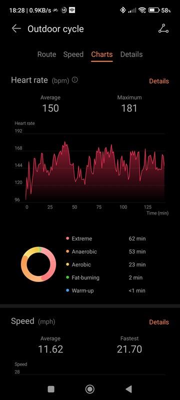

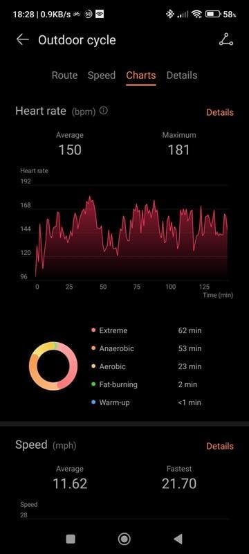

still nice to see an ebike does give a workout, heres the first ride I did since buying a smart watch
