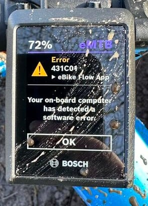

My Mondi Crafty got the extra mode options though after reading the Bosch site descriptions I stuck with those it came with, tweaked to my preferences.
Seems for some unknown reason mine didnt fully update YET says its on latest update so can't delete or try updating the bike again. Spoke with shop and they updated bike they had and again like you and my mate they didnt get an error code warning and did get the extra power modes I should have gotten. I'm not that bothered about extra power modes BUT I am worried my zero miles brand new bike gave an error code during this update. Bike shop told me just to wait until the next flow app update comes out and hopefully that will add the missing power modes. As for the error code, that came up but didnt after switching the bike back on, I won't know IF my bikes motor or electronics has a problem until I can get out to ride, which hopefully will be next month.

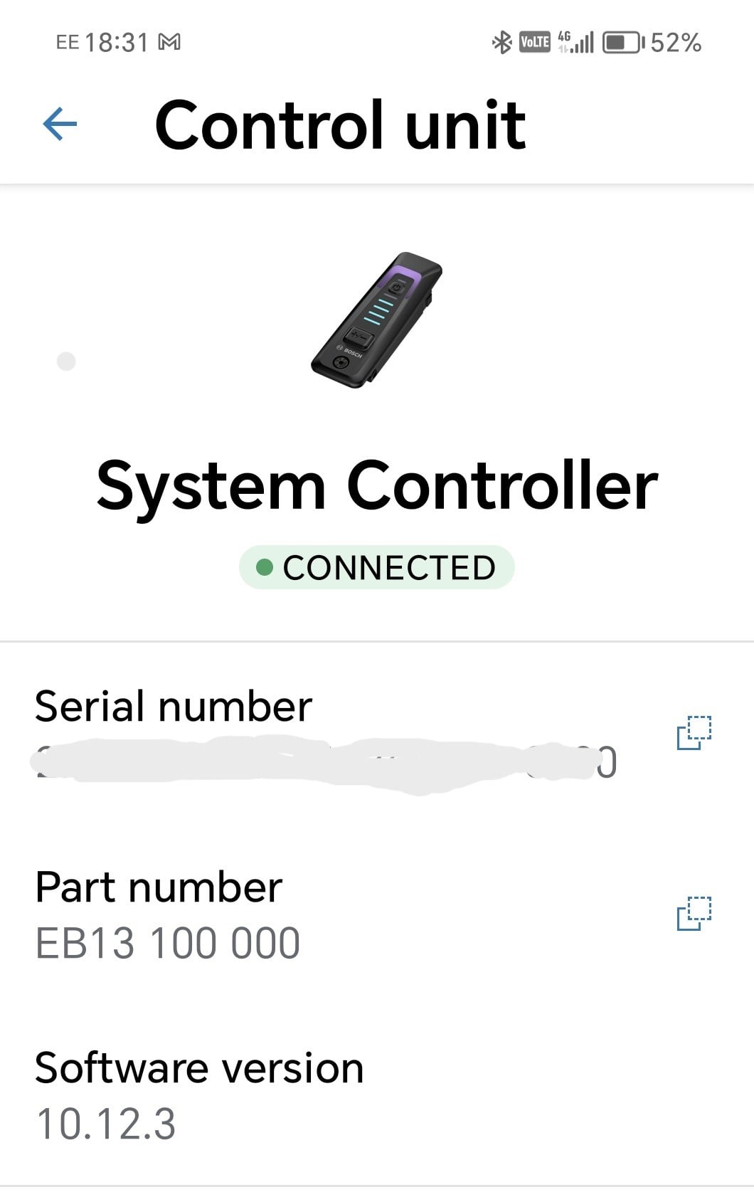

Can I see what firmware version I’m on using the flow app.
If you look for and select your controller until your bike has in the flow app it will tell you which FW it has. This is mine.

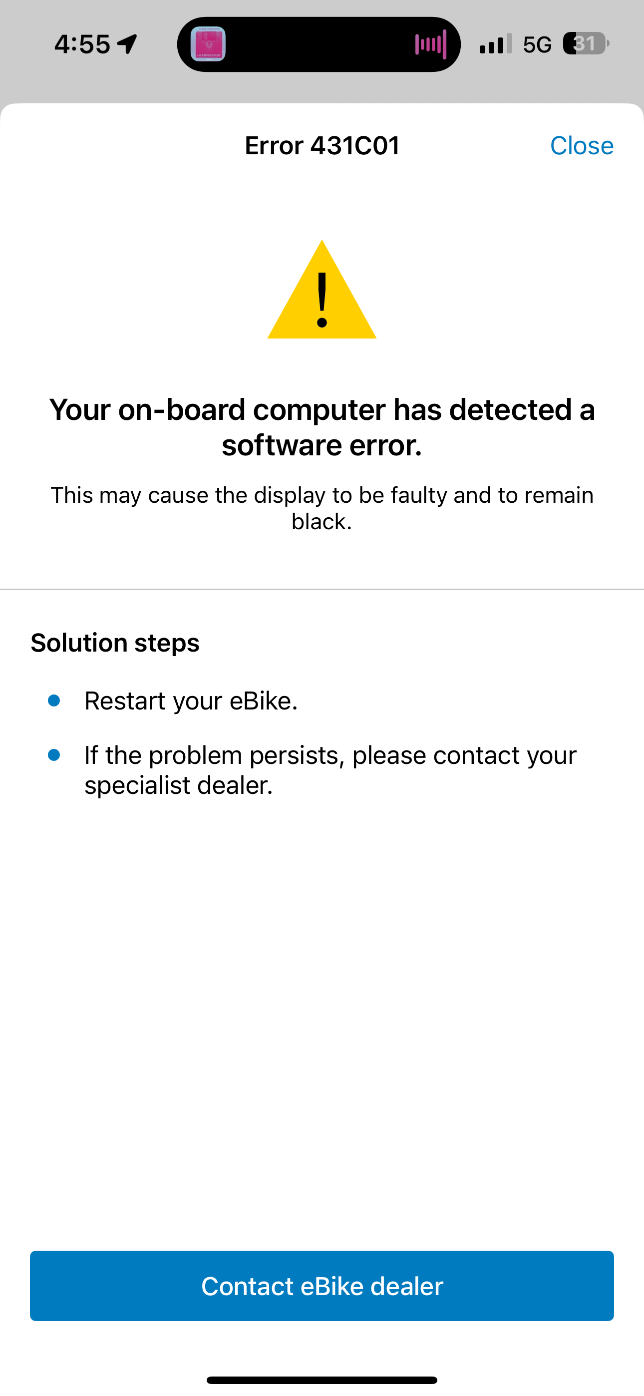

Anyone else getting the error code '420003'? I've been getting it once a ride since the last major update - I think it's something to do with my HR monitor.
OleP
Dec 3, 2020
16
7
Roskilde, Denmark
Yes, it is a known update bug and has also been seen by me who does not have a heart monitor. Just acknowledge the error and continue.
According to other forums it should be fixed in a future update.

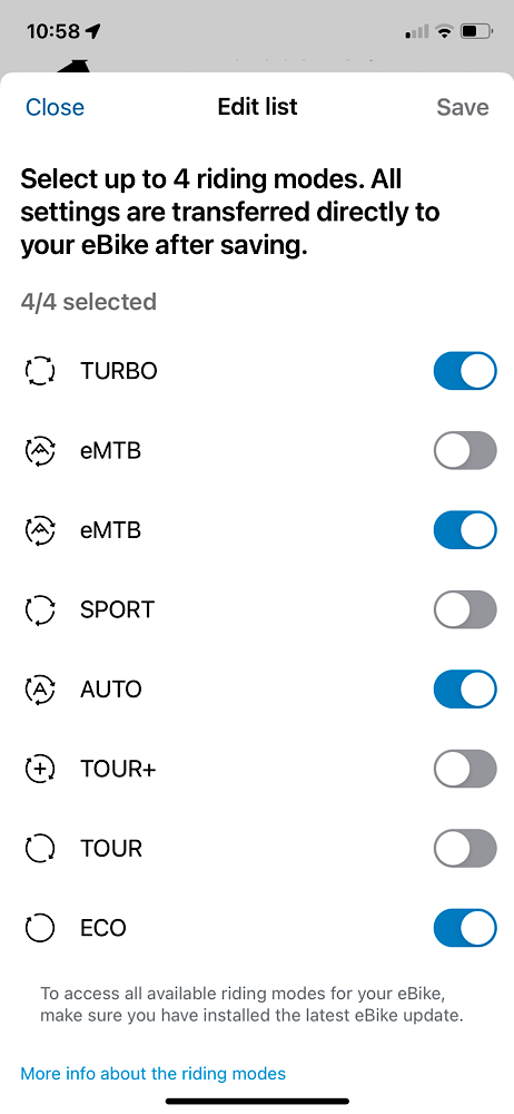

Hello.
I´m in a Cube TM 2023 and made the upgrade. Regarding the modes I have now two emtb modes visible in the APP (neither one with mention to shortcranks) . Also no Auto mode.
Well, I tought could be a nice option if we could have 2 emtb modes with diferente parameters, but no (good sugestion to Bosch if someone could reach them) .
I have selected the 2 at same time , and bike system acept it, but wen I change parameters in the APP in one off them , both modes are afeted/replicated the same.
Anyone experienced the same? Is this only on Cube or any other experience the same?

I have a Cube 2023 Actionteam - I have the following modes available. Its a CX Smart System.
This is a known bug in the Android version of the Flow App. Bosch has promised a fix for the next update.
One is the regular eMTB mode, the other is the short crank version. The order is different on different bikes, therefore you don’t know which is which.
You can identify with is the original, acording to Km/milage donne in each mode.
