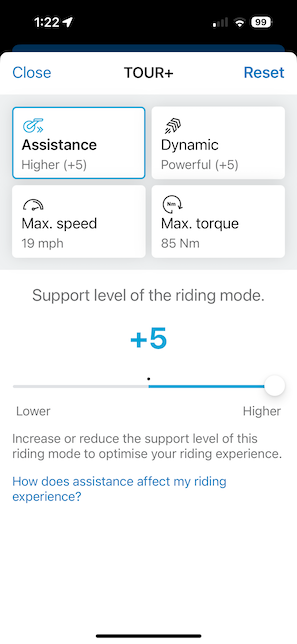

Interesting. Can you tell me where I can find this data while using the app?
My app tells me that the maximum assistance in my four chosen modes (ECO, TOUR+, EMTBsc, TURBO) is 340%. All I have to compare the four is the "Range Estimation." If I bump up Turbo, my expected range does not change. That supports your claim that TURBO is maxed out in its default setting.
If I bump up TOUR+ to maximum ASSISTANCE and maximum DYNAMIC, then it should be churning out 340% assistance, according to what the app tells me elsewhere. I would expect to see the same estimated range as TURBO. But I don't. See the attached screen shots.
If you can show me where I can see the explicit numbers for each mode and slider, I'd appreciate it. Thx.
This can’t be found in the app. You need to search multiple pages on the Bosch website and/or have historic data from earlier versions of that site. Bosch once had very detailed information about motor performance and how much support each mode would deliver. Recently this changed to a more marketing focused design and many details got lost.
The best overview for riding modes can be found while starting on the following Bosch page, clicking on ‚Everything at a glance‘ and then opening each detail page for the individual modes. There you can find the maximum support for the mode. Riding modes: individually adapted to you - Bosch eBike Systems
TOUR+ will always support with a maximum of 340%. It’s a dynamic mode that reacts to rider input power. With low input from you it will support with an added 60%, with very high input it will automatically reach 340% support.

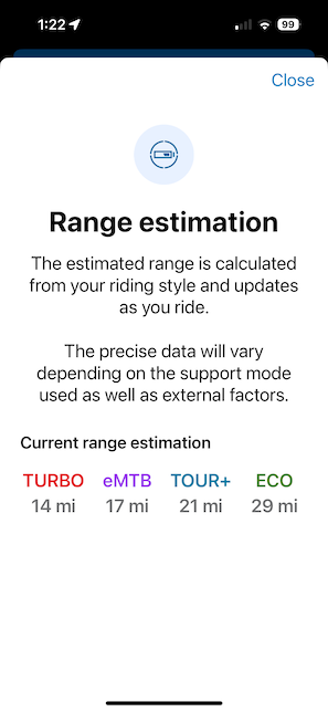

Not possible. TURBO will always give you 340% on top of your input. TOUR+ can go down as low as 60% and will use less energy than TURBO.

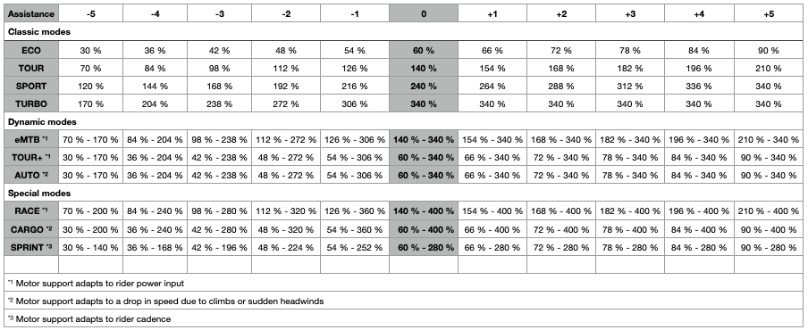

Here is an example for ECO mode: Factory support is 60%. A setting of +3 will calculate 60% plus (30% of 60%) resulting in 78% after modification. -5 will calculate 60% minus (50% of 60%) resulting in 30% after modification. Each number in the range is one 10% step. This principle is true for all modes with the added limit of 340% as upper ceiling.
There was a very similar discussion on a German e-bike forum where one user put all known facts into one table. I used that table, updated it with some Bosch data I had stored locally and added some missing modes. Here you go
P.S. I’m not 100% sure that CARGO and SPRINT have a starting point at 60%. If Bosch followed its own logic this should be right - but who knows!
RustyIron
Jun 5, 2021
1,904
2,993
La Habra, California
I’m sure it does not tell you 340%.
Clearly, we have a failure in communication. The app provides descriptions for each mode, and you're sure it doesn't. I see no place to go from here.
Thanks. I was hoping for some published data from Bosch. A table made up by a German guy, where you added in some numbers that you think you know, and then adding in some more made up data isn't what I looking for. Phoney data plugged into a pretty chart is still phony data. Work like that will get you kicked out of the university.

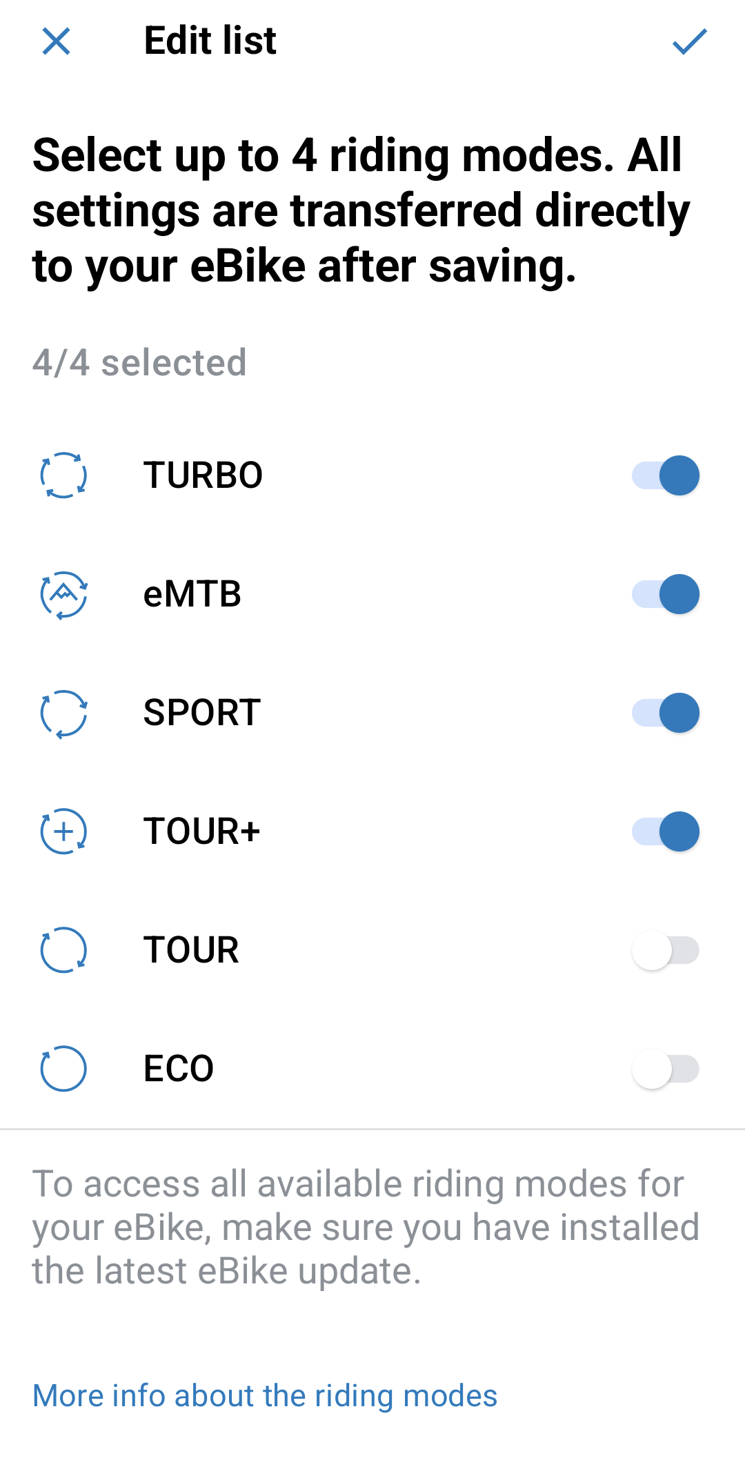

Hi, getting back to the problem of the two eMTB programs appearing, disappearing, reappearing, but still not being distinguishable by name, I have discovered a few things, which may be helpful.
By deselecting in the Flow App the eMTB program currently "installed" on the bike and choosing 4 other programs, when you return to the choice menu, both eMTB programs reappear.
Selecting both, you should notice a difference in the calculation of the remaining range.
The "Standard" one shows a longer range (1-2 km or so depending on the state of charge of the batteries; mine was at 55%), while the one for short cranks shows, on the contrary, a shorter range.
How do I know? I asked my dealer, who through the computer was able to verify which program was actually installed. And, in my case of a TREK Powerfl 7 Gen. 4, the short crank program indicated exactly 1 km less range.
The dealer confirmed to me that for my TREK, with 165 mm cranks, the eMTB program for short cranks is indicated. He then confirmed to me that this program is designed for cranks of 165 mm or less, while the other for longer cranks.
I mean, between one program and another, not much changes. But since I was there for other work, I took the opportunity to do the test.
Great to know, thanks for sharing.
Is this on Flow app for Android or for iOS?

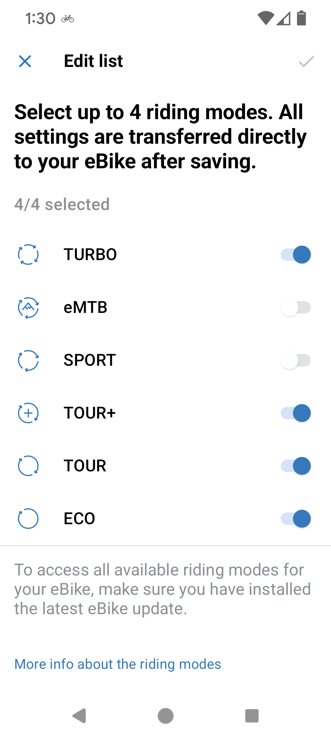

Sincerely.
I tried this but after deselection I didn't see 2 EMTB modes , only one.
I selected it and it appears that this single option was the original EMTB mode that I have accumulated the most kms on. The other EMTB mode that I had switched to after the previous update is now not available in the app.
If my Mondraker that came with 165mm cranks was set up the same as your Trek , then I am now back on short crank mode. 👍
This is on the android version.
