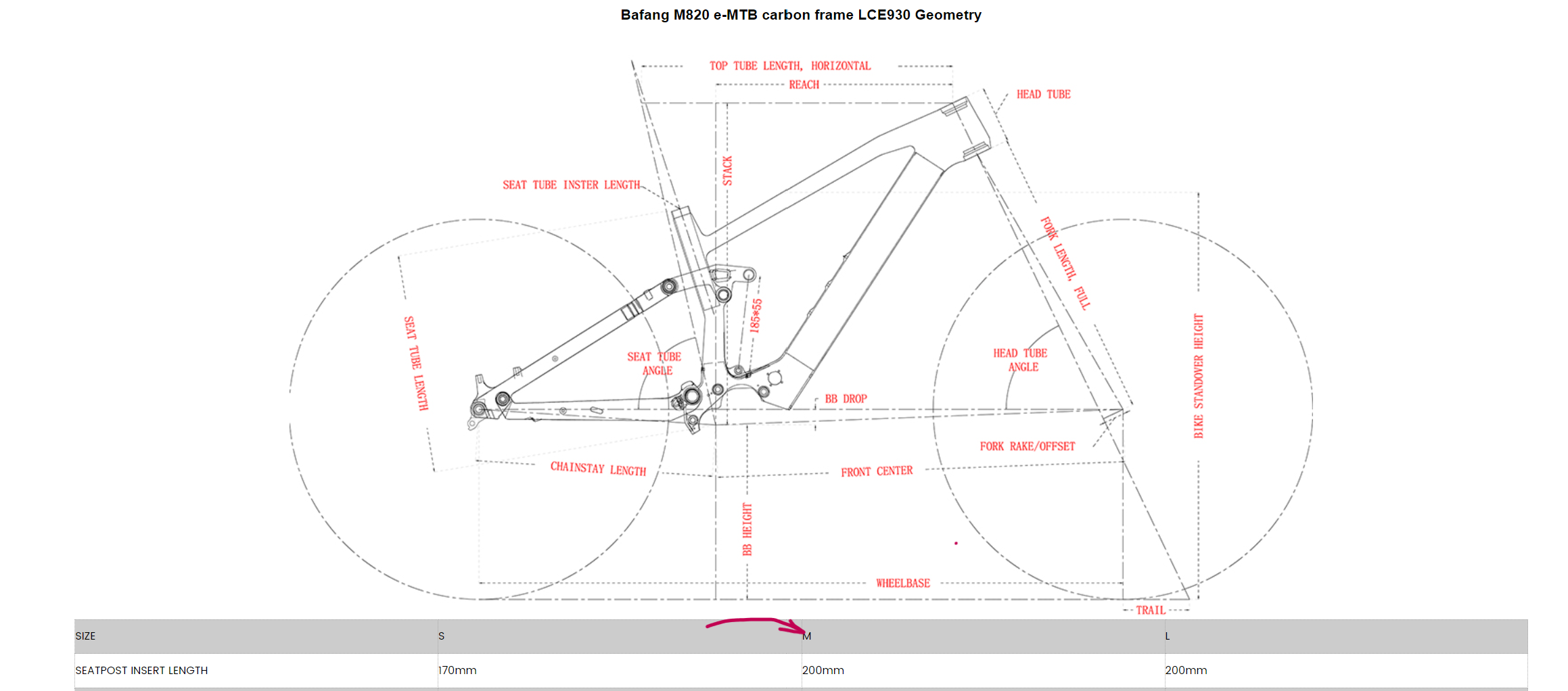

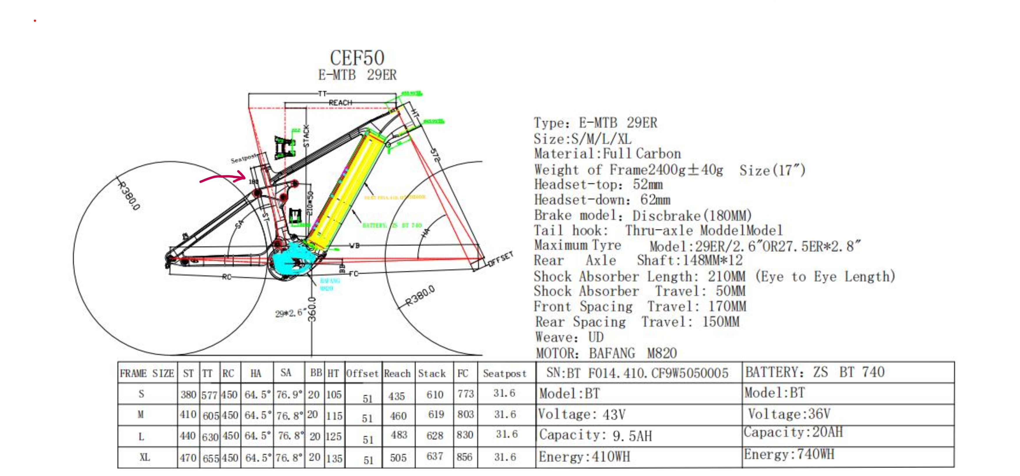

@spokemon @thaeber @LAnton
Hi guys... Go to the manufacturer's website, click on geometry and look at the seat tube insertion length... I'll copy them for you to make it easier. Best regards
