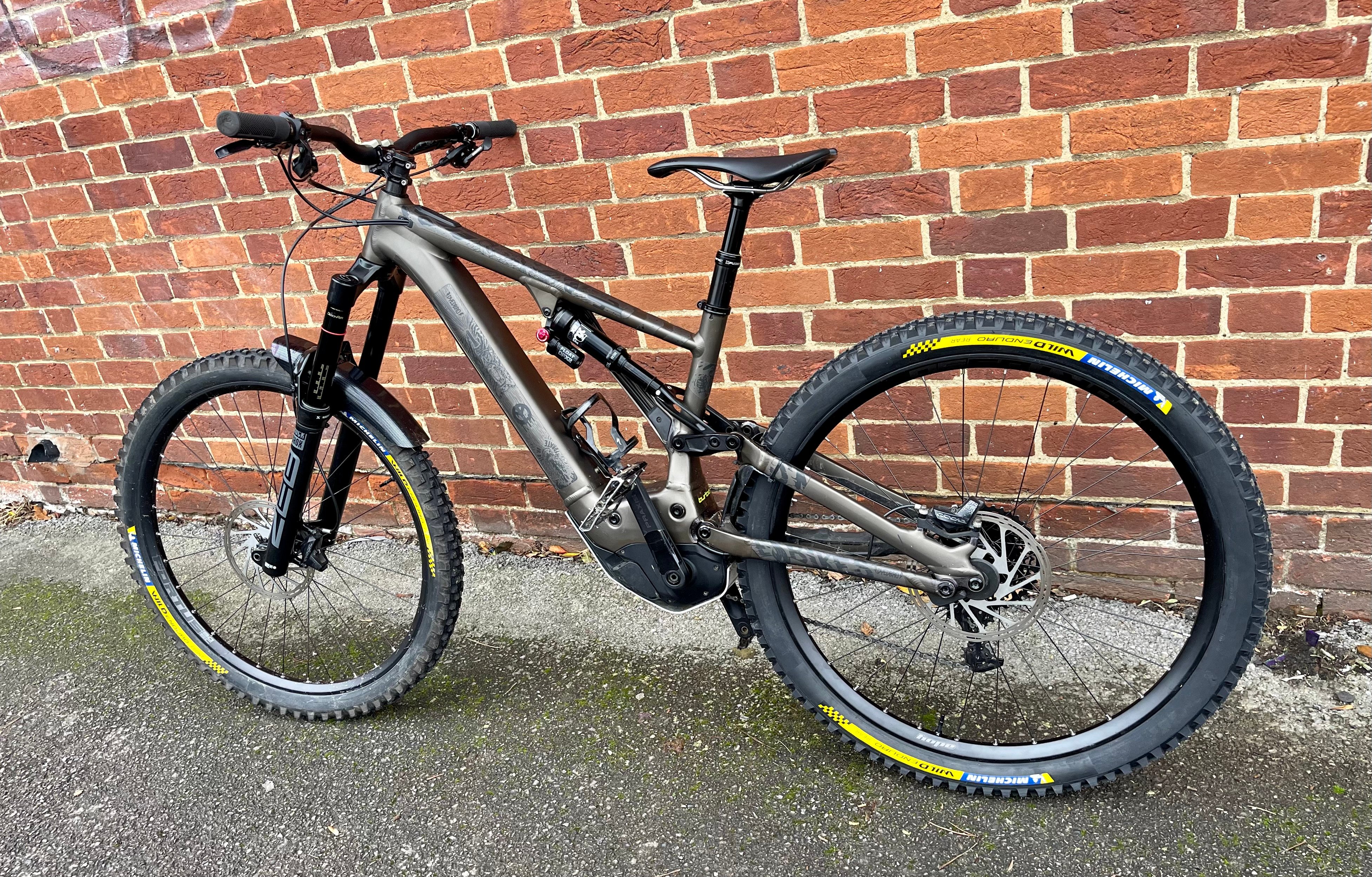

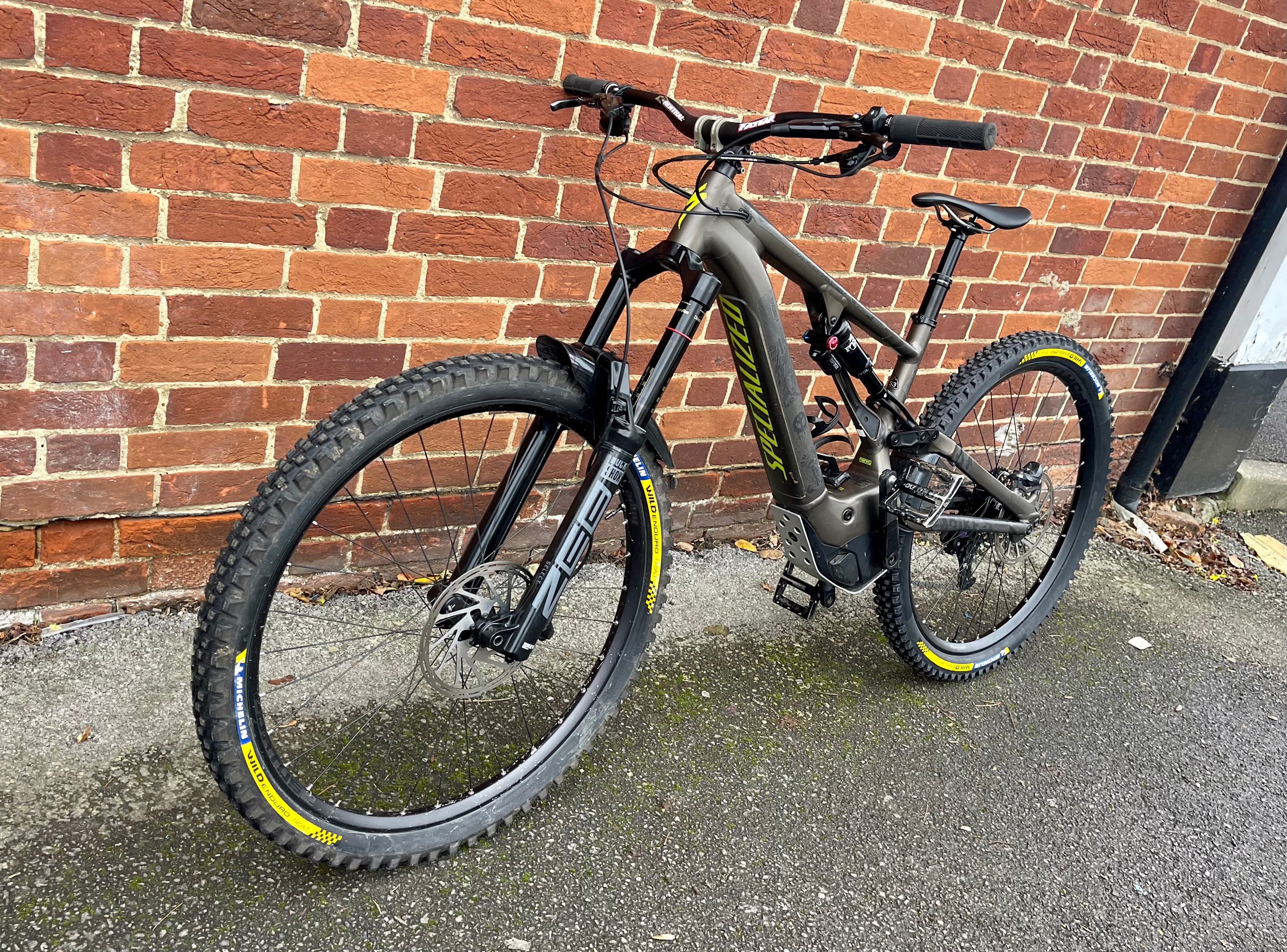

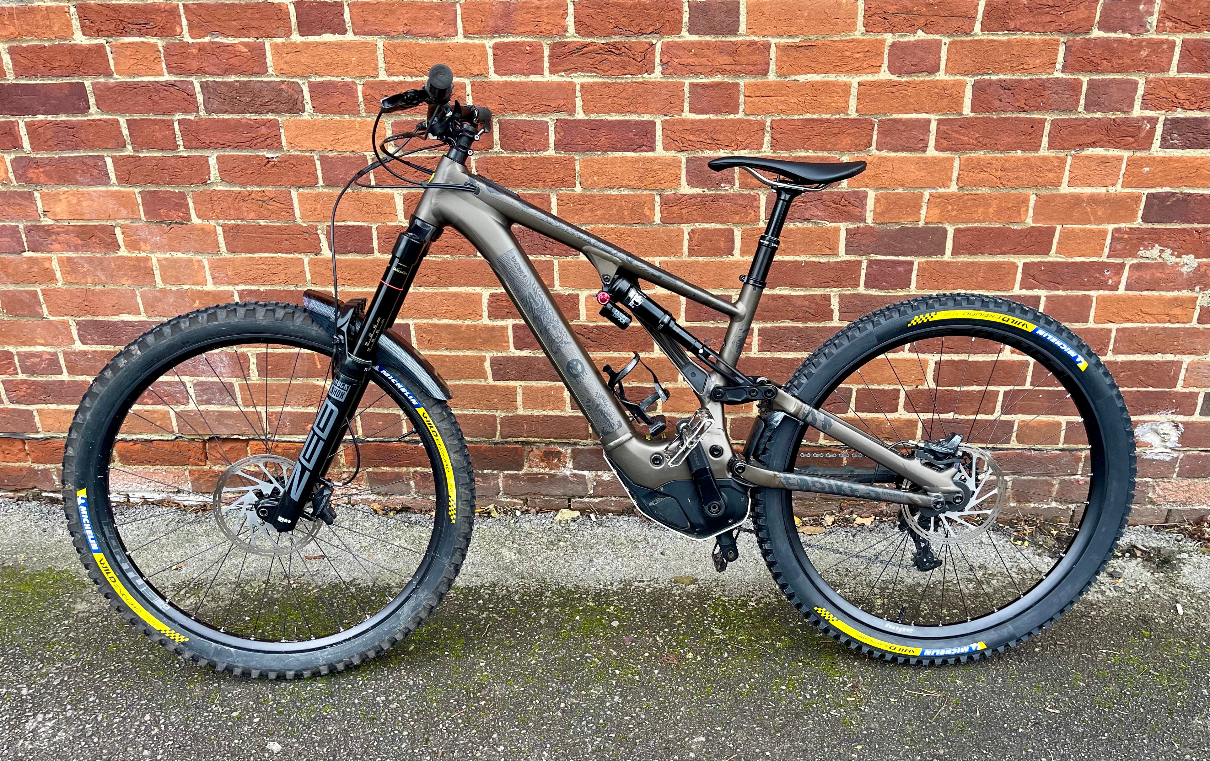

Here’s my 2020 but now use a super deluxe select+ ;

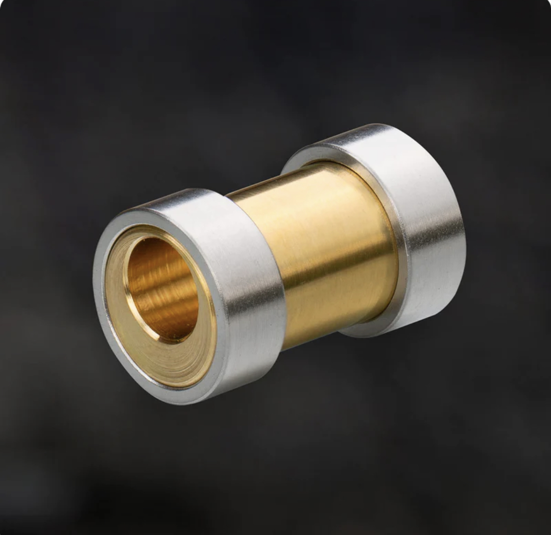

This is what the offset bushing looks like, it goes in the top shock mount eyelet.
Average adjustment - single Offset Bushing (x2 for a pair)
Note: clearance required around eyelet will match the offset amount
  • 6mm bolt - 3mm offset, ~ 0.75° head angle adjustment.
  • 8mm bolt - 2mm offset , ~ 0.5° head angle adjustment.
  • 10mm bolt - 1mm offset, ~ 0.25° head angle adjustment..

Would these help steepen the HA after a mullet conversion?
