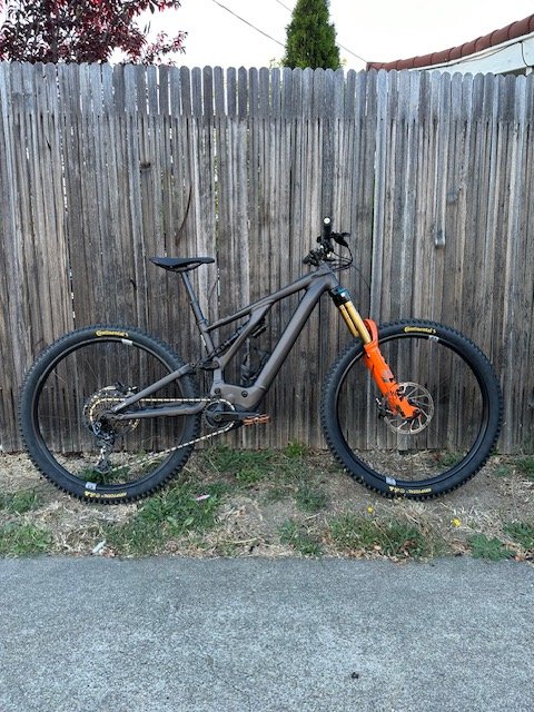

New to the e-bike world but not to mountain biking. Thanks to everyone on this thread I was able to decide the bike and upgrades!! It'll be a slow upgrade process but here she sits....
2023 Kenevo Expert 29er F/R
Fox 38
Crank Brothers Wheels
Conti Kryptotal Tires
Deity Tmac pedals
Renthal Stem/Bars
This bike rips!!
