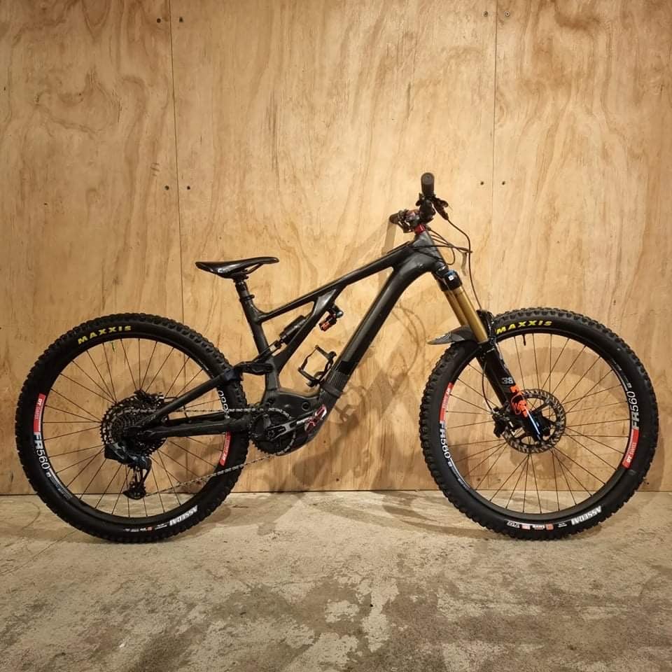

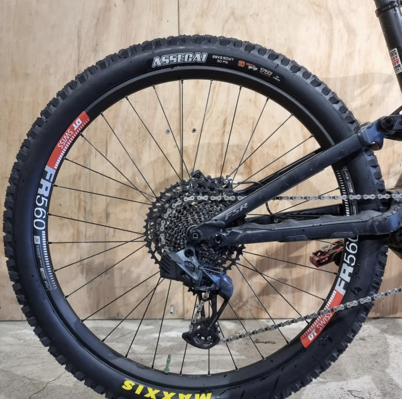

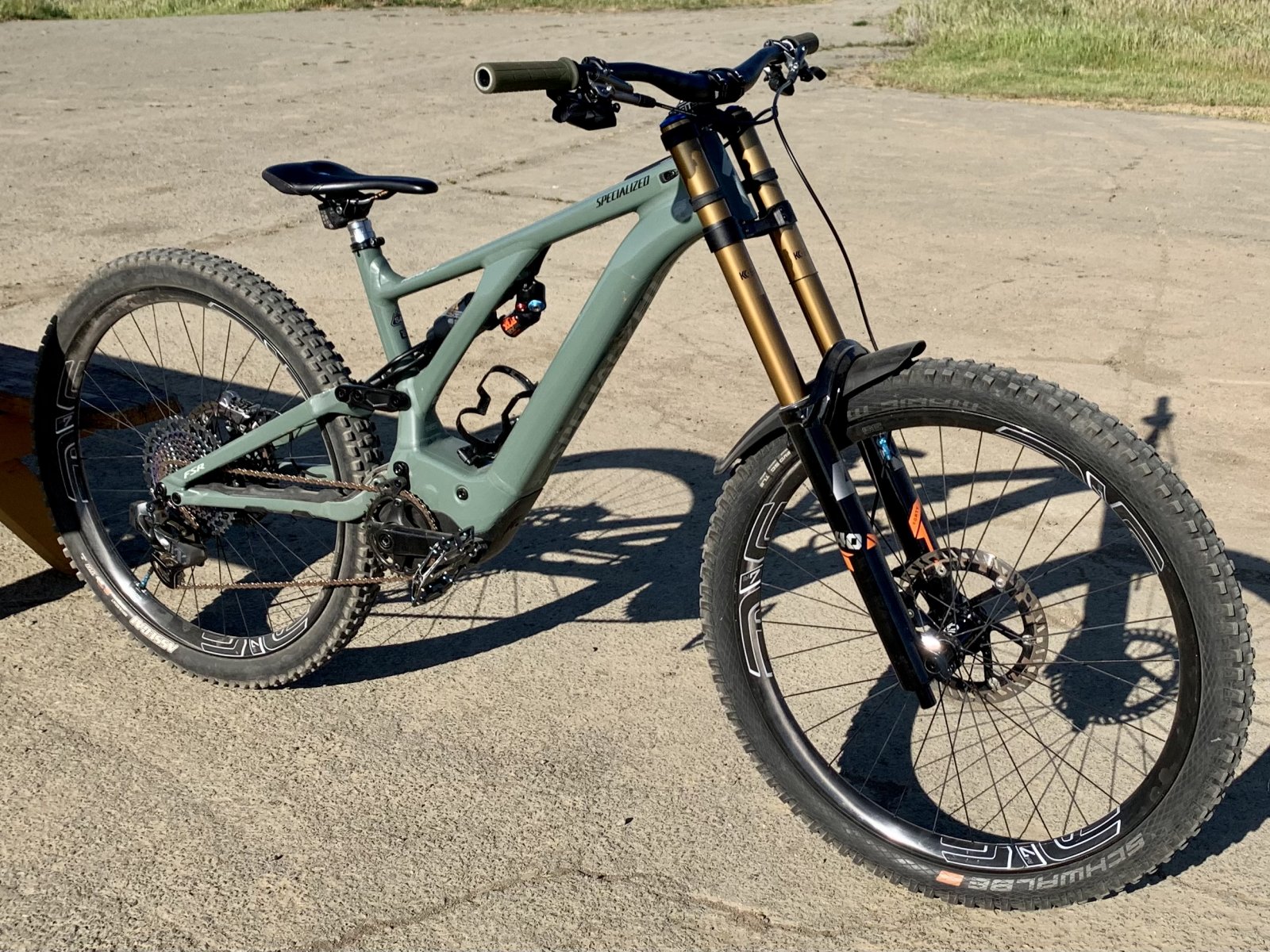

To answer the questions, yes you can put 29 wheels in the rear without issue
Untitled by Sales Punk, on Flickr
To balance out the bike the fork is a 29/170 setup
To answer the next question, the BB height is not a hinderance at all. Mine measures out at 361 or about 7 mm higher than my Enduro. The bike is insanely fast every where. We ride a lot of very steep and raw natural trails along with some big jump lines and the bike absolutely slays. Getting to those trails is done via steep technical singletrack climbs with lots of tight switchbacks. Again, no issues with the 29 wheels. Happy to answer any specific questions about the changes.

Yeah, that clearance'd be a joke for a UK winter (more of a black comedy really).
mud clearance is a big issue with a lot of US bikes sold here. EVIL being among the most retarded I've ever encountered
I don't ever run larger than a 2.4 rear tyre.
Thanks for posting pics. Although this time of year I'm kinda jealous of all that magic brown powder sprinkled on your chainstays. ;)

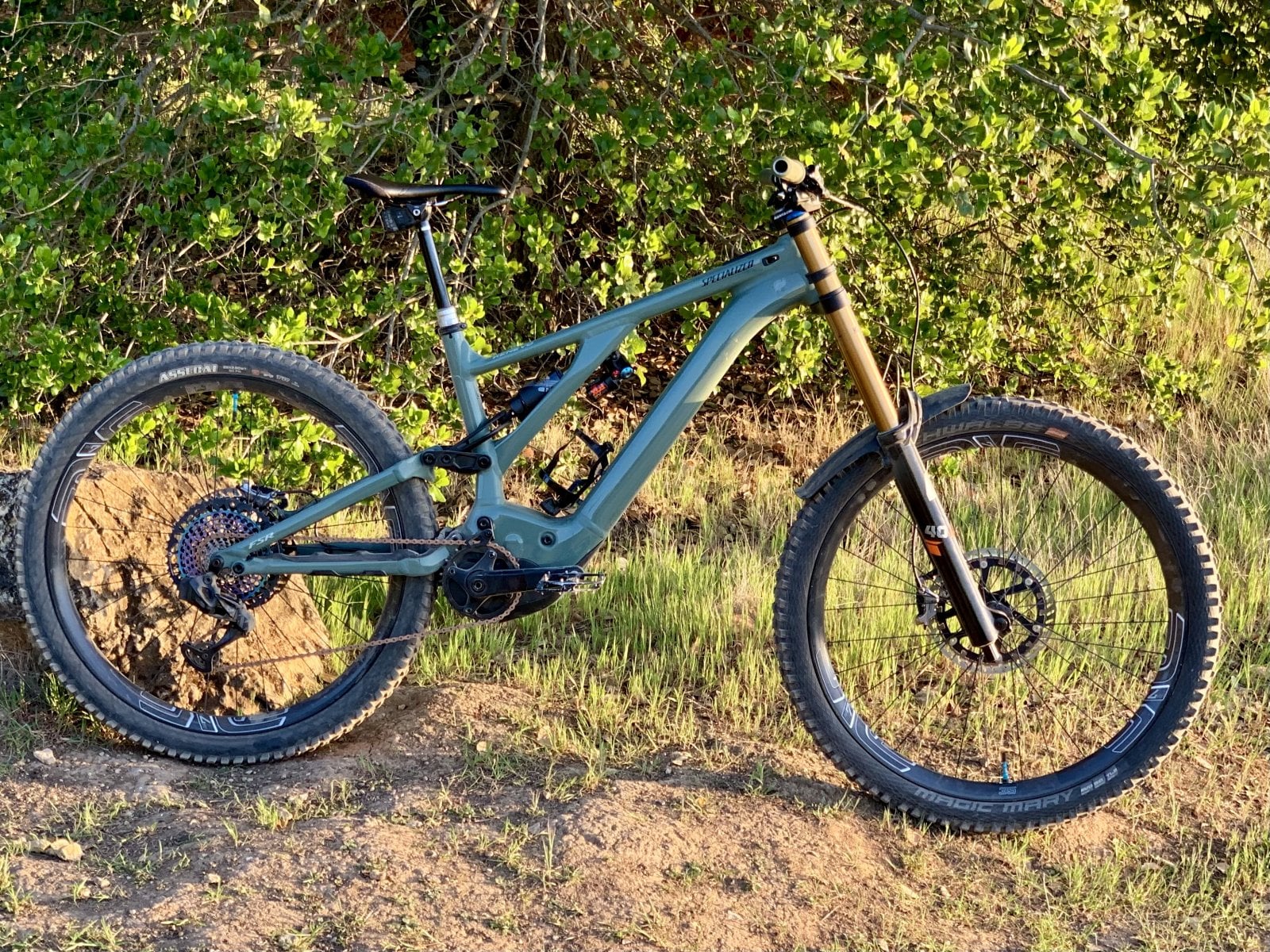

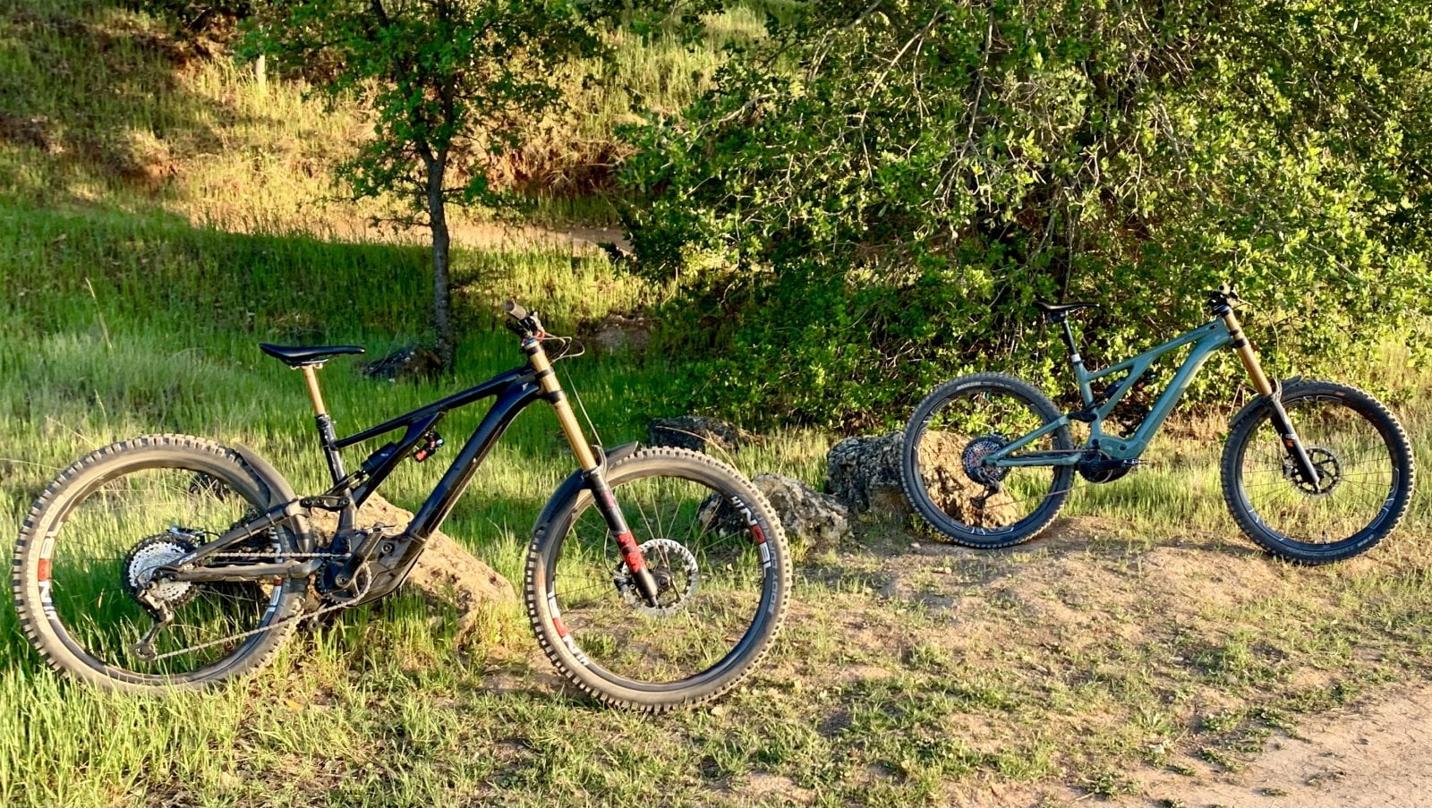

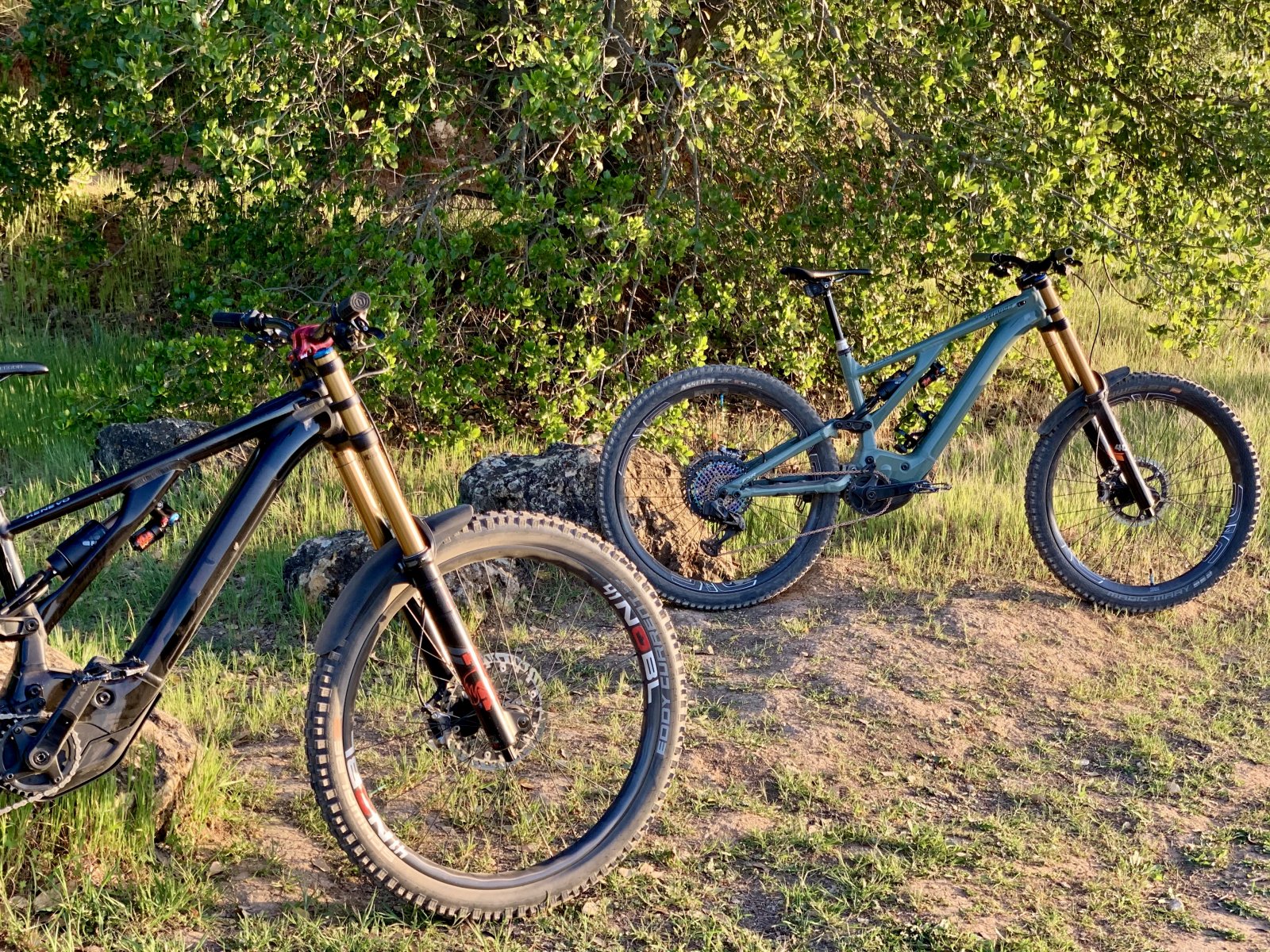

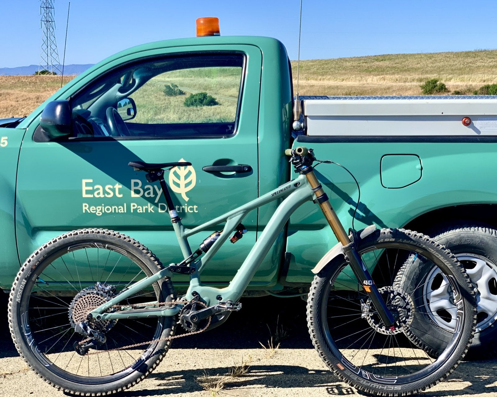

Trying out my 29er wheels and it’s fast
I think I will go away from mullet setup for now and go with 29er f/r

29er/29er with triple clamp is my favorite set up so far. I’ve tried them all. It turns better than a mullet set up. Big travel 29er is a lot of bike for my local trails but good to have for the places i take it during the weekends.
i can still turn on switchbacks. There’s 2 I can’t clear even with a single crown. So not much of a drawback.
It’s almost too stable at high speed lol. It feels like I’m going slower but actually going faster. I think i need the speed limiter removed. I find myself reaching top speed too often and needing more

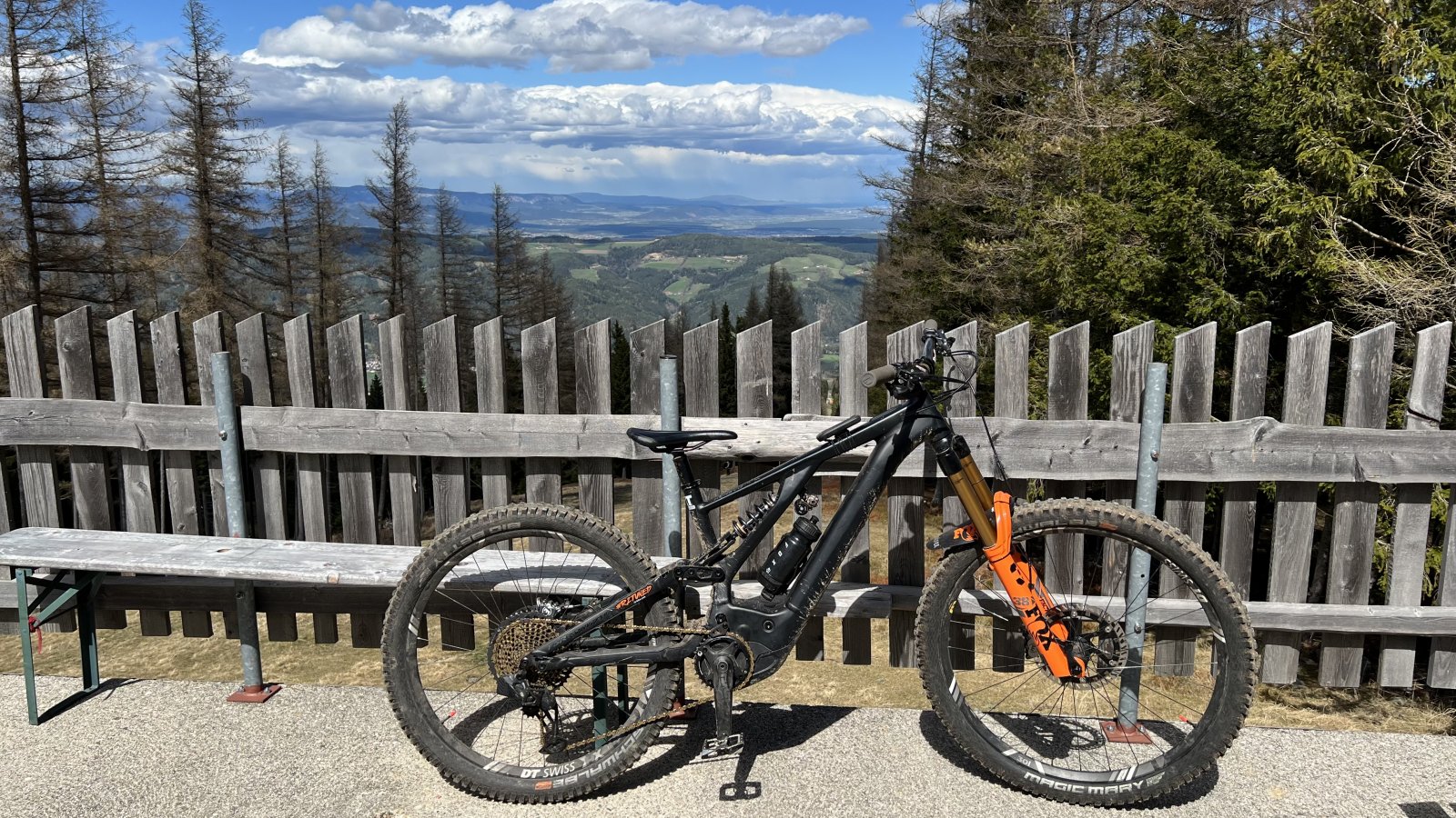

Hey guys, I am running my S3 Kenevo in Mullet (180mm f/r) now. IMO much better than stock. But I am considering now going 29 f/r as it might turn better (steeper HA).
Does a 29er fit in the rear of an S3 with a 2,5 Maxxis tire? I read somewhere that a 29er in the rear might have clearance issues with the saddle "on smaller sizes".
BTW EXT e-storia works like a charm - strongly recommend it. ;-)
No problems with a 29/2.5 maxxis. I used to run 2.6 butchers without an issue. Might be a problem in muddy condition’s picking up sticks and stones though as the clearance is close. I ran it also with a Sicomtb guard and it had around 5 to 10mm clearance. In the end I chose to run 2.3 tires as they were more than enough for what I needed.
Bike rolls much nicer on 29s
