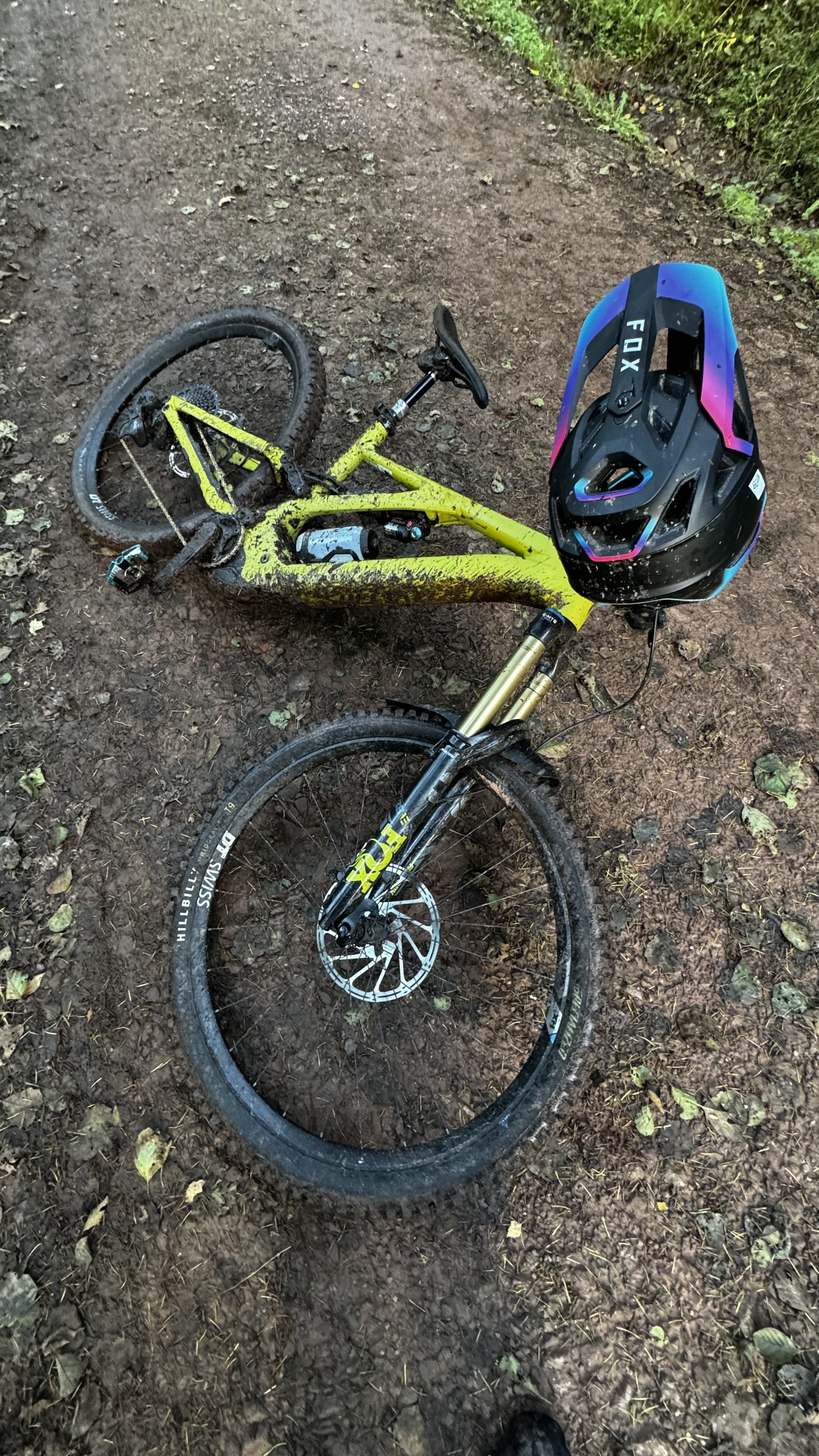

Another weekend on my 29er Kenevo. I still think if this bike was released now, in 29 or mullet that it would be ranked in the top few enduro bikes out there.
Virtually silent descending, no clunk or rattle, suspension curve thats not too progressive (many new bikes are getting too progressive IMO, more harsh ride in some situations) and the Kenevo with Air Shock works so well. I still cant beat the times on my tracks with any other bike.

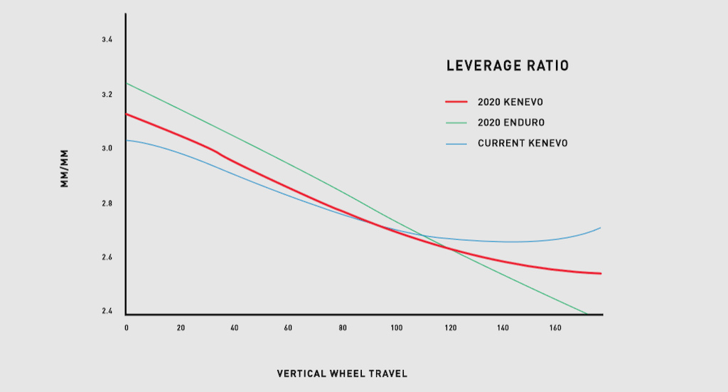

Yes I see what you mean - hopefully I can explain myself better:
The Kenevo isnā€™t that progressive, especially in the latter stages of the travel. Looking at the leverage curve from Specialized, once we hit 100mm of travel the ramp starts to flatten out a bit :
I found on a coil it was very easy to bottom out and get bogged down into this lower part of travel (100mm+ of travel) . By moving to air it helped ramp up due to the nature of an air shock.
Leverage according to that chart from Specialized is around 3.15 - 2.55, so approximately 19% progressive (so not *that* progressive compared to many)

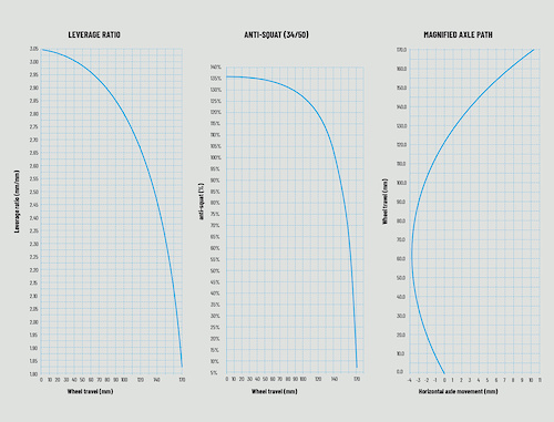

As an example, the new Propain Ekano, with 180/170 is a massive 40% progression through the travel:
This massive progression with its stock air shock meant it was really difficult to use all the travel, and felt a bit more harsh over rooty chatter compared to the Kenevo. IMO the Propain is a bit too progressive for me. I only tried that with an air shock, but Iā€™d have liked to have moved that to a coil to try out.
Itā€™s all personal preference really, there is no best, just what works for one wonā€™t be the best for all.
What I found on the Kenevo was that the air shock helped keep the rear up a bit better, as well as keeping it feeling a bit more agile vs coil (which on a long travel big bike I prefer)
But in short, Kenevo with air works best for me šŸ‘

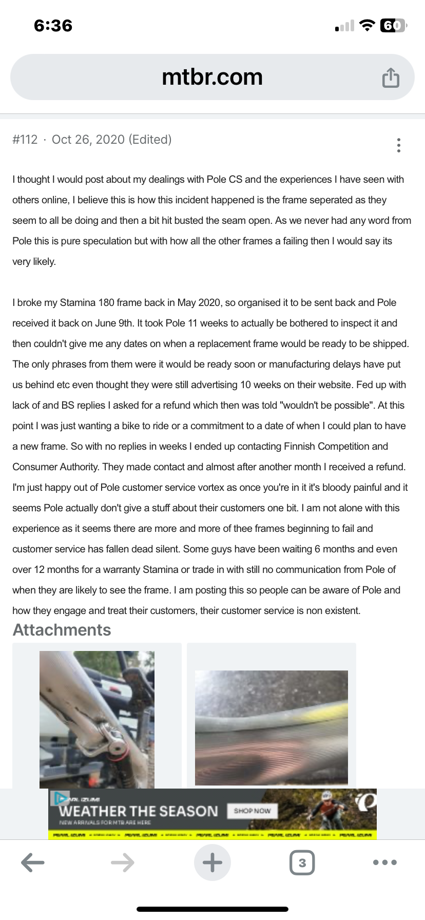

Look on mtbr, pinkbike and such, they have had some frame failures and rather than jumping on the problems, they have been less than helpful. This is according the disgruntled customers and you do not hear much from poleā€¦.. 2 sides to every disagreement you know.
I figure e bikes are a lot more complex than regular bikes so my final decision came down to picking a shop that I think will be there is there is a problem with the bike I bought from them. If My Kenevo has an issue, my lbs will deal with it or I will destroy them on line and contact the manufacturers with documentation of the shopā€™s failureā€¦ā€¦. If you work with a mail order company, you are pretty much at their mercyā€¦. Jmo
Here is an old example although I have seen some pics of cracked linkages on the new bikesā€¦.. so there are still some issues.

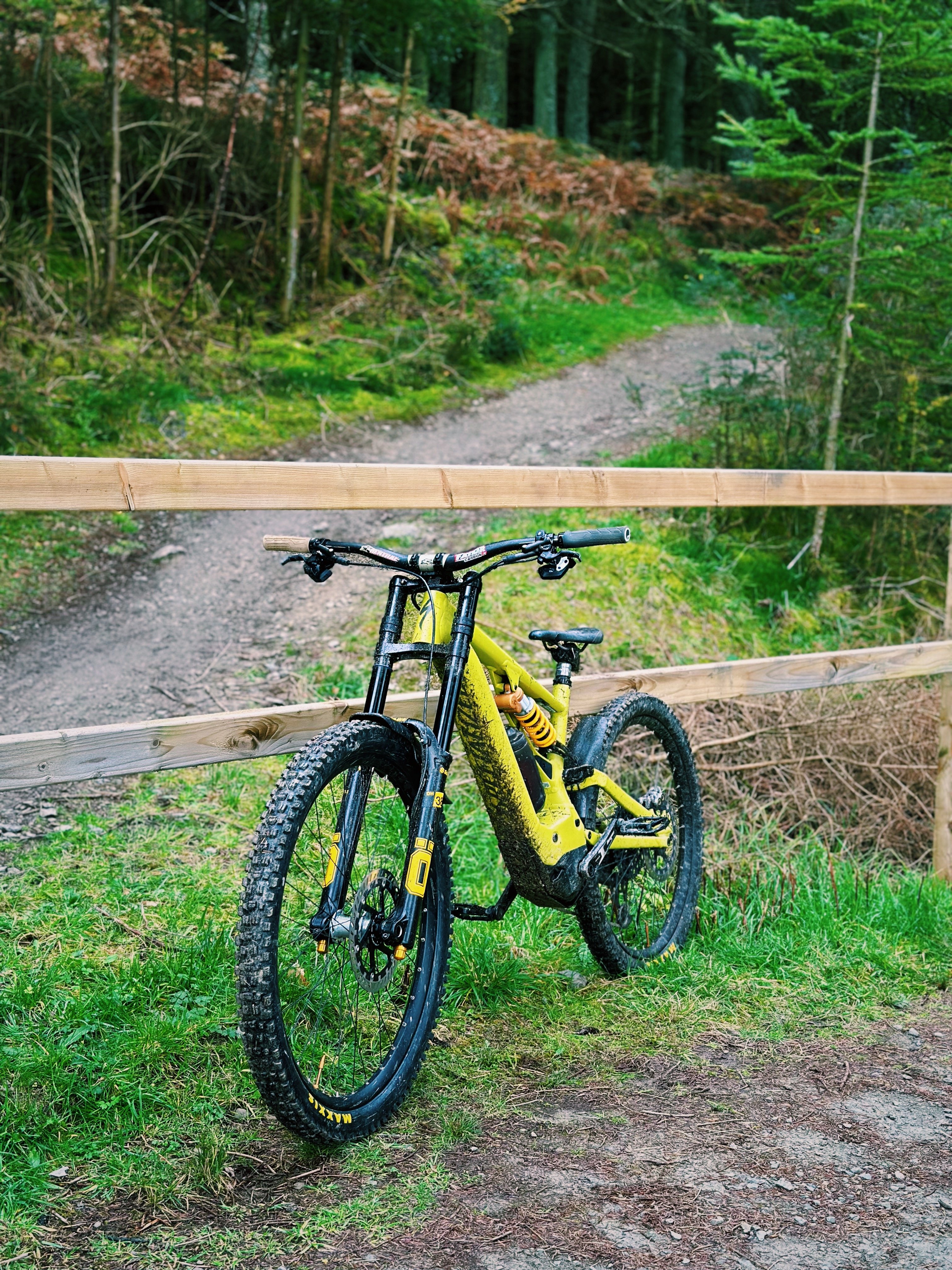

Switching my Fox 40 29er (200mm) to a Fox 38mm (180mm) soon. Even with the Fox 40, I feel the bars are too low. I have to use a 50mm riser bar. Thinking a Fox 38 with some spacers underneath stem would be more comfortable.
