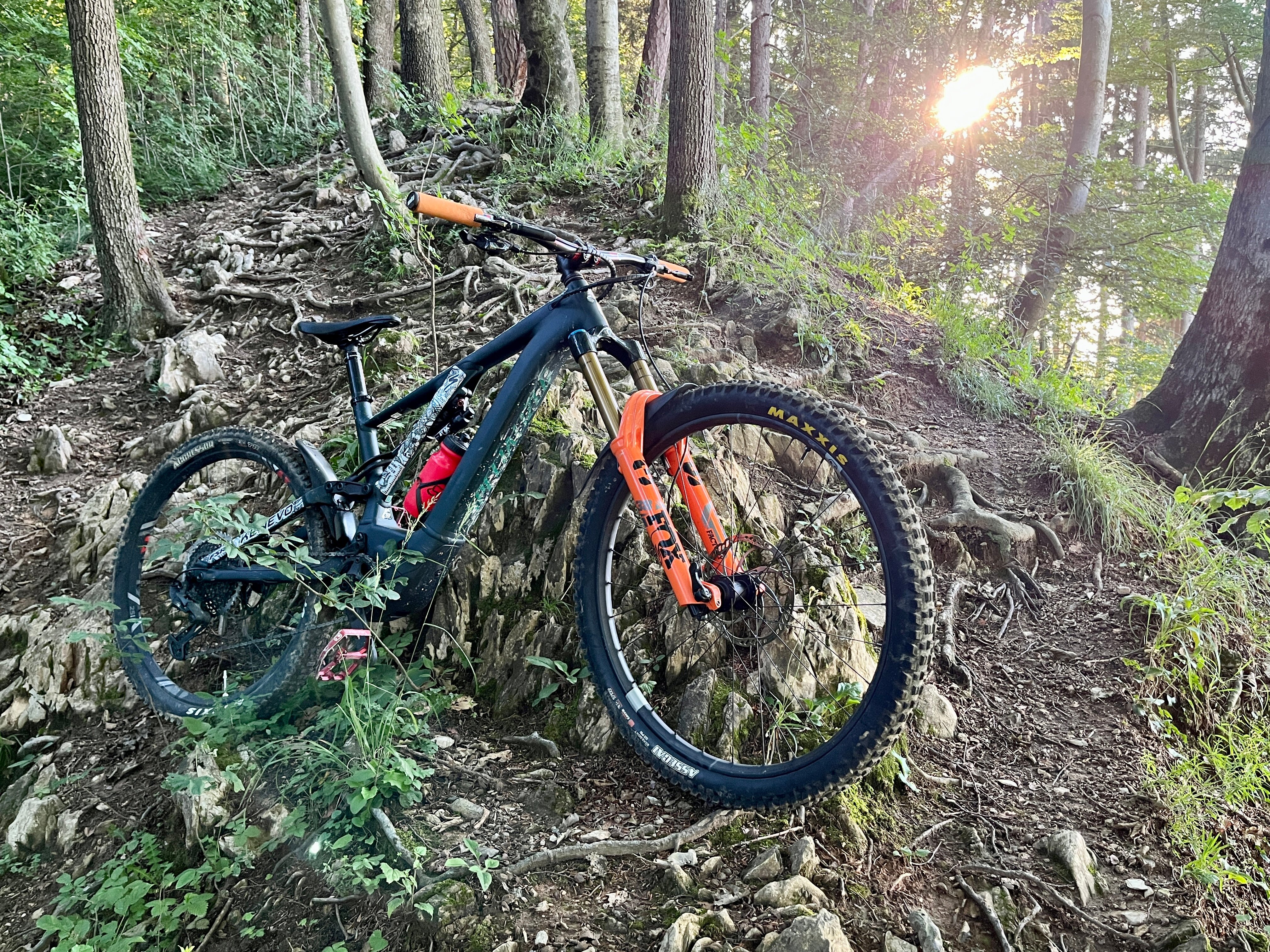

Just did this 2weeks ago; went from g2 M size levo (but very custom- f38 180, magneg 55 rear, 27,5 rear) to kenevo s3 and put the same parts on the new kenevo, which i ride in full 29 or with 27,5 rear.
Kenevo is a BEAST uphill, also on speedy downs, can do front&rear pivots on twisty and technical stuff, but much more rider input is neccesarey. Also on short berms its harder to throw it in and be spat out of the corner…
I mosty did it as M levo is 435 reach and it got too small for my growing 4yo daughter - we use shotgun pro.

I think you re good to go, crown race on my f38 that i had on levo was a direct fit for kenevo…
Maybe you need caliper monts as its pm 180 and you have 220.
do it asap, as its a BEAST ;)

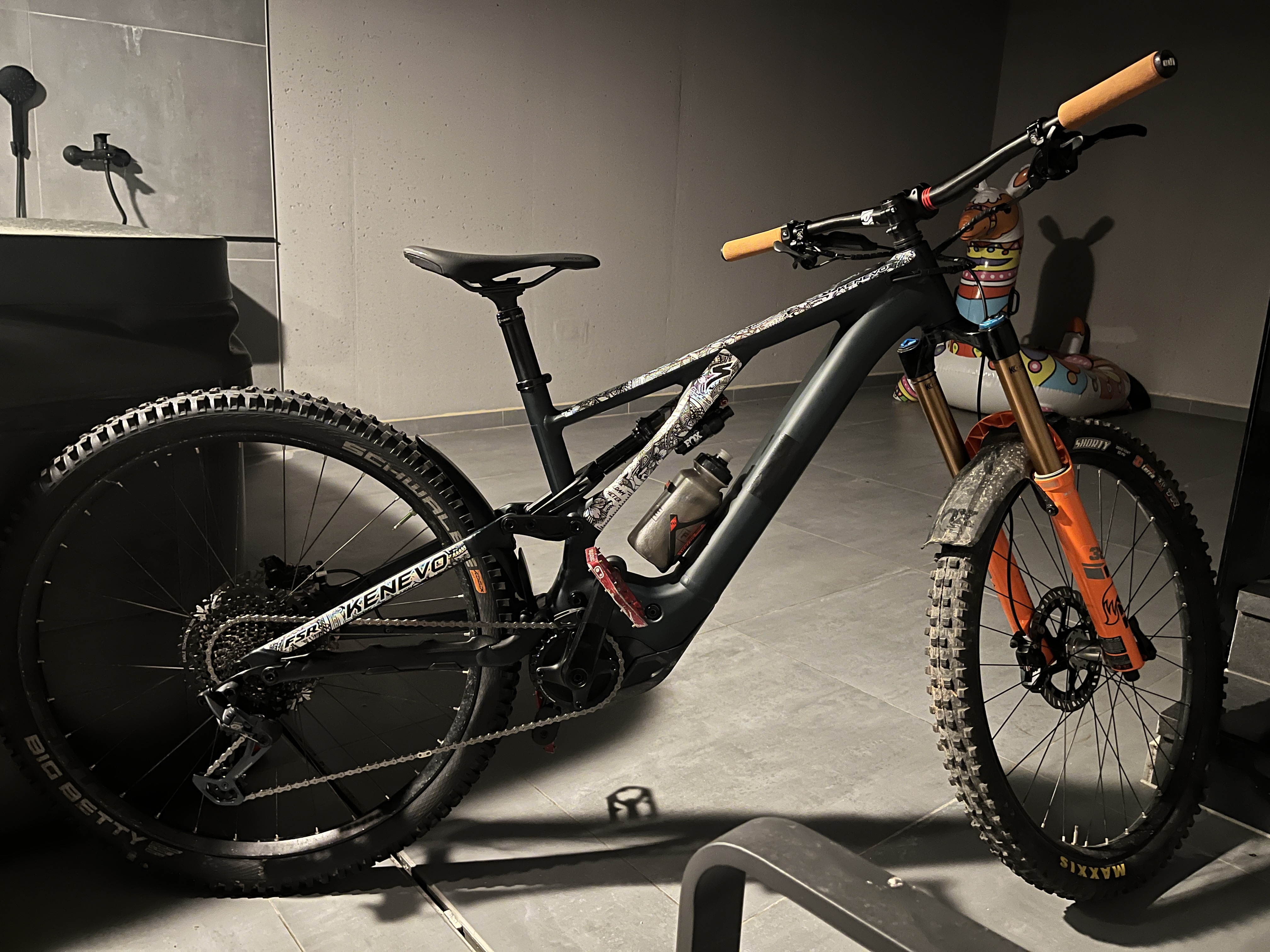

…i only have it for 2 weeks now and we zinged on last rides. First few rides it felt too high, but i soon got used to it and it flies now,
on tech alpine terrain- pivots are ok, and also on twisty closed switchbacks and berms i learned how to push it in and get some Gs out of corner… veery happy with my decission ;)

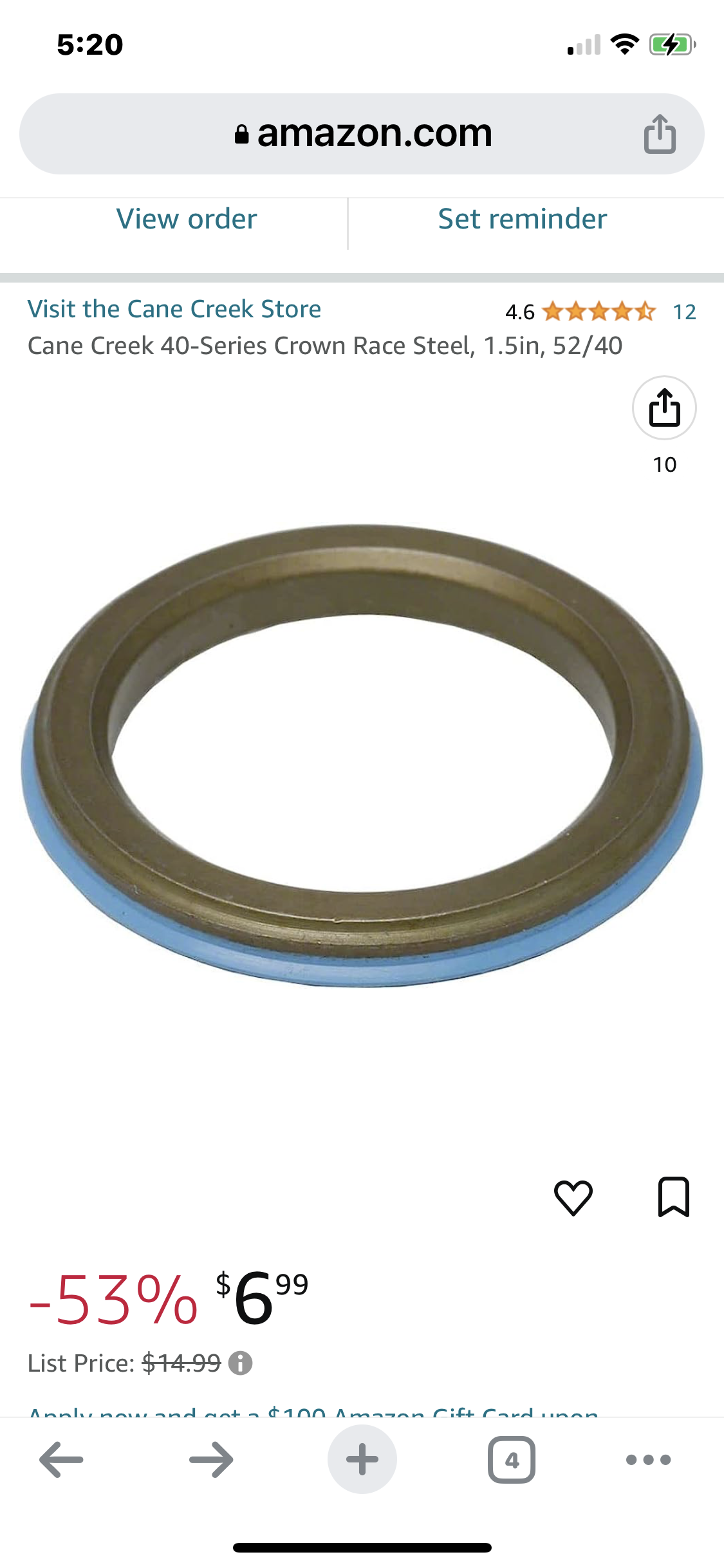

This is what I am using, seems to work.

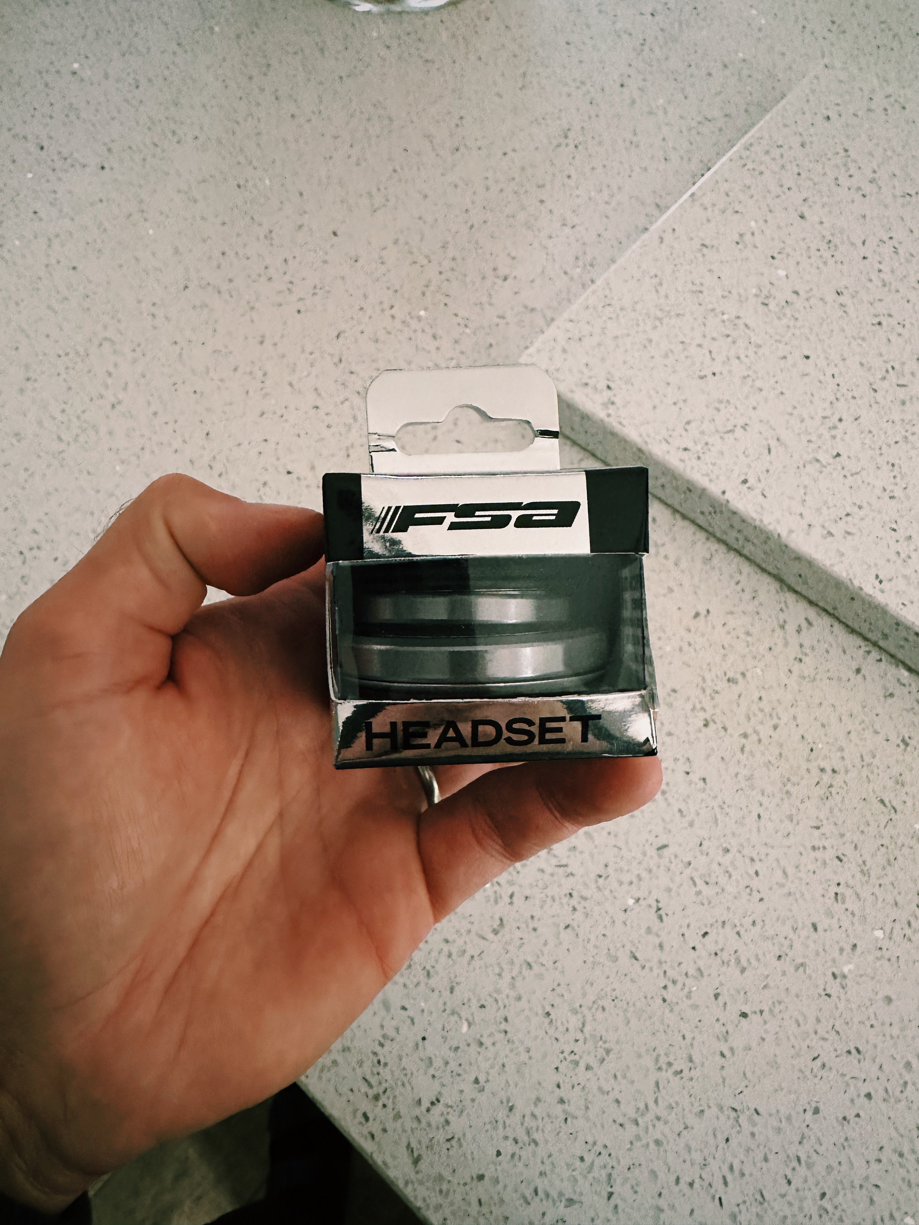

Did exactly the same. This is the bottom crown race you need.
One thing I did was drop the front travel to 170mm. I thought 180mm with the 38 would make it a bit too slack.

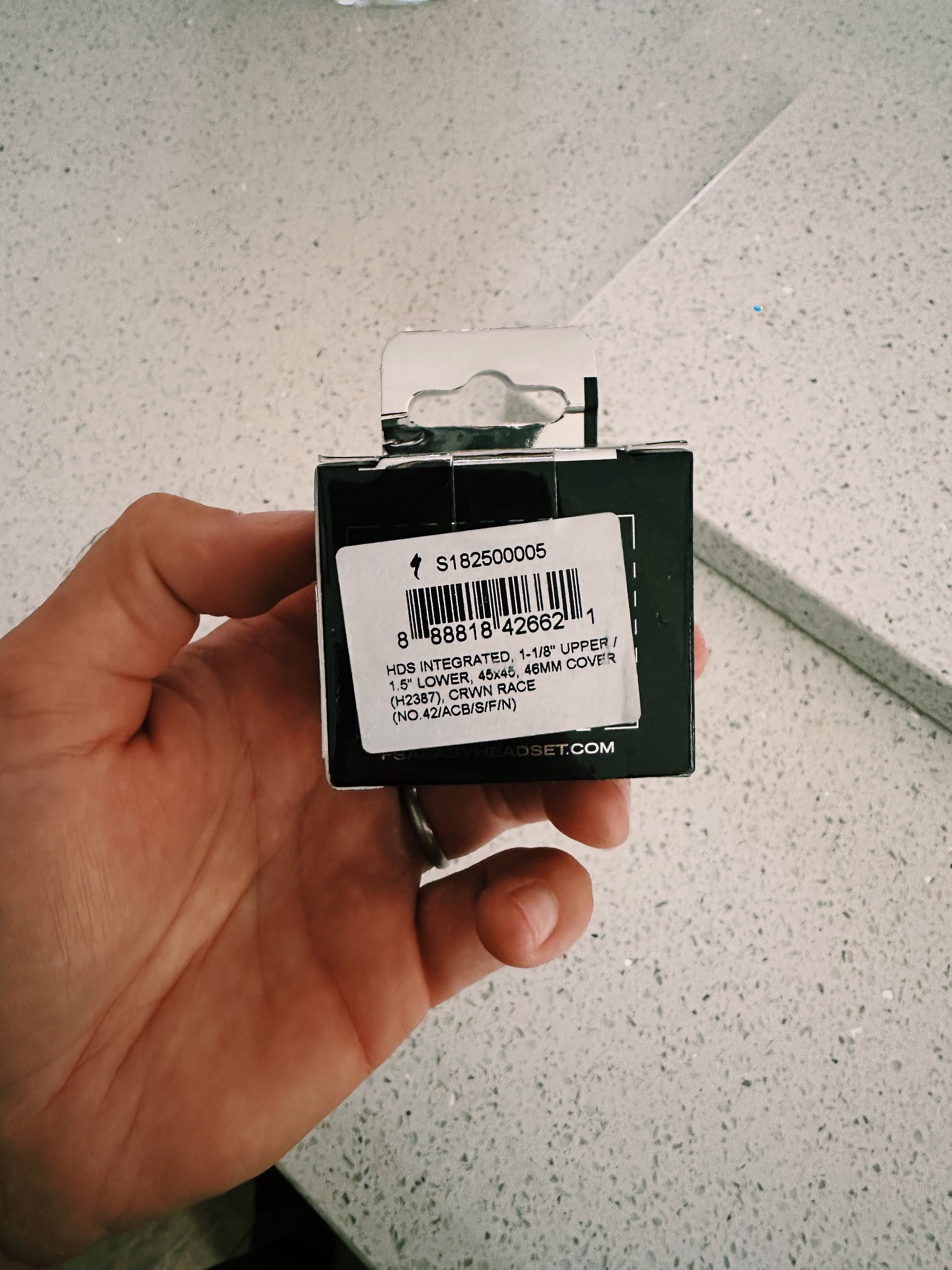

I ordered the comp headset kit for my expert to convert to a single crown tapered config…
Part no:- S182500005

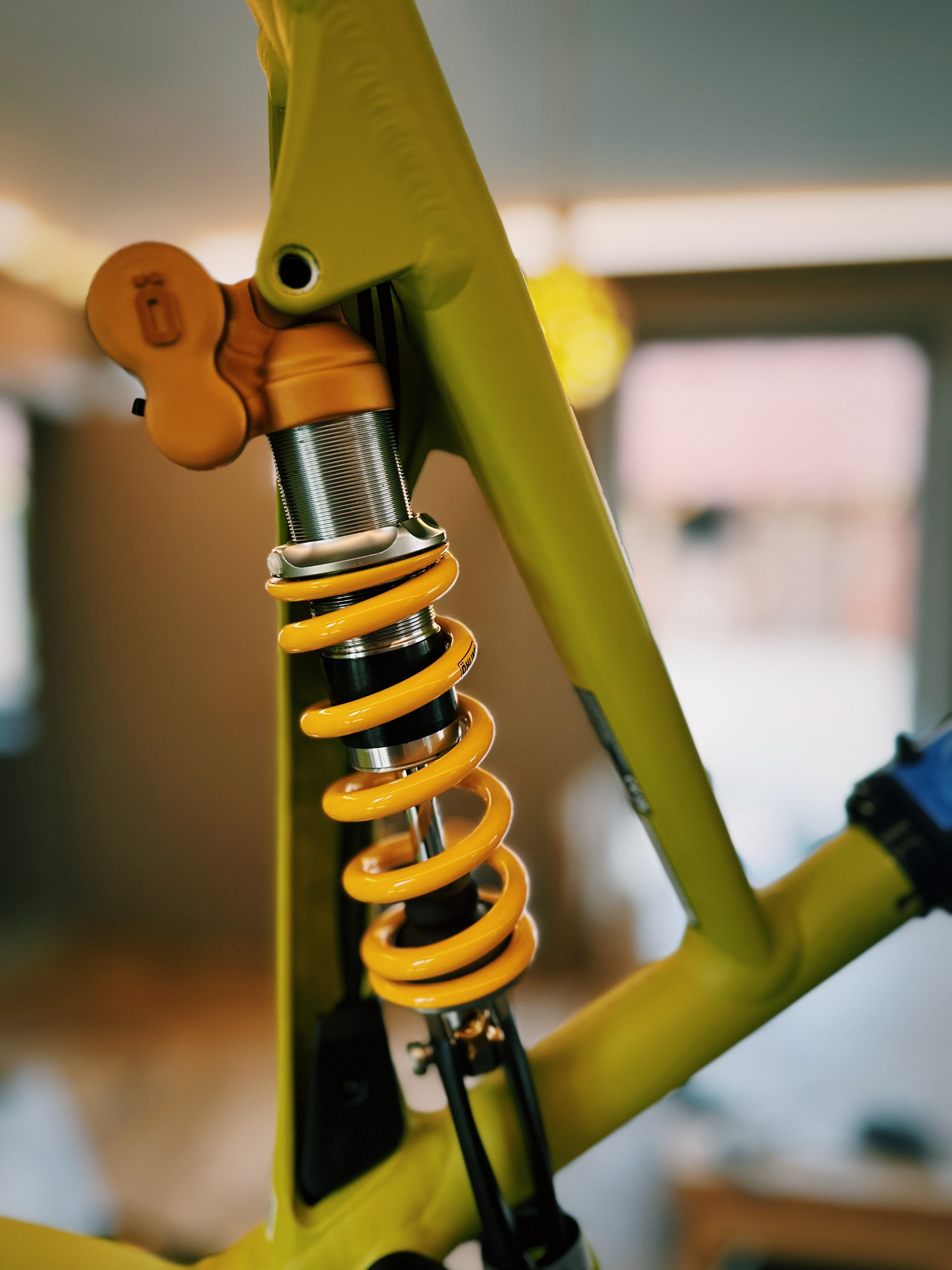

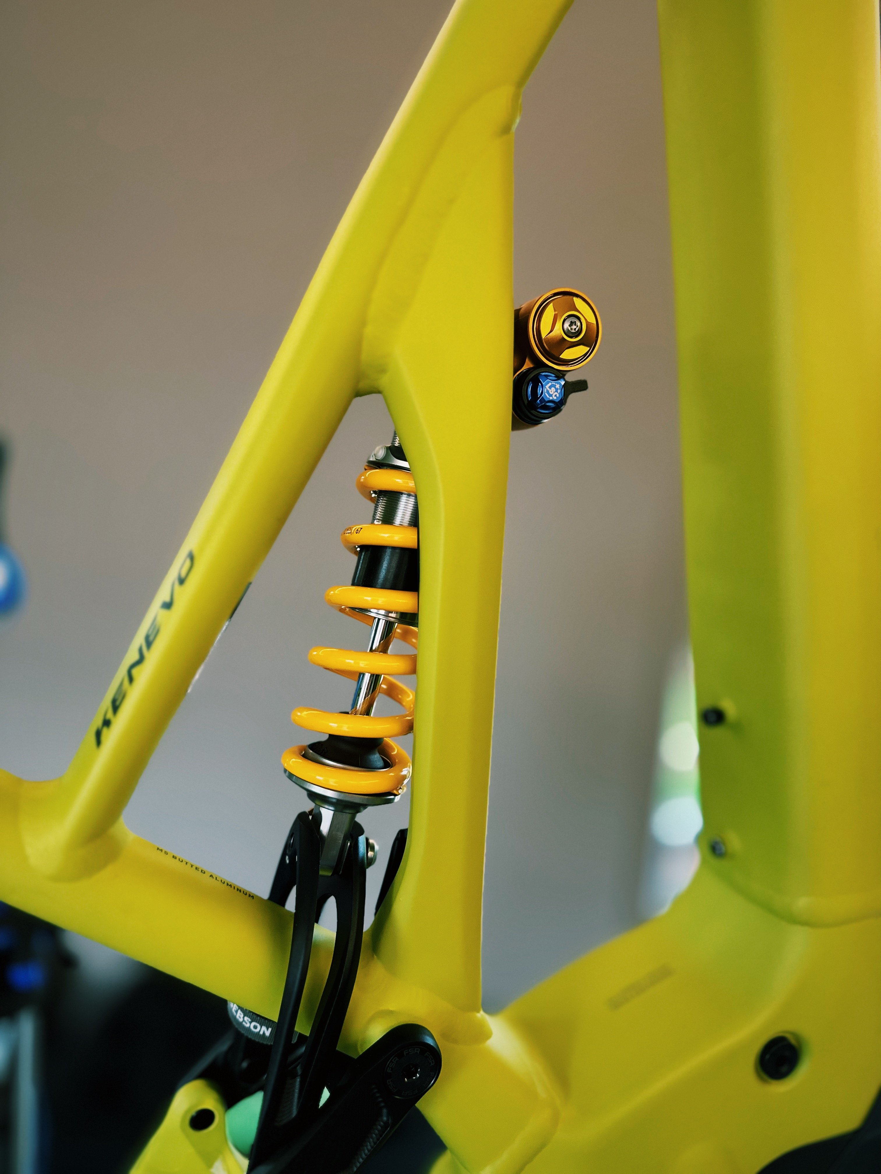

Still not sure what mounting hardware I need for my Ohlins TTX22M2 shock. I’ve done a search but can’t find anything. It’s been setup for a Levo but guess it needs different hardware on the top mount. On the Levo you can transfer over (I bought new) - not sure if you can do that on the Kenevo

Just my opinion: I avoid any headsets that have a split bearing seats. They need to be kept “wet” with lube or they creak.

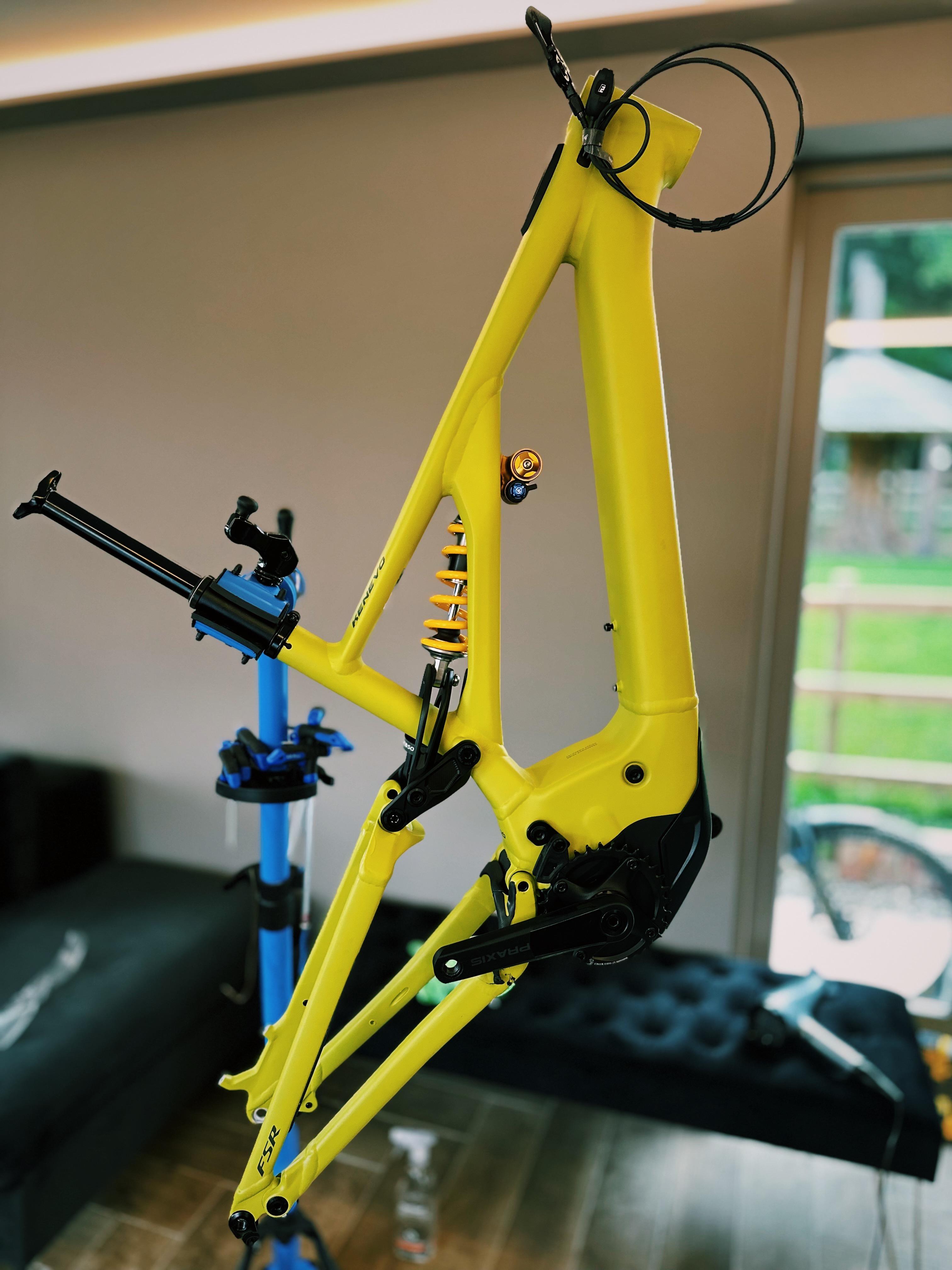

Basically I’m replacing everything (even the dropper pictured below to Factory Transfer and cranks / chainring to Hope.
Have a massive box of new parts now 😂
It looks like this at the moment ready for invisiframe
