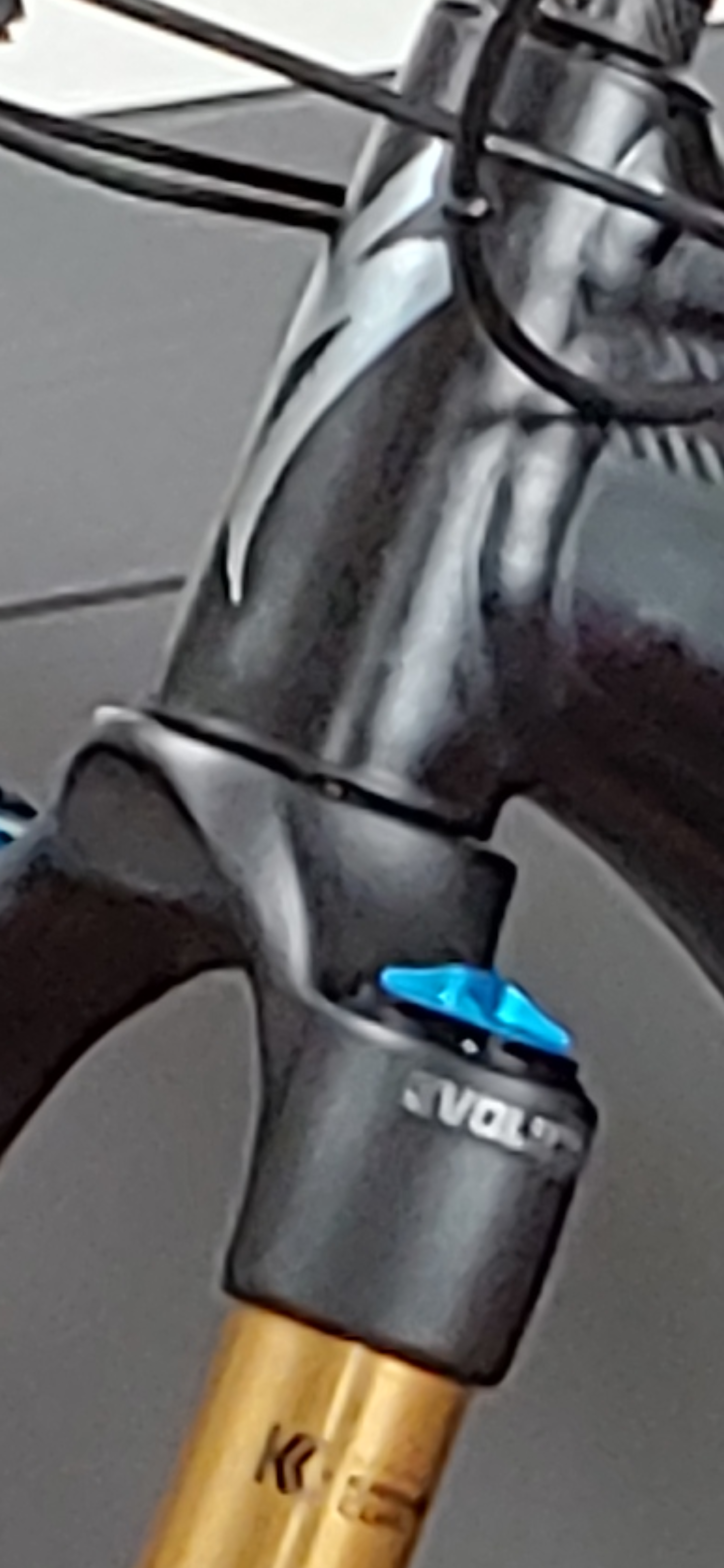

How come my fox 38 crown is massive compared to yours rob?
cozzy
Aug 11, 2019
979
1,115
Hampshire UK
For the OEM market, Fox will offer 2 crown sizes, but the company stresses that there are no performance advantages from one crown to the other, and the choice is purely for aesthetics. A larger crown will be offered for bikes with a larger headtube and chunkier design, such as an eMTB, while a smaller crown is available and looks more at home on a regular enduro bike.
You bought a cheaper oem fork. I did the same recently, came with no decals, volume spacers, manual etc. Was a healthy saving over retail model.

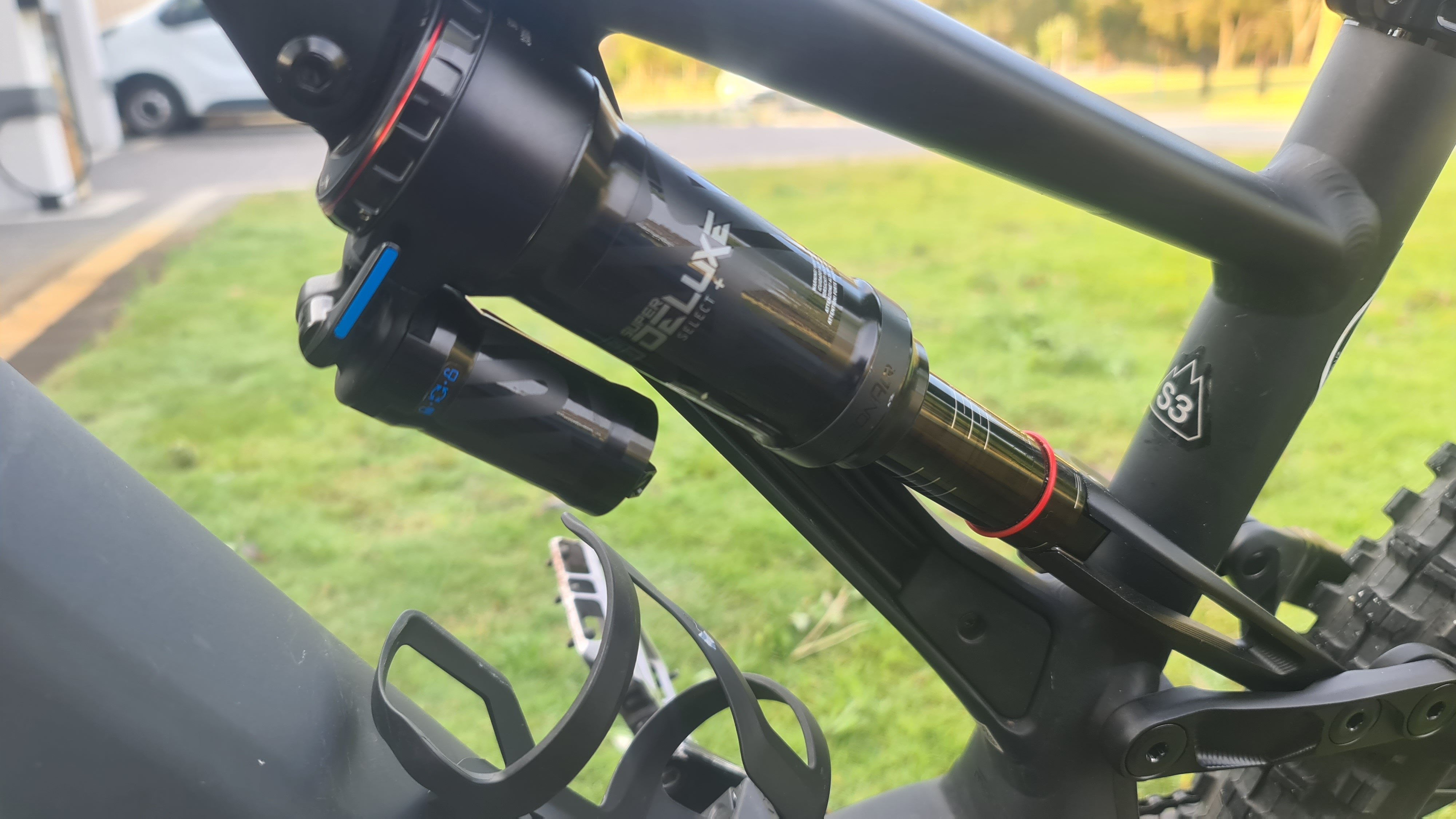

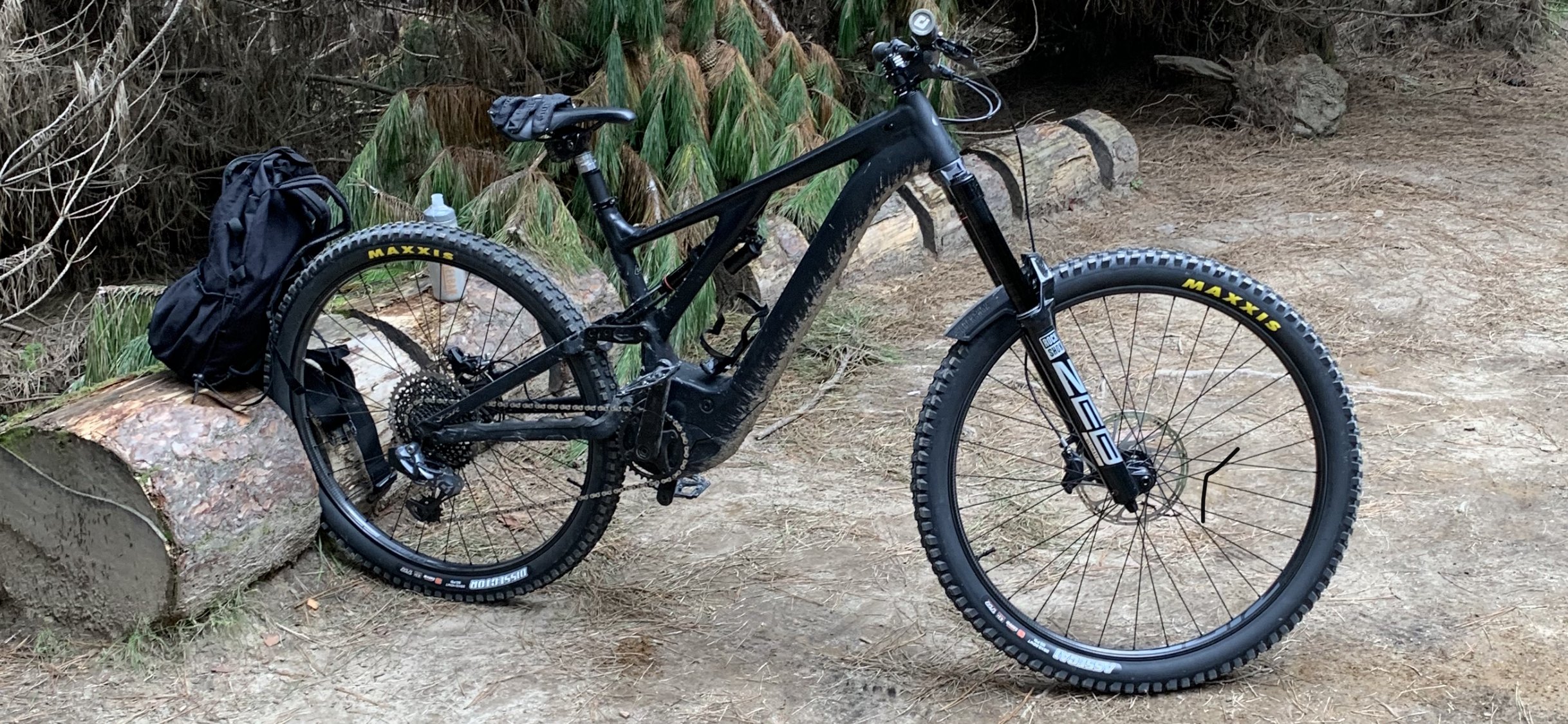

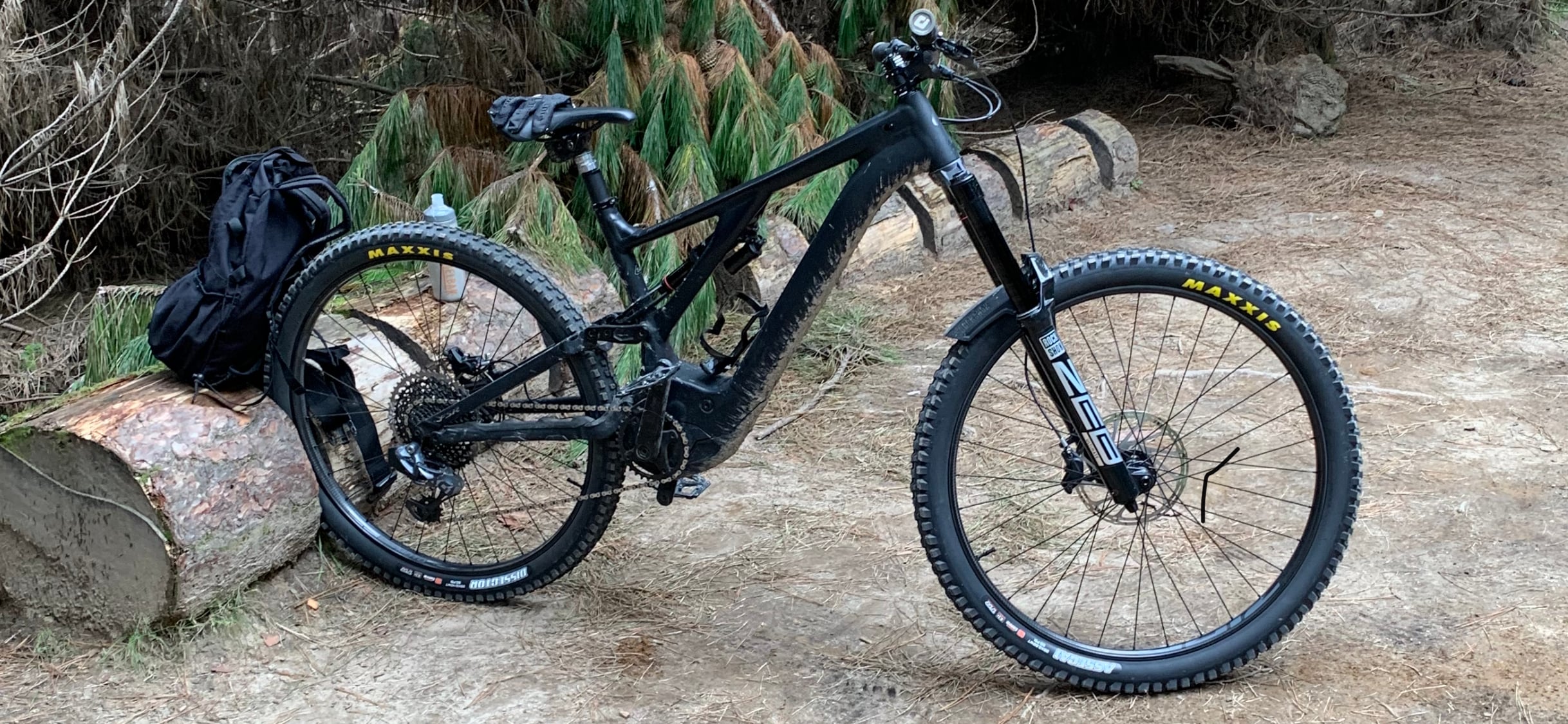

Recently completed my conversion also…….
Zeb Ultimate with 190mm Airshaft (63 Degrees)
Super Deluxe Select Plus 230 x 65mm / Flip Chip High (Approx 187mm Rear Travel)
Zipp 3Zero Moto 29” Wheelset with 2.5 Assegai + 2.4 Dissector (Tubeless)
Renthal 50mm Apex Stem with Renthal Carbon Fatbar
X01 AXS Derailleur and Cassette + 170mm AXS Dropper
HT ME03 Magnesium Pedals
Size S4
Weight = 23.0kg
Loving it so far, so much more agile / playful and goes down anything…….
Size S4
Weight = 23.0kg
nice setup.
I just bought an used Kenevo. 2021 with 27.5 wheel for now. I will try it like that and change setup little by little and aim to a build like yours in the future.
Can you tell me why you choose the flip chip on high ? With 190mm + 29er you dont sit to high above the trail ?
In low position the bike is too sluggish i guess ?
thanks
JasonNZ
Sep 6, 2019
35
96
New Zealand
nice setup.
thanks
No reason, just had it that way before to get a higher bottom bracket and just put it back in that way without thinking about it until after. Will definitely try it on low as well, but it’s so good now I keep forgetting to change it.
It doesn’t seem too high to me, I’m 6’2” and the balance feels really good……but will let you know once I try the low setting.

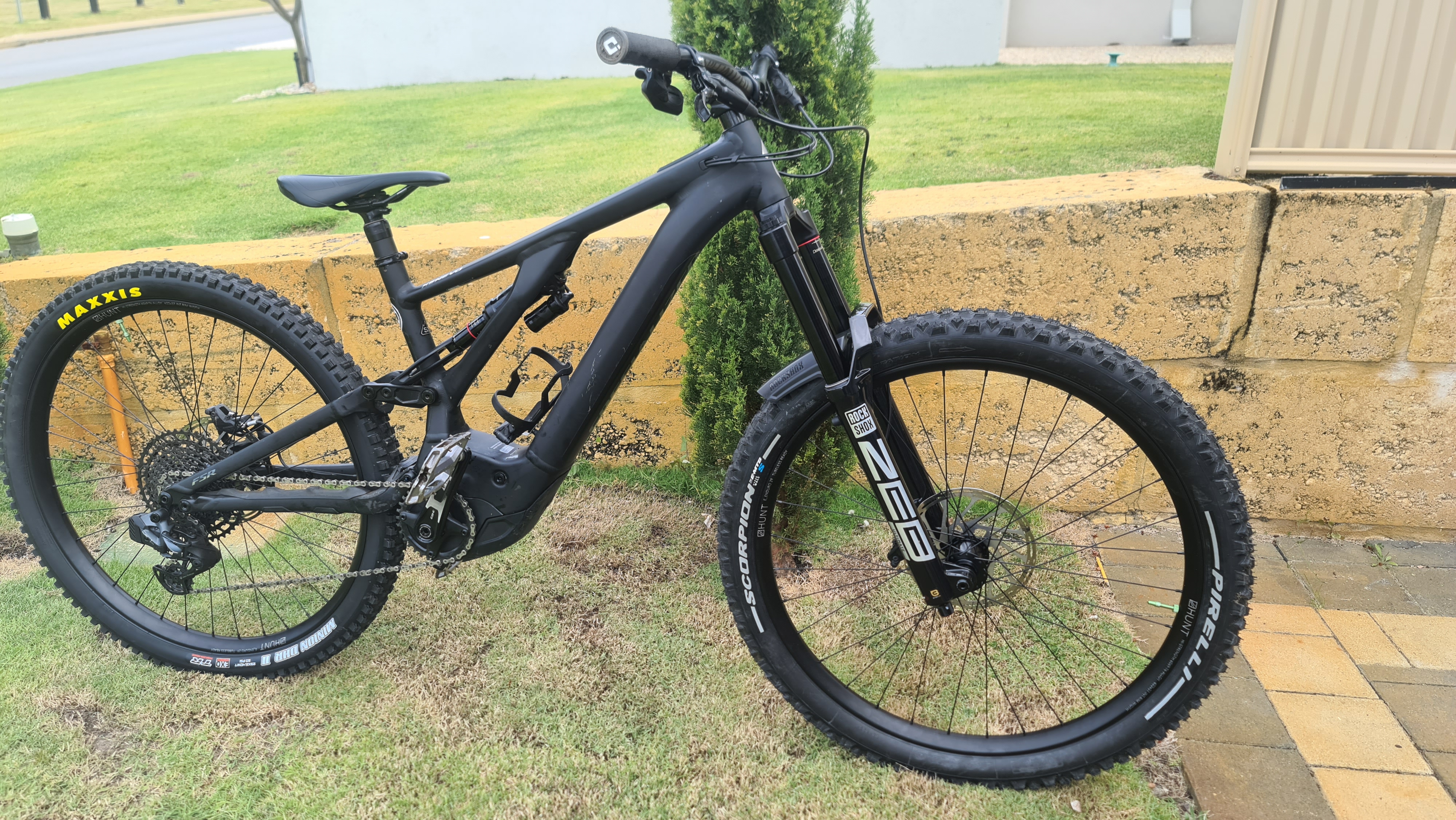

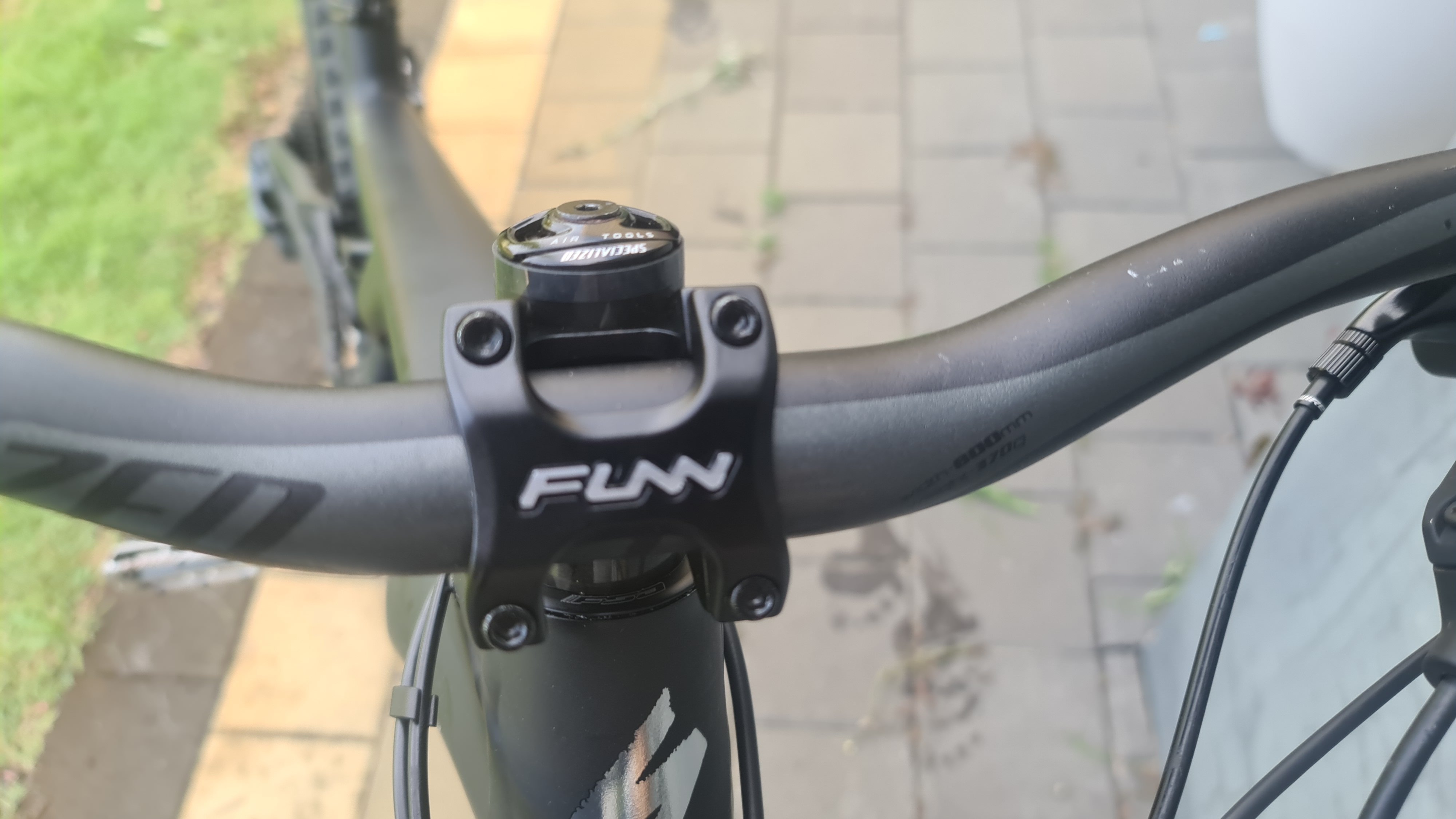

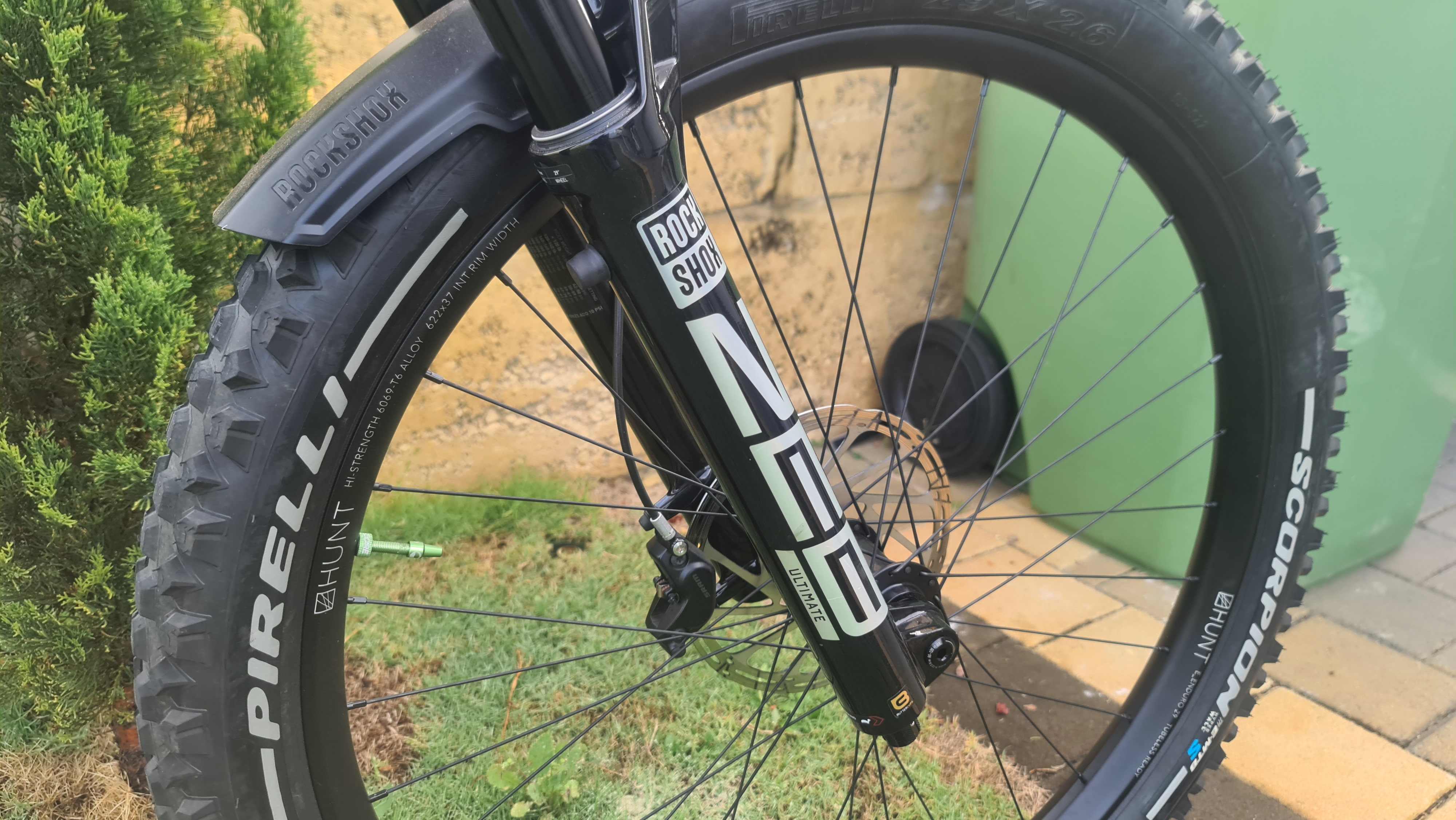

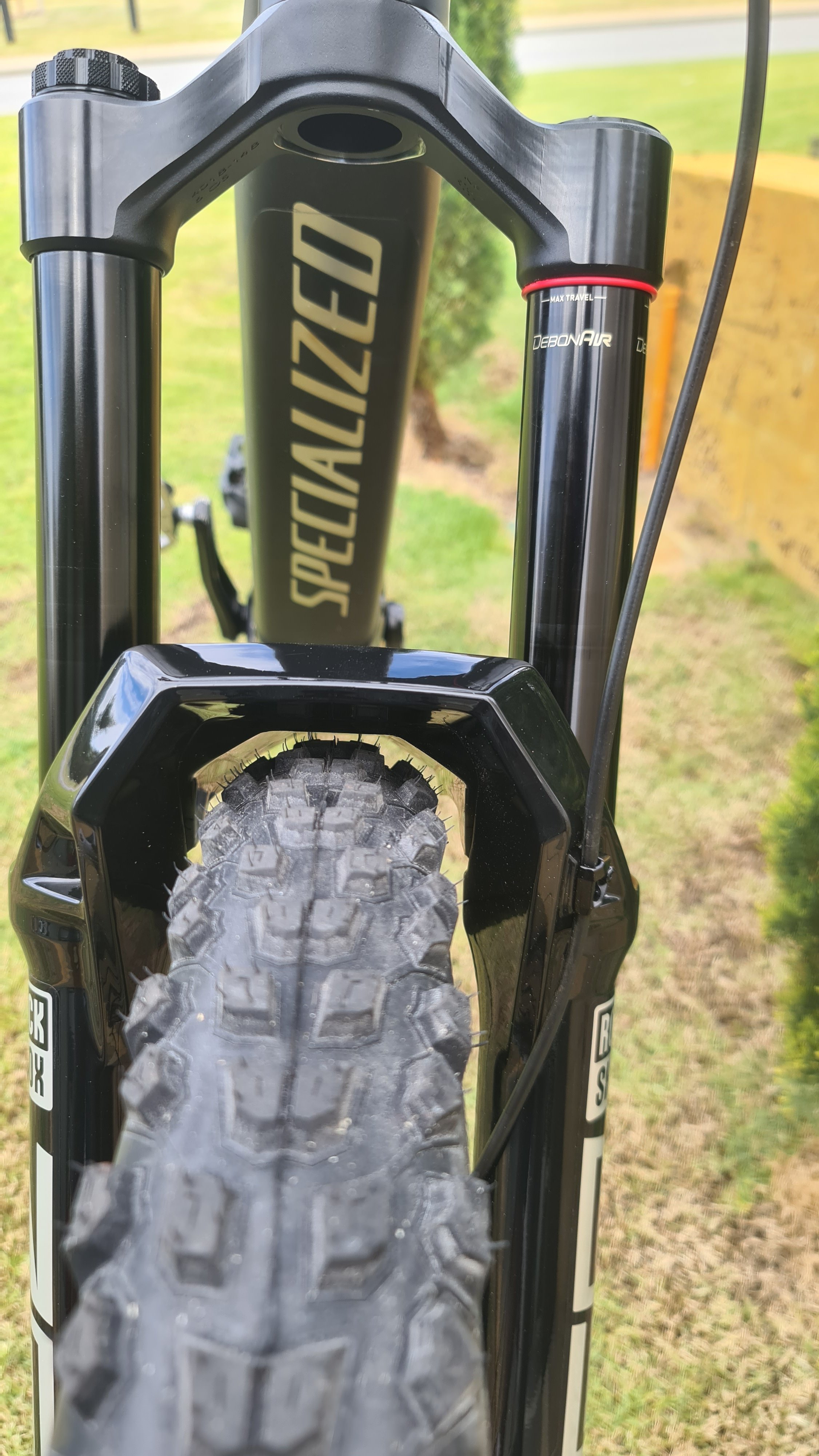

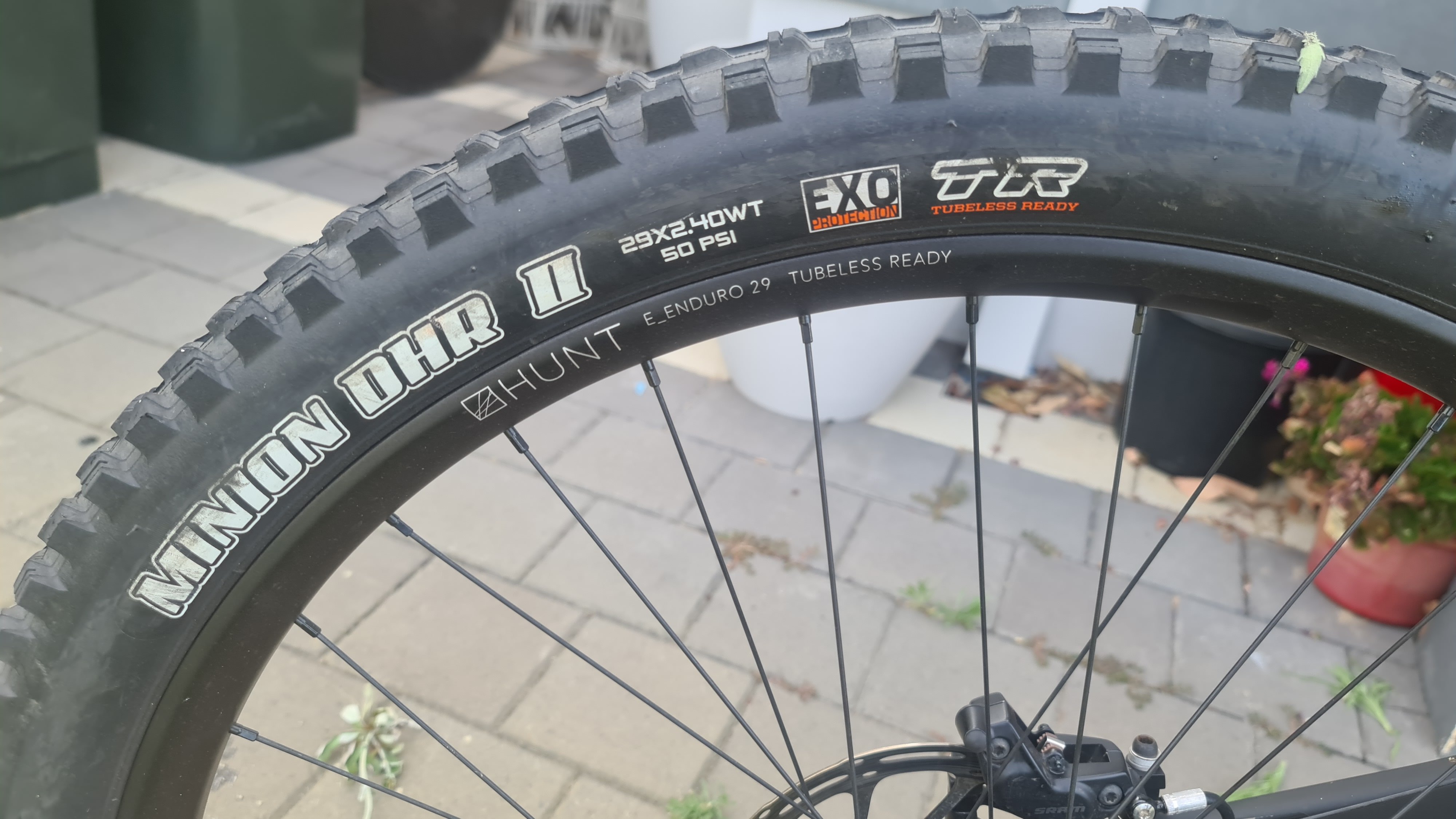

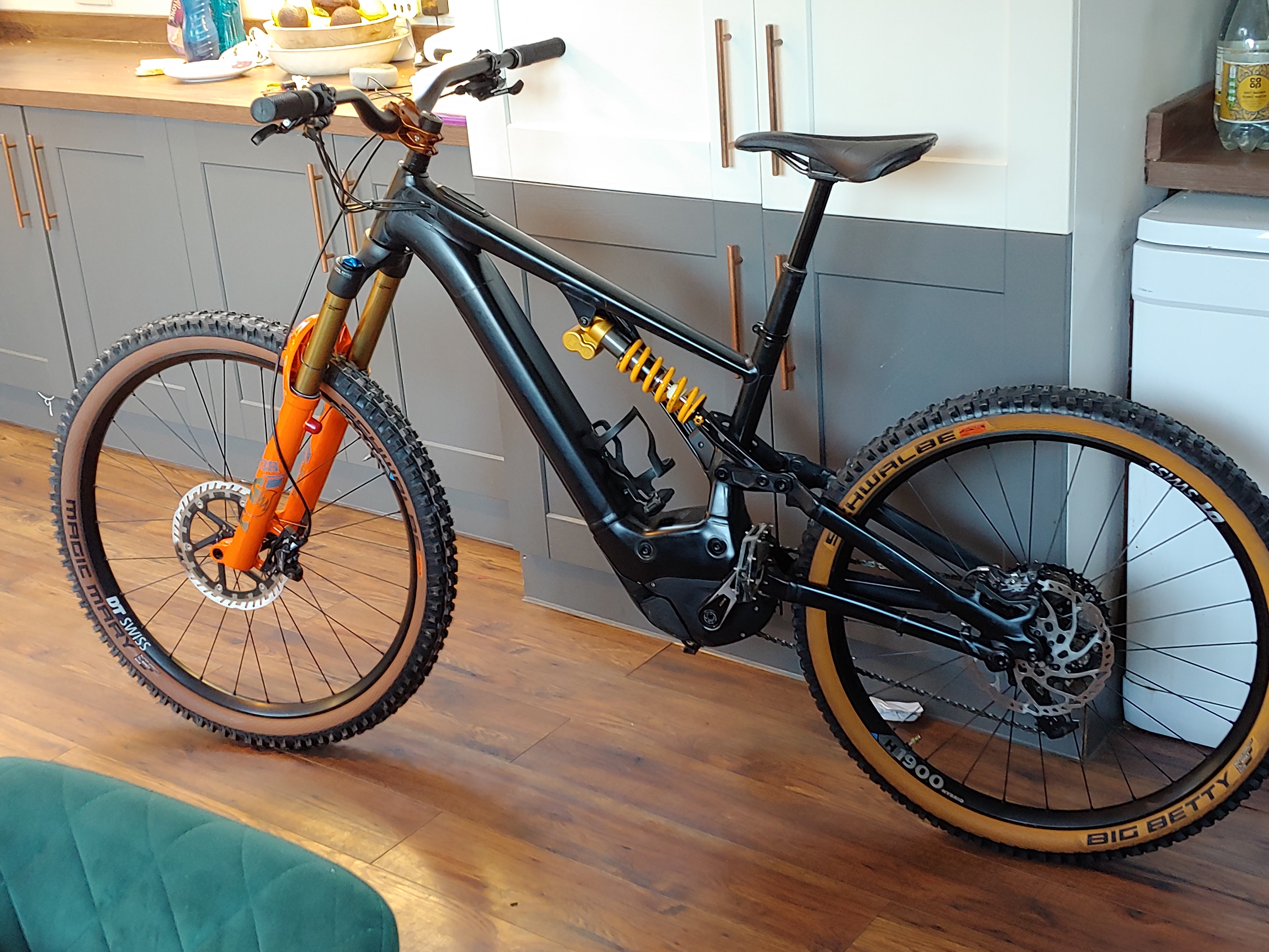

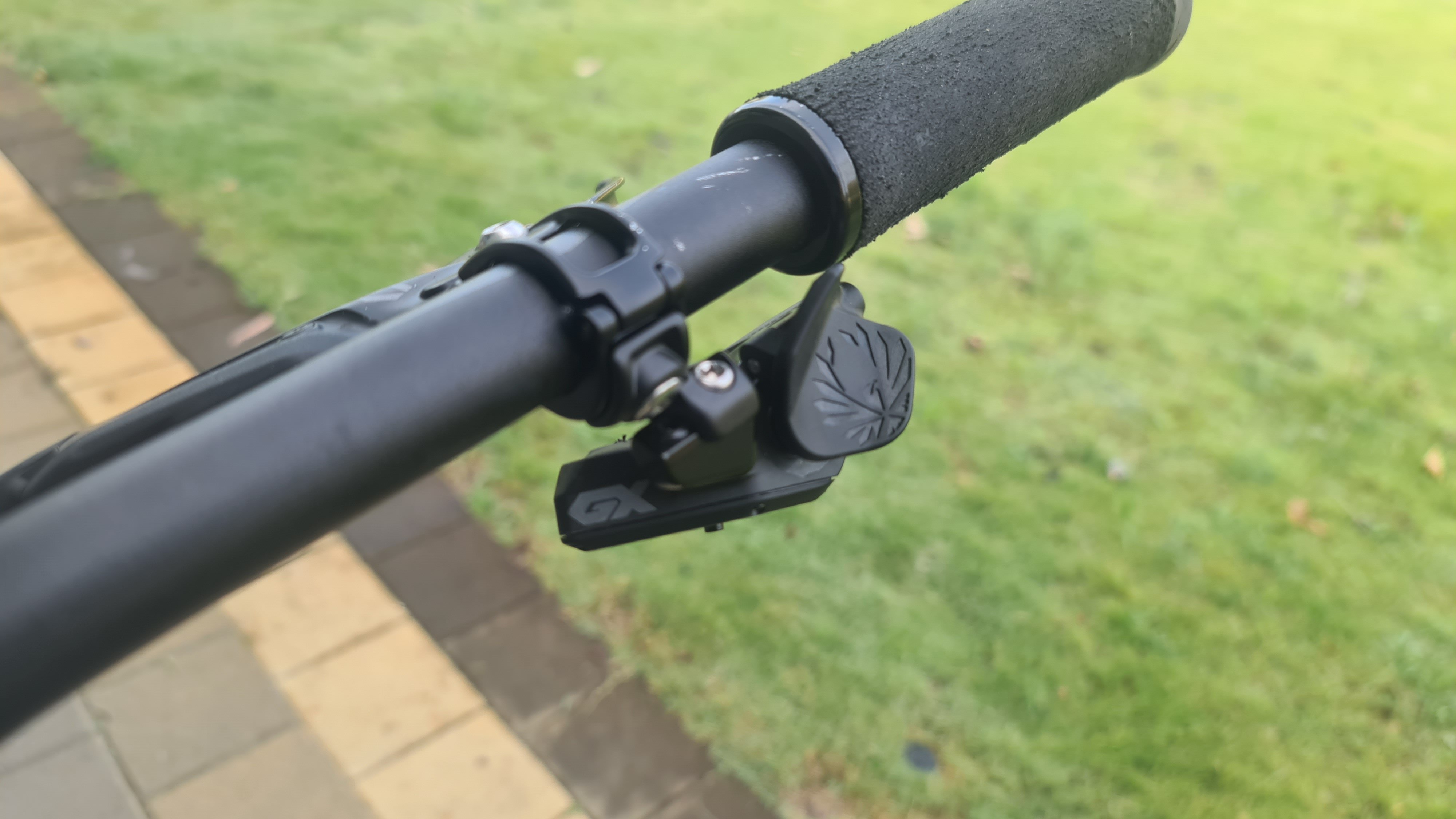

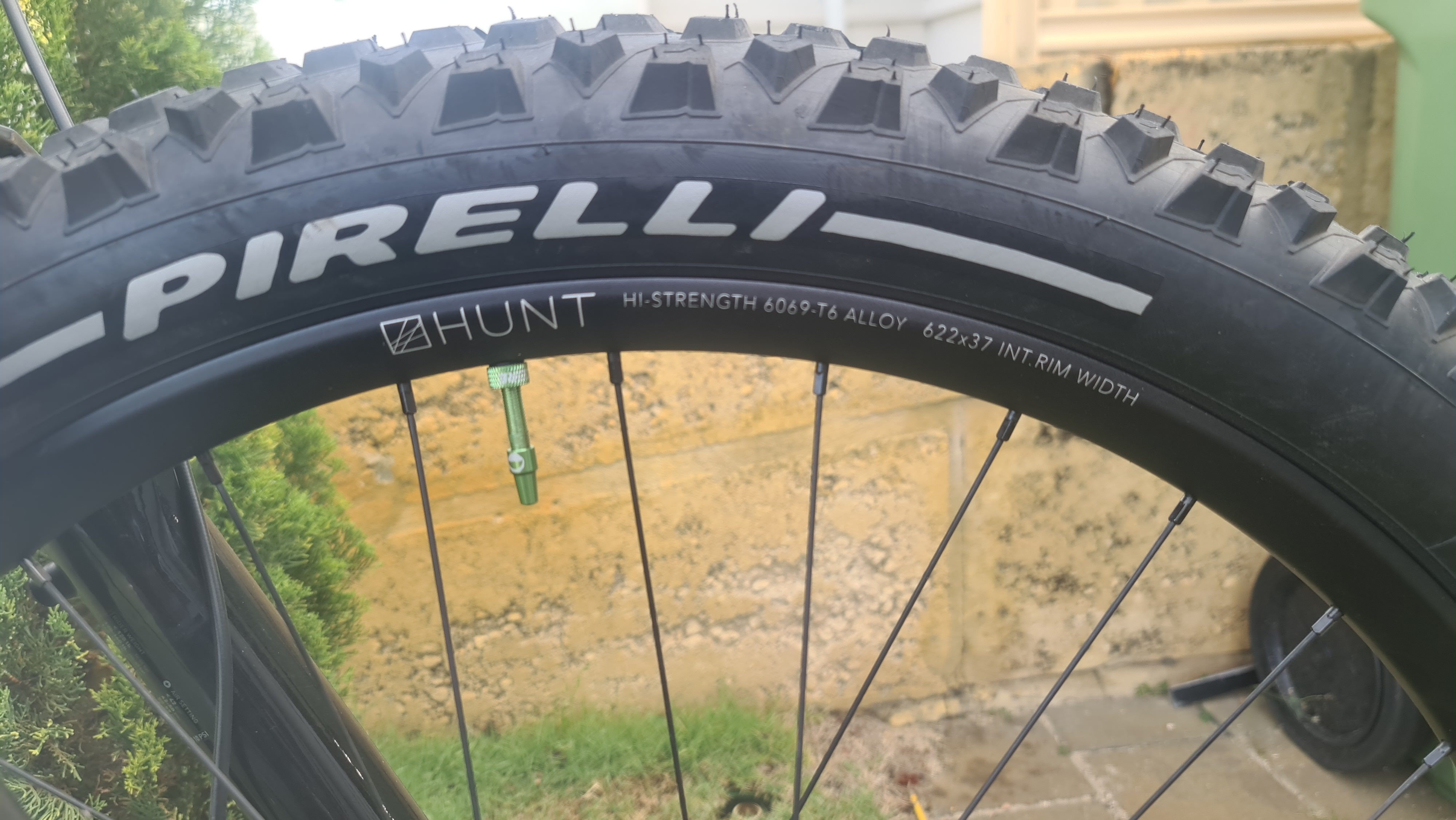

Hi Rob,
Everything else stock bar the Zeb Ultimate rc2, Hunt wheelset, 2.6 pirelli scorpion on front, minion Dhr 11 on rear with cush core inserts, GX AXS 12 SPEED, 155MM HOPE Cranks.
Cheers Astan
View attachment 102462 View attachment 102463 View attachment 102464 View attachment 102465 View attachment 102466 View attachment 102467 View attachment 102468 View attachment 102469 View attachment 102470 View attachment 102471 View attachment 102472
This looks like a weapon…keen to build one of these now..
