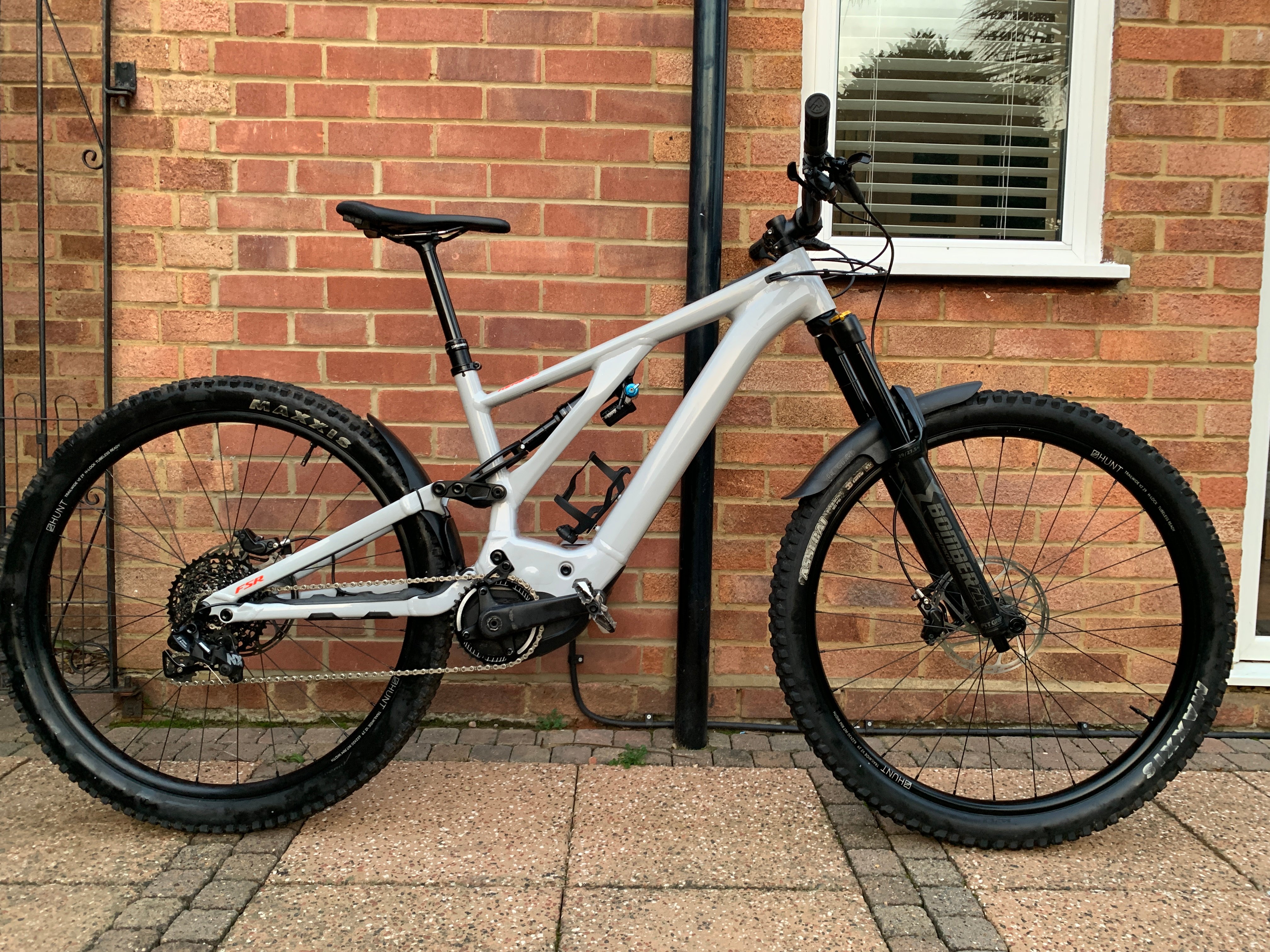

I’m 5’11 and have just purchased an S3 Kenevo. The reach on the S3 is 470, my other bike was a large Levo G2 that had a reach of 455. S3 feels spot on.

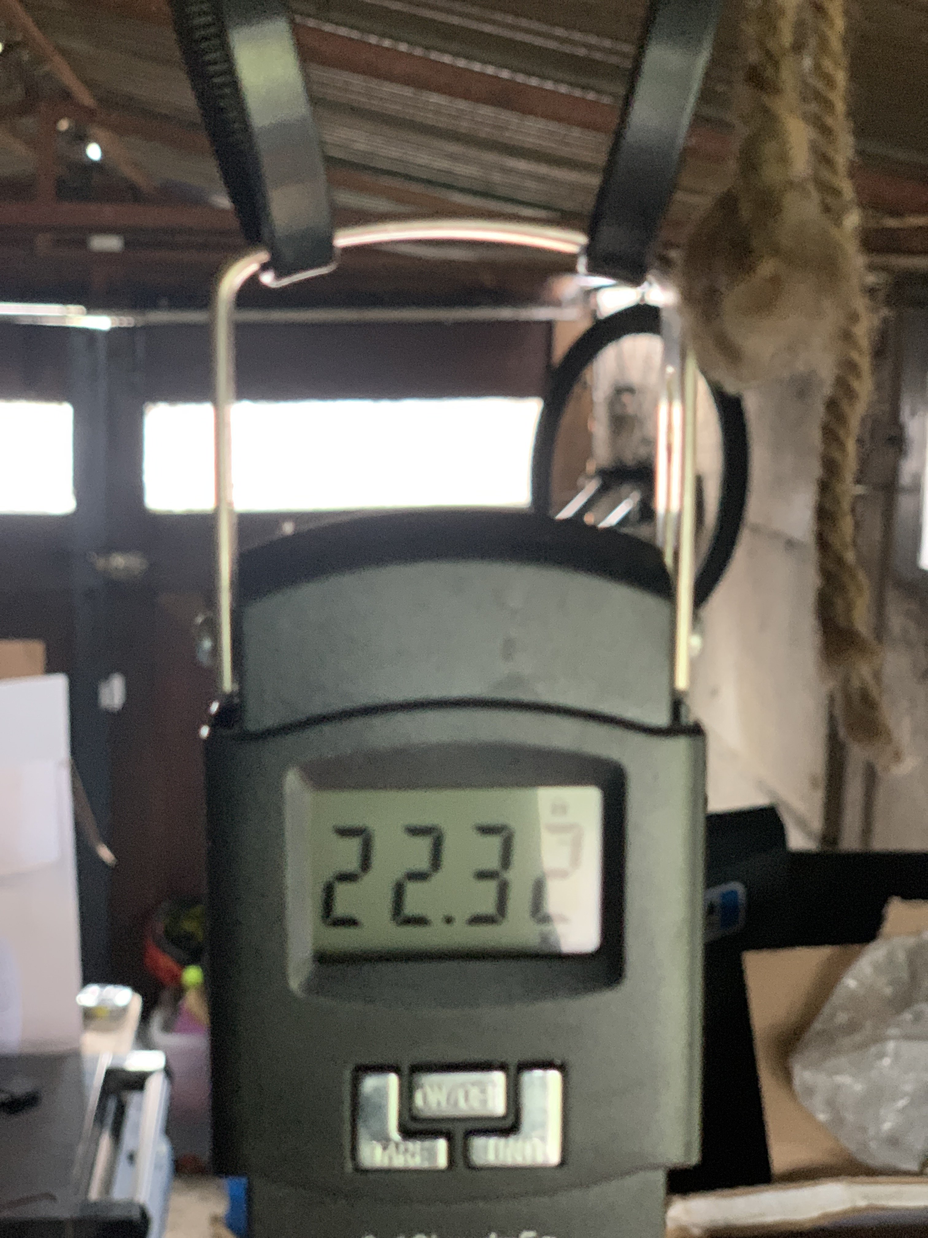

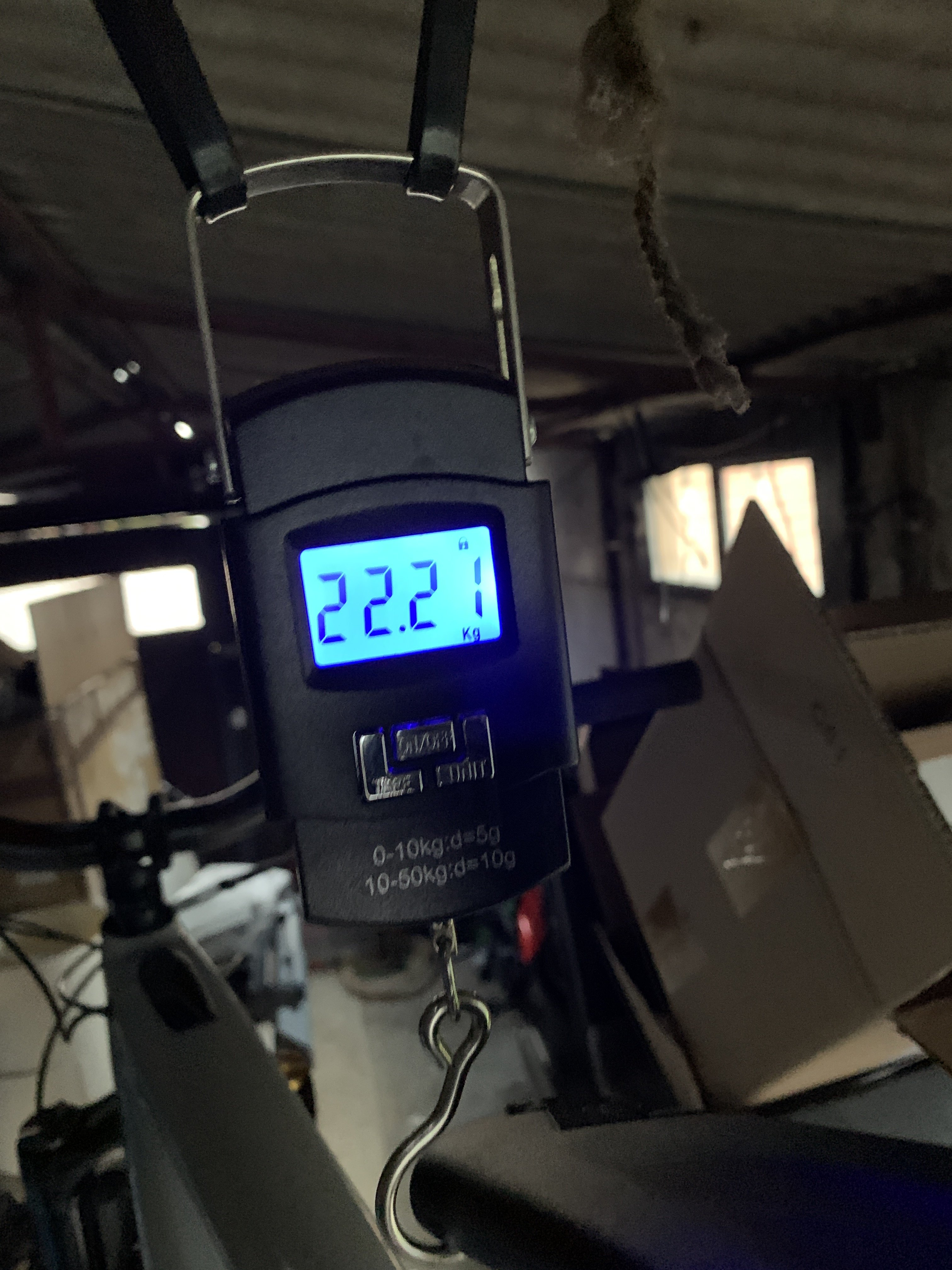

Just purchased a 2021 Kenevo Comp and did the 29/29 conversion the current weight is only 22.3kg with pedals (500w battery).
Levo Laland
Nov 27, 2019
274
236
Surrey UK
Did you fill the frame with helium? What tyres?
My Gen 2 Levo weighs 24.5kg with pedals.
Assegai exo 2.4, Butcher grid 2.3
Hunt trail wide wheels (will probably swap out) carbon cranks and carbon bars. Bomber Z1 fork, DPX2. 500w battery which is 700g lighter than 700w.
My large Levo gen 2 comp carbon was only 21.3kg.

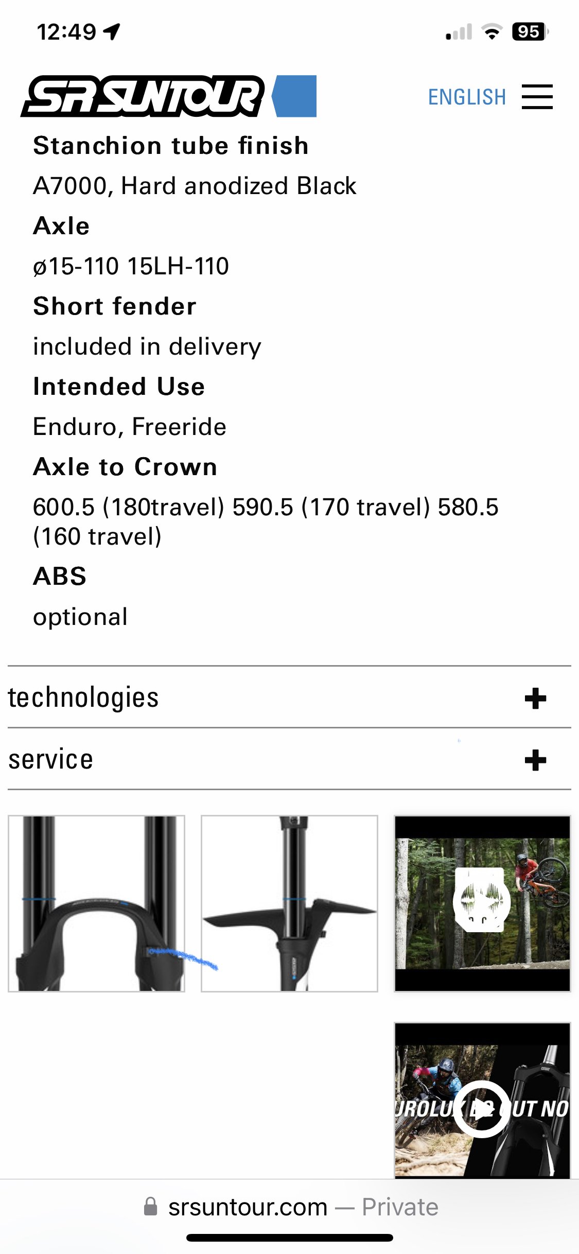

Hi all I've been watching this with interest as a 29 kenevo really might work fir me I've just seen suntour released there new durlux 38 and it's axle to crown is 590mm where the zeb is 597mm it might be an option to keep the H/A a bit steeper any thoughts ?
Levo Laland
Nov 27, 2019
274
236
Surrey UK
590 is with the 170mm travel, it’s 600 with 180 travel! 20mm or 30mm higher than sock that’s probably 1 & 1.5 degrees slacker than stock. Rob seams to think that works.
Stretch40
Jun 26, 2019
326
133
Durham
Hi sorry for thus question but I'm trying to get my head round it ? If you fit 29er lowers on the boxer course you get the geo/HA back to normal if u drop uppers through a bit ?

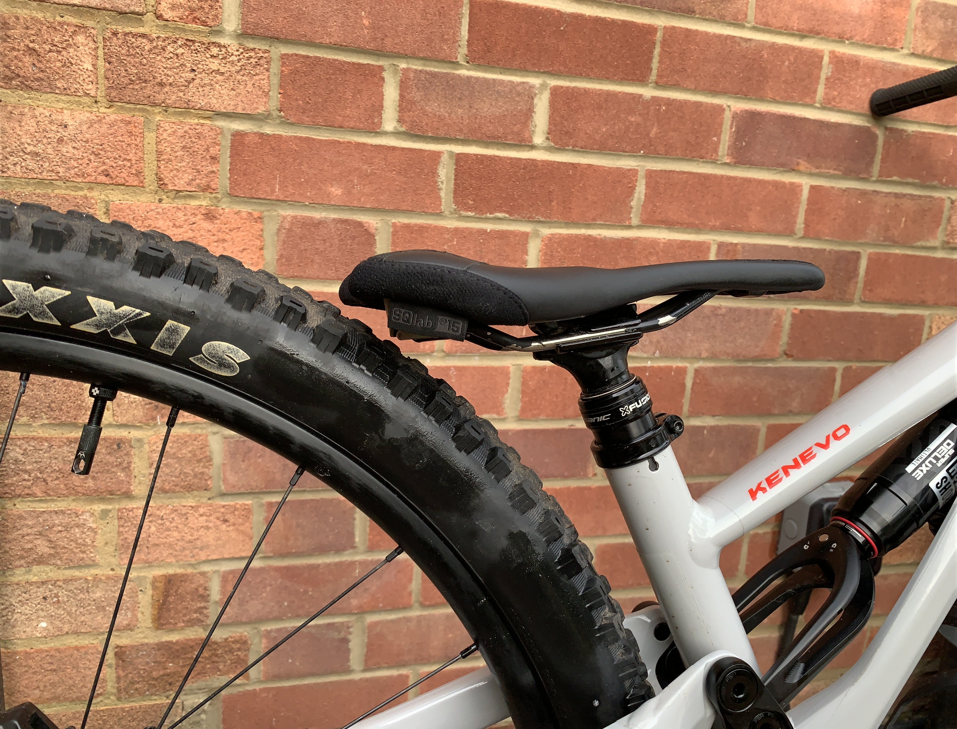

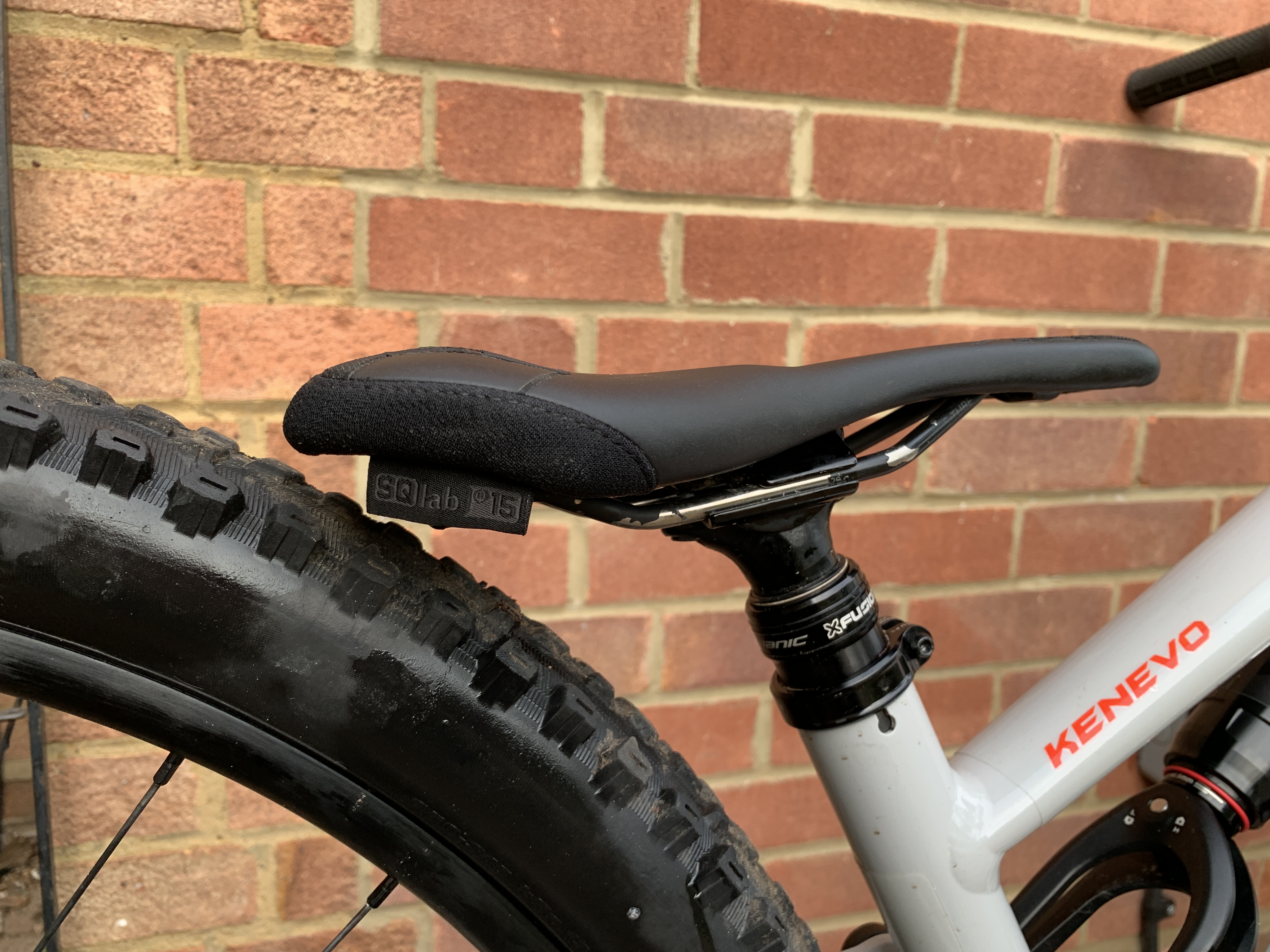

Here is a photo of the saddle clearance on a size S3. The tyre is an Aggressor 2.5, the post is as low as the frame will allow, and the rails on the SQlabs saddle are quite low.
The seat tube length on the S2 is 20mm less than the S3, so it gonna be tight on an S2 unless you run the post about 30mm or more up! Otherwise, you’d have to run a shorter travel dropper.
View attachment 105552 View attachment 105553
What length XFusion post you have when you got it so down?
