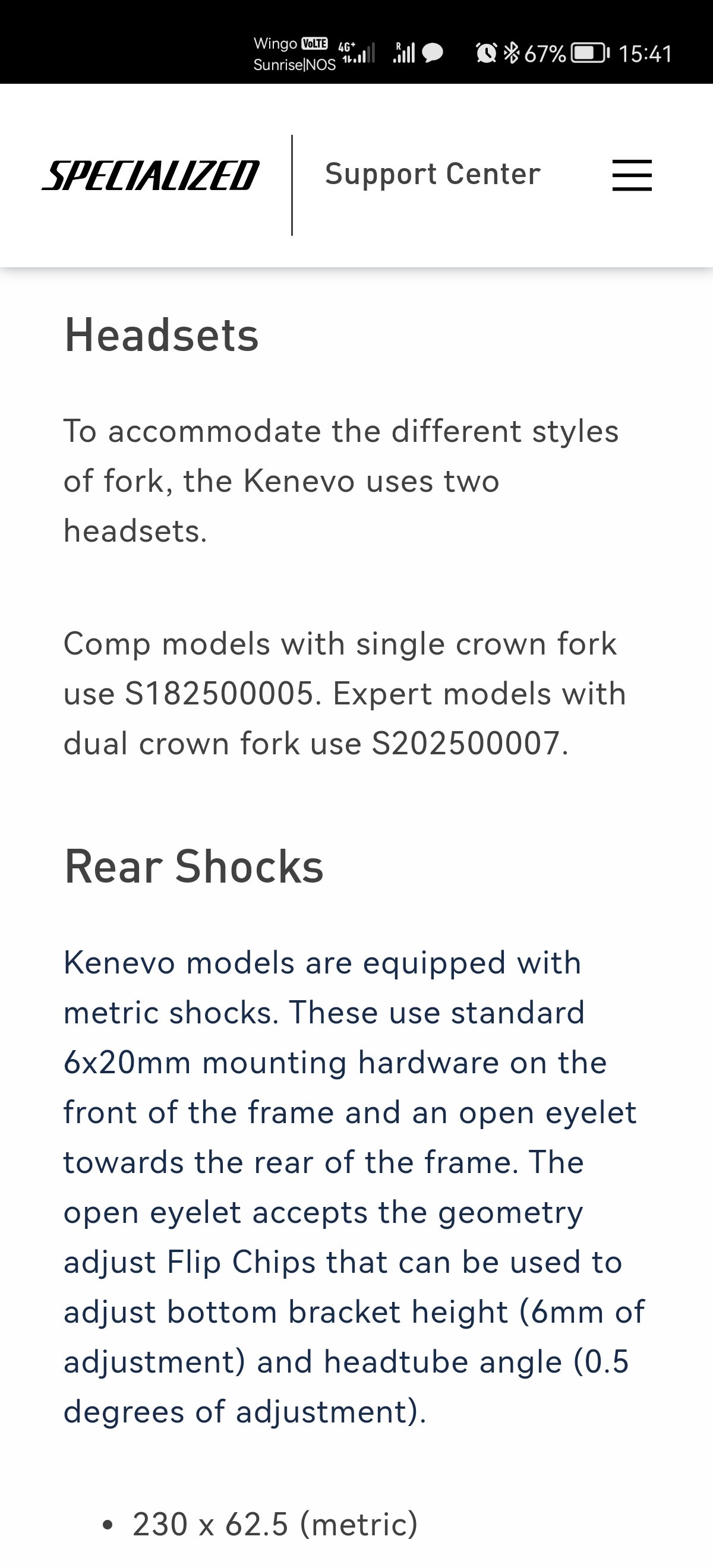

Just building mine up. 180mm 29 Zebs, Fox X2 and Nukeproof Wheels. Gusset S2 bars, as I can’t get on with 35mm bars and gonna put my AXS seat post in from my other bike.
Anyone have any advice on fork crown race for lower headset? The Boxxer was a straight steerer and new Zebs are tapered. Can’t seem to find much info on what Headset Specialized have used on the Kenevo.
Aug 25, 2018
46
84
Randa, Switzerland
You can order it over Specialized dealer. On the pic you have the part number. I'm also waiting for mine.
Cheers

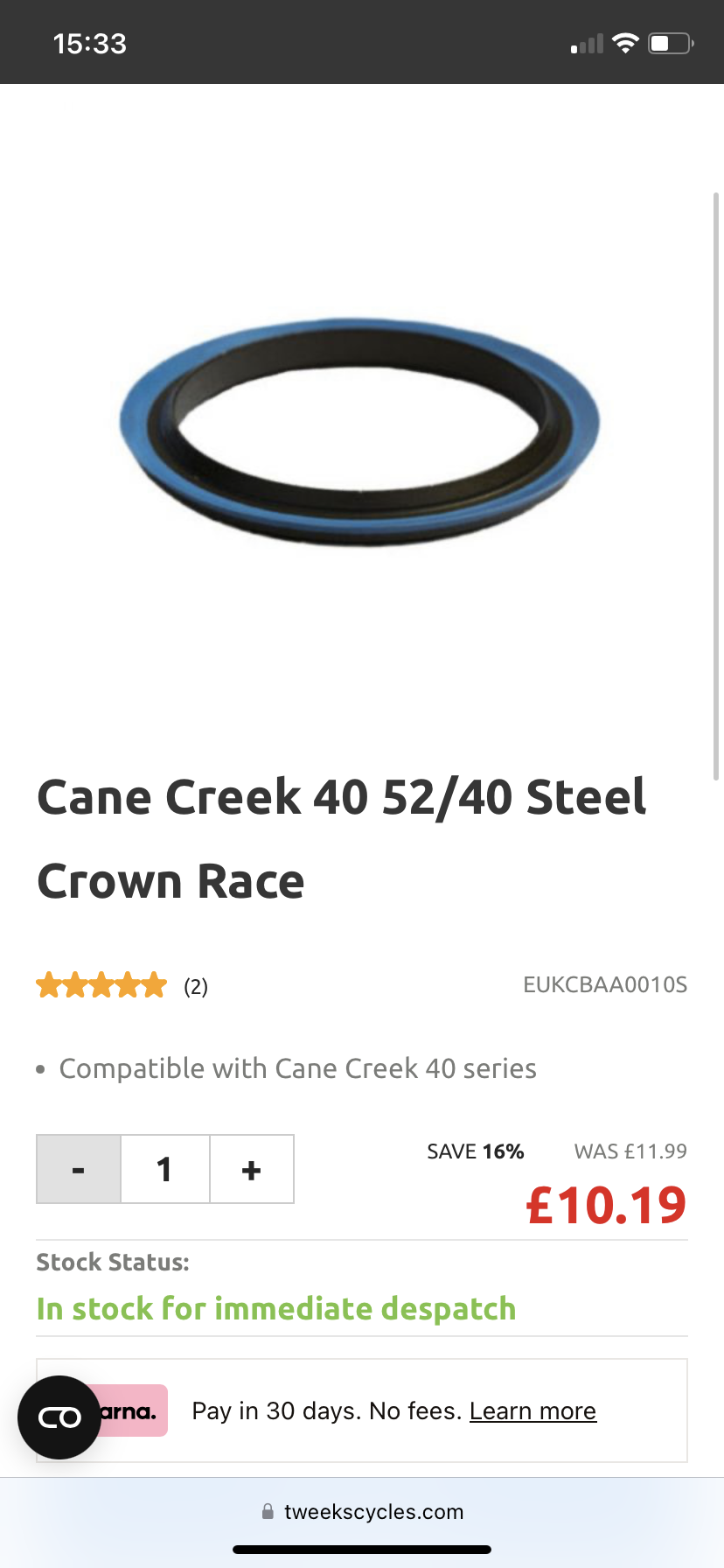

Do some research to verify, but I would say its one of these for a single crown fork.
Quality item being steel with a seal built in rather than the awful alloy split ones that come as stock.
For reference the boxxer with the 1 1/8 straight steerer uses a 52/30.
52 headset OD
30 ID = 1 1/8 (straight)
40 ID = 1 1/2 (taper)

Get a lower from crane creek or King and crown race. Specialized uses a different angle than most bearings. And the split ring is terrible.
The upper is a taller bearing than normal too. So if you are getting a set make sure you get the one for "Specialized" bikes.
Alexbn921
Sep 27, 2021
545
512
East Bay CA
The angles are different
Specialized uses 45 / 45 degree.
Cane Creek uses 36×45 degree bearing
"52/40 refers to the diameter, in millimeters, of the inner and outer surfaces of the bearing. It works with a tapered headset with a 1½" lower bearing and an inner race angle of 36 degrees (standard 45/36 bearing)"
I made the same mistake and it "fit" weird and never worked right.

It looks like the lower bearing is the one that Specialized use on almost all their frames. It appears to have the same lower as the Levo’s which is the lower bearing in the attcached. 66F46B1C-9631-4294-9D99-511CEFEEADD9.jpeg

Interesting! I am using a CANE CREEK crown race 40er series EC/ZS/IS52 | 1 1/2" steel with the standard specialized bearings on a Fox 38 for a year now and have not had any problems so far.

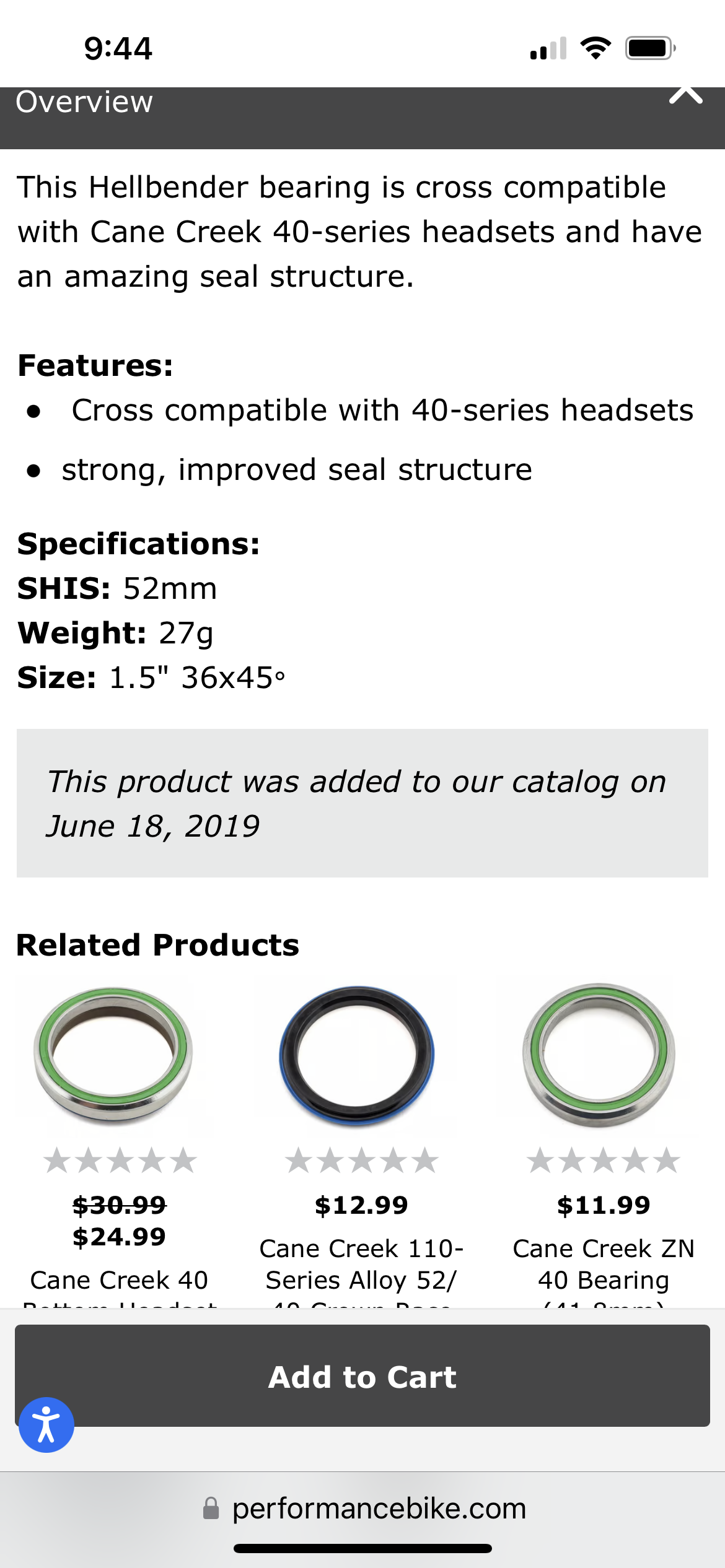

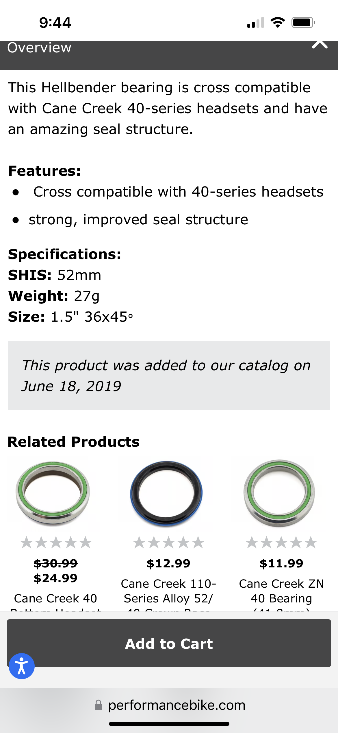

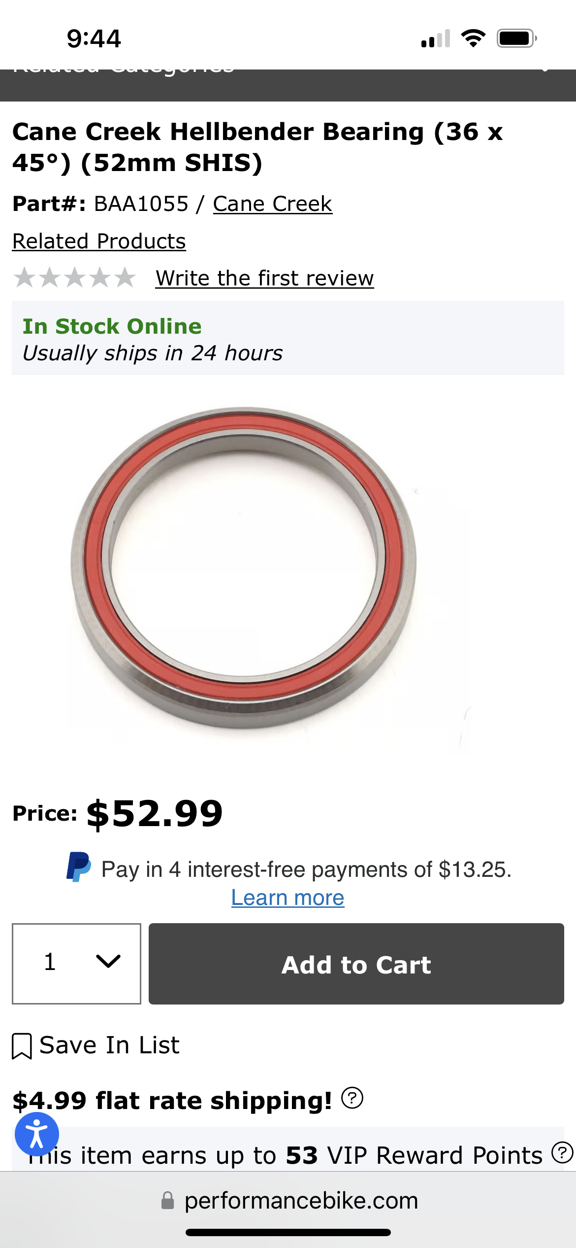

Alex,
Is this a good bearing option if using the boxxer with the cane creek solid steel crown race as shown above? 1B54514B-13DC-4817-B722-7604A123FA08.png A165224B-08A7-47A8-8BBC-5EEA495B0704.png

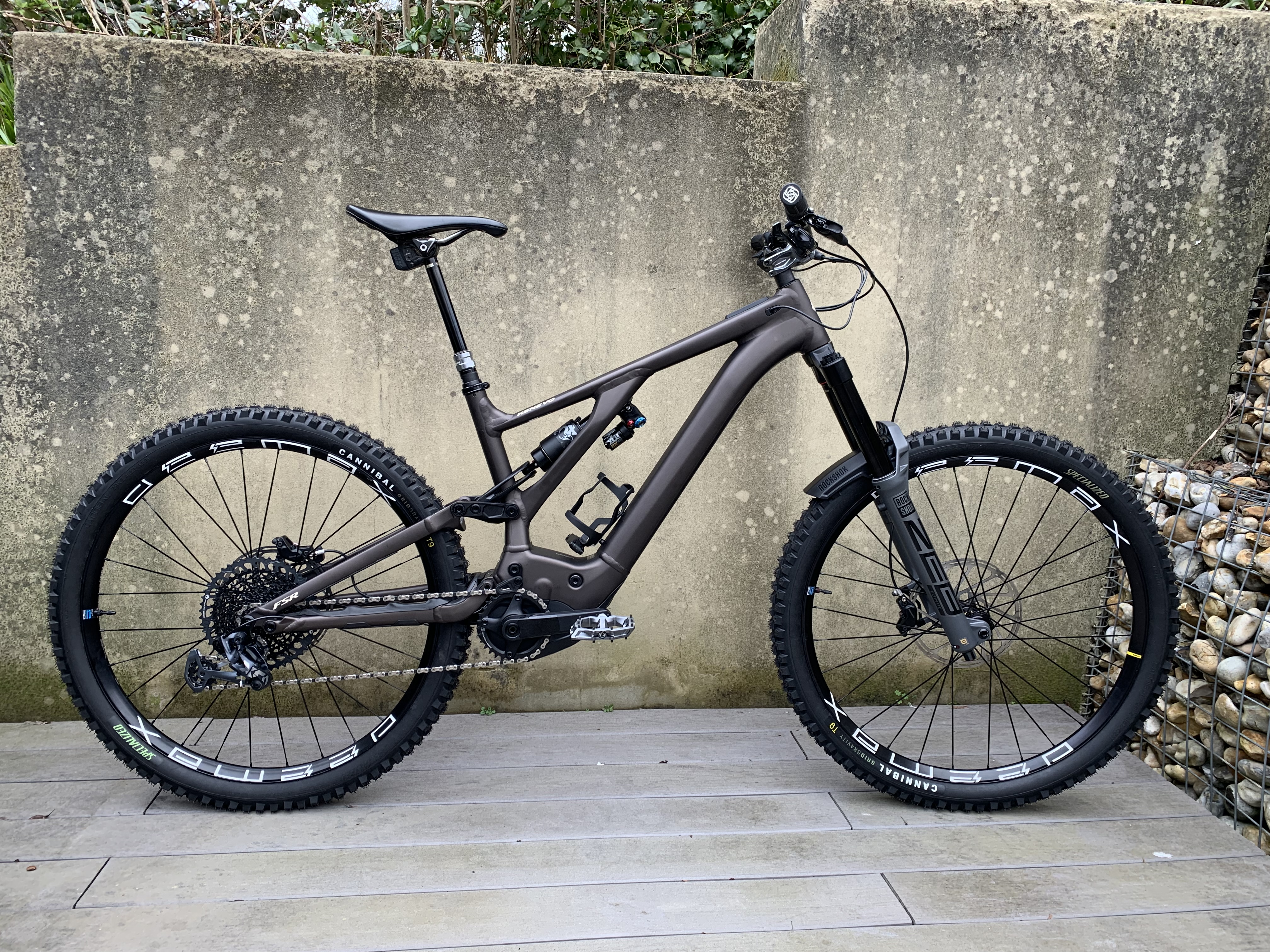

6’2” and 78kg.
Kenevo S5. 2021 Fox x2 shock. 700wa battery in what was a comp version.
Have tested
27/27. with z1 180
29/27 With lyric 170
29/27 With Zeb 180
29/29 with Zeb 180 (Run flip chip high/low and fitted offset bushings to top of shock eyelet)
Running timed runs on local easier DH and hitting technical climbs the best feel was/is the following setup:
zeb 180 29 front
29 rear
Offset bushing
Flip chip low.
This gives me:
HA 63.5
BB 350
SA c. 78
No contact saddle/rear wheel
Running Eliminator 2.4 in rear with plenty clearance
The bike climbs like a goat. Runs anything DH…I bail first. Corner grip is superb.
It’s a 180/180 Levo Turbo now with option to chuck a 27 in back for even slacker/ lower however I find sweet spot for BB height with 180 travel to be 345-350 with sag around 25%.
Just love the covert flexibility of this bike. Plush, sensitive, poppy and 23.5kg with pedals and 700 battery.
I’ve run Spesh for decades now and can’t think of a better geometry, kinematic, feeling and all round bike than this one….and it has a motor.
Think I’ll setup a YouTube channel documenting my project ;-)…mind think Robs rather good at that…
