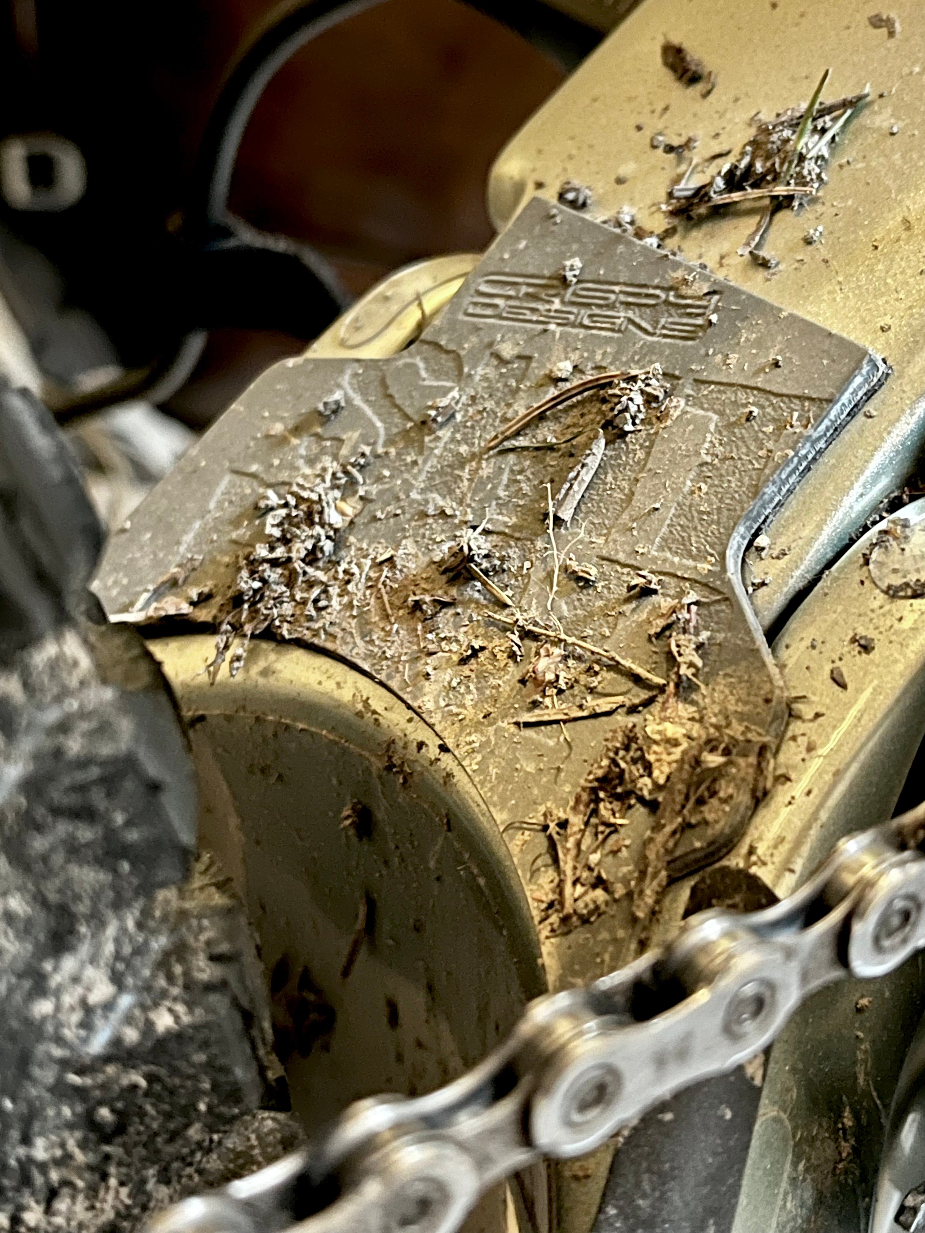

“The Shit Flap”.
Keep mud and rocks out of your suspension crack.
Laser cut from 3mm rubber. Held on with some 3M VHB double sided tape. Nice and soft but should be decent wearing too. I’ll be testing it out this week in Snowdonia

Lol, looks good. Does it adhere to both parts, or just one? I've also been wondering how to keep stuff out of here because my rear mudguard doesn't quite reach down that far.

It just adheres to the section of the main frame. It’s ‘solid’ enough to stay in place throughout the suspension travel/movement. I did wonder about adhering it to both sides but though it’d just pull off on the side that had less adhesion

Yeah, definitely. Are you doing them in black?

At the moment I can only get this mid-grey. But, if they test well I’ll try and source black rubber (I have to use rubber that’s stable and safe to use on a laser cutter).

A couple of rides testing The Shit Flap and it’s a little trooper! Been riding on trails and natural in Snowdonia so lots of loamy mud, slate shards, rocky descents and slop. Done a great job of keeping the poop out. The rubber seems to have a hydrophobic quality so a lot of the slop and mud doesn’t seem to stick.
A couple more rides to test the 3M VHB tape holds up then all being well I’ll make a short run of them and make them available on my site.

How's the shi*t flap holding up?!
The Shit Flap is a little trooper. Holding up very well. It’s done a great job at keeping the poop, mud, loam, rocks, stones and other unwanted items out.
I’ll definitely be making a short run of them when I’m back.
