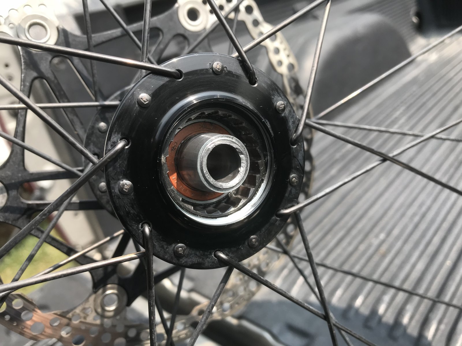

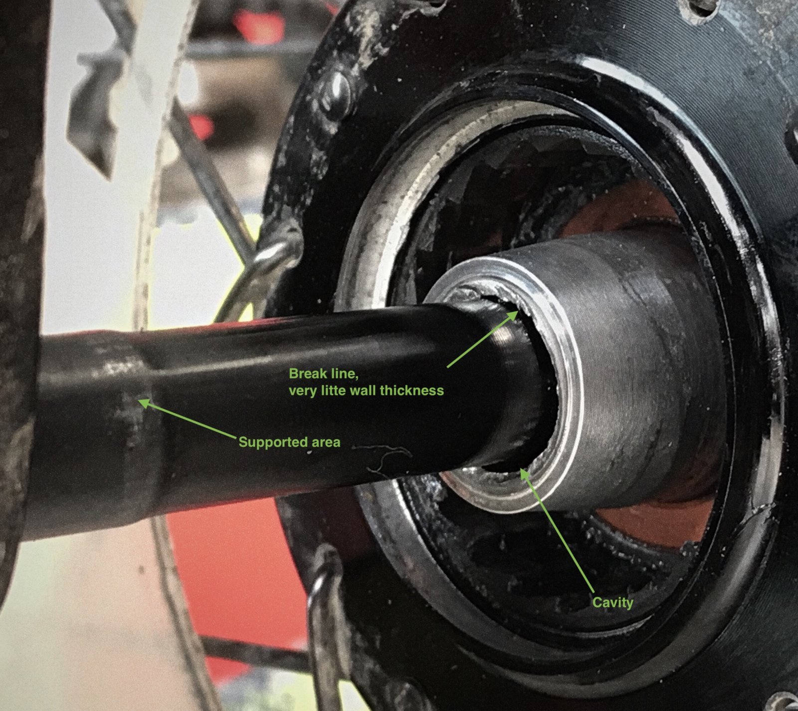

Broken Axle - Alternative options?
Discovered my rear axle was broken when the free hub and cluster fell on the ground upon removing the wheel, the retaining shaft has a waist along most of it's length so where the middle bearing sits there is no support given by the pin. Wondering if Kenevo's have a more robust solution as I'm sure it will happen again.
Anyone else experienced this?
Regards Gyro

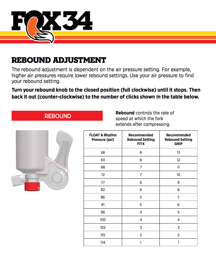

I seem to have about 22 clicks of rebound dampening on the FOX 34 Rhythms on my 2019 Comp Carbon Levo. I presume this isn’t right, anyone else had a similar issue?
  • Like
Why do you "presume this isn't right"? IIRC, 22 clicks is standard for that damper.
Here's a rough guide to settings Fox recommends (I prefer more damping) -

I must be missing something, the table shows 13 clicks for the GRIP dampener?
They didn’t bother suggesting damper openings 14-22 for even lower air pressures, but you should get the idea.
Sorry mate but you’re confusing the hell out of me. All my other Fox products across three different bikes have a predictable number of rebound dampening clicks consistent with the manual except the Levo forks which has far too many suggesting a hardware issue. Has anyone experienced similar?
