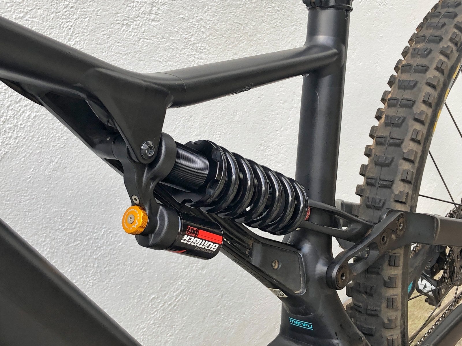

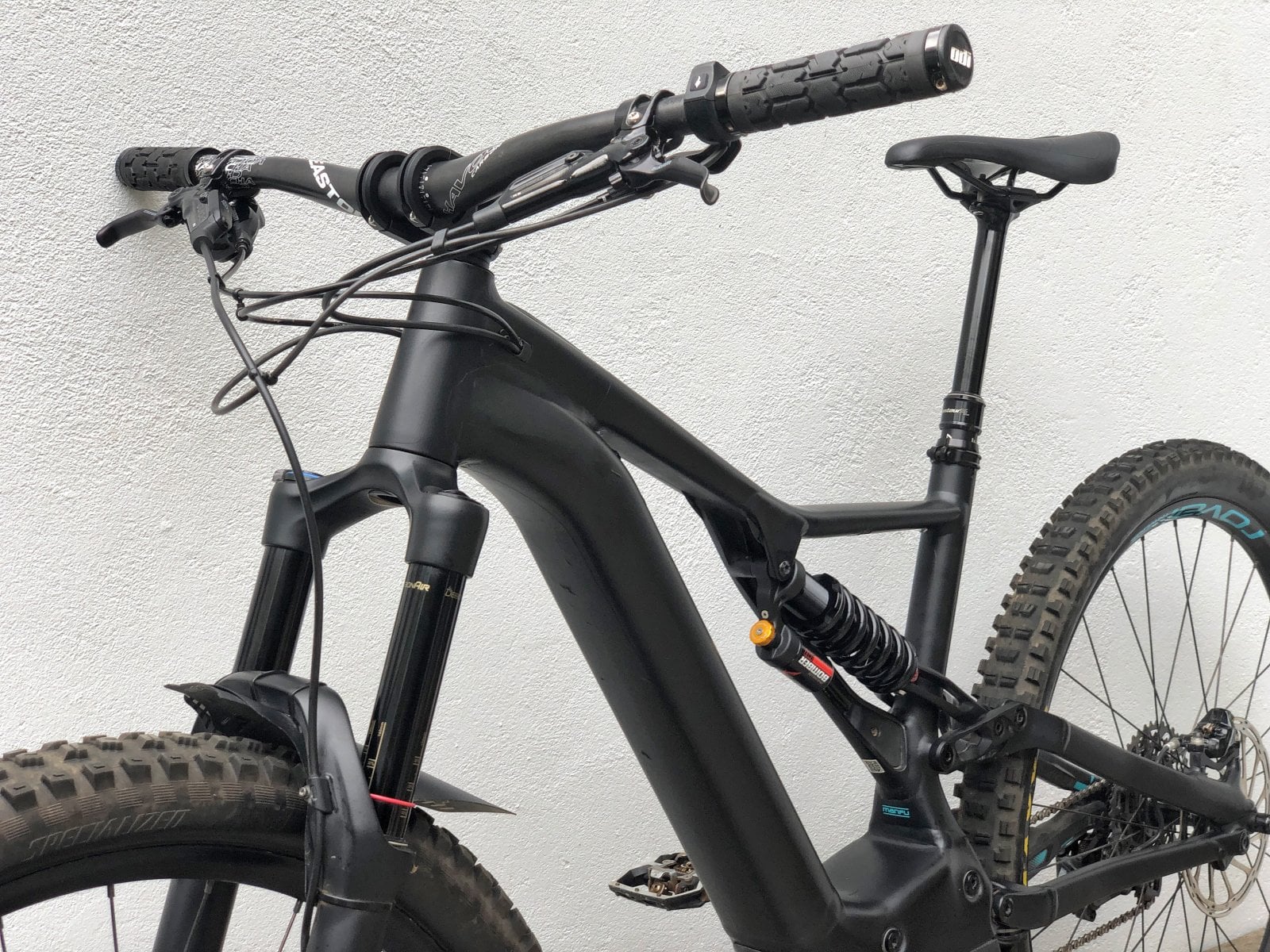

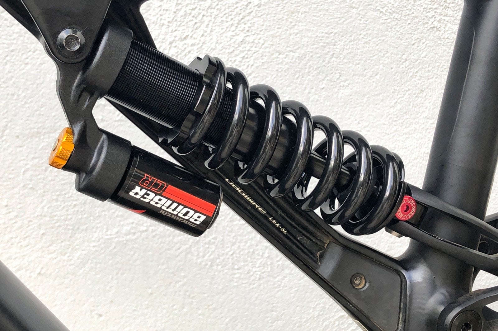

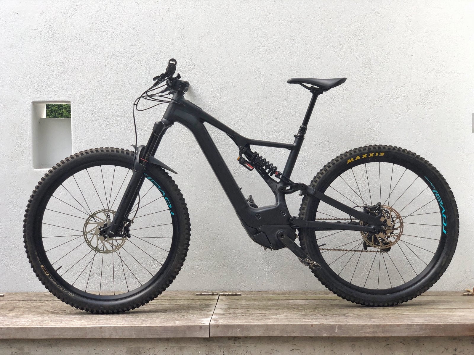

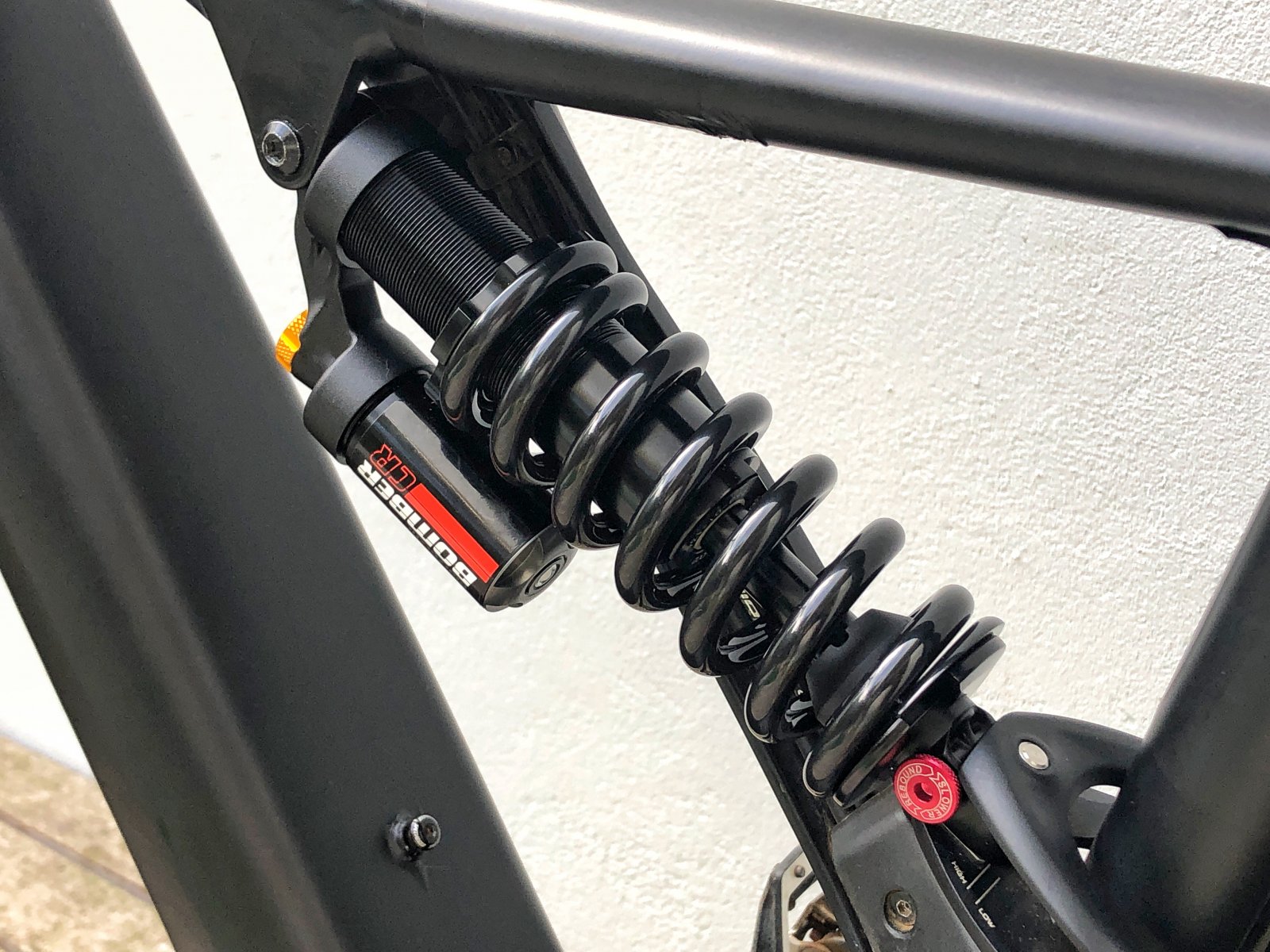

Hi,
Anyone have this in order? Marzocchi Returns To Rear Shocks. Affordable Shocks From This Legendary Company. - Singletrack Magazine Looking forward for a review with this Coil Shock on a 2019 Levo. Know there were some shaft issues with CC... Hope this one does not have that issue.
Marzocchi Bomber CR 210x55
lookhear
Sep 18, 2018
39
55
Cape Town
Looks good! How do you feel over the oem shock? I'm thinking about tha Fox DHX2 2pos, because of the infinite adjusment, and the lock option.
I read about the Marzo... Price is excellent!
OEM shock is an air shock. Coil and air are two different animals. Coil is buttery and plush compared to the OEM. Small bumps don’t exist on a coil. Corners feel better and big jumps much more linear. I prefer the coil. So far.
The Fox DHX2 is the better shock. Same spring for both. Can use either the more expensive (Orange) Fox springs or the cheaper (Black) Fox ones sold with the Marzocchi (they’re pretty much the same just a big weight difference)
More adjustments on the Fox. I never lock any shock out and prefer a set and go approach so the Marzocchi works great.
If money doesn’t matter go for the Fox DHX2.
lookhear
Sep 18, 2018
39
55
Cape Town
Nice!! Did you reuse the shock HW (bushing,plastic parts, spacer) from the airshock? Does the rubber touch the frame when fully compressed?
Looks REALLY GREAT!
Sent a direct message regarding bushings.
Forgot to add that the rubber doesn't touch the frame. Plenty of clearance when fully compressed - tested before installing the coil.
And since then I've jumped off some biggish drops and all's good.
