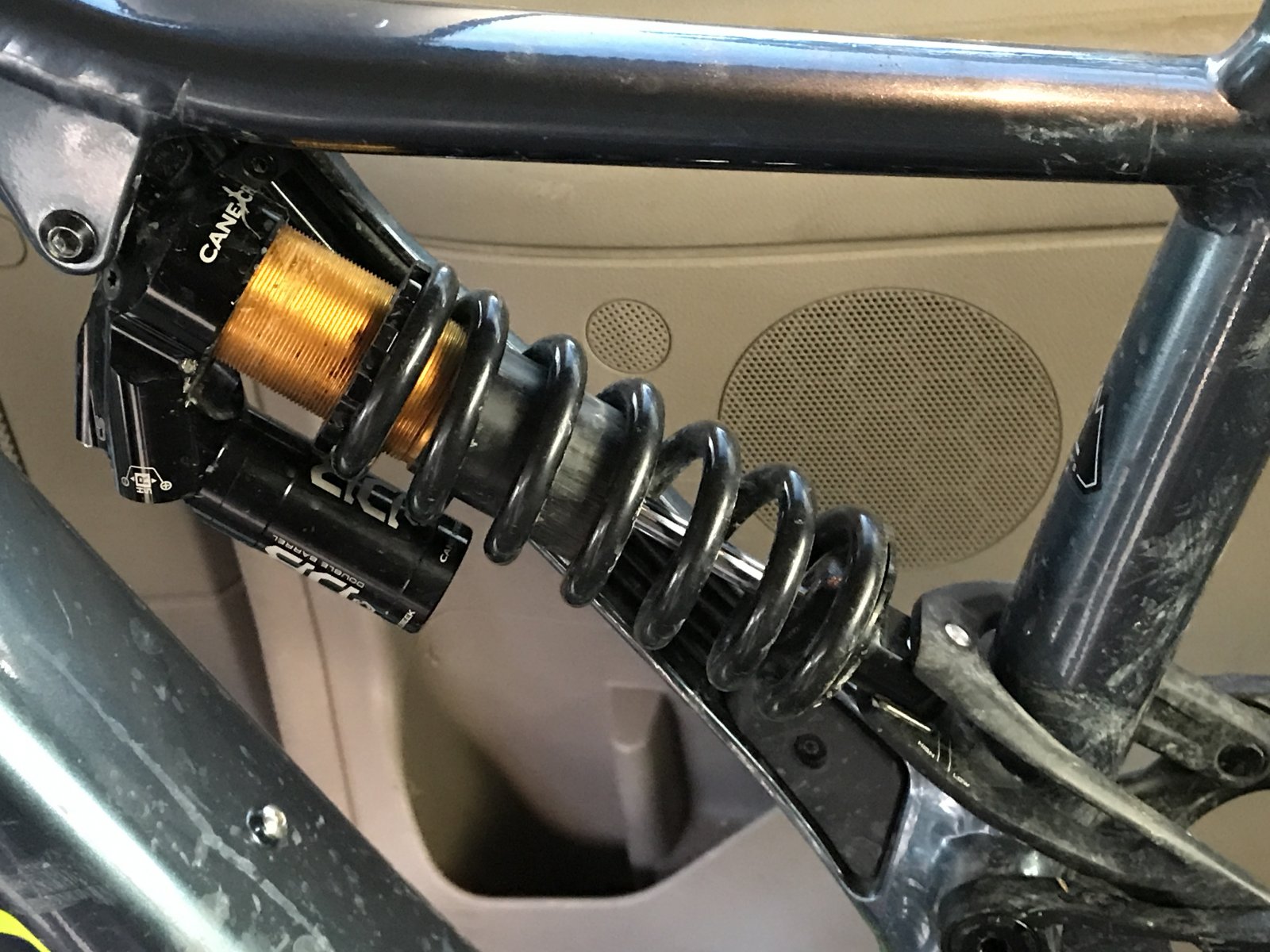

Fitted this the week before Christmas. However....... got a call from TF tuned saying..... Cane Creek have been in touch with them and have said that they do not recommend that you put a DB IL Coil on your 2019 Levo or 2019 Stumpjumper as they are worried the shaft of the shock may snap near the rear eyelet due to the increased leverage force created by the yoke.
So..... I am sending the shock back to TF Tuned who are happy to give me a refund and we are working on 'other' possible options.
It is a real shame as I have been for 3 rides with the new coil shock on and compared to the standard air shock the new coil shock in my opinion is far superior especially on the terrain I ride :cry::cry::cry::cry::cry:

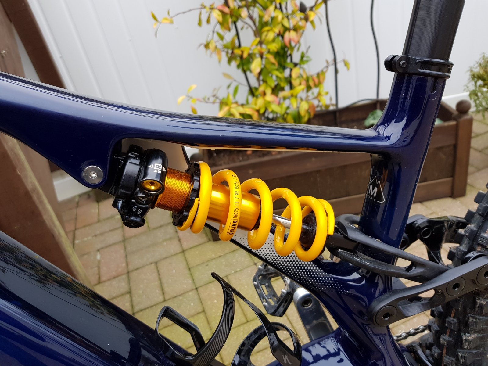

I spoke I to TF tuned yesterday and have ordered an Öhlins TTX M22 series 14 metric for my 19 Levo. It’s the right size so should fit perfectly. I will ask them about ny sort of issues with stroke/shaft worries when it comes in. I have been disappointed with the stock air shock. Can’t believe they spec such a low end shock with a bike that retails for over 7k.
Having said that, I have been tweaking with it recently and today at bike park wales it did perform slightly better than before. It’s not bottoming out so much which is a good think.

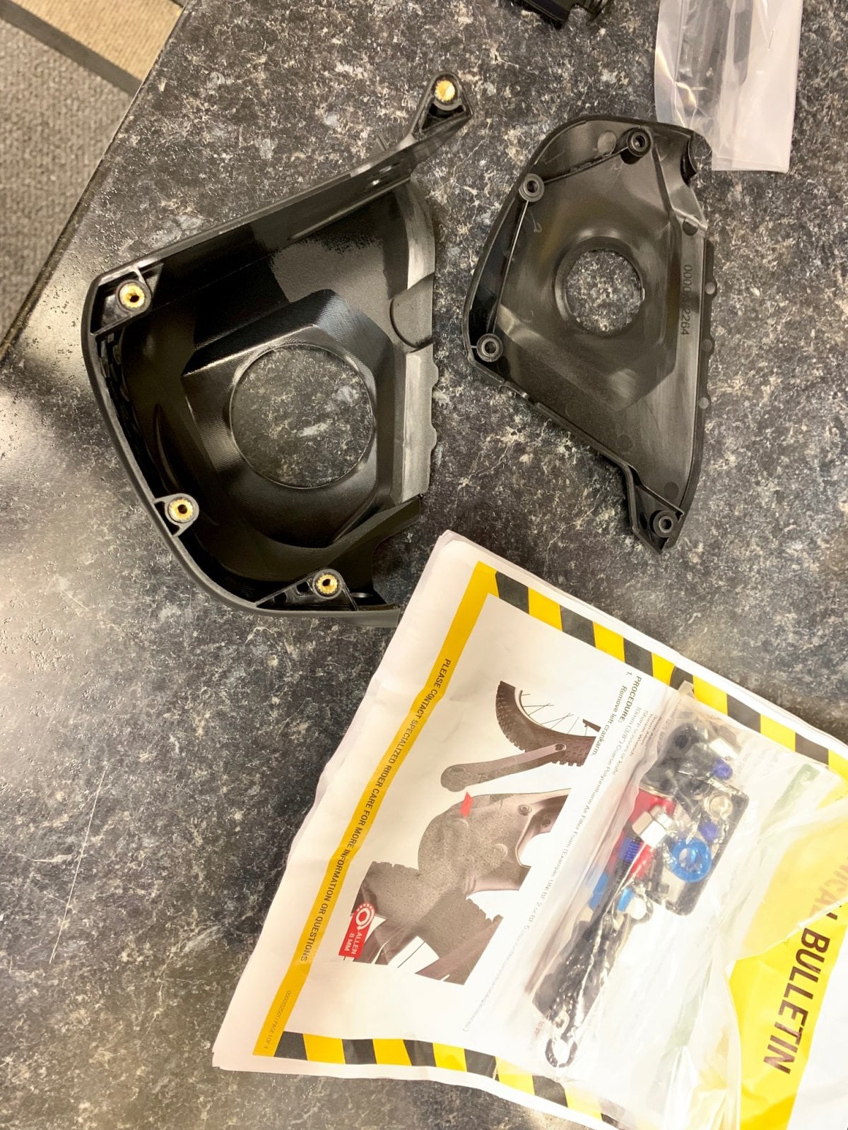

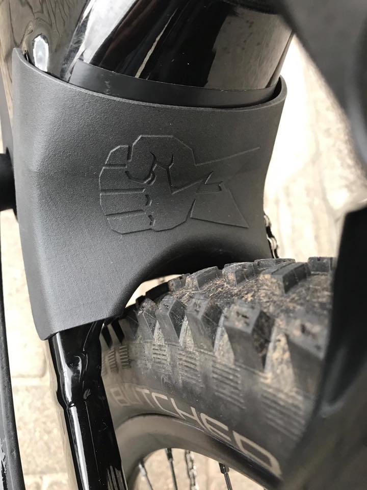

Finally arrived today from my ( oversea's ) LBS ! Easy install and finally acceptable. I have now switched from my " Shit Lip " which performed perfectly to a adhesive inner tube strip as suggested on this forum for better aesthetics. View attachment 9303 View attachment 9304 View attachment 9305
Wait, what are we looking at here??? New 4 bolt cover? And this still requires a home mod to prevent any crud intake? I'm confused, what have you been shipped, by who and for what purpose?

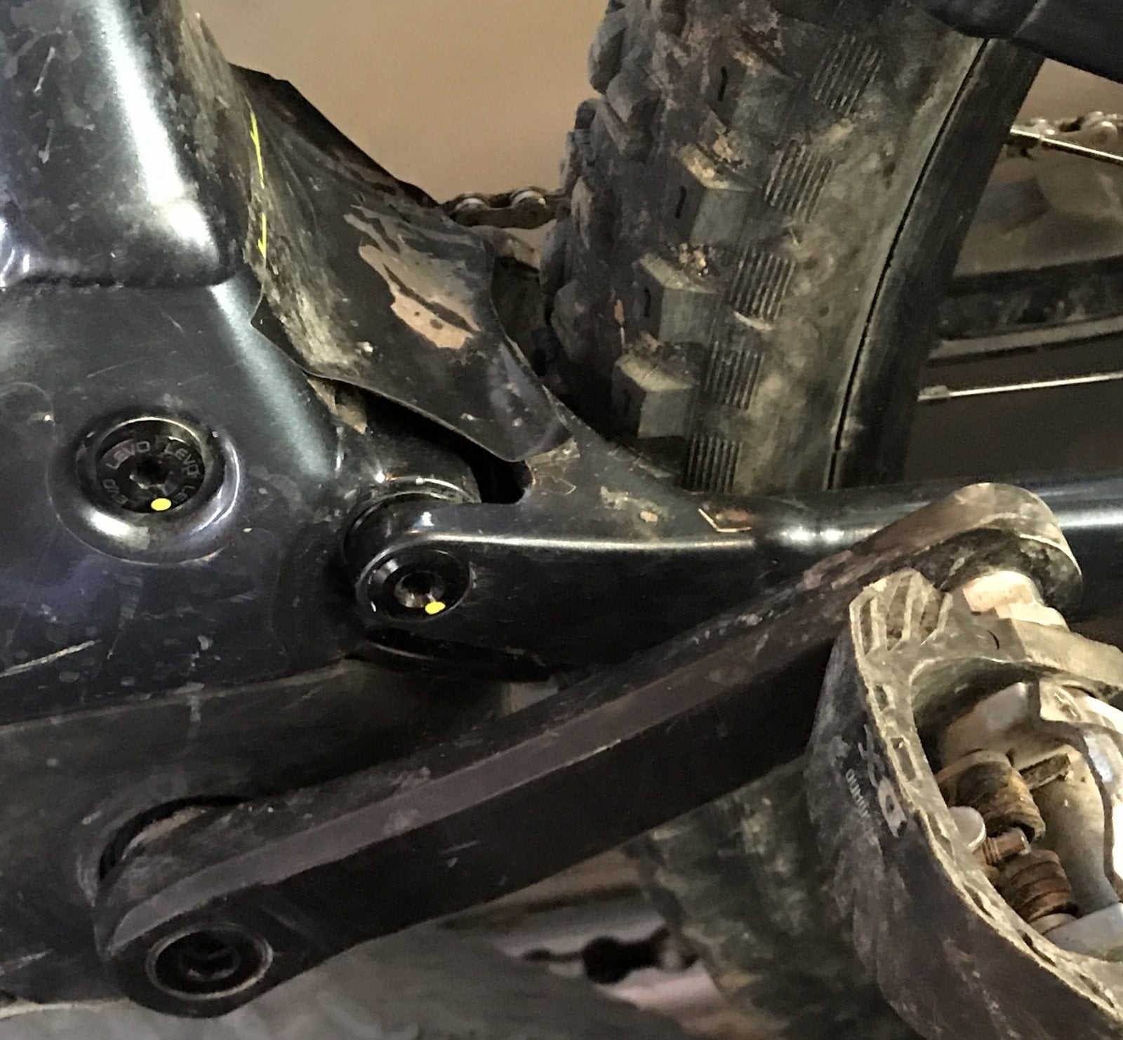

Hi there,
Looks like I may have the same issue, I've just fitted a CC also with a 550lb spring, running max hi speed rebound damping to keep the the bike from bucking on rough downhills.
Getting about 165mm travel, paired with 180mm Lyrik forks makes for a great ride.
Also a strip of PVC tape to keep the crap out of the motor housing as pictured, due for replacement.
Other changes include 160mm KTM cranks 155mm raised the cadence too much and outside the motors sweetspot.
SRAM EX1 8 Speed & CushCore inserts.
Rockguardz motor protector, which I've added an extra 2.5mm of glassfibre to the area under the motor as being Carbon I broke it second time out.
Painted dots in all fastenings to monitor any loosening, which is not infrequent.

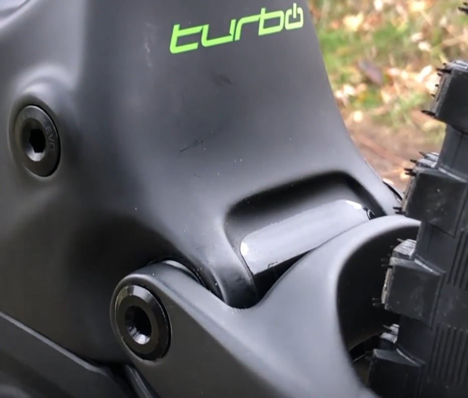

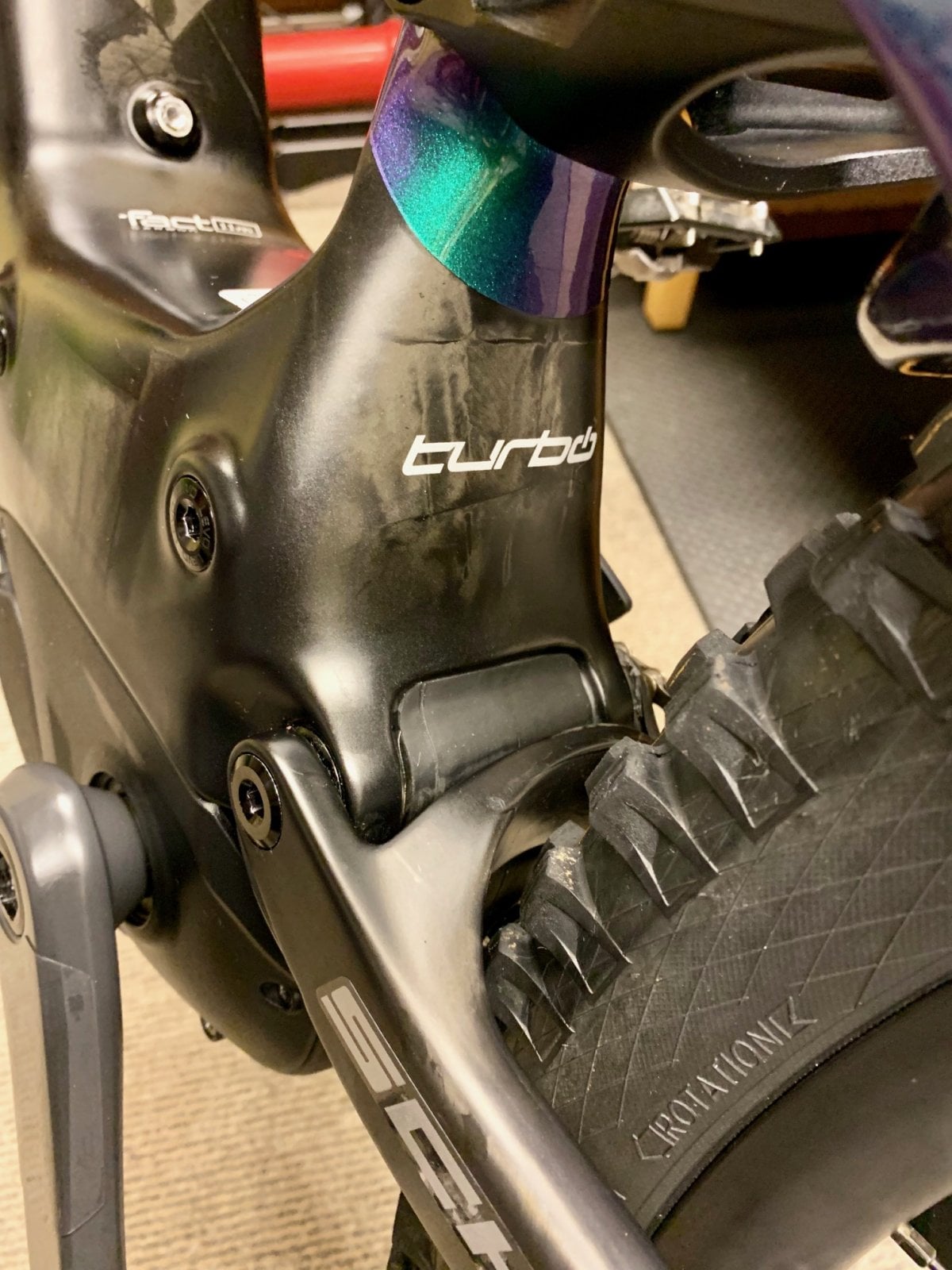

I think I have spotted the new fix at 37sec into this YouTube video.
I plastic film to cover the hole :unsure:
If you look very closely at any 2019 Levo you will find that the plastic film pictured is actually already fitted on your bike.
It just shows up more on the Matt coloured carbon frame of this Expert.
All it is, is some frame protection between the frame and the rear triangle as the gap between the two is very tight in this location ?

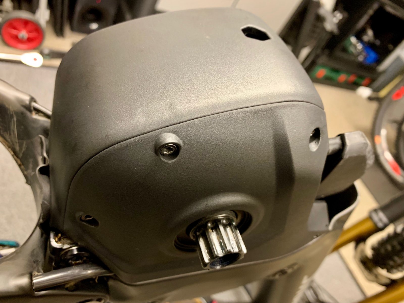

Thanks Bend & Specialized Rider Care- the rubber washer also fell out of my bike when I took the battery out and I've been perplexed since trying to find where it came from!! worries are now over..
Regarding the mud build up from the back wheel- that does concern me. Are Specialized looking to provide a specific clip on guard?

Hi,
165mm travel in the rear? Don’t you have any collisions from tire or any other interfering parts?
Gyro
Jan 5, 2019
37
19
Auckland NZ
Hi,
Surprisingly not, about 1.5mm clearance between the yolk and seat tube on it's high position. Bottom bracket is about 20mm higher than stock, still catch it from time to time hence the rock guard.

For the fun of it I just checked my 2018 Levo Comp carbon for dirt behind the plastic covers and it seems like it is far better designed than the 2019 model. This is after 500 km of riding in wet muddy forest and loose sand trails:
The 2019 is for sure a big step back design vice.
