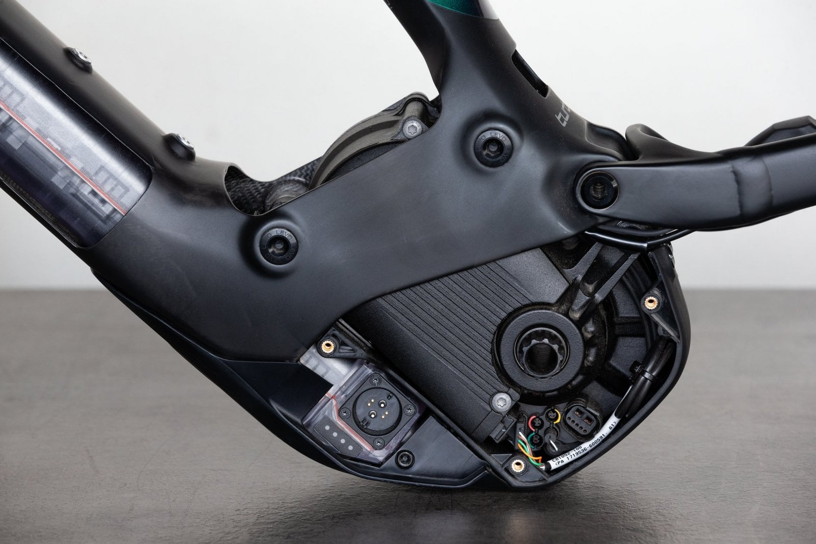

Hi Stephen,
I can imagine that you will not be happy when buying an VERY expensive s-works and getting this kind of "do it yourself" dealer support. I am really questioning myself if you would inform Specialized about this way of warranty handling by your dealer if they would accept it and keep such a dealership alive.
But anyway if you search the forum on Specialized Rider Care you will find posts where they explained the new 4 bolt motor cover. According to Specialized, if I remember well, it wasn't a big deal (motor needs to be removed completely from the bike to fit the new cover design. So they only changed the cover once you had a faulty motor. I was "lucky" to be in this position.
I am not sure if you read my post:
My Levo 2019 review of a critical owner and summarize until today - EMTB Forums
Here you will find a link which a really very easy "do it yourself" fix by cutting out a very small piece of inner tube and mount that over the gap on the outside. (where the sponge will be on the inside) I have ridden the bike in very muddy conditions with the sponge on the inside and the rubber flap on the outside. It worked great and no one will notice it as well. It looks like factory made.

Hi Stephen,
Hallo Maastricht ,
Yes , I have read your mentioned post and have made and installed the inner tube rubber cover and as you say , it looks very good and works well . Thank you .

Finally arrived today from my ( oversea's ) LBS ! Easy install and finally acceptable. I have now switched from my " Shit Lip " which performed perfectly to a adhesive inner tube strip as suggested on this forum for better aesthetics. View attachment 9303 View attachment 9304 View attachment 9305
Highflyer - so it looks like the revised motor housing is stiffer and fixes the gap(s) between the two halves of the housing but there is still the gap at the back that requires a homemade fix?Someone else asked if this gap could be there to assist with motor cooling so I wonder if that is the case? Otherwise, why wouldn't Specialized have sorted the famous design fault gap with the new housing???

Highflyer - so it looks like the revised motor housing is stiffer and fixes the gap(s) between the two halves of the housing but there is still the gap at the back that requires a homemade fix? Someone else asked if this gap could be there to assist with motor cooling so I wonder if that is the case? ...
Whilst monitoring motor temperature and (when needed) limiting motor power to protect against overheating is a good idea, relying on that feature is not.
As a user, it's no good having 90nm torque capable motor limited to say 50nm due to overheating.
As an engineer, I'm more concerned about having electrical connectors in a constantly wet environment. I believe the hole is there for both cooling and to allow it to dry out.
The sponge is going to ensure area inside motor casing stays damp for a very long time. I think likely to cause problems within the 2 year warranty period. :unsure:
... Otherwise, why wouldn't Specialized have sorted the famous design fault gap with the new housing???
Totally agree. The cheapest satisfactory solution would be a change to the motor cover design. Either change the back end of the cover so that it's a deflector slope rather than a catch scoop. Or remove the cover almost entirely, ie. a small enclose (on left side) to cover the electrics only, with a small extension underneath to act as a bash plate; with an elastomer backing (between plastic bash plate and motor).
Thanks for the reply Indigo - all makes sense
I'll probably continue with a bit of black duct tape across the frame / chain stay bridge gap. Not fancy but very effective. Or I will fit something like the now famous Sh*t Lip solution that lays across the top of the chain stay bridge. These solutions stop wet mud and crap getting thrown into the motor housing and also keep small stones and sharp stuff from sticking in the gap where suspension movement could cause them to damage the frame / rear triangle. The bit of helitape stuck to the frame will not protect against flints! There is still a small gap between the underside of the chain stay bridge and the casing but nothing gets thrown into there off the wheel and a small piece of sponge in there will not do any harm
The other inner tube solution that glues inside the frame rebate then passes down through the gap looks much neater but will still allow small stones to lodge in the gap.

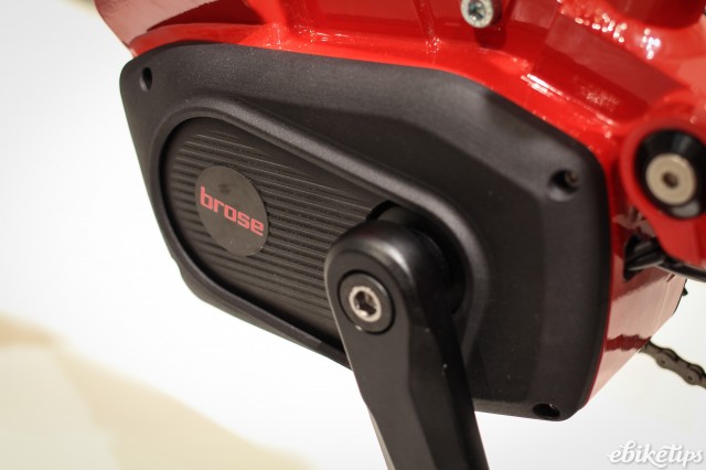

Could you fit the cover that come on other Brose Mag S motors under the Specialized covers?
ccrdave
Jan 16, 2018
1,421
1,125
uk
no dont think so on the spesh bike the motor angle is different and half of it is inside the frame so the covers only cover the bottom half so to speak
Dear all,
The new complete lower motor casing ( two halves ) ONLY addresses the 4th bolt hole.

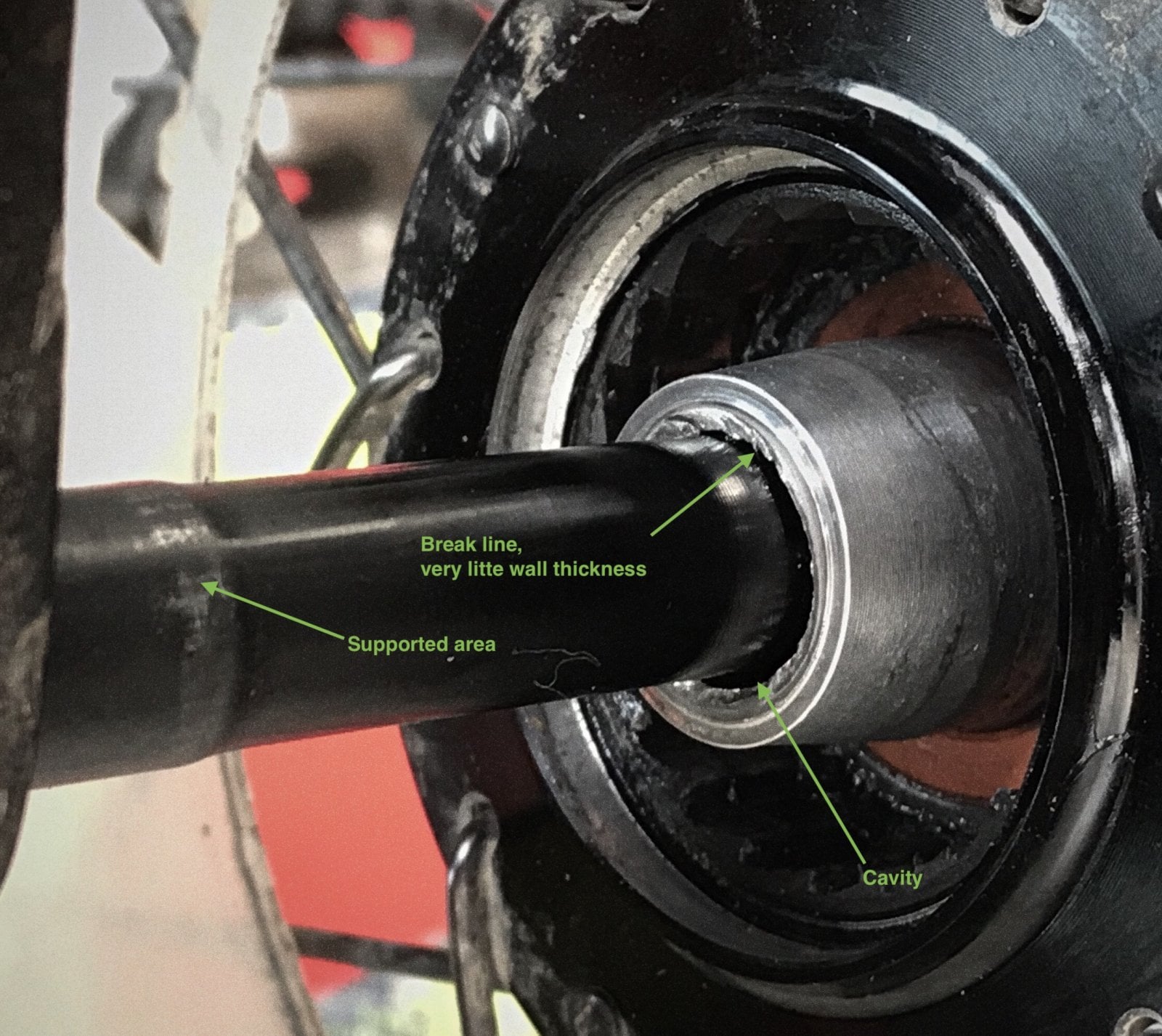

Broken Axle - Alternative options?
Discovered my rear axle was broken when the free hub and cluster fell on the ground upon removing the wheel, the retaining shaft has a waist along most of it's length so where the middle bearing sits there is no support given by the pin. Wondering if Kenevo's have a more robust solution as I'm sure it will happen again.
Anyone else experienced this?
Regards Gyro

Hunter-m-j
Jan 13, 2019
12
Hi there,
Looks like I may have the same issue, I've just fitted a CC also with a 550lb spring, running max hi speed rebound damping to keep the the bike from bucking on rough downhills.
Getting about 165mm travel, paired with 180mm Lyrik forks makes for a great ride.
