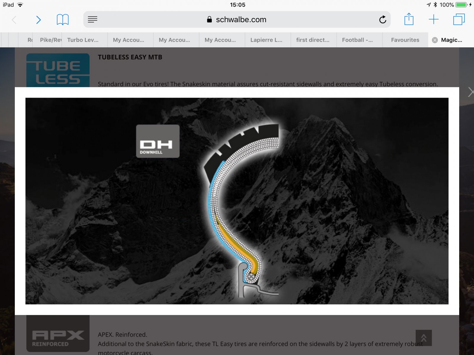

The below screen shot is why I run MM 2.6 Wire bead non folding Apex Addix Ultrasofts.
Oh, and the immense grip and believe it or not, long life and resistance to cuts/slices unlike what I have very recently experienced with the MM 2.8 Apex Addis Soft compound folding versions.
I have these on for most of the year and the only issue I have had with them is they don’t like wet clay based soils as it tends to clog them up. I have an easy fix for this issue. I have two sets of other wheels.
