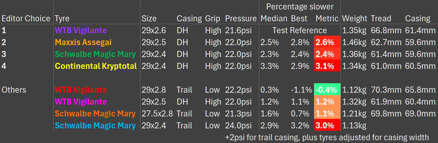

Tldr spoiler:
I did A-B-A testing on each day aiming to get in 5 quality laps before swapping tyre, then 5 laps, swapping back again and another 5 laps.
Timing was done by picking the exact GoPro frame where I crossed a specific feature on the trail, e.g. tree, rock, post etc so that I could get accurate timing to 1/60th sec and construct a perfect lap taking the best from each sector.
The results often surprised me and I think "feel" can be misleading. The Assegai for example felt epic, but in the data it is slower in every sector.
View attachment 153444 View attachment 153445

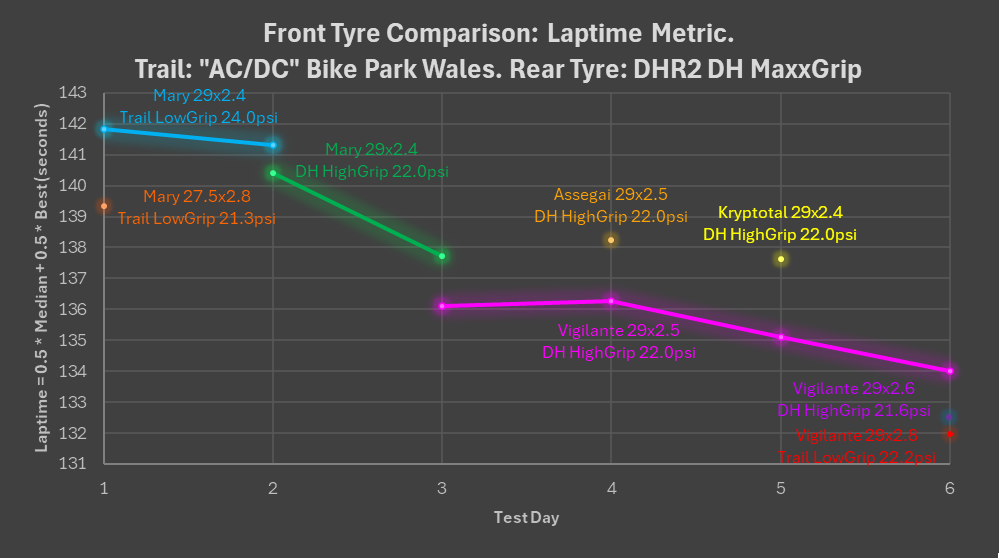

The trend in the chart above strongly suggests that you simply got faster riding the same track for 6 days in a row.
Even on the same tire, your pace improves day over day. Unfortunately, since tire/day was not a controlled variable, I tend to think that the "slow" tires would have been "fast" tires (or at least mid-pack), had you tested them on day 6 rather than day 1.
Hi, yep for sure I got a lot quicker, and I can't pretend that there aren't dozens of flaws in my testing.
The reason I stuck to the A-B-A format on each day is so that I could get a fair compare of two tyres when I'm riding a similar pace in similar weather. The summary table is based on deltas from each test day, not directly comparing day 1 with day 6. It is a bit iffy adding these deltas to compare say Mary Vs Assegai when all I have is a common baseline of Mary Vs Vigi and Assegai Vs Vigi on another day.
However, I think there are some reasonable conclusions and that is that Mary, Assegai and Kryptotal are similar pace (when compared to Vigi on their respective days) and the noise doesn't allow me to pick a clear winner, even though I preferred Assegai for confidence and Conti least for harsh ride.
Vigi kicked ass because it managed to stay on as test winner. I also analysed sector times to see that it was rolling resistance where this tyre has a consistent advantage in the flatter sections.
Plus sized tyres are fast but hard to control with high standard deviation.
Low grip compounds and thin casings are challenging.
However, these conclusions could be wrong... there is a reason why randomised drug trials cost millions of pounds! Tyre testing is a tricky subject and I'm sure there will be some surprises along the way, but I wanted to at least attempt it because I'm tired of sponsored riders telling me to buy a tyre without even comparing it to the alternatives.
Next up is Albert Vs Assegai, and I've got another battery on order so hopefully I can get even more runs on this in a day.
