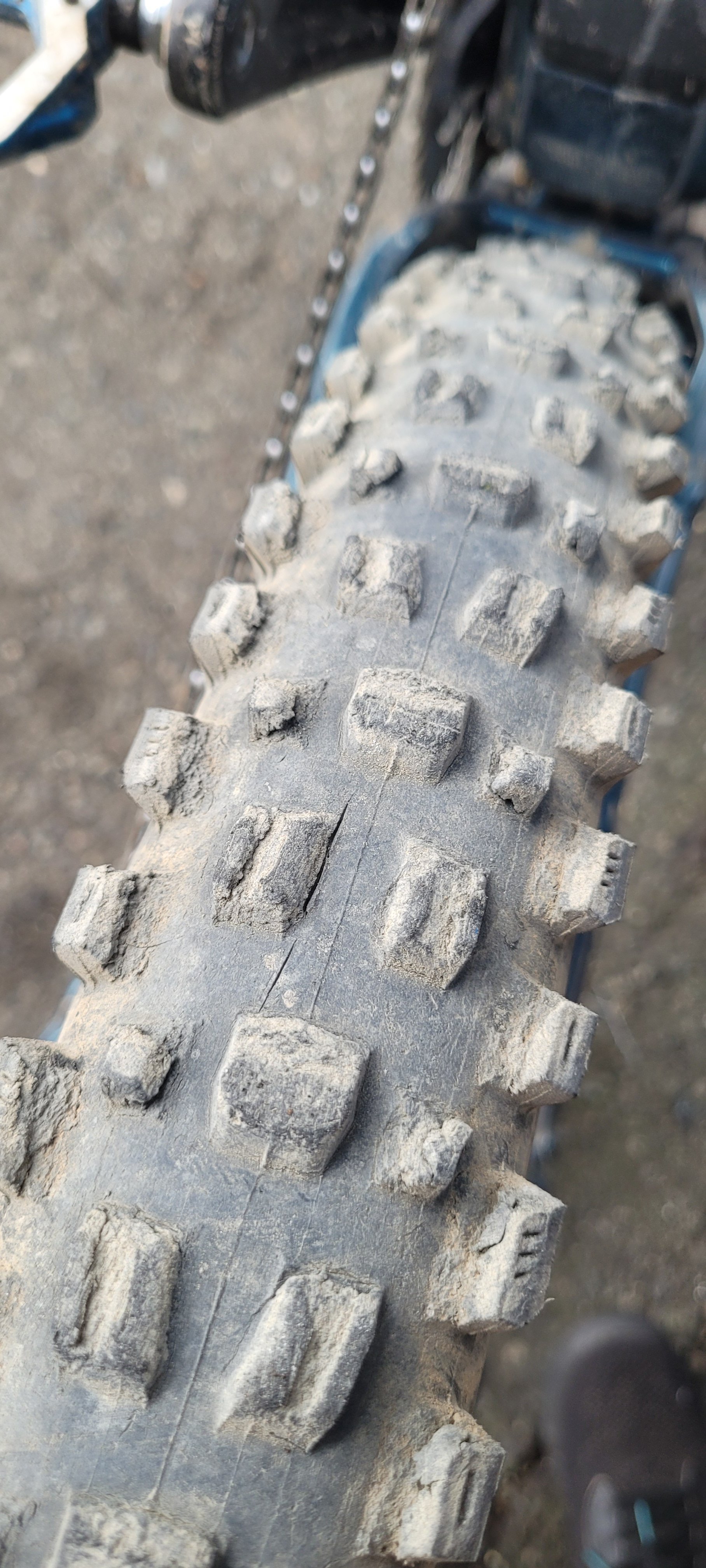

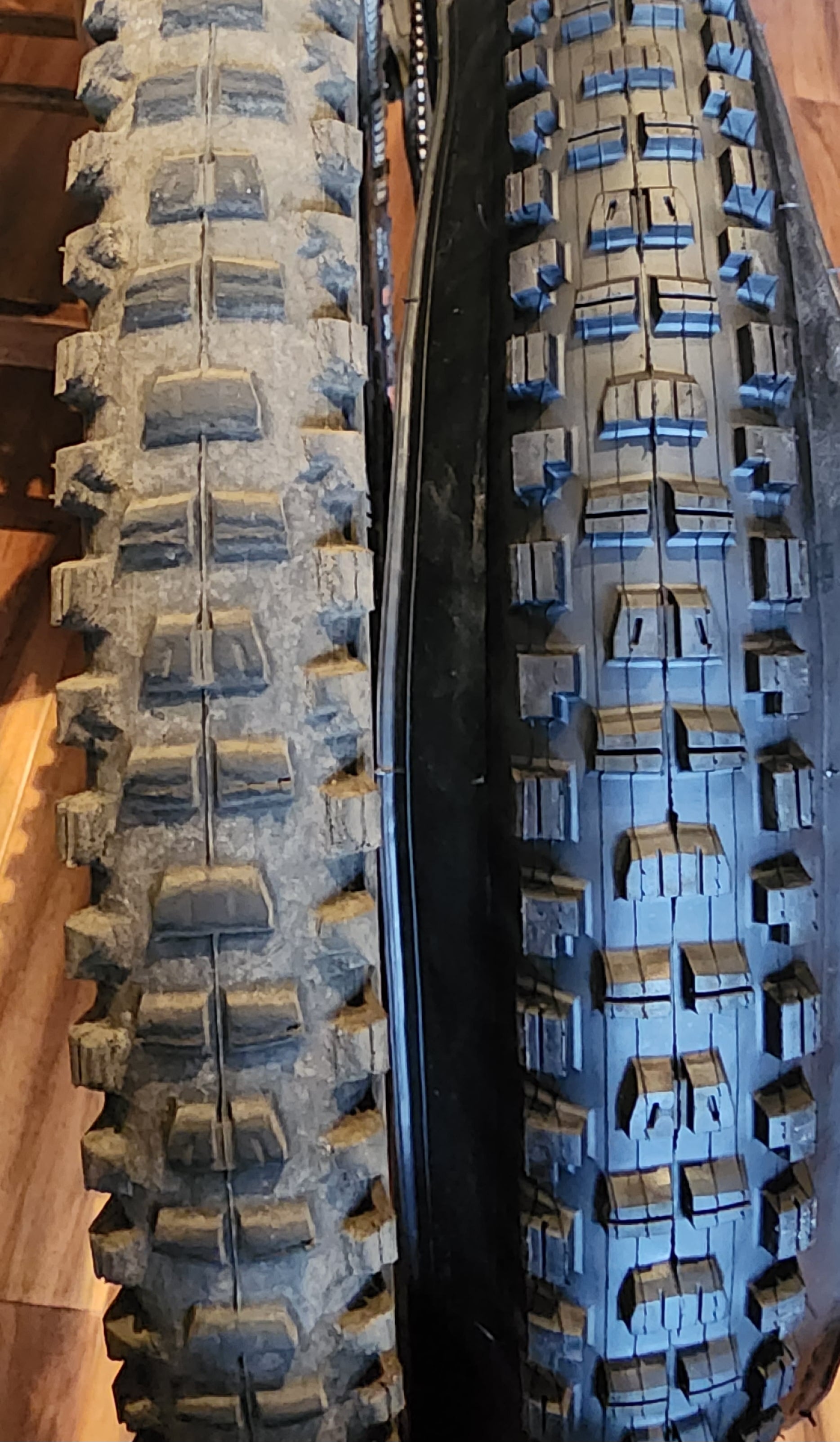

I finally went to 29x2.6 Muddy Mary front and a 27.5x2.8 Muddy Mary rear. It is a game changer. Our trails are super dry and dusty right now, but we have super gnarly rock sections. I beat a ton of my Strava climb and downhill times today on a ride I do 10-15 times a year. Its a 20 mile loop with almost 5000ft vert. I have run a Maxxis DHF Minion 29x2.6 front and a Maxxis Highroller 27.5x3.0 rear on my last 5 Levos. I will never go back unless these Magic Marys start ripping knobs off or get sidewall slashes.

I finally went to 29x2.6 Muddy Mary front and a 27.5x2.8 Muddy Mary rear. It is a game changer. Our trails are super try and dusty right now, but we have super gnarly rock sections. I beat a ton of my Strava climb and downhill times today on a ride I do 10-15 times a year. Its a 20 mile loop with almost 5000ft vert. I have run a Maxxis DHF Minion 29x2.6 front and a Maxxis Highroller 27.5x3.0 rear on my last 5 Levos. I will never go back unless these Magic Marys start ripping knobs off or get sidewall slashes.
View attachment 123558 View attachment 123559
I’ve come from a 27.5 2.8 plus bike and I really dislike how skinny a 2.5 assegai and a 2.4 minion dhr feel so looking for something a bit bigger to remove some of the trail chatter. Haven’t used magic Mary for well over 6 years but used to love them so a 2.6 front and rear is quite tempting. (Mullet setup now ) I’m having to run the pressures much higher than I’d like to stop rim dings because there is very little volume there. Also doesn’t allow me to get the nice supple feel im used to so even though my travel has increased I feel like I have less than before

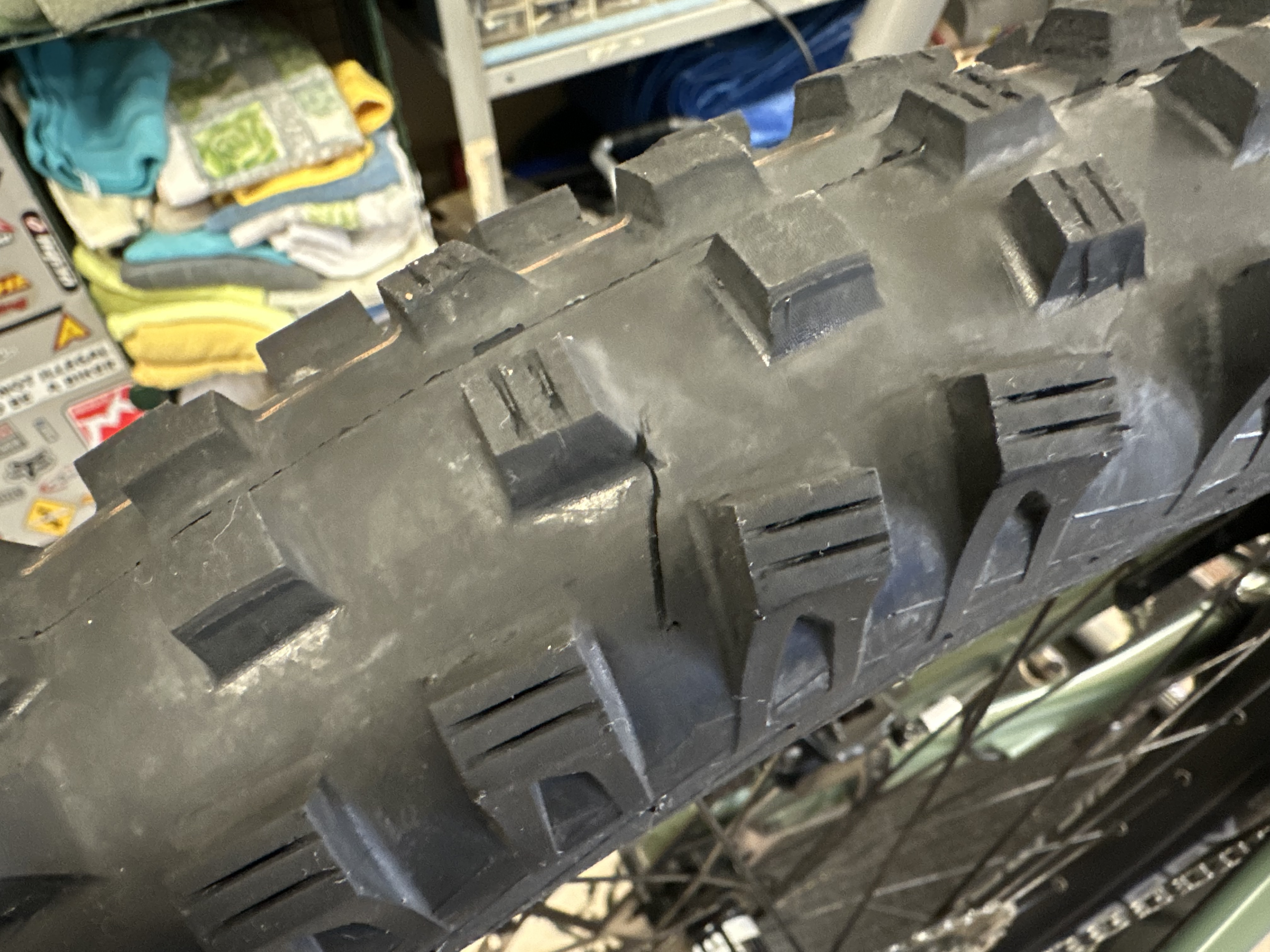

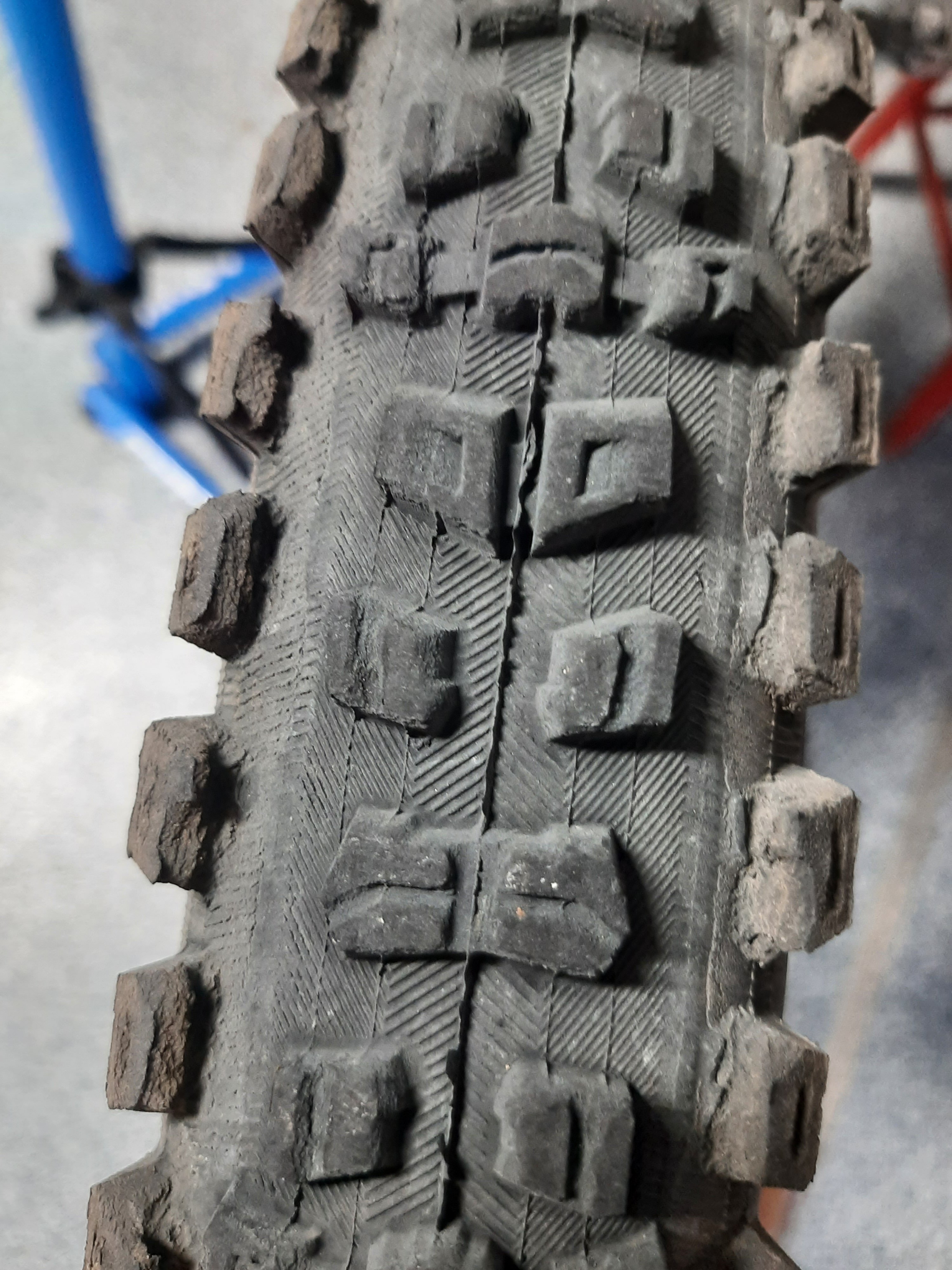

Dang it. I really love these tires. Two rides and now this. Maybe it was just a fluke, but it was 2 big rides with lots of vert and rocks. Ill keep riding them and see what happens.

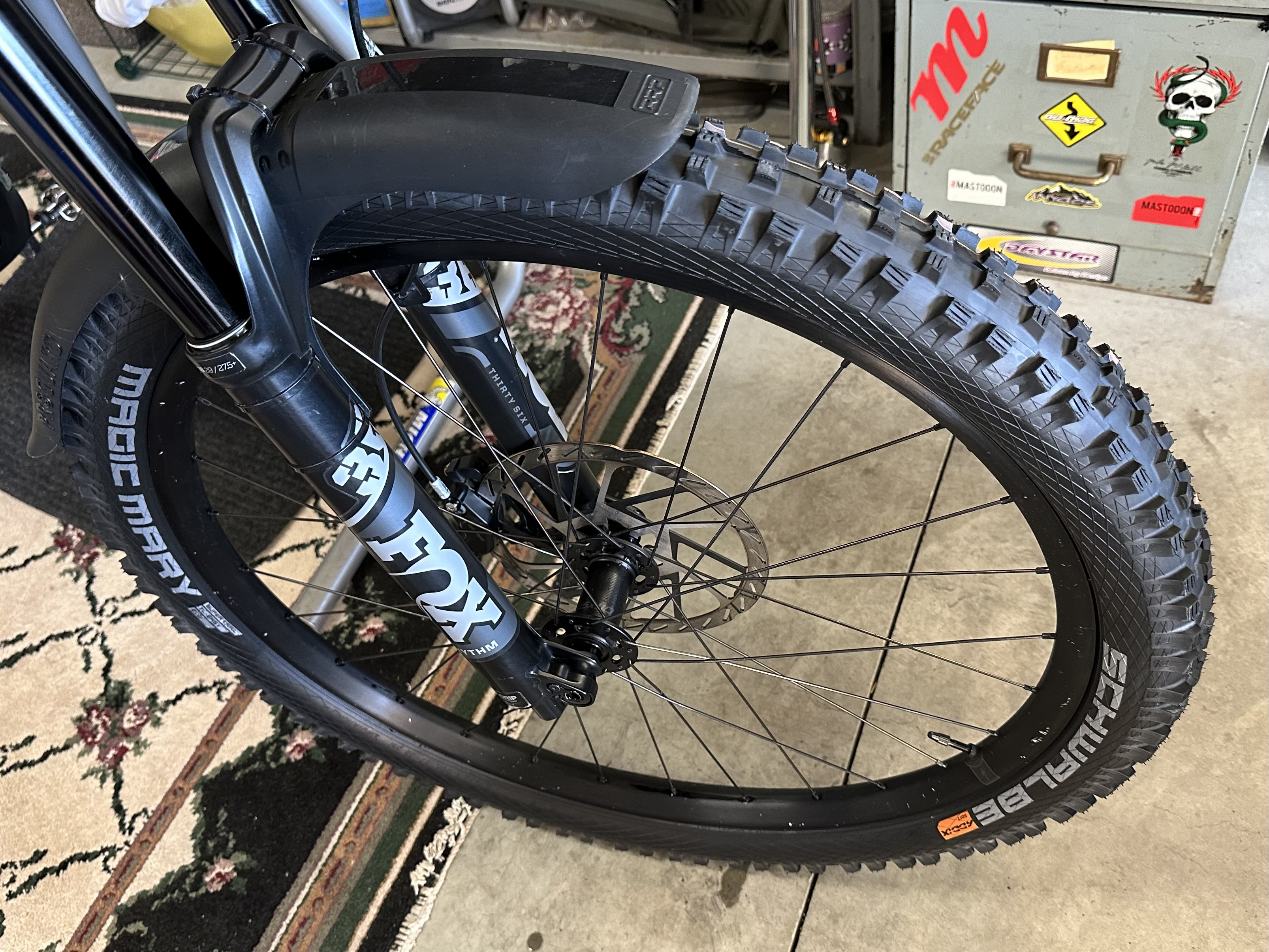

Next up is a Vittoria Martello. I was hoping to hold off until I had my new suspension but can't wait any longer. View attachment 124545 2.6.
I like the Martello, but wears out quickly. I’ve got 4 rides on one right now and it looks worse than your aggressor.
