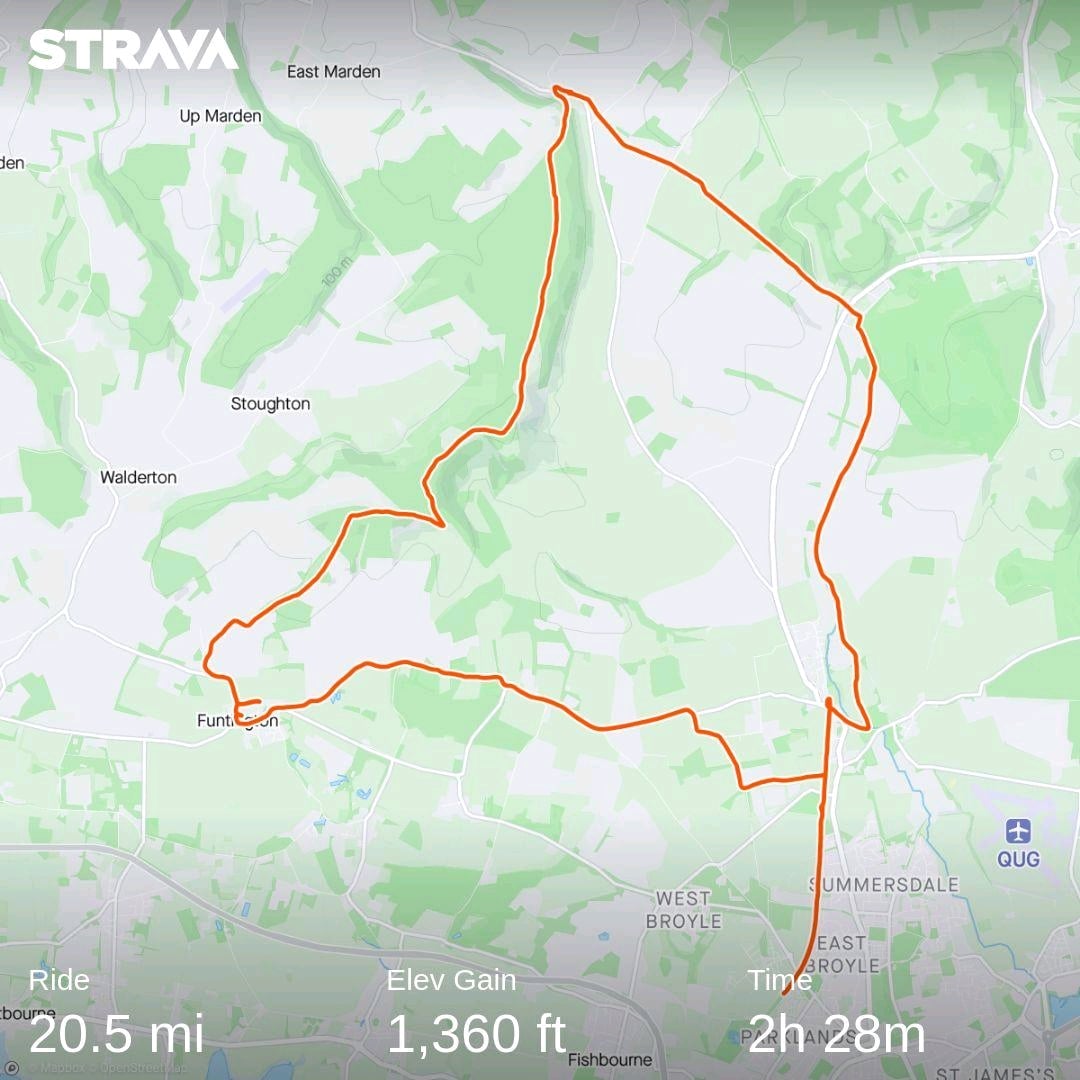

Been riding Maxxis Assegai Maxxgrip DD front and rear Spring and Summer. 26psi front and rear. Huge grip but in the now very wet and muddy weather they become slicks. (Have tried Maxxis Exo+ but after 2 punctures in 3 months switched to DD, no punctures since).
So took them off and put on:
Front: Schwalbe Magic Mary, Ultra Soft, Super Gravity.
Rear : Maxxis DHR 2, Maxxgrip, DD (Double Down)
Today set both tyres to 26psi and rode 20 miles on every sort of terrain - well drained, mud, loose chalk and flint, root, climbing and downhill, where the downhill was mostly well drained.
First observation was that Schwalbe Super Gravity is a lot stiffer than Maxxis Double Down. The DHR 2 felt compliant whereas the Magic Mary felt over inflated. So stopped 3 times to let a little air out of the MM during the first 10 miles, then during the next 10 miles good.
When got home checked the pressures again - DHR 2 still 26 psi, Magic Mary 24 psi. Have a couple of tyres to be fitted tomorrow on Mrs Trek Rail and sure enough, Schwalbe sidewalls are definitely stiffer the Maxxis Double Down in the squeeze test.
Might drop the MM pressure a bit more.
Edit 30 Oct: today dropped MM to 23 psi, worked great.
YMMV
