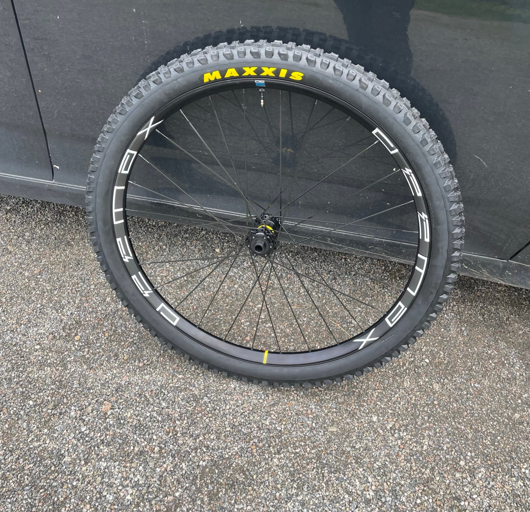

Just got Assegai DH MaxxGrip. And second wheelset. Maybe testing Assegai at the weekend. Interesting to see how it compares to 2.6 Butcher T9 Gravity.
Ive got the same tyre waiting to go on my Rail, used to run it on my non ebb Intense Carbine at our bike park with loose over hard pack. Its a brilliant front tyre and grip for days
And just ordered DHR2 DH Dual for rear, so soon i have Spesh and Maxxis set to compare.
Just came out from the woods with Assegai. Mostly dry, roots and stones.
Nice tire. But seems to be at its best on sand in berms, etc.
On moderately hardpacked sand Assegai is better than Butcher. Very stable.
Very short experiment though, one steep and twisted downhill ski trail track base.
Even on the dry stone it came clear that it does not have the same grip and logical behavior as the Butcher T9.
Two times it slipped from dry rock.
Never happened with Butcher.
And in my opinion i might think that T9 is a little softer compound than Maxxgrip.
Grip is better even on dry rock and root.
But anyway, i like Assegai. It's stable, sturdy, goes exacty there where you want it to go. And seems someway more agile than Butcher.
On wet i can imagine that Butcher might be a little better perfomer.
On the otherhand i assume that Assegai has better wear resistance than Butcher.
I will continue with Assegai, this was just one and first ride. New tire, new behavior. Getting used to it takes it's own time.
All in all: no dissapointment here.👍
