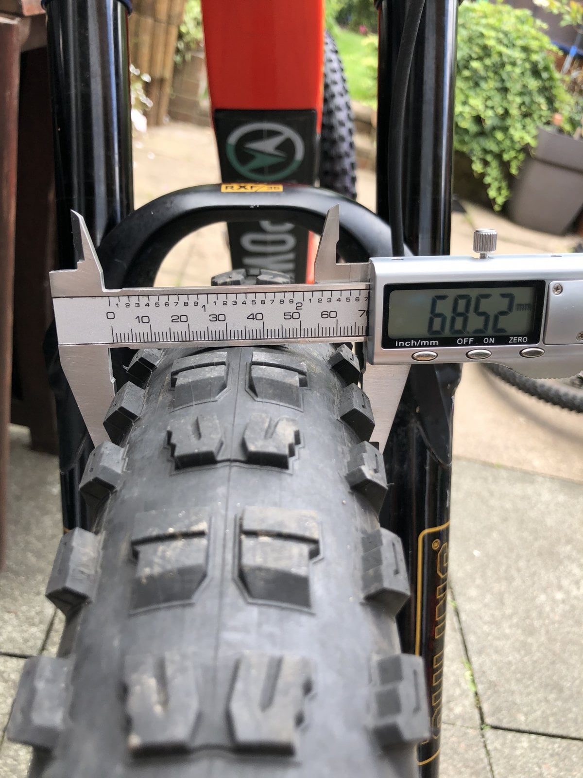

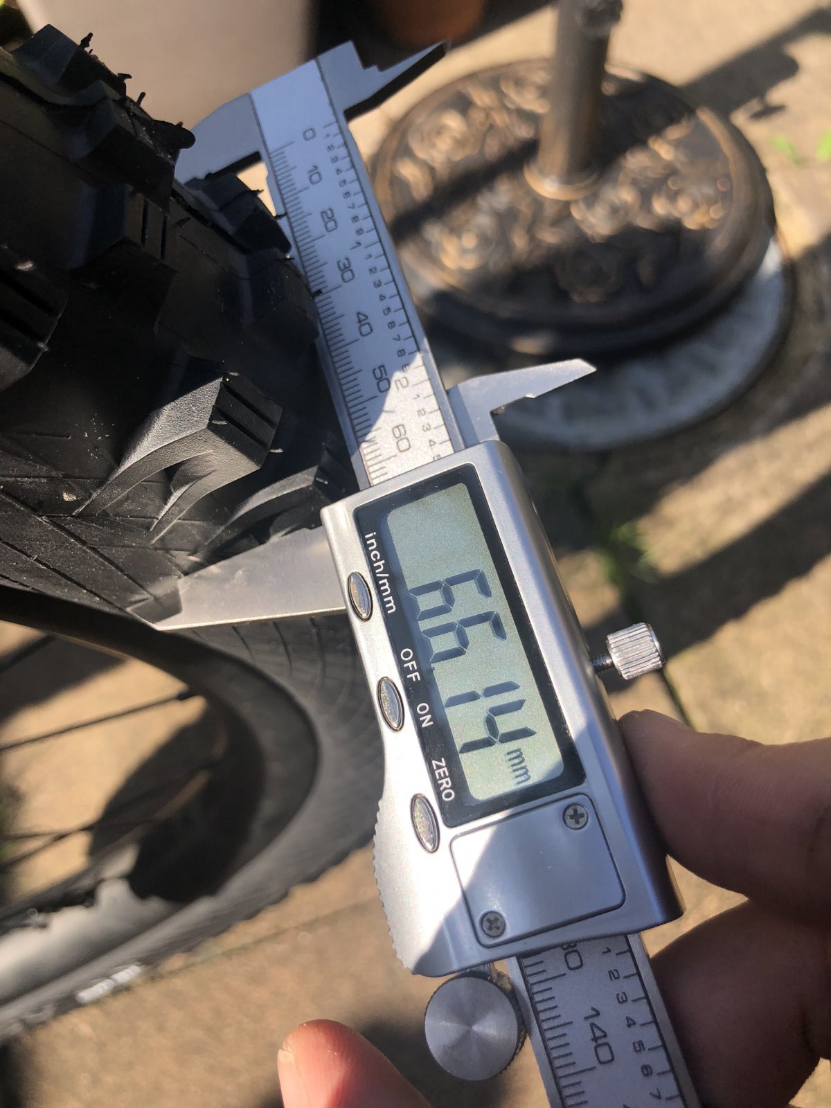

2.8” Butchers vs 2.6” Magic Mary (in millimetres!)
@Donnie797 I think you asked this in another thread.... measured on the sidewalks, not the tyre knobs.
Butcher 2.8” (2.7” actual)
Magic Mary 2.6 (2.6 Actual)
Rob Rides EMTB
Administrator
Staff member
Jan 14, 2018
6,296
13,868
Surrey, UK
Maxxis imeasure widths at 60psi.
Spesh tyres are made by CST
CST is Maxxis' parent company.
Put 60psi in and re-measure.
Not that 0.1 of an inch really matters
So Butchers could be a very similar tyre to the Minion?
