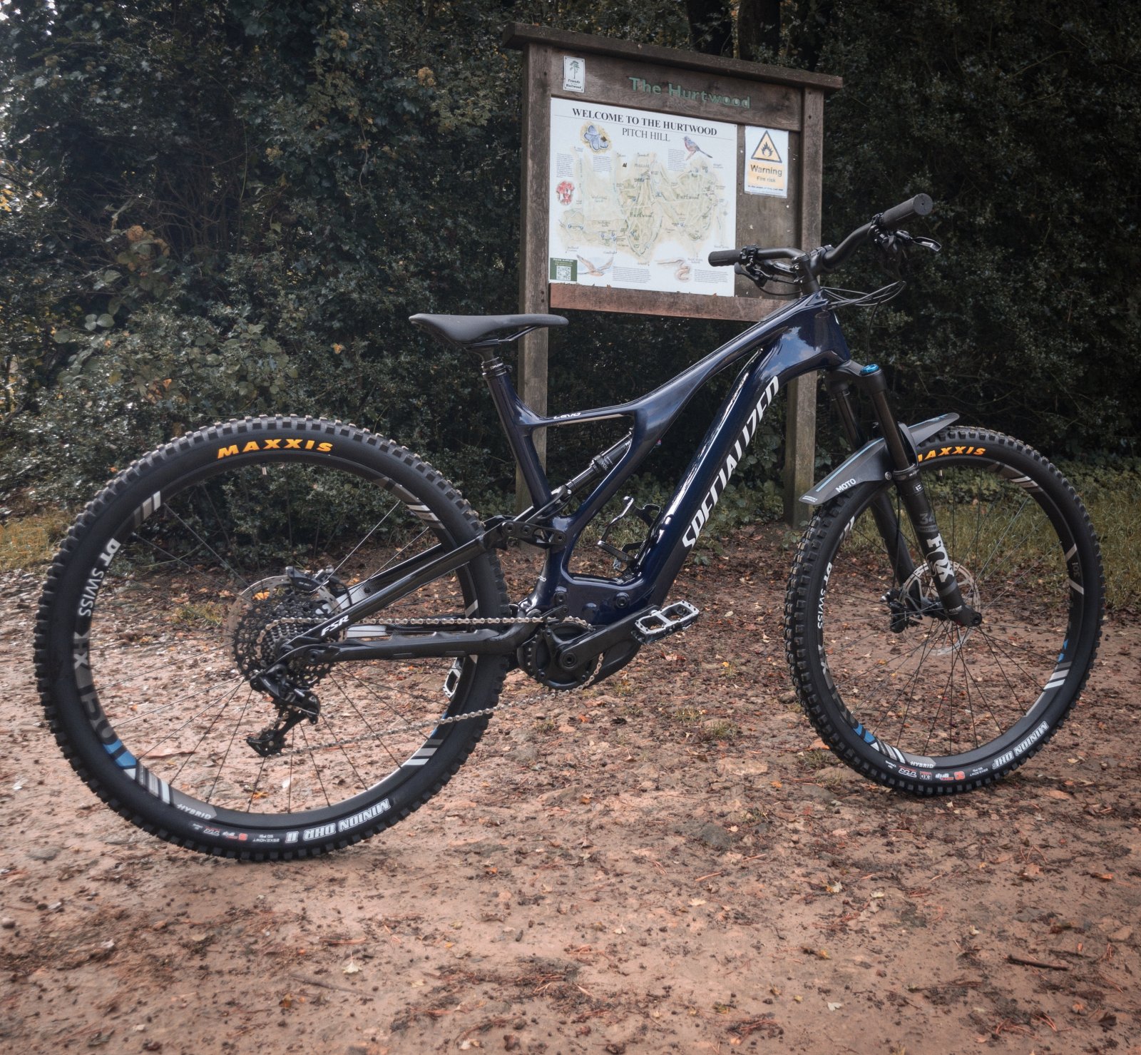

I’ve just got some Maxxis Minion 2.5 DHF II and 2.4 DHR II on the Levo.
The stock 2.6 Butcher isn’t much bigger at all than the 2.4 DHR II.
These are the DH compound (they were supplied on a set of test wheels that DT Swiss have given me, the HX 1501’s).
The tyres are ridiculously grippy and probably way too burly for my riding, so I might replace them with Eco casing at some point.
29”?
That bike in the pictures looks looooong.

Can you put your dropper up and repost the photo please Rob? ??
9,190
Tyre valves should be at 6'oclock too - Rob your supposed tube setting the standards here!

And the text on the tyres should be in line with the valves.
Sloppy Hancill, sloppy.

Great. Thanks!!
I’m going to change the DH casing tyres. They’re super grippy but heavy! I think they’re about 1.25 KG.
@Gary do you know which is the next one down in terms of casing? It’s bloody confusing looking at their range. (Someone in their marketing dept needs to simplify it!).
Need more of a trail tyre instead of DH.
