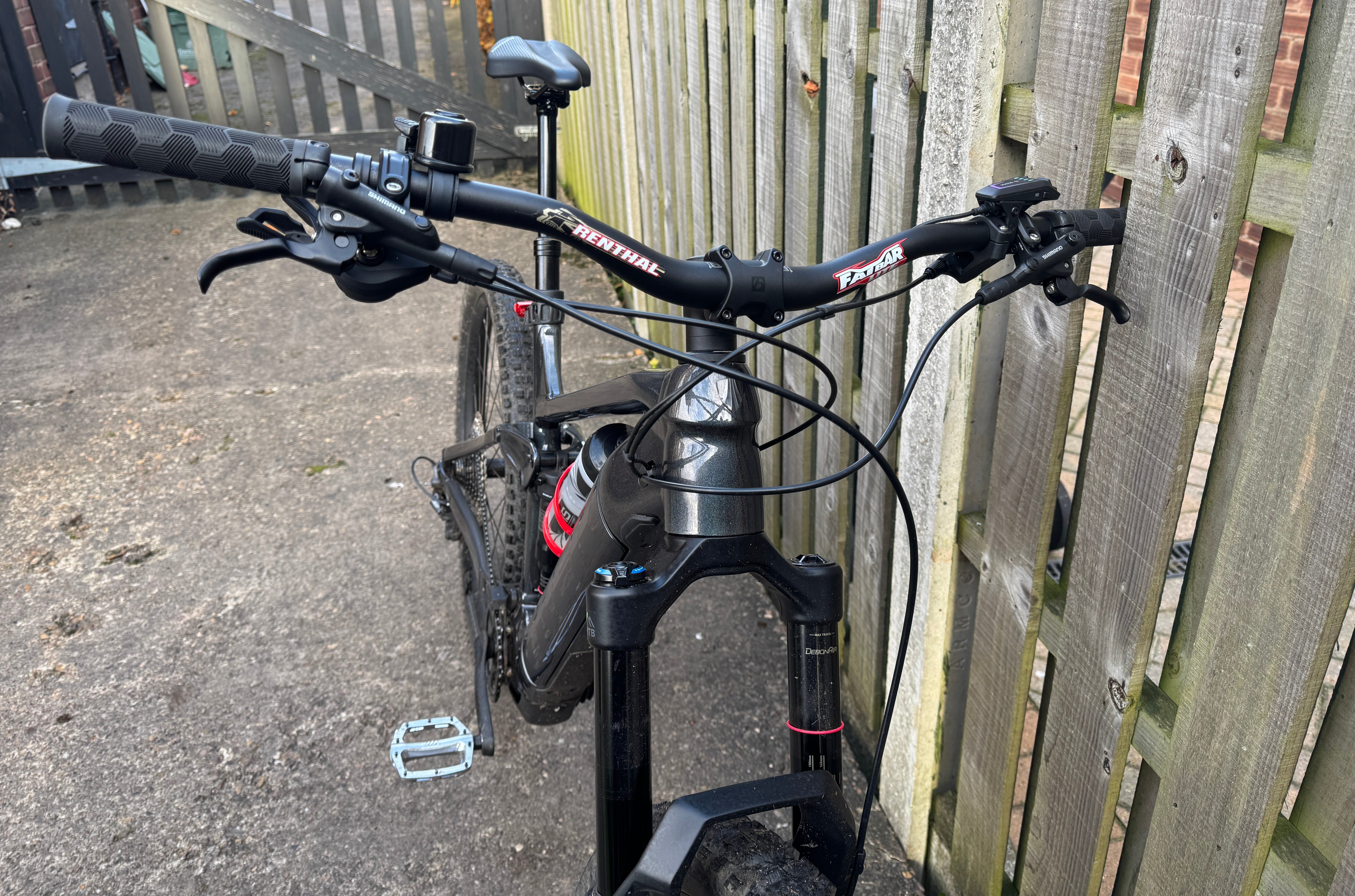

This week was Fatbar Lites.
More than twice the rise, half the weight of the stock bars (not I care much on a Rail 😂) and £75
First test ride out this morning, much better on the posture 👌
Without the fold in the bar and the little hole under the grip to allow the cable to be hidden, what did you do to route the cable? I know it has to go outside the bar, but did you just ziptie it or use something else?

Had a look i could possibly get them as a Xmas present. Not sure about what sweep and rise though 🤔
My stock ones were 15mm rise, and chose to get 40mm, so effectively an inch higher in old miney.
They are 760mm long as opposed to the 780mm of stock, but I'm not missing the cm either side.

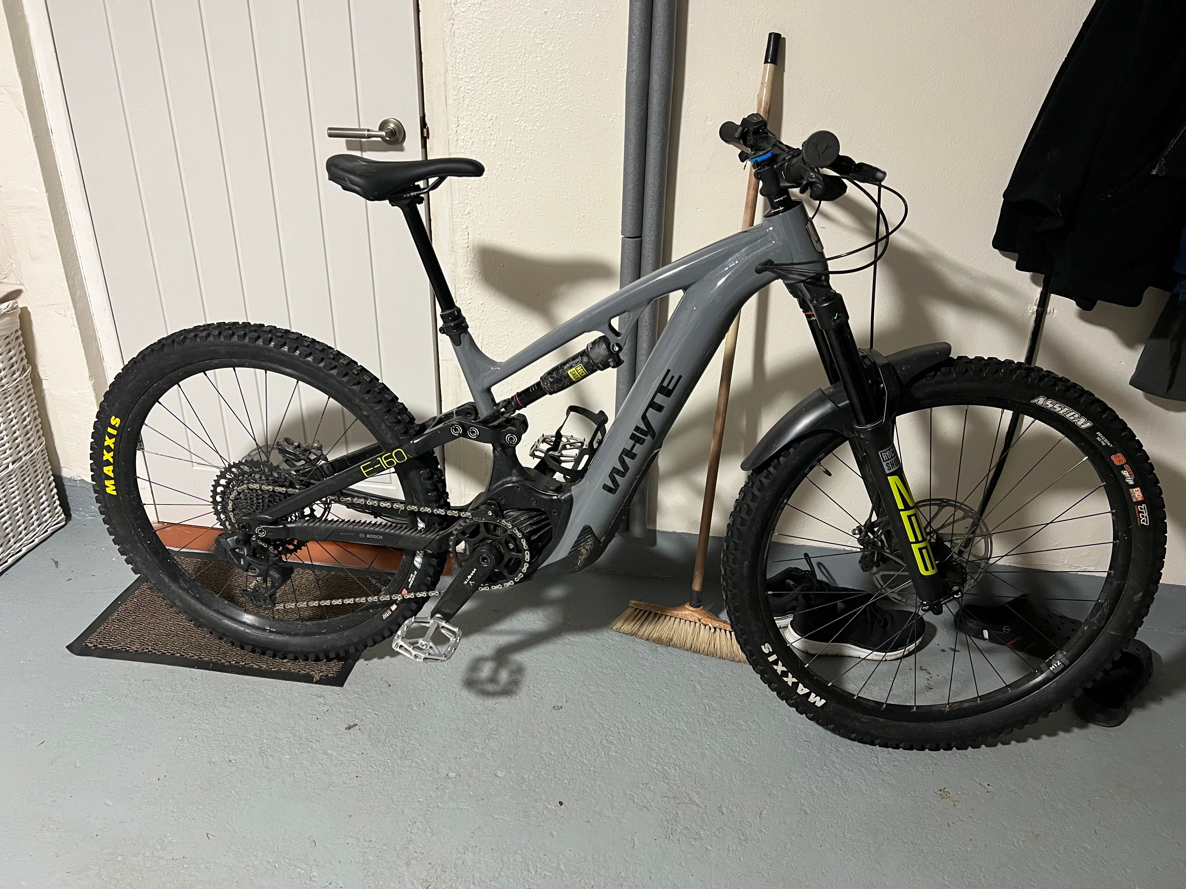

Mulleted my Whyte e160, and shaved just under 900 grams off the rear end even with a burlier tyre. Just got to order the shape it link now.

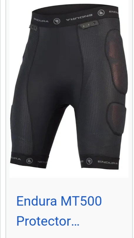

Always used Mt500 Endura lycra shorts , had about 6 pairs over last 20 years. They still use shorts with that name but the ones available I have seen in shops are half the thickness and Chamois padding is the same pretty thin . I looked at the undershorts liner with same name but no mention of the padded arse bit. Shops I have tried have not been much help. I wonder how good the ones in pic are , the Chamois is not mentioned . Can't be bothered faffing about ordering stuff to send back . Thing is shops don't seem interested, I remember when I could go to a shop and order something now they don't offer that option.

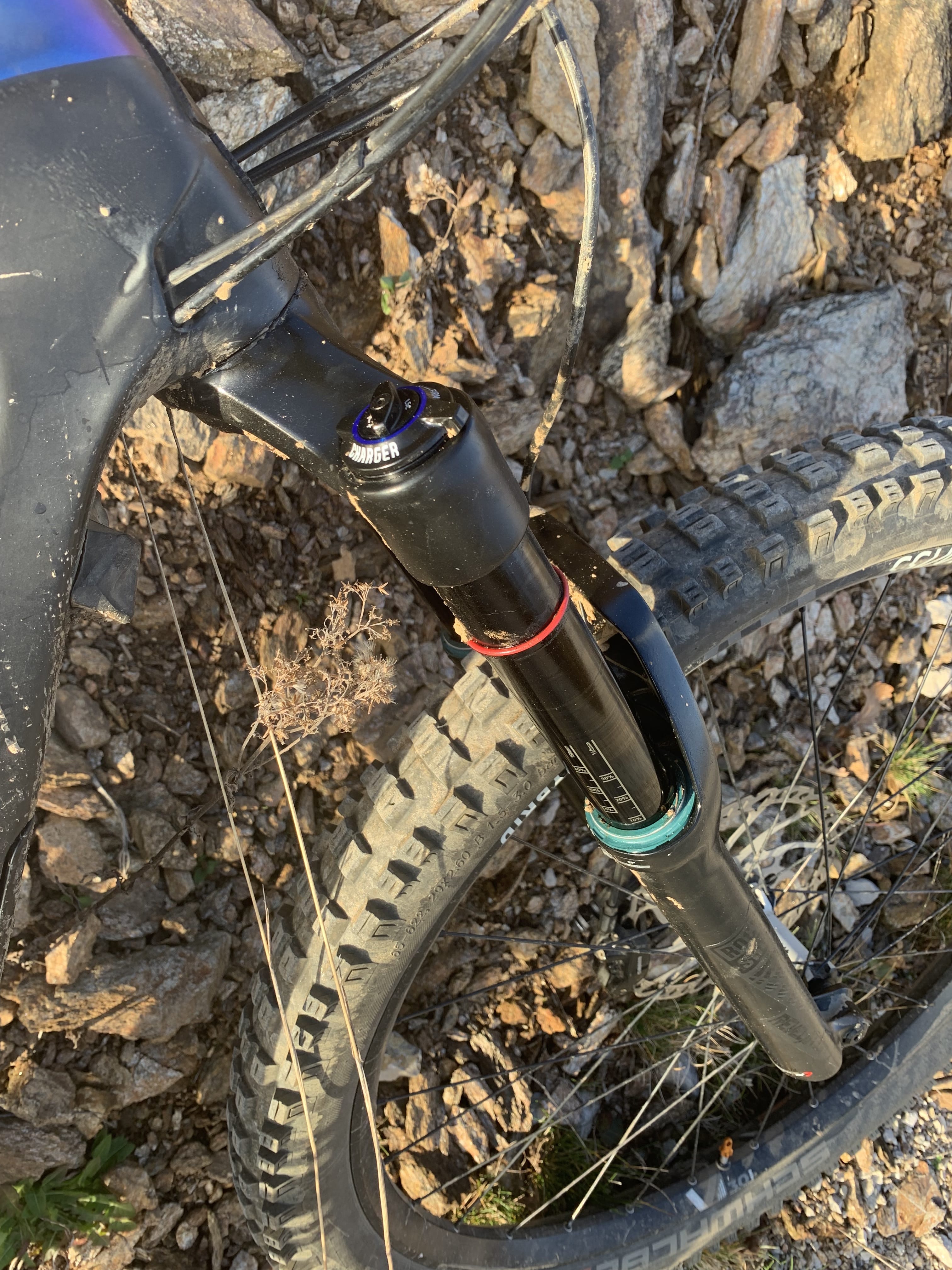

Basic Revelation fork on my Levo wasdue a service, so I fitted a Debonair airshaft, Charger damper and SKF low friction seals, Maxima Plush oil, and is now noticeably smoother
