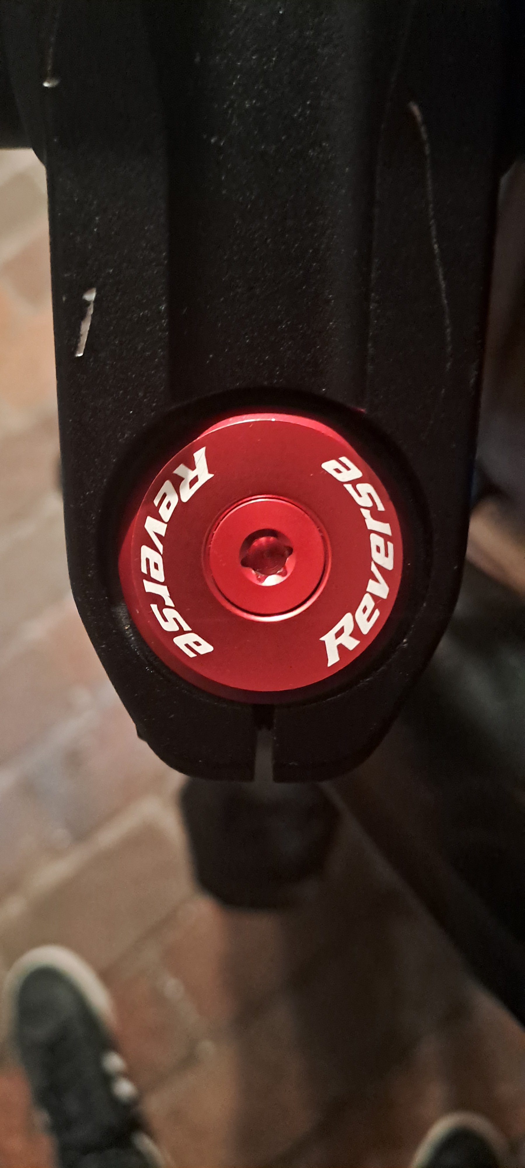

This week the most essential upgrade ever:
20241117_140055.jpg With the new cap, the bike goes faster of course ;)

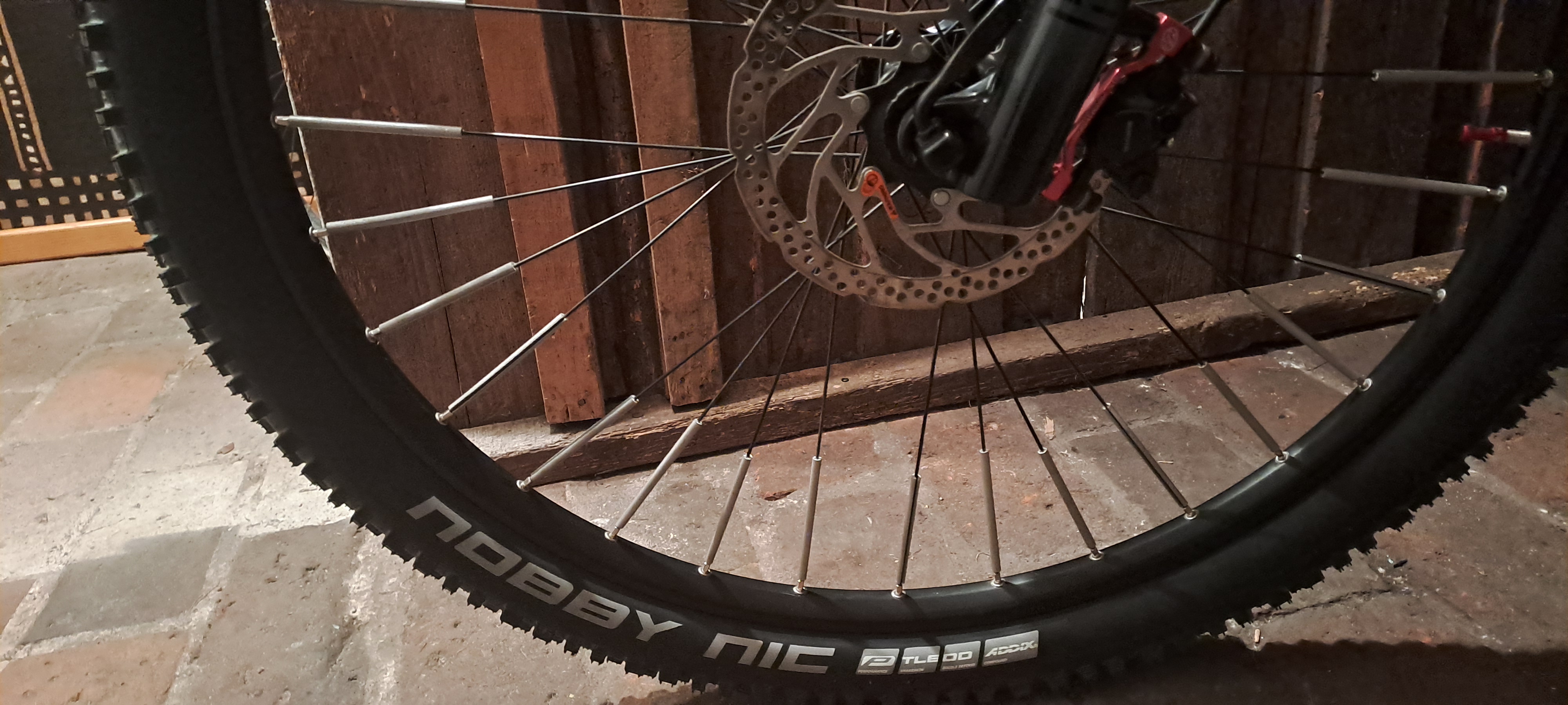

Also put on the new tyres, just in time for the shitty weather coming next week. (Related thread: Tyre advice: upgrade from Smart Sams )
I've put on tyres loads of times but I think this is the first time doing foldables, they were a bit of a bugger to put on as new tyres generally are. It's one of those "I need 3 hands" jobs (3 tyre levers ≡ 3 hands). Also in my haste put the front one on without checking the direction, was of course the wrong way (doh). "Changing tyres makes you tired".
Also cleaned the cassette and chain and the brake discs while I was there.

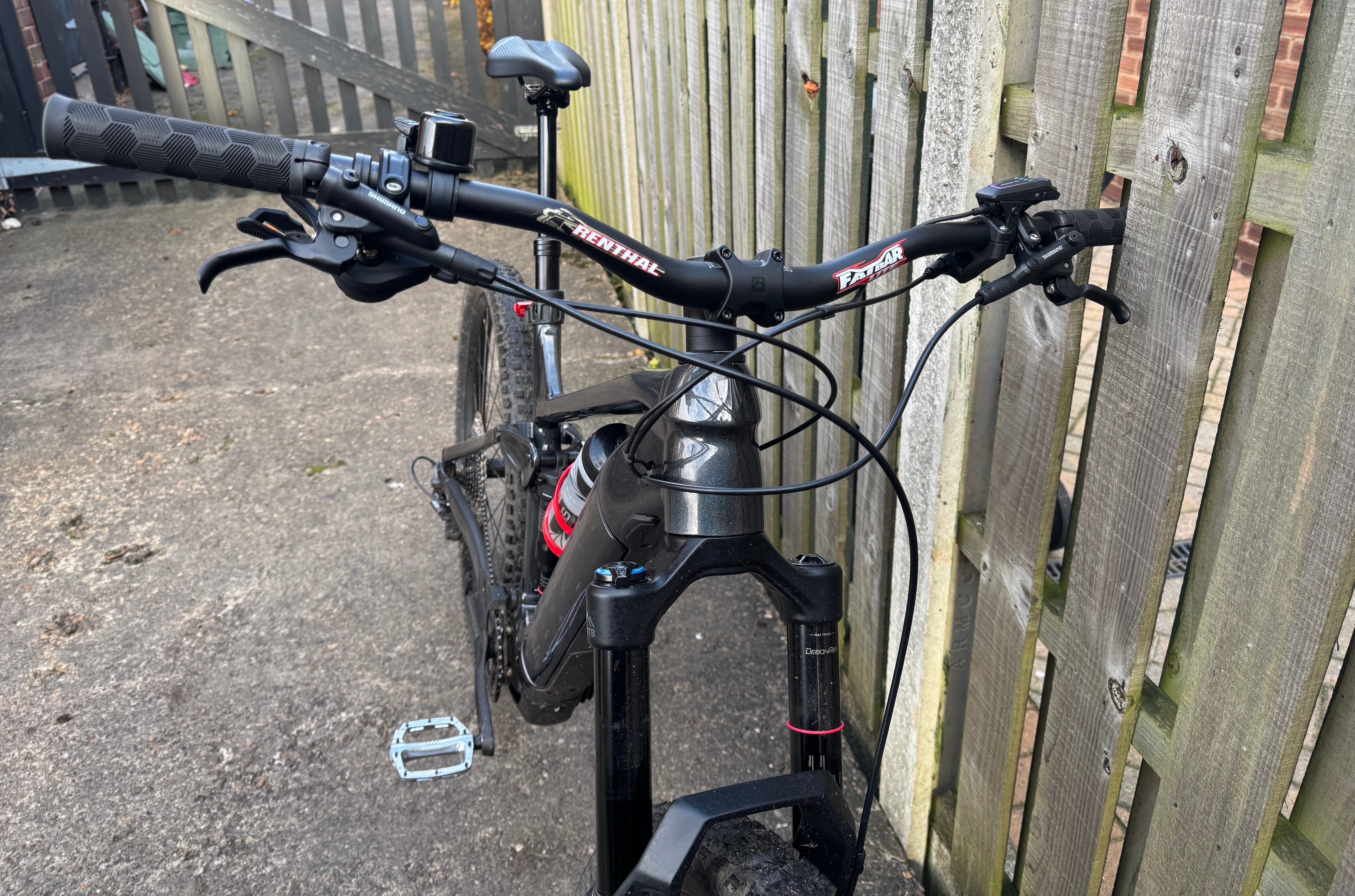

This week was Fatbar Lites.
More than twice the rise, half the weight of the stock bars (not I care much on a Rail 😂) and £75
First test ride out this morning, much better on the posture 👌
I am a massive fan of Renthal Fatbars.
Their upsweep and backsweep numbers are perfect for my hands/wrists and they are by far the best bars I have ever used.
At some point I will add some to my bike, but the internal cable routing on the stock bars makes it harder to do than a standard MTB.

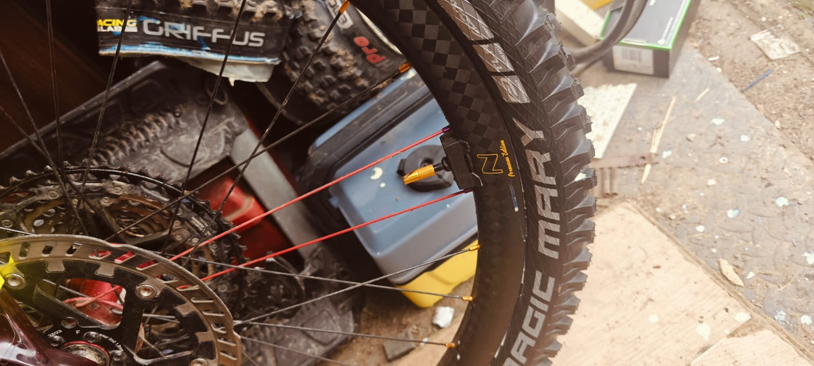

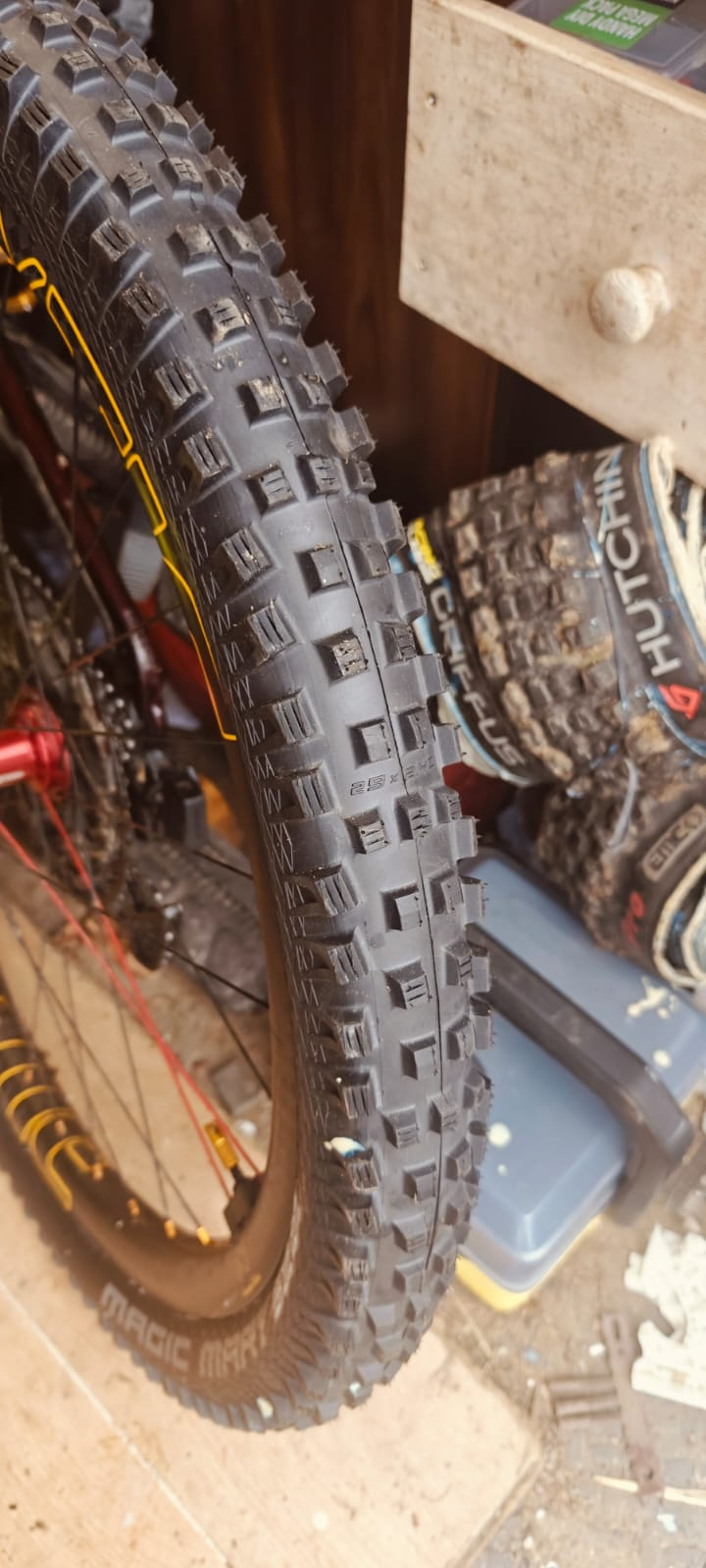

I so I got round to fitting the Magic Mary's that I bought for Ard rock that didn't turn up until a few weeks after the race.
Really frustrating that when you line the valve up on one side to be in the middle, on the other side its #wonky
I did clean off the monkey Jizz after the photo.
