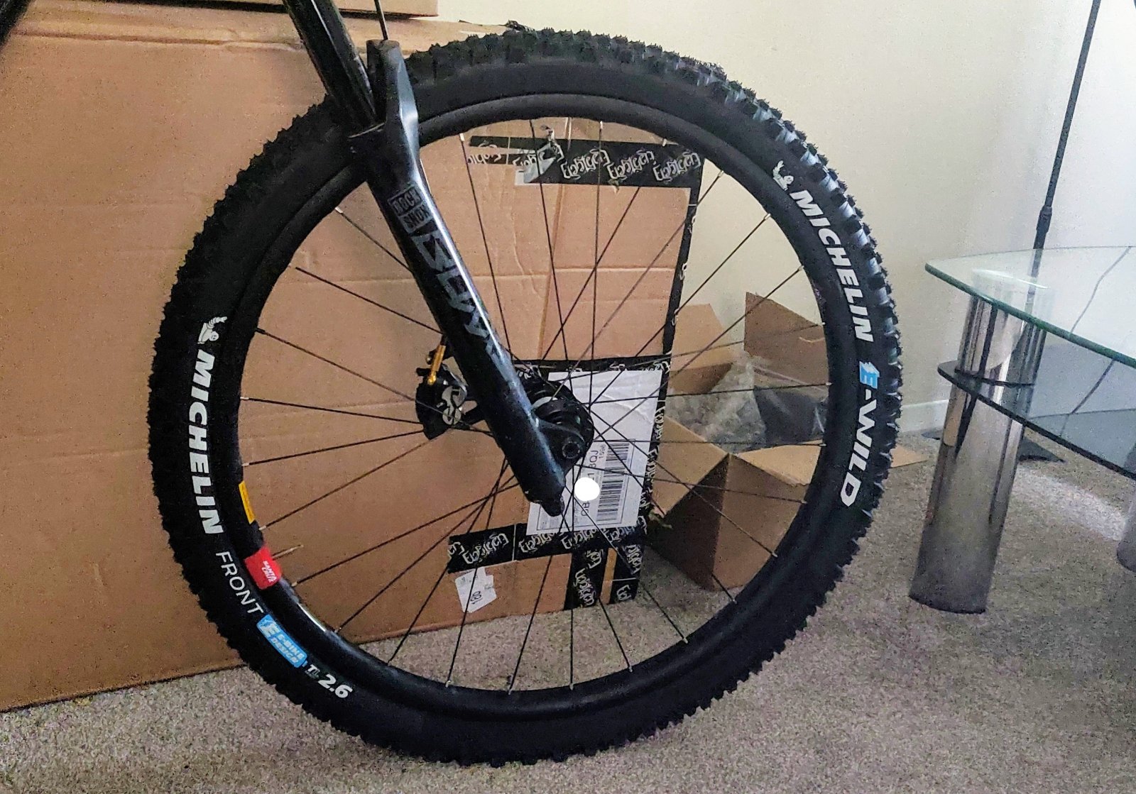

29er Nukeproof front wheel, with Michelin Wild AM 2.35 for a mullet conversion.
Ergon saddle.
And some suspension trickery.
Are bike spirit alligned as I also bought ;
Michelin ewilds ( 27.5x2.6 ).
Ergon sm pro with oil slick rails ?.
Cane creek progressive spring for the shock .
A new chain guide .
Also got the new GoPro 9 blk & max lense to film it !

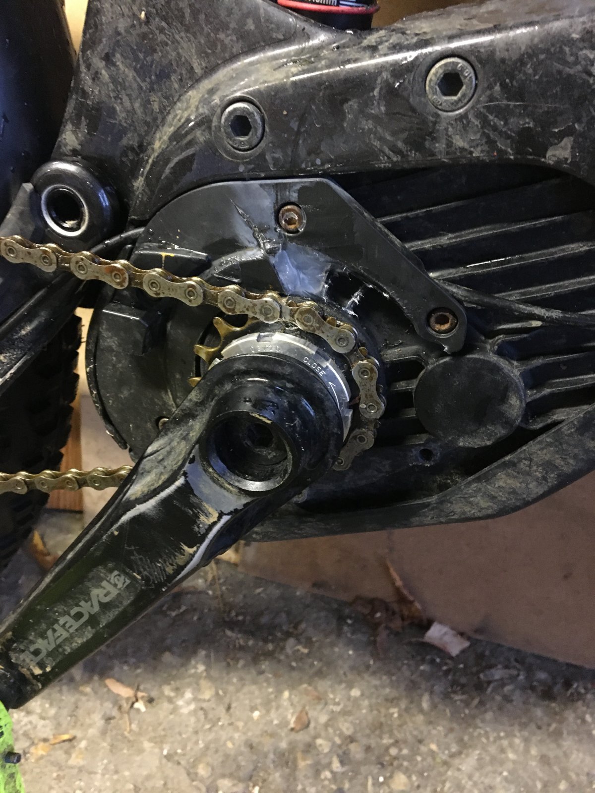

I highly recommend fitting one of these lockrings to your bike. It has massively reduced the build-up of mud around the front chainring of my trek powerfly

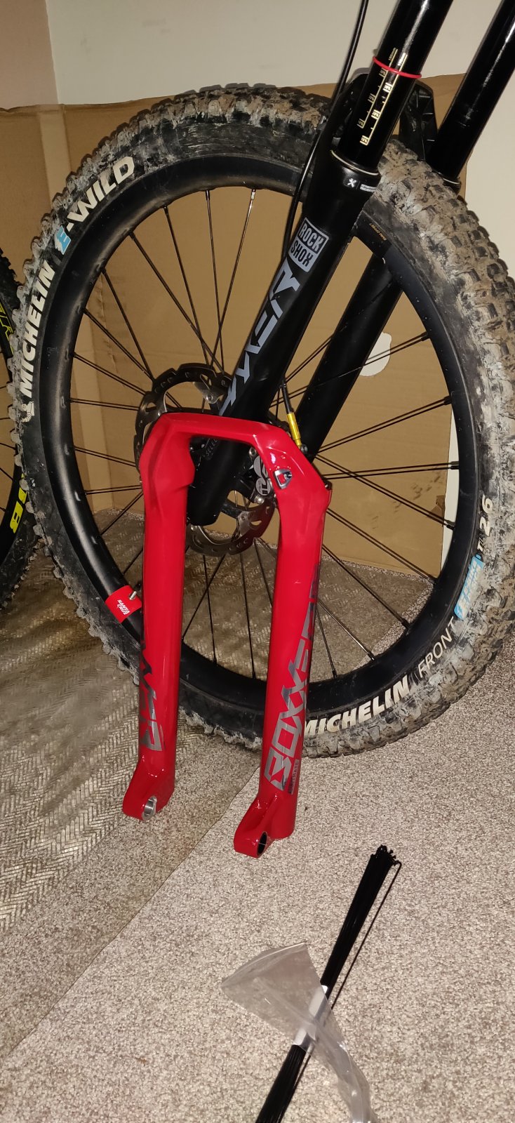

A 29 wheel and tyre for my kenevo mullet project.
Well I say wheel. I think I got the last Santa Cruz 29 30mm reserve rim in the UK and the spokes and hub from Germany.
Unfortunately SC have increased the erd by 6mm so my spokes are too short, so more ordered from Germany.
This will match up with some 29 boxxer lowers I had to order from Spain. Why can't I get parts in the UK!?

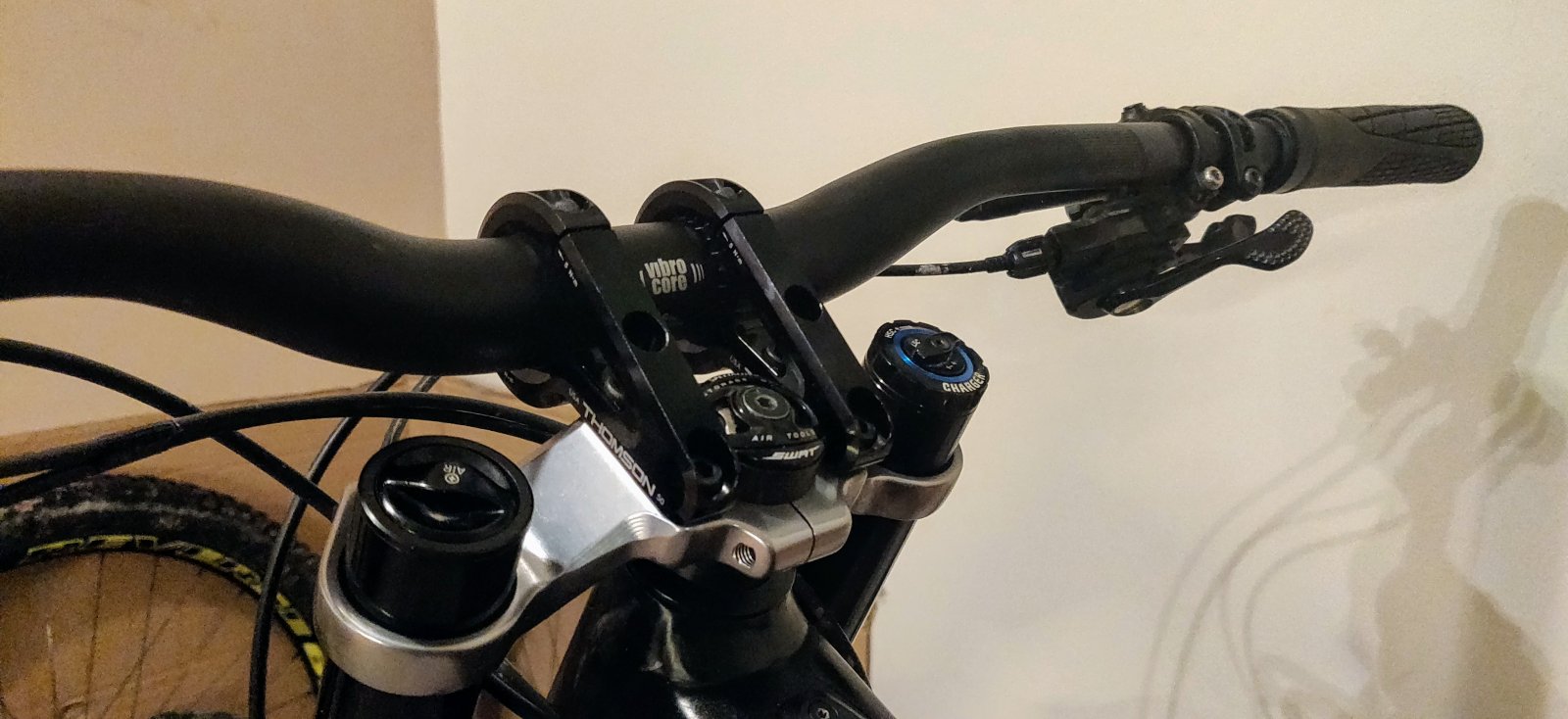

A Thomson stem to replace the stock one, 15mm lower to help keep the bars about the same height for the mullet.
A quality item.

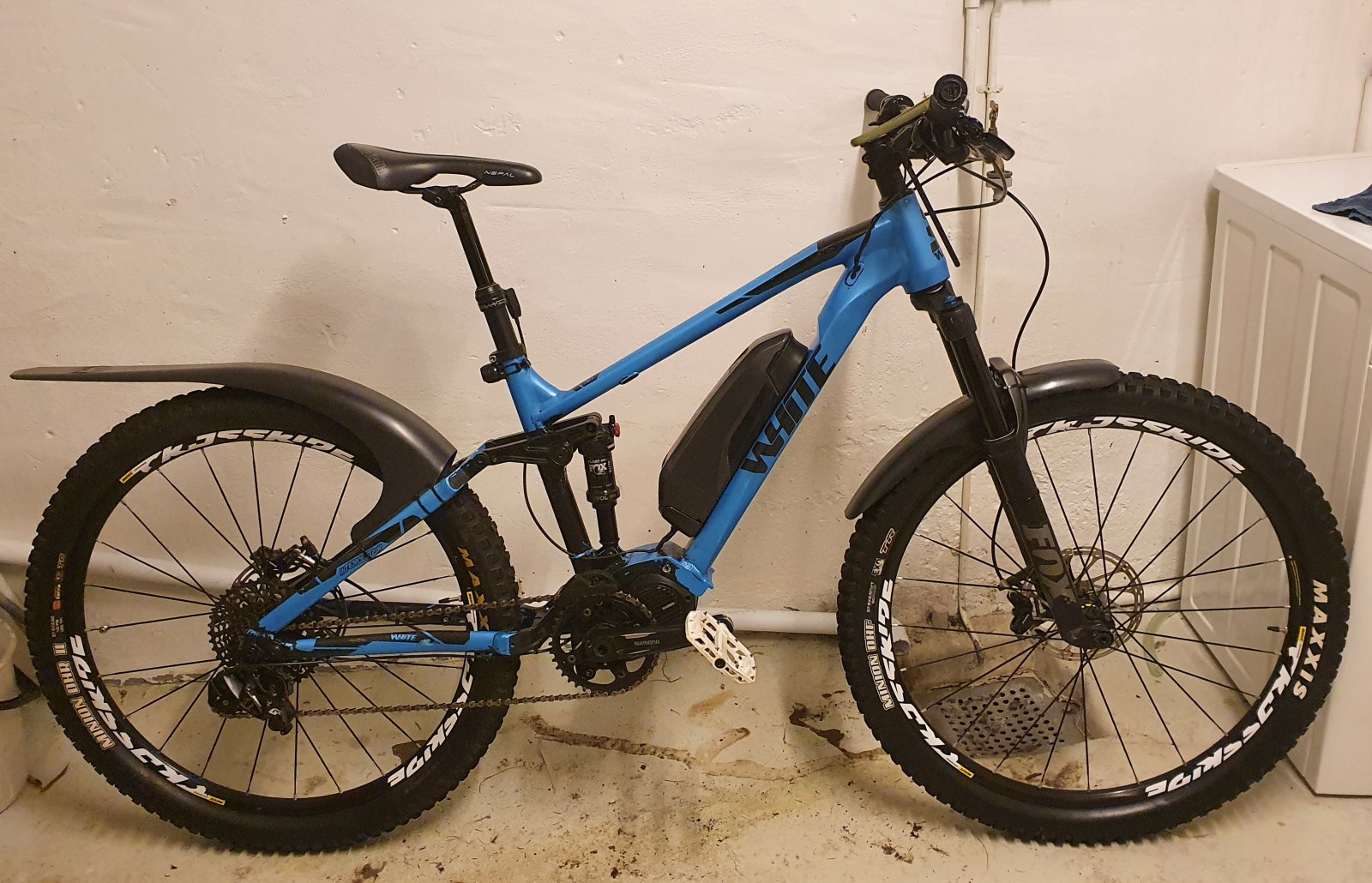

Installed Mudhugger's Front and Rear this evening ?Rear one a bit long for my liking, maybe I'll cut it later. Need to find a protector for linkage now

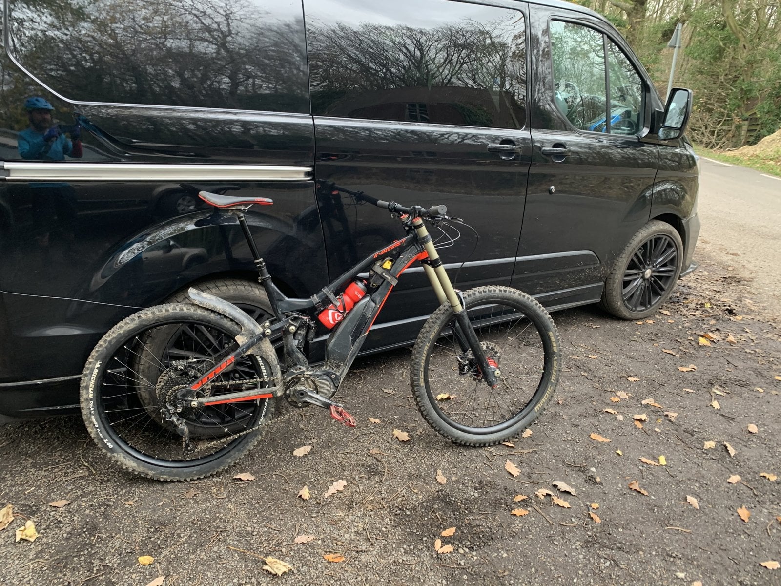

The BOS forks the spring is a bit light so was blowing through the travel a bit, I like the 29er front wheel & the Mezzer fork is soo good I prefer that setup so I have swapped back to 29 & currently servicing the BOS fork which is a 26” fork but had a 27.5 wheel with MM 2.35 up front

Excitement levels at max!
Correct spokes and 29 boxxer lowers arrived.
Ordered lowers from bikeinn who use spring GDS shipping who both get appalling reviews but I can't fault, part arrived on time.
Not much work will get done today. :)
