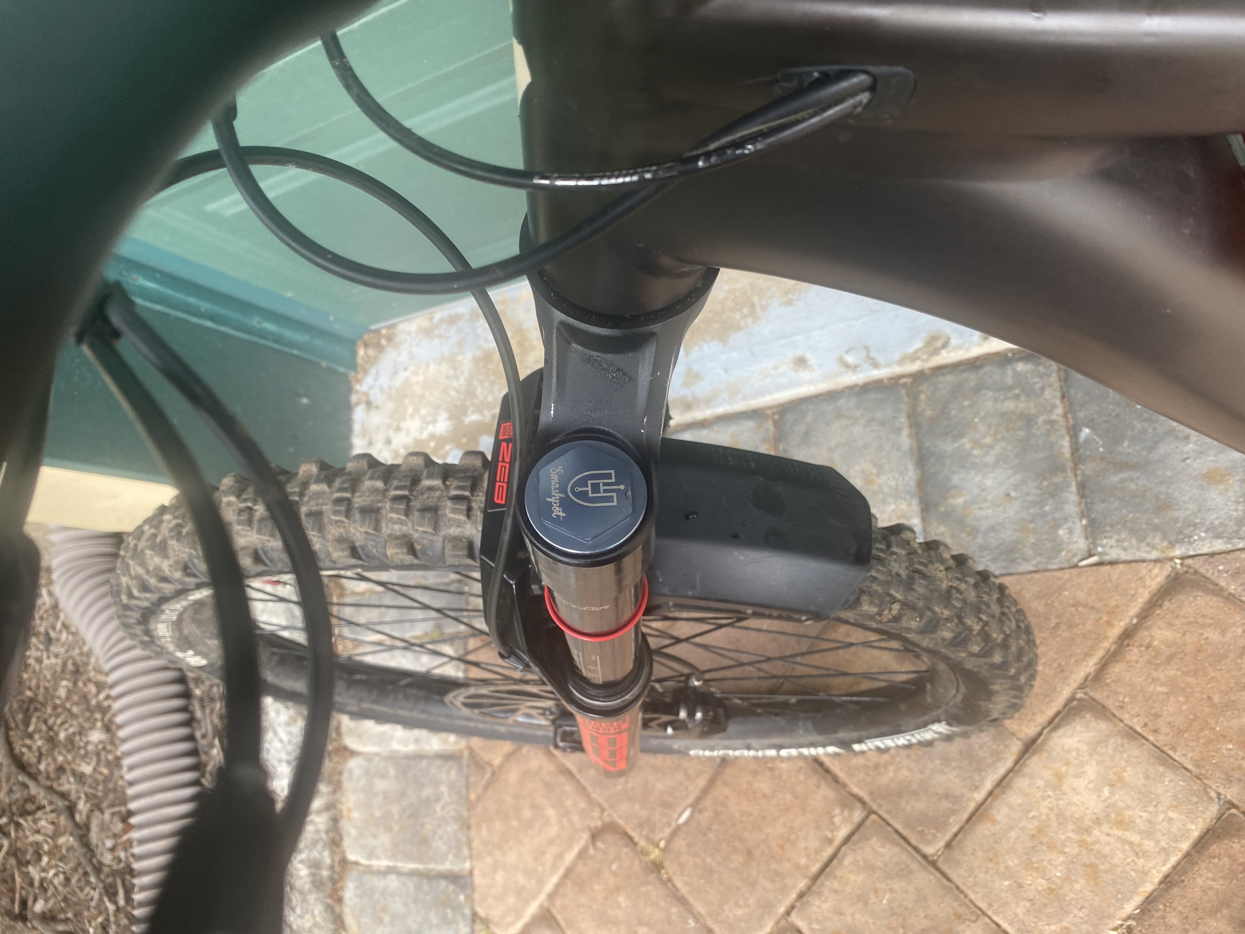

Your thread "SC Bullit knocking/rattle" disappeared pretty quick, what happened?
I don't know. I was trying to edit the post to get the youtube short to show up in the post rather than being a generic link to youtube...

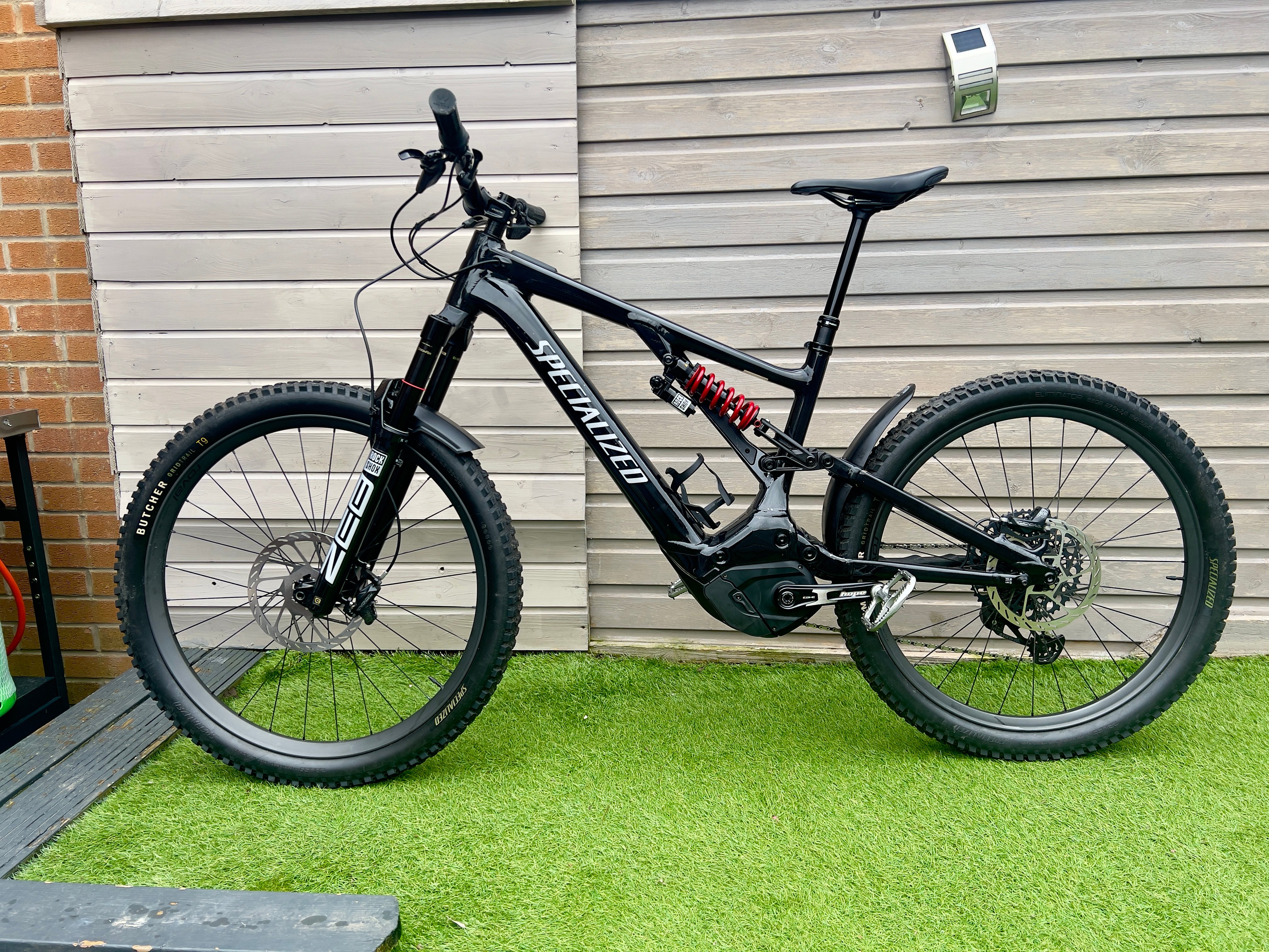

My birthday today and my wife surprised me with some HS2 rotors and Galfer purple pads. I did drop a few hints but that was at Christmas. Can’t think what is that else I could upgrade now :(

Happy birthday Rich. Nice bike.👍🏻
I don’t think you just started WW3 in these forums …but here’s a few ideas;
Ride Wrap, valve caps, Reverb Dropper, AXS GX transmission etc etc…😉

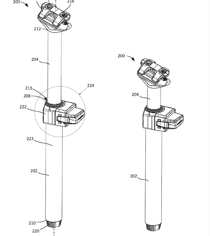

Thanks man, waiting for a new reverb dropper that has more than 170, have Axs and ridewrap, but valve caps are definitely an idea 🤔

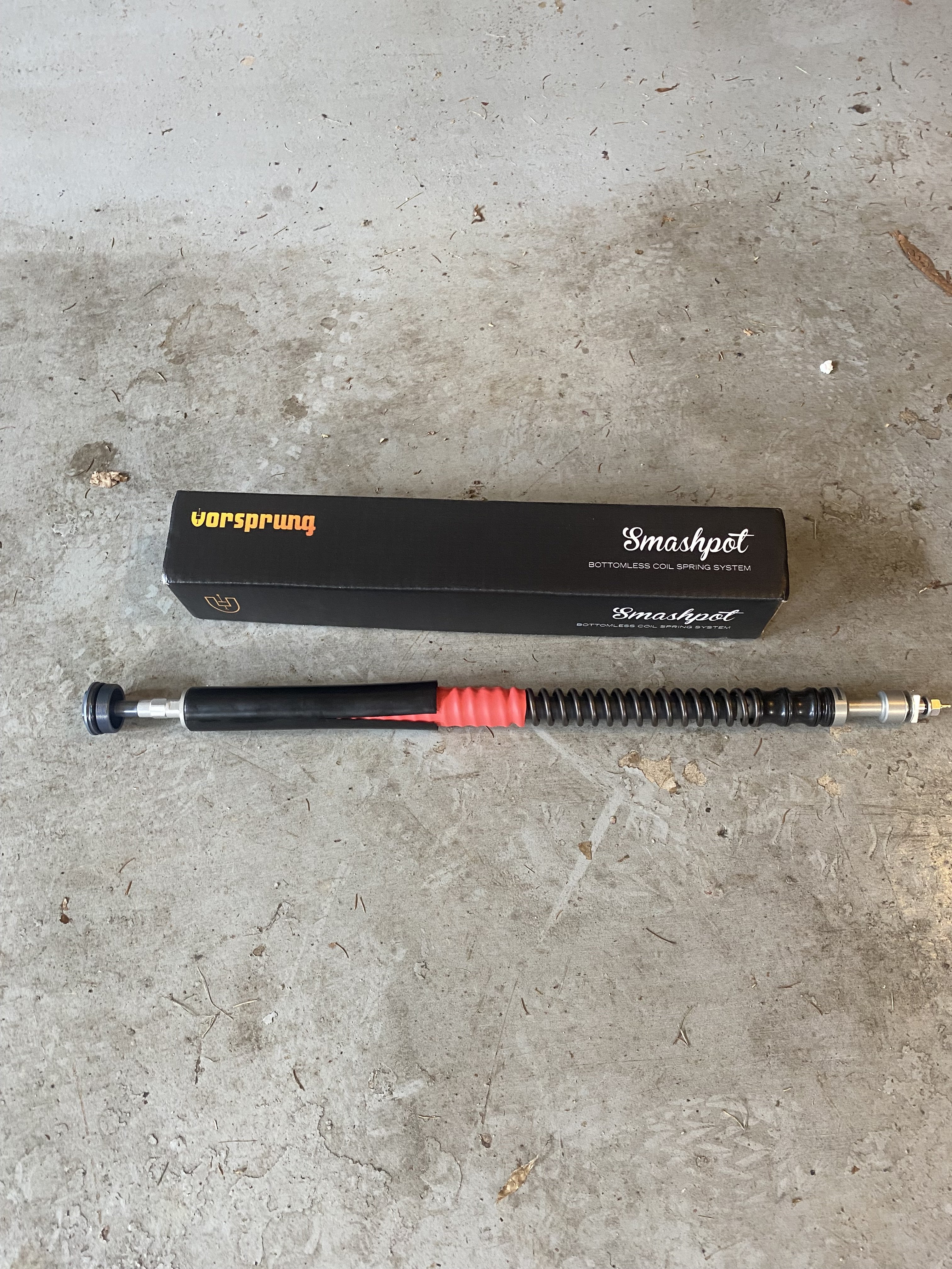

Cascade link was a good upgrade for my levo but if your shock is new then I doubt you want to be spending on that area again :).
Smashpot conversions for forks are also awesome.
Had a cascade link on my 5010 v4 and was impressed with it, I’ll probably give it a few rides to see how it is.l, but I’ve not really seen much about smash pot on a Zeb.
The AXS Reverb dropper is definitely a luxury. My medium Rail came with the 150mm Bontrager dropper. After several rides I wanted something else.
I carefully measured the seat post for fit (broom stick) and ordered the 170mm reverb. But I had to wait 7 months for delivery. The owner of the LBS felt bad and sold it to me for cost. These droppers are stupid-expensive so the drop in price was helpful.
The think the reverb also comes in 190 or 210 length?

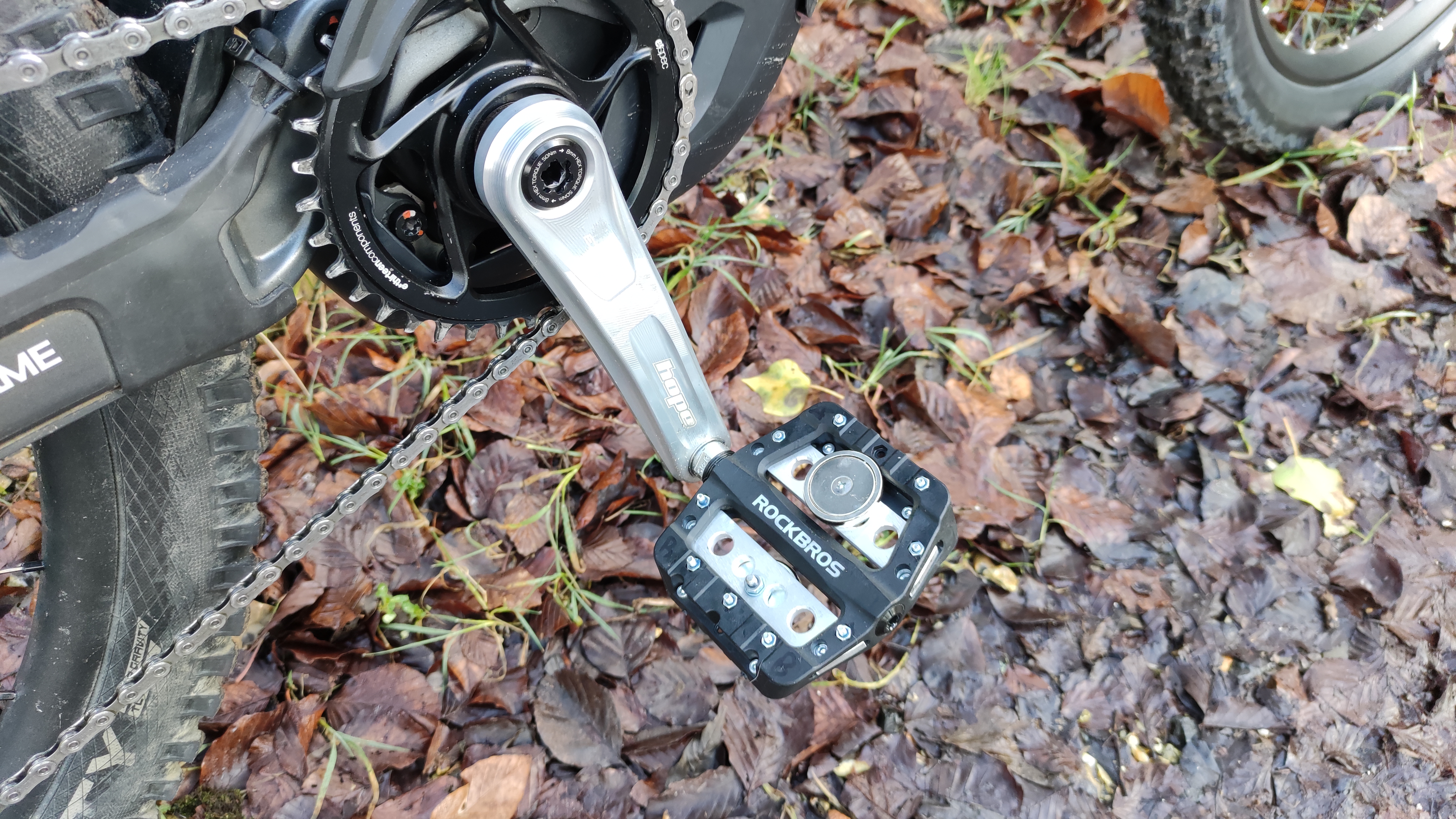

Are those magnetic? RockBros eh?
Maybe a short review and some pics could be useful. …or even your reason if you don’t mind. 🙏
They are "homemade magnetic pedals". The Rockbros plastic pedals were a good candidate as they are light and have an open space in the middle to house the magnets and support bar.
Initial impressions are, very good! I like how they snap my foot into position quickly, but still enable me to put my foot down quickly when needed.
Also having the ability to move my foot around the pedal, but obviously they work best when directly above the magnet.
They also offer a small amount of pedal pressure on the upstroke, which is nice for the climbs.
I suspect nothing like being properly clipped in, but it is still a noticeable amount.
I need to tweak them some more, as at the moment it feels like my foot in riding on the magnet, and I'm not getting any added grip from the pedal pins, so my foot is rotating easily. I believe this is a common issue even with Magpeds, and has a lot to do with the type of clipless shoes you have. I'm using Leatt clipless mtb shoes, which I Really like, but I've read 5-10s have a softer sole that grip the pedal pins better.
So I've either got to try and move the magnets lower, the cleats higher or get longer pins, the easy option is to move the cleats first.
Overall they work far better than I expected and so far I really like the feel of them, though I need to try them for a full day at a bike park to be sure.

I found a number of factors that affect the release. Pin length. Pin amount, pin position, strength of magnetic, hight and position of magnet, spacer used for spd, shoe type …probably a few more too.
I have both Magped and Avery Hustle. I vary the length and position of the pins. Also the spacer under the spd steel plate for different shoe types.
Are you using the Rare Earth type of magnet? Those work well imo.
Hattori-Hanzo
Apr 10, 2023
437
584
Yeah, I need to have a play around to get them just right, they might need a combination of different pin lengths and magnet adjustment.
I really only made them to see if I'd like magnetic pedals as I didn't want to waste the £200 on magpeds
They seem to work a whole lot better than I was expecting so I think its going to be worth having a mess around with them until I can get something proper.
I'm using neodymium magnets, they cost more than the pedals 😆 but they are strong!
