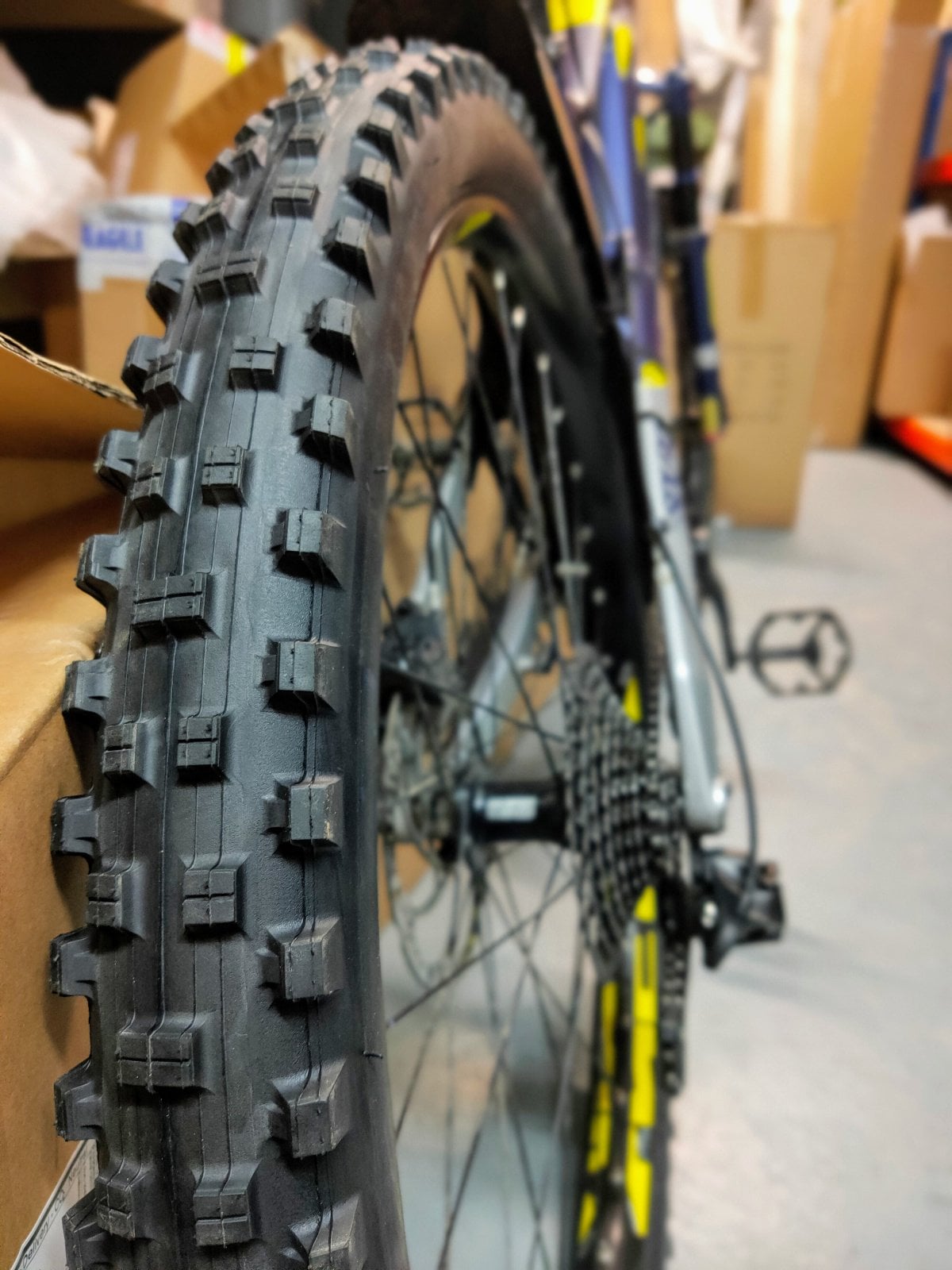

This little bad boy. Maxxis Shorty 2.5 WT DD Maxxgrip yada yada yada..... It looks so skinny compared to my front 2.8.

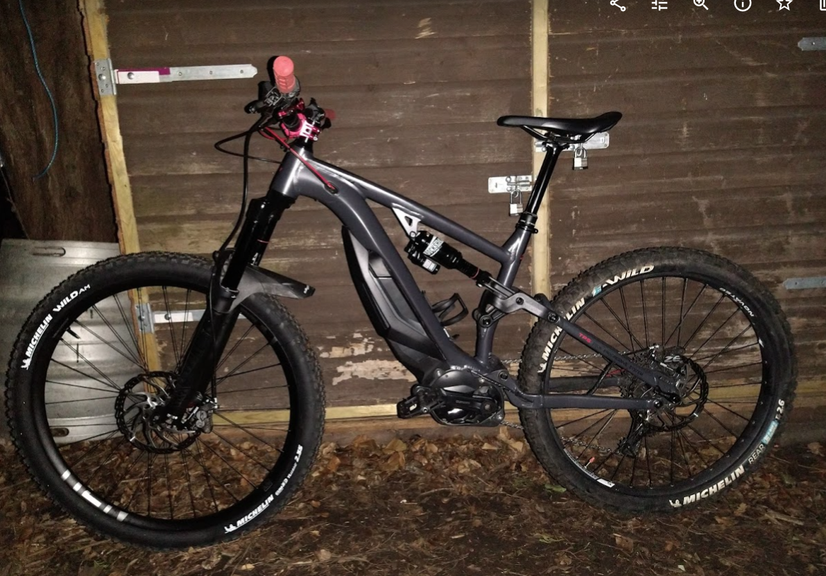

Finally got round to bolting my new bits on.
160mm Debonair Airshaft upgrade for the Yari
Rockshox Monarch 210x60, shimmed to reduce the stroke (increases the rear travel to 150mm).
29" Nukeproof front wheel with Michelin Wild AM.
Ergon saddle.

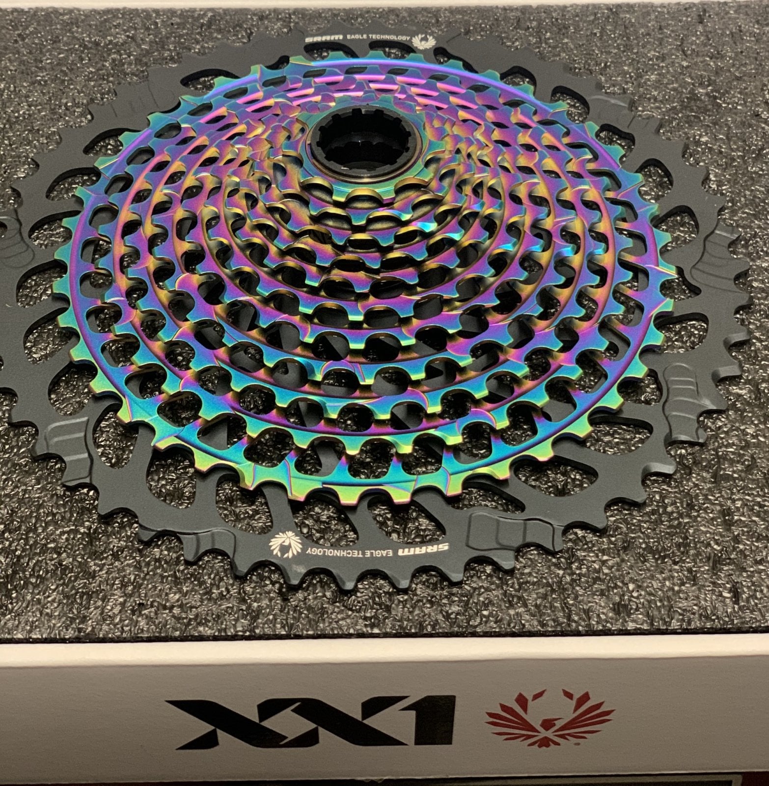

Yeah. For sure not needed. Your detailer works with the 52?
Don’t forget, Use the space checker in the second gear.
Yes Axs derailleurs work with the 52
If mechanical, the updated derailleur is needed
Currently have the copper 52 on SL which im moving to my other bike
i do need the new space checker. Stam should include with the cassette. I’m winging it with the old checker

That is very nice, it'll be a shame to get it covered in chain gunk.
Thanks
Didn’t have that issue with previous rainbow cassette
The color just fades as the cassette wears and just becomeare metal
By that time the teeth are already sharp anyways
i do lube and wipe the chain more often now that i have an ebike

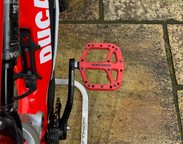

Are those pedals any good? Been looking to get some rick ross to
I can confirm, the RockBros pedals are serving me very well! The 135mm pedal width is exactly what I was after. Occasionally I get few more pedal strikes when riding through narrow tracks, but I prefer to have larger surface area between my boots and the pedals.
I have lubed the pedals with WD40, also applied light-strength Loctite to the screw-on spikes and I expect it to last few seasons.
