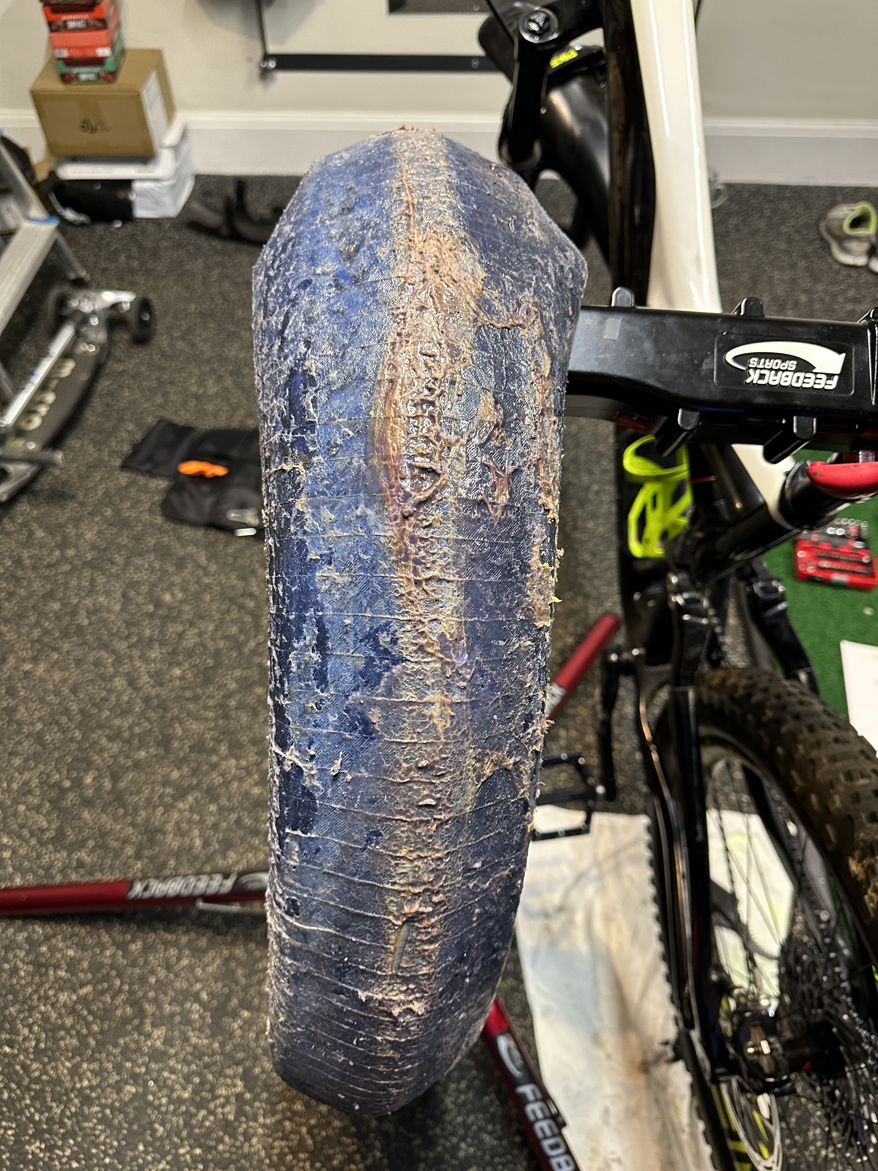

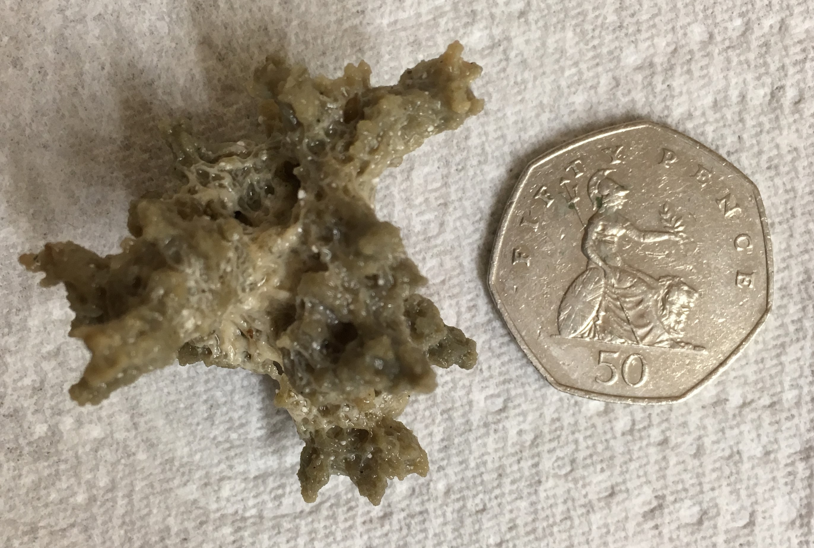

Here's the inside of the tyre from my Stumpy 6-Fattie that I just kept pouring around 100ml of Stans into every 3 or 4 months! I always just popped the bead and poured it in. The bike didn't move for about 6 months - as I had it on a Kickr for winter. When I went to ride it again, the wheel went thump, thump, thump.
Turns out there was a sealant monster created - a HUGE lump of solidified latex 😵‍💫
The inside of the tyre looks like something from Alien 😂
Here's mine., a 3-D starfish! I could hear it rumbling inside the tyre.

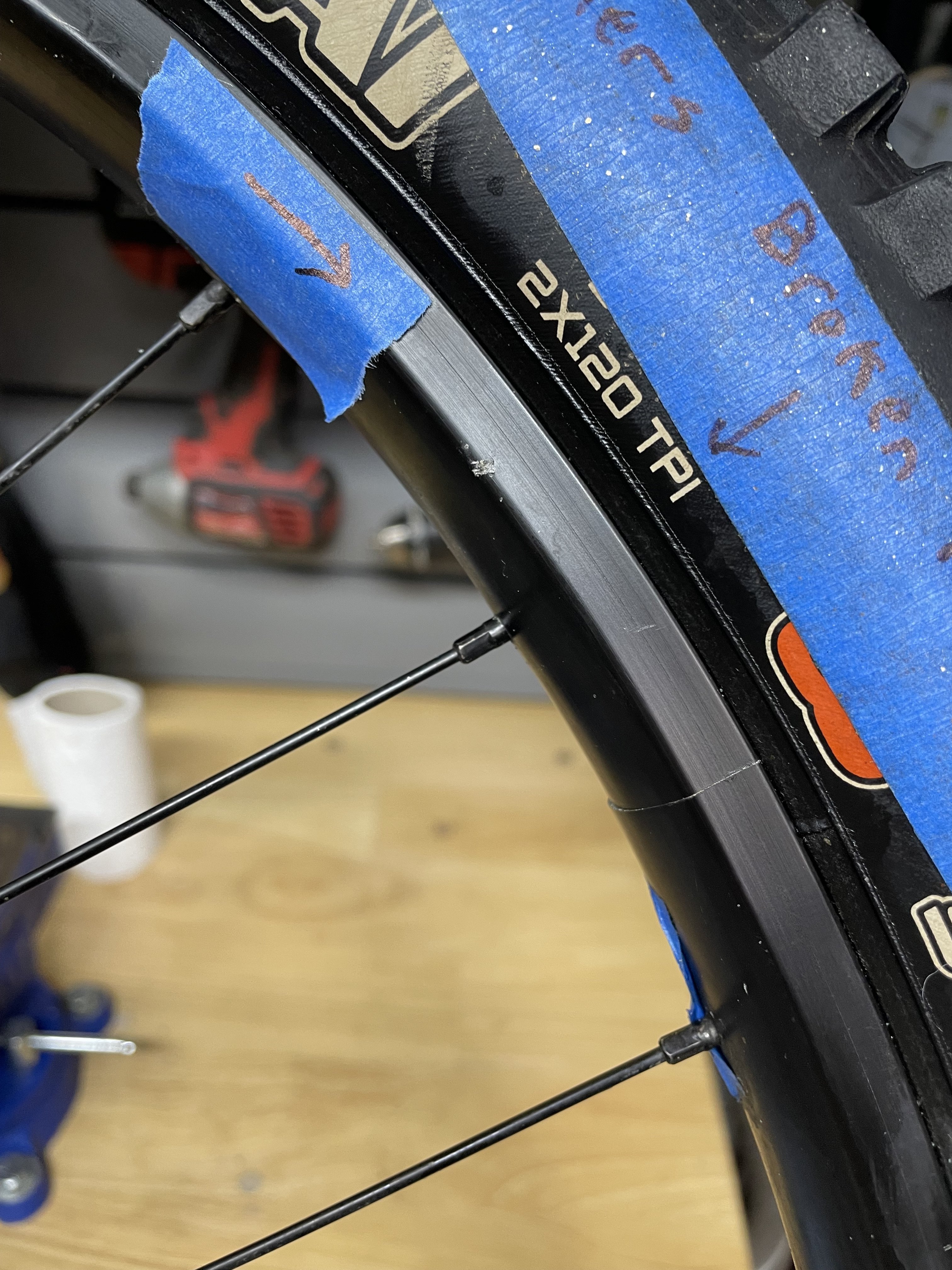

A tire I fixed wasn’t that bad but the Bontrager sealant had completely dried. This was the original Bontrager alloy rim on my nephews Trek. He bent the rim edge so it would no longer hold air. Of course he had a race in Whistler the next day 🙄. I lent him one of my spare wheels (complete) just to get him ready. I decided to try and fix his front wheel later that week.
It took a while but eventually I straightened the rim edge with some weird pliers. Reinstalled his tire, added some Bontrager sealant (150ml injected through the presta valve).
Inflated to 35psi, spun the wheel and started checking for leaks. Damm! Some air was escaping at the dent and the side joint of the rim edge. Spin the wheel some more and hope the sealant does its job. Success 🙏.
The joint on the rim is a concern and I would recommend replacing the rim. But it seems to work. He works now (plumber helper) so he can bare the cost of a new rim.
