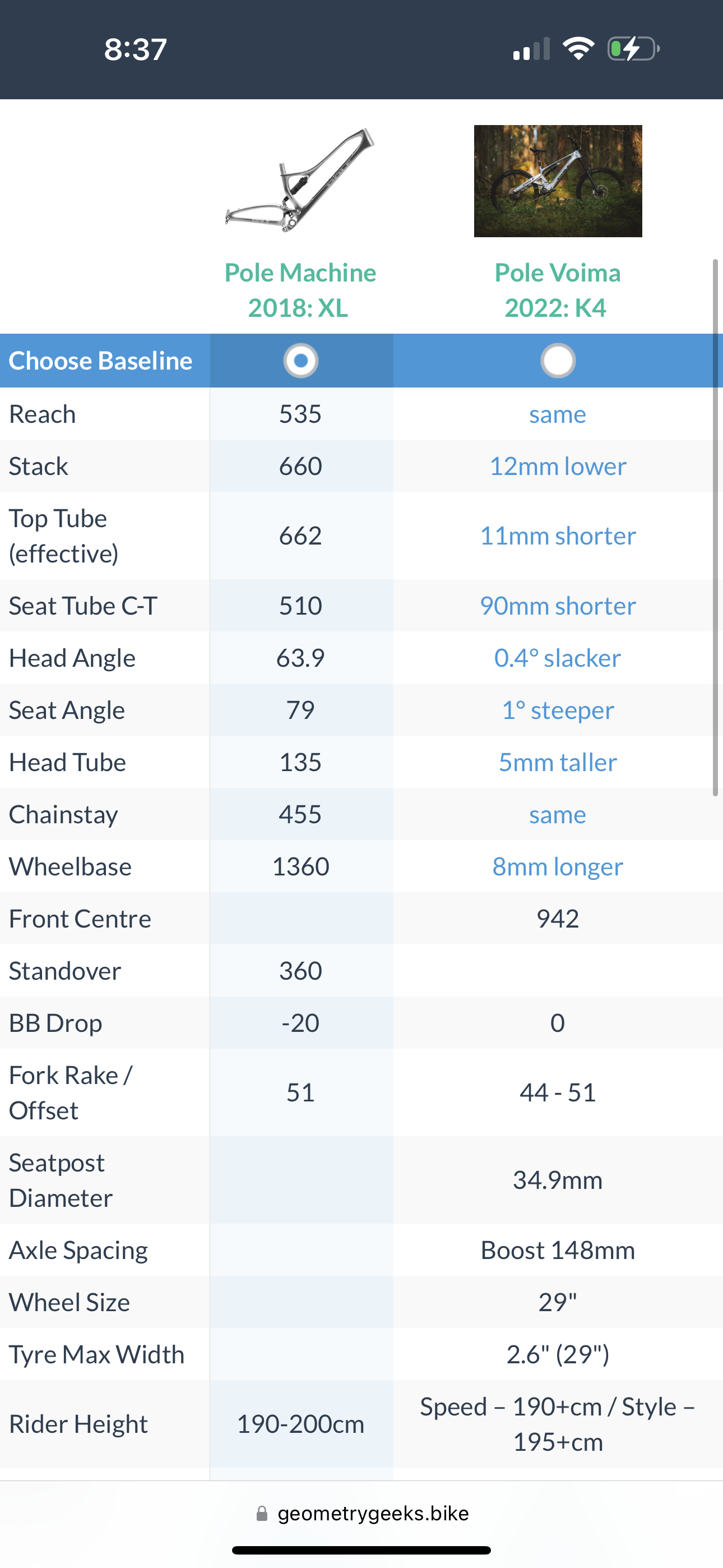

Man, everyone is really different =)
I found myself wanting to slide off the seat to get more comfortable on K4 voima. Will be installing 50mm stem instead of 35.
Being 196cm tall Machine is the perfect size for me, a bit on the planted side though, but I like it that way. Still can throw it around if I want to. Voima feels tiny bit shorter, but it has different stem and handlebars and harder to throw around due to weight and probably need higher bars. Still dialing it in.
