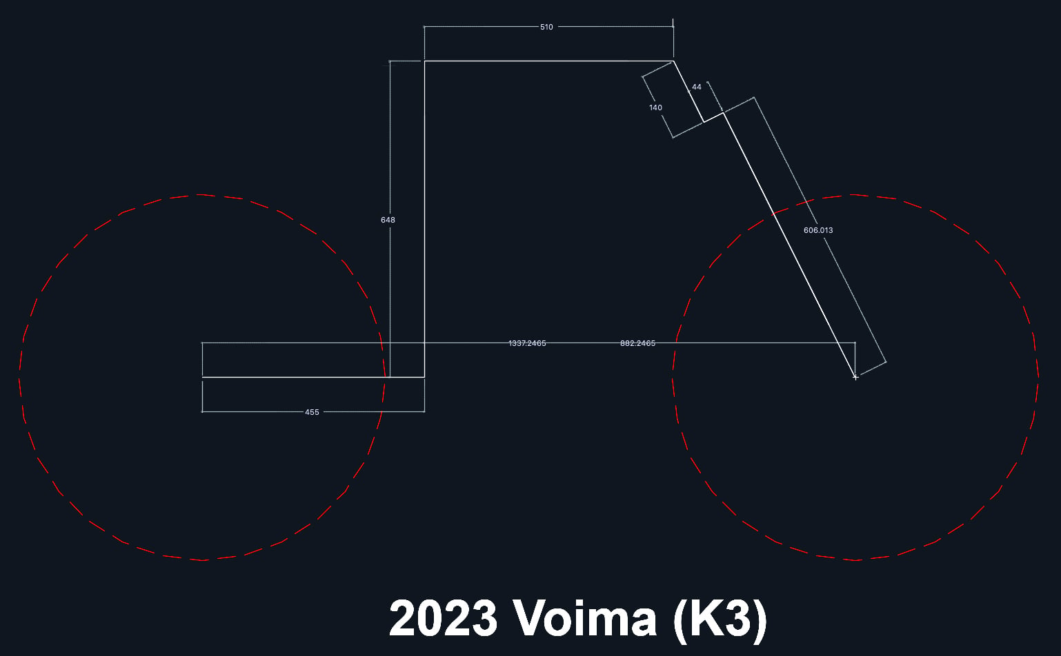

Quick and dirty Autocad geo diagram of a K3 below. Front center (and wheelbase) derived from stack/reach/head tube/etc.
Fork ATC clocks in at 606mm which is right on the money for a ZEB 190, so if the published 510mm reach is correct then this front center should be accurate.
K3 Wheelbase = 1337mm
K3 Front Center = 882mm
As a side note, with the exception of the BB drop, the k3 front geo is pretty similar to my 2022 XL Norco Range with a 180mm fork. Reach is the same, stack is slightly less, and the front center is almost identical. I guess the Voima Geo is not so wild after all.
Assuming we’ve correctly identified the incorrect front center number, Pole would do well to fix it on their geo chart - it almost put me off from buying the bike, and I’m betting I’m not alone.

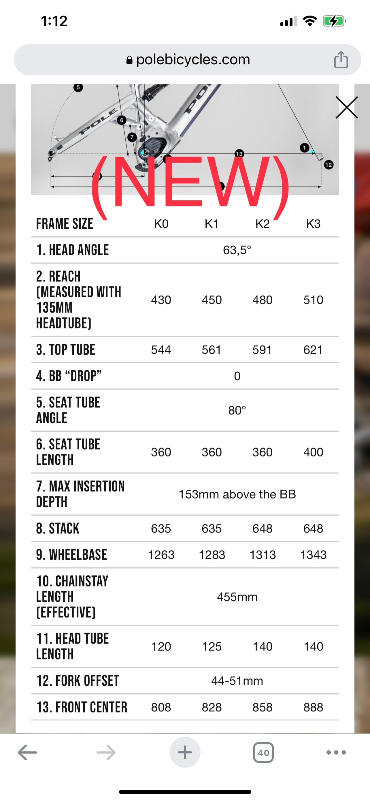

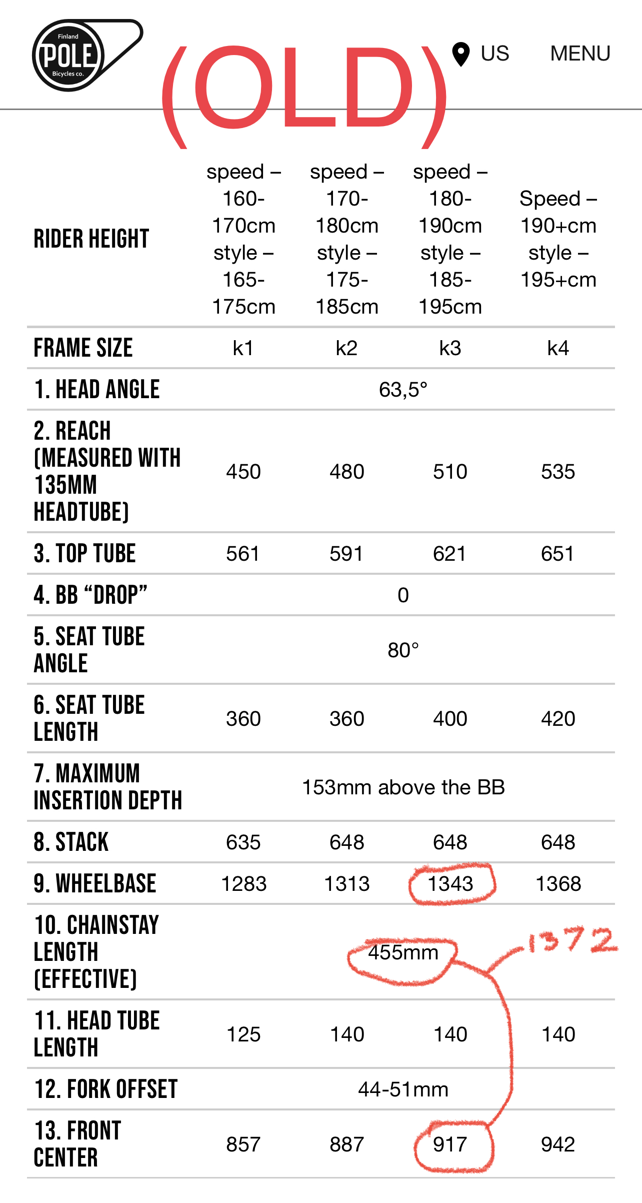

Front Center and Rear Center (chain stay) should add up to wheelbase.
Pole previously had incorrect numbers in their Voima geo chart for front center, although rear center and wheelbase were correct. Seems they had accidentally transposed the K4 front center over to K3 and so forth (we are all human). They’ve corrected it now with the new chart that eliminates the K4 and adds the K0.
I was relieved to find that it was indeed a mistake, because I didn’t spot the HUGE (incorrect) front center number until after I’d ordered, which had me in a bit of a panic TBH.
Previous and current geo charts below in case you’re interested (nothing about the geo has changed, they’ve just corrected the front center number).

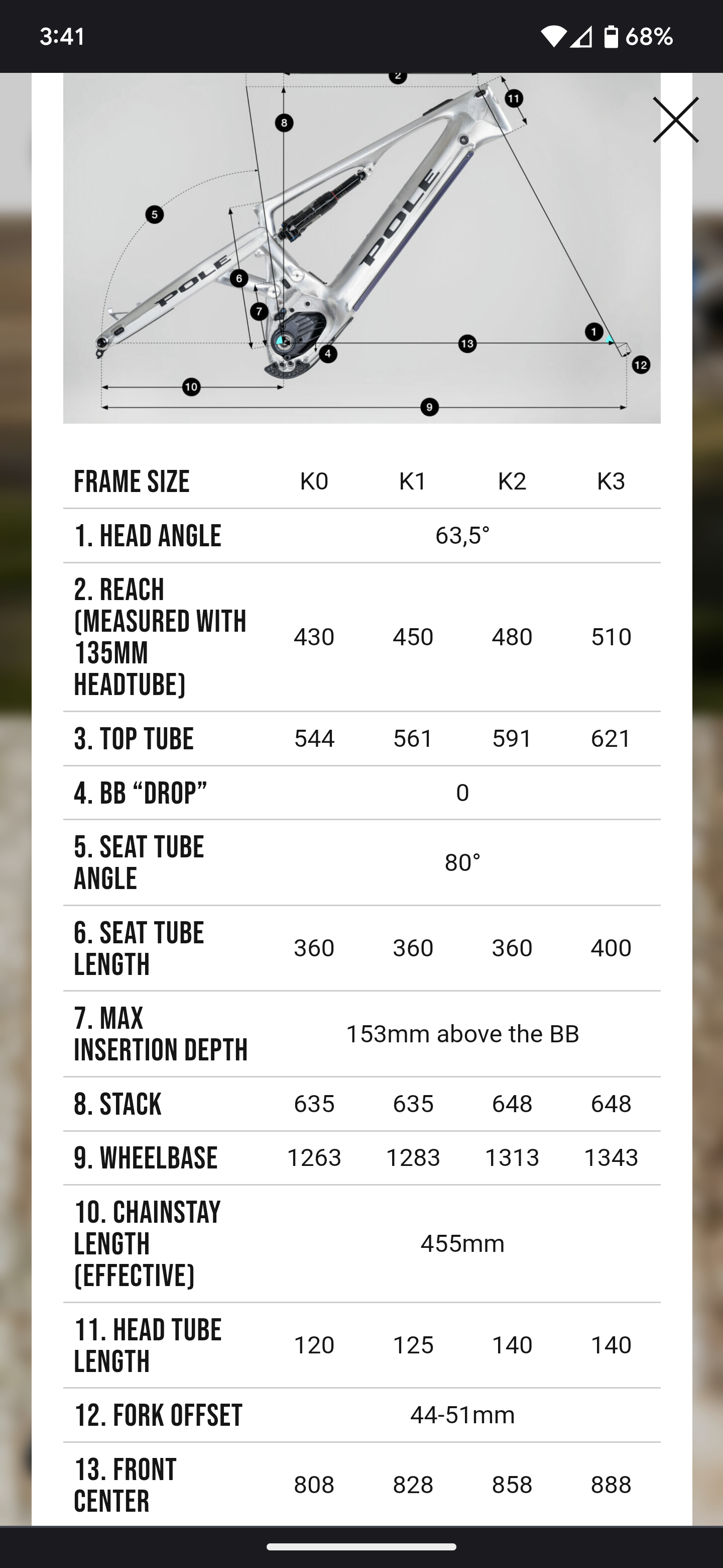

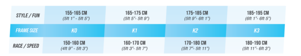

I’m planning to order a frame once I clear out some of my amish bikes, I was going to order the K1 because it was the smallest size. At 5’6 I typically ride smalls in most bikes, my Levo is a S2 and I tend to prefer around a 430-435 reach. Now I see the K0 size with my preferred reach but the top tube is extremely short. Should I stick to the K1 or go with the K0?
Plummet
Flash Git
Mar 16, 2023
1,178
1,659
New Zealand
I went through the same battle, as do most Voima buyers. My decision was to stick to the reach dimensions that I like and withstand the shorter TT. That appears to a common trend, particularly from descent orientated riders.
PS, I'm 5'11 and getting a K1.
At 5'6 you are firmly in the K0 size.

On that note, just got my K3 built up and I’m measuring front center at 880mm with a 190 Zeb. That’s 8mm shorter than the most recent geo chart (and I’m definitely not mad about it).
Yeah, that’s the direction I was leaning. I sold my DH bike today so that’s one down. I’ll more than likely pull all the components off one bike to use on the Vioma so I’d be running a 50mm stem anyway. That will give me some length back in the TT.
