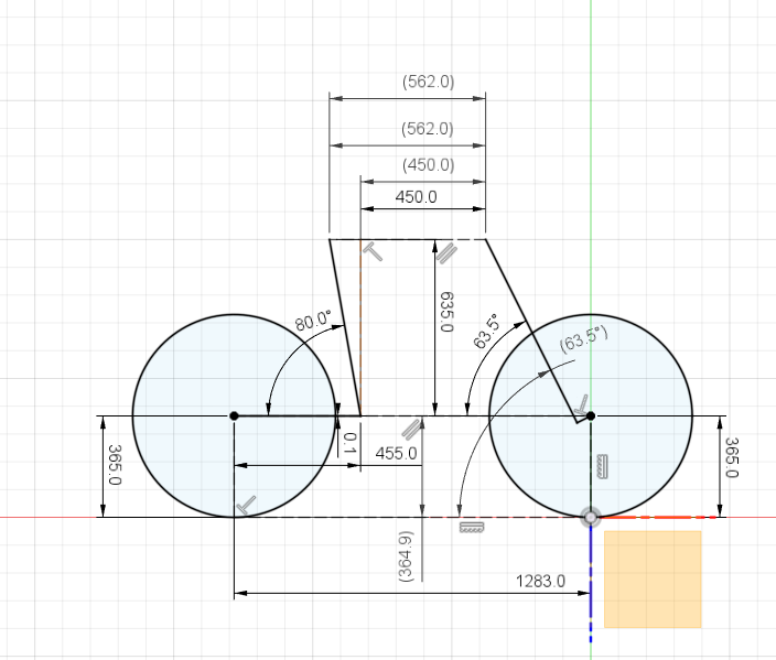

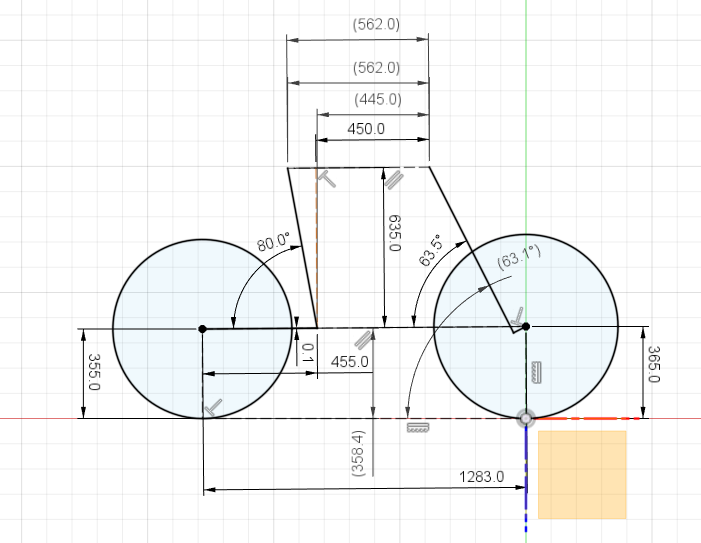

I created a drawing to see what would happen if I mulleted the Voima.
For anyone who is interested.
K1, 29er mode.
K1, Mullet mode.
Reach decreases 5mm
Head angle slackens out 0.4°
BB drops 6.6m
K1, 29er mode.
K1, Mullet mode.
Reach decreases 5mm
BB drops 6.6m
What size tyres did you base this on? I recall when doing the calculations for mulletting my bike, a 29" wheel was about 20mm taller from ground to axle v the 27.5", not the 10mm you have.
