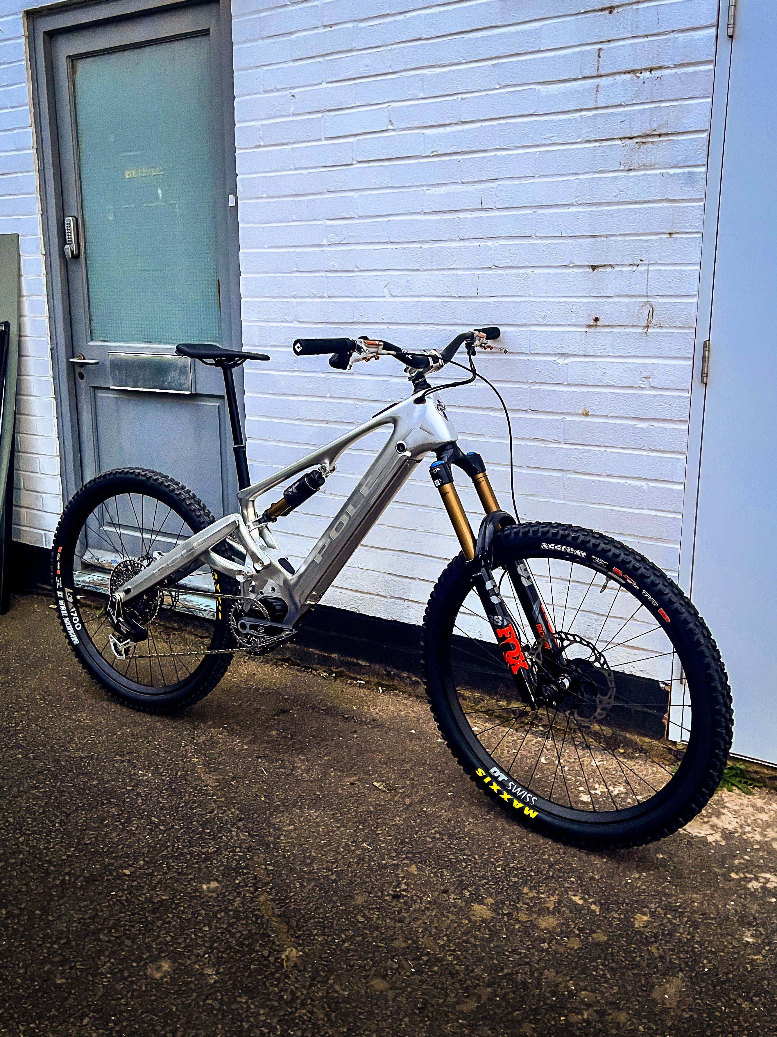

Got my Voima ID after my factory visit. The factory is amazing really, the work they achieve and attention to detail is superb.
It really is such a unique manufacturing method to these bike. Leo can make any design changes as required and send to production immediately - the very same day a frame is produced with that change.
By the way, I got a K2 and am 190cm 😊
View attachment 110641 View attachment 110642 View attachment 110643

190cm / 6’3” and can ride anything from 480-515mm.
I plan to put a +5mm works reach adjust on this.
Interesting, so you are under sizing almost by 2 sizes. I'm interested to know why.
Wheelbase too long in the k3 size?
Assumingly TT is way shorter than your normal spec.
Rob Rides EMTB
Administrator
Staff member
Jan 14, 2018
6,292
13,853
Surrey, UK
Long wheelbase, 63.5 head angle and 190mm travel = inherently stable, opted for shorter reach to make it feel as lively and agile as possible whilst still retaining stability.
Will run 50mm stem and 50mm rise bars. If it’s shit and I prefer K3 I’ll let you know!

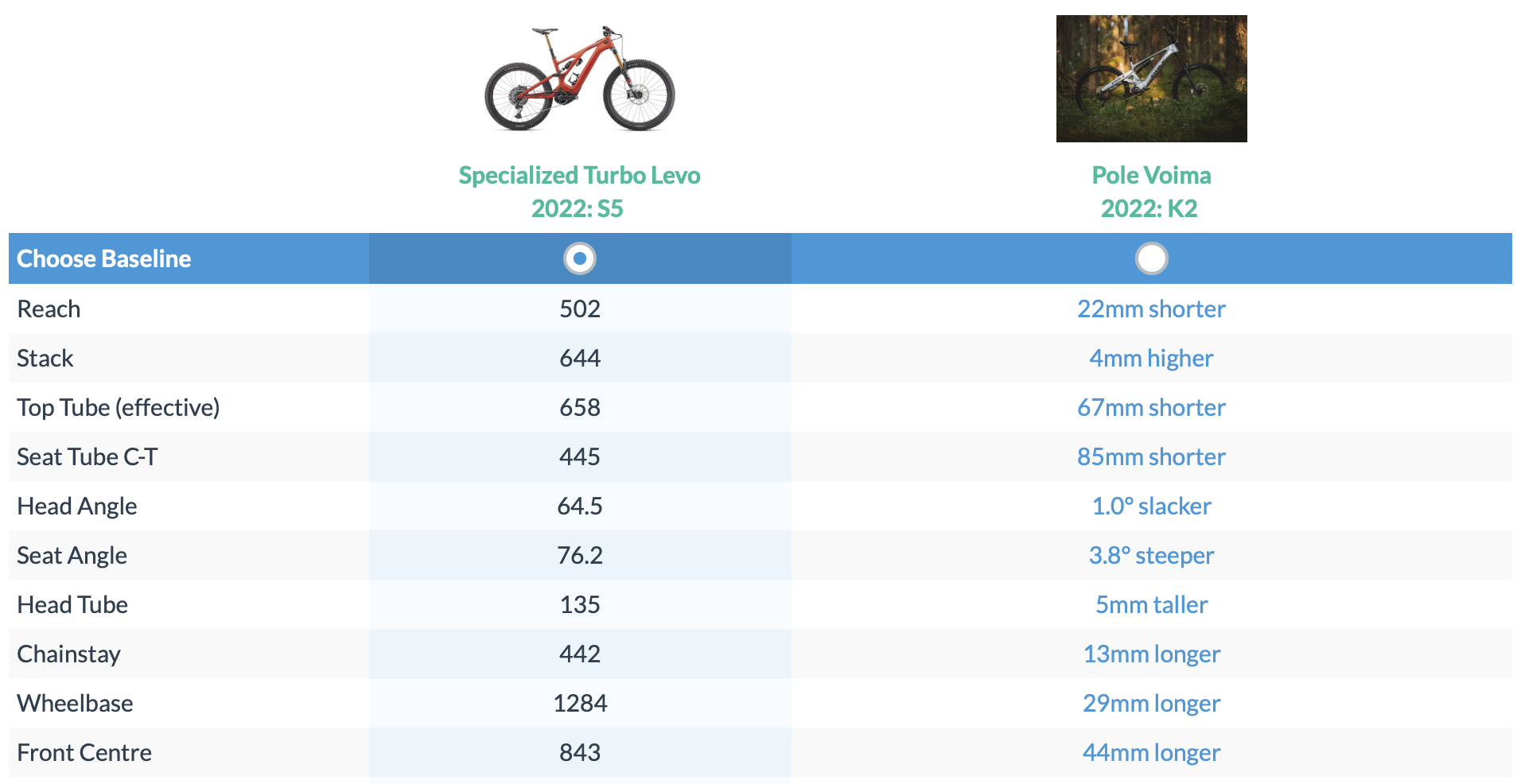

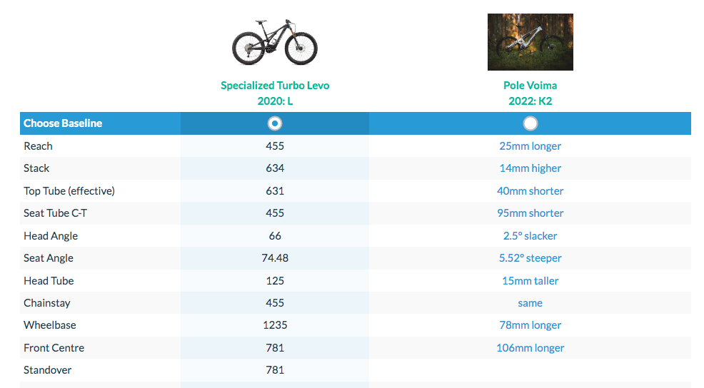

well damn, my Large Levo is 455 reach with 1235 wheelbase
My XL Levo had a 480 reach with a 1266 wheelbase
you're still a brave man ! but if it fits you it will deffo fit me

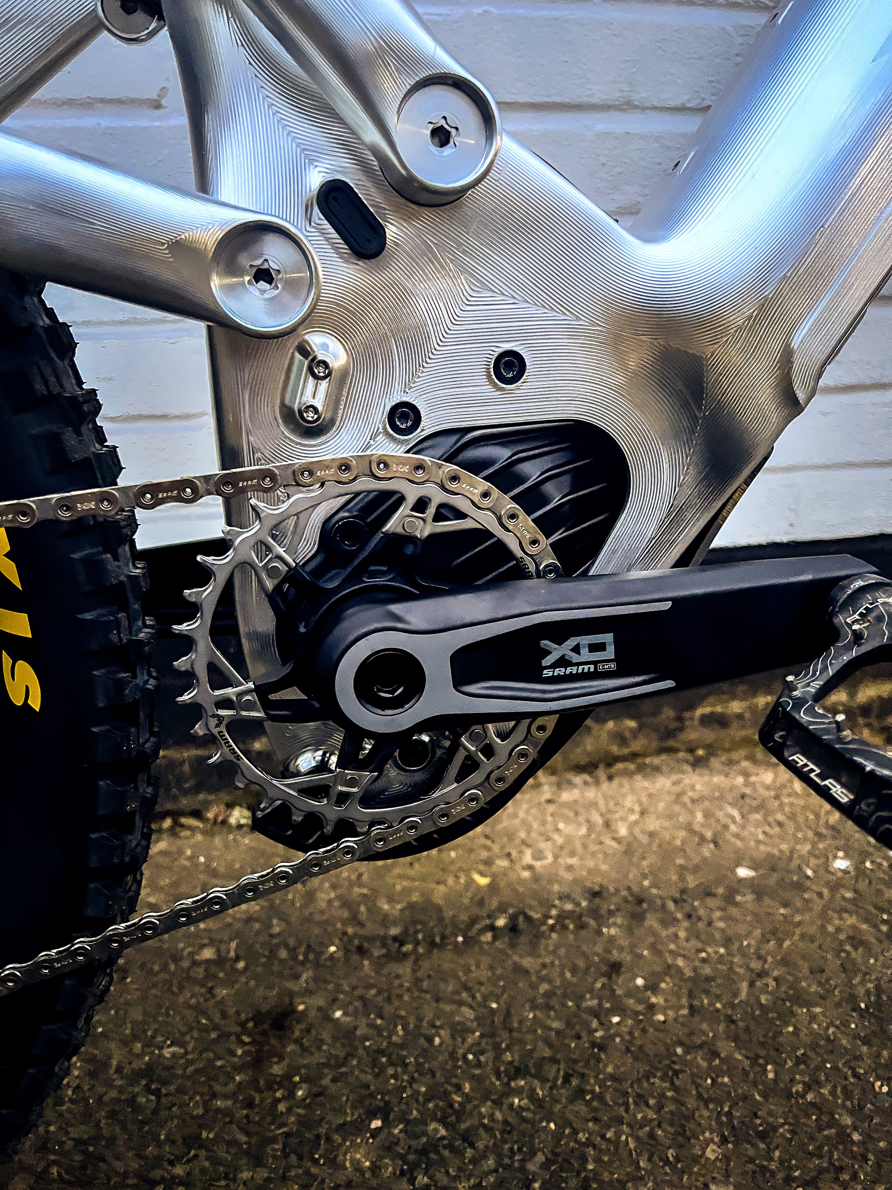

No chain guide required with the new Sram?
Looking good 🤙
I ran the new SRAM without a guide for months and no issues. So will see how it goes on the Voima 👍
In terms of sizing @dobbyhasfriends - overall geometry is the most important factor to consider IMO. For example, I’d prefer something a bit longer if I was riding a 65 head angle and 150mm travel bike - because it’s not quite as stable / forgiving on the steep tech. They can feel a bit twitchy, especially if short reach and short wheelbase with steeper head angle.
For the Voima, wheelbase in K2 is still longer than most L and XL bikes. It’s slack, and has long travel - and it’s just so stable with this geo. Reach at 485 is totally doable.
I still have the K3 demo bike so can share more comparisons when I’ve ridden the K2, but after a quick test it feels great so far.
In summary=
Slack bikes, long travel, modern geo = can go shorter
Trail based bikes, conservative geo = a bit longer

K2 works amazing for me. I know it sounds crazy to a lot of people but sizing down on these bikes is totally doable. Having spent an hour or so on the bike today it’s so much better to ride than the K3.
There’s a lot of scope to move things around with bar height / backsweep / stem length etc to fine tune fit.
I’m 190cm / 6’3” and with the 480 stock reach and the +5mm works components reach adjust the bike handles sweet.
Had a knocking sound coming through the bike that I had to solve. Fox X2 is already toast sadly. Super Deluxe back in and knocking sound has gone!
Bike is superb, so happy with how it rides.

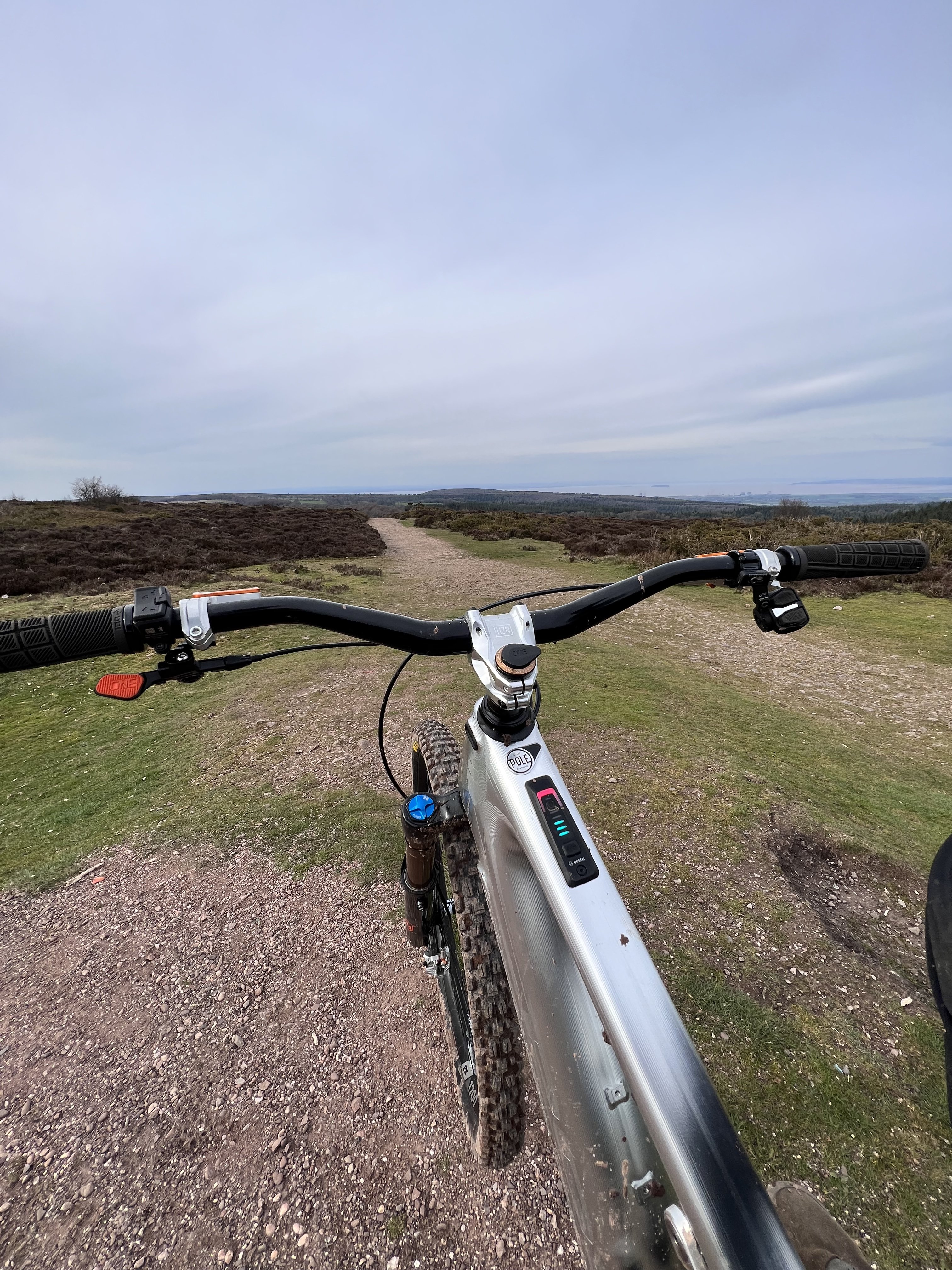

@Rob Rides EMTB what handle bar is that?
It’s interesting that you are now liking shorter reach bikes. It wasn’t so long ago that you wanted long reach and builders to extend their geo to accommodate larger riders. What’s changed?

Rob Rides EMTB
Administrator
Staff member
Jan 14, 2018
6,292
13,853
Surrey, UK
Its from a brand called Title. Great quality Alu bars (mines 31.8)
Definitely wanted longer bikes - most bikes 2-3 years ago were 480 reach, 150 travel and 65 head angles. Longer reach for me helped with stability (less crashing / over the bars!), as well as a general feeling of 'fitting' on bikes with bigger reach.
What happened also is that bikes reaches grew, but proportianally, the rear centres actually got shorter. So the bikes in my size became too unbalanced (weight too rearwards, because 520 reach short chainstays on ebikes is not ideal for me).
As bike geometry has evolved, we now have 63 head angle, very long wheelbases (Voima in K2 is 1313mm!) and 190mm travel. There's less need to have a very long bike, because the bike is crazy stable as it is. And with the Voima, its 455mm chainstay and 480mm reach, its extrememly balanced when the rider is standing on the bike with the pedals weighted. I no longer have to shift my entire body weight forward to get the front tyre to grip on corners.
As my riding has progressed I've also found that I like a more nimble / easier to corner bike, and have found that I can have my cake and eat it; stable, planted at speed, slack, long travel, but also corner easier and a better balanced overall bike.
So with my bike now, 190mm travel, 63 head angle, 1313 wheelbase, 485mm reach, its a great all rounder. I can ride DH trails or pavements to the shops. I'd do a 30mile XC loop. Or Fort William (well, the 'doable' stuff for my skill level!).
Also, to add, reach is one single factor in bike geo and I think that its quite easy for us all to get too hung up about it. It's about the overall package. You can easily move things around to account for 20mm reach and your body will naturally adapt to sizing quite quickly (obvs someone 6'7" would bee foolish to bike a XS bike, but you get what I mean!)
Look at the wheelbase and front centre of the Voima. The Voima wheelbase, even on a K2 is 29mm longer than an S5 Levo, and the front centre is 44mm longer. So an S4 Levo will feel short (more than just a short reach, its a short bike!)
dobbyhasfriends
🌹Old Bloke 🎸
Sep 19, 2019
3,261
4,649
Llandovery, Wales
really assures me that the K2 is the right size for me, im 186cm and when you compare what im riding now with the voima it all looks right. My levo is too short for me when standing but perfect when seated.
I have to lean over the front to get weight over the front tyre quite a bit and that leaves (in some situations) perilously close to tipping over the front.. I want the voima..
