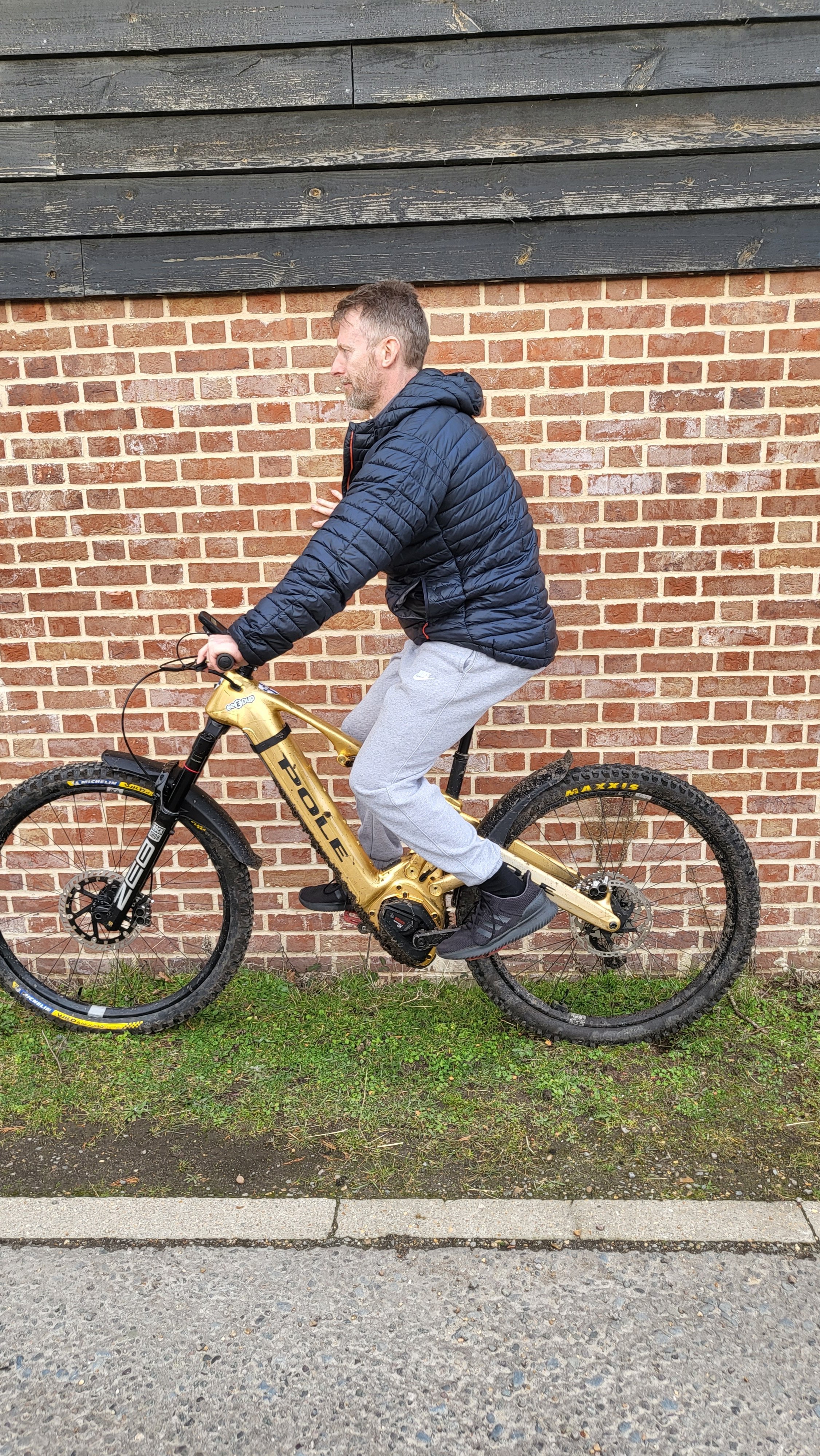

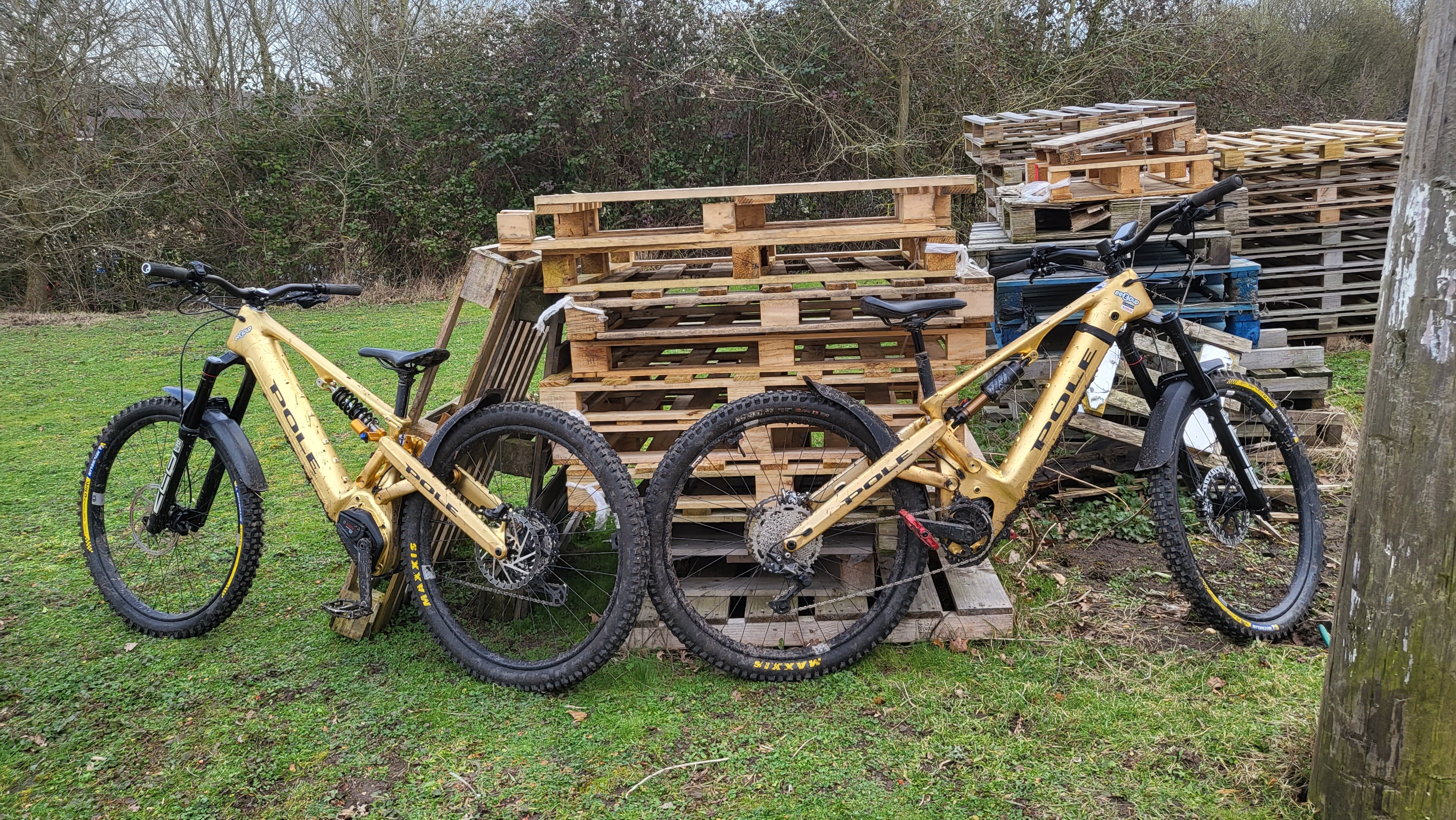

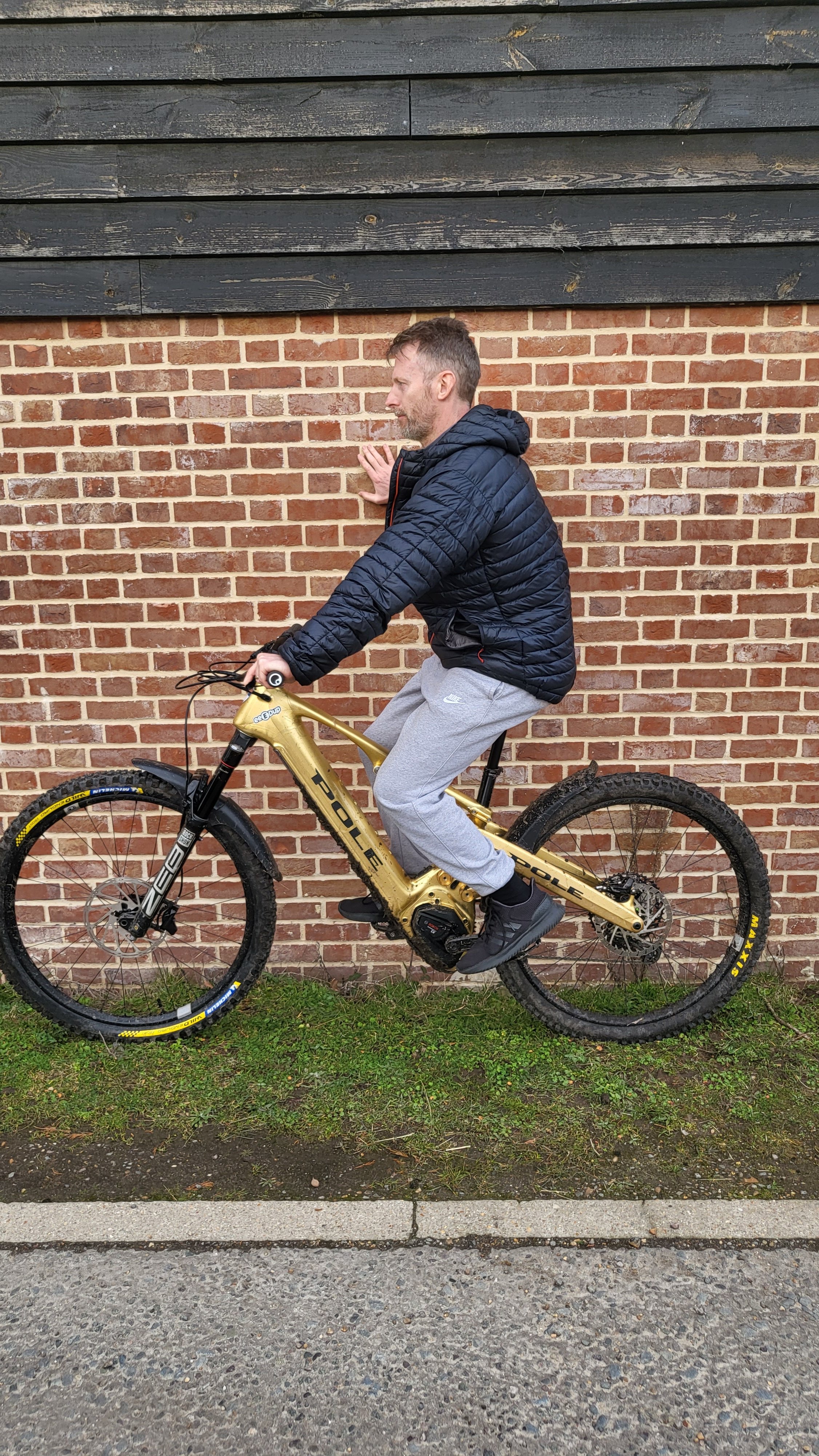

I've just ridden both today.
I'm 175cm and currently ride a medium 22 Rail.
I could ride both the K1 and k2 fine, but I can manual and wheelie the K1 easy, where as I couldn't manual the k2 at all and could only wheelie it with a lot of effort.
The K1 was set up with a 50mm stem and 40mm rise bars, where the K2 had a 30mm stem and 30mm rise bars. From the cockpit, the K2 was still fractionly longer, but not much.
I was all set on a K2, but I think it will now be the K1, it was so much more playful.
Me on K1 on the bottom and K2 on the top, for size reference.
View attachment 109382 View attachment 109383 View attachment 109384
they both deffo fit you, the K2 looks like a better fit though. It looks like the K1 would be cramped, did you do any downhill on the test ride ?
Oh for awesome. That's pointing me towards the K1.
Unfortunately they are based in Colchester, Essex so no proper down hill, mainly trail riding.
But I could really dominate the K1, where the K2 I could ride just as fast, but when it came to trail features i.e logs etc, I could easily bunny hop them on the k1 but clattered over then on the k2.
I can't manual, I can't manual my current Rail, where today on the K1 I pulled the longest manual I've ever done a good 20 yards! I reckon I will crack the manual on the K1🤘

Helpful pictures
Them pics were very useful thanks. I agreed the k1 looks a little short. I don't suppose you have standing pics also?
