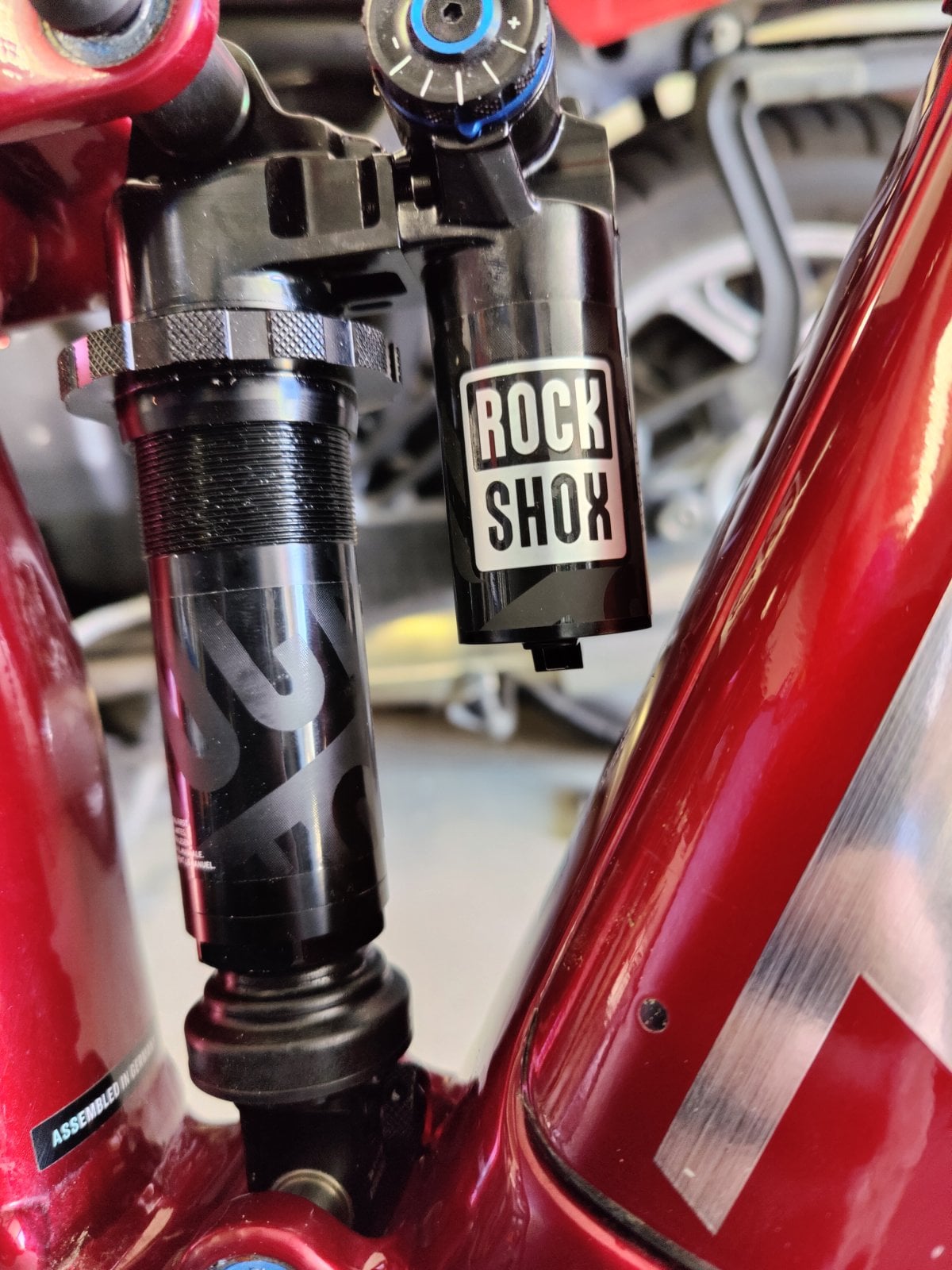

I made a 5mm spacer to reduce the stroke to 57.5mm. This is me just sitting on the bike and the gap to frame is 3mm. I couldn't make the shock to touch the frame by bouncing on the seat but that's not a real world test.

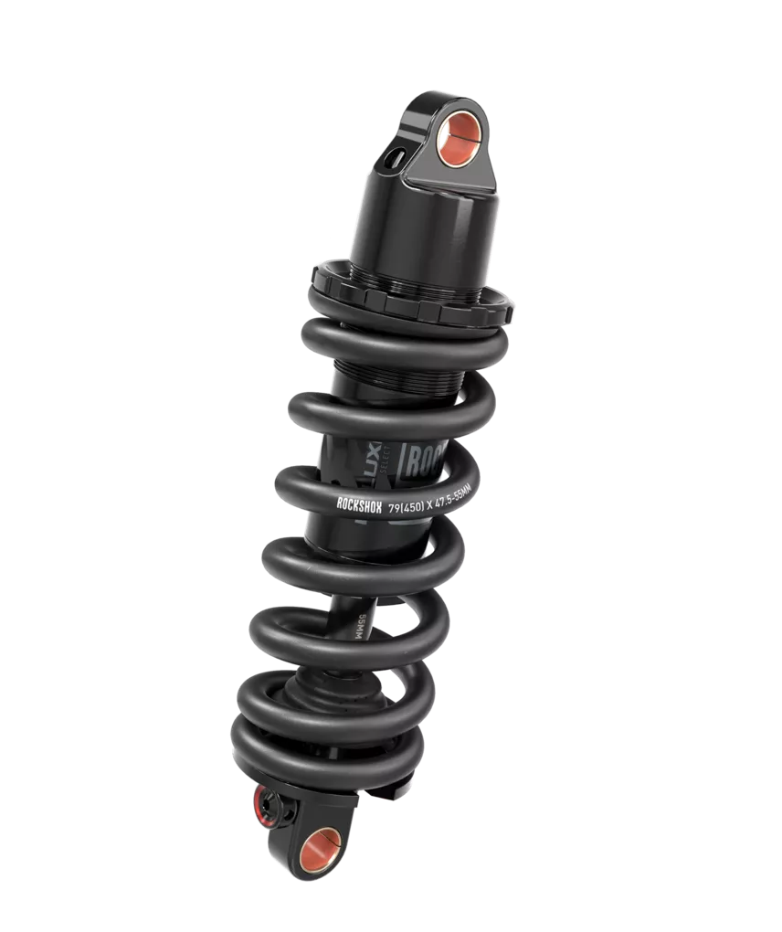

Waiting to see if the new Deluxe Coil Select is any good.. looks like it should fit with no issues. Comes in 230x57.5, 230x60, 230x62.5, 230x65.... Standard and trunnion mounts.

Could be a decent basic shock, the compression tune would need to be spot on as there's no adjustability. No doubt they'll come with a stock MM tune for aftermarket. If they come as OEM then people will look to upgrade making this possibly a very.good cheap shock for the tuners out there.
Thanks for that. This is something I was wondering about as I look for a new shock for my Rail. Looks very close at 57.5mm stroke. Any idea if the air versions have smaller piggy backs or have them oriented differently to the coil? Im still between air and coil but leaning towards air as I like the versatility for my Rail as it is my do it all bike.
With that amount of clearance I may even be tempted to try it. My Rail is pretty beat up at this point. Im a RS fan and these new shocks look very good. I just upgraded to the 2023 ZEB Ultimate on the front would be nice to match it on the rear.

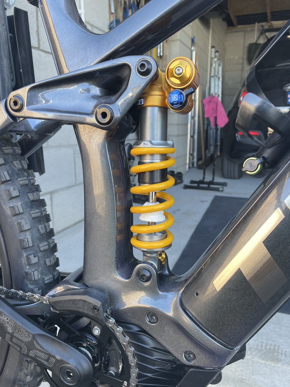

Anyone Else here with öhlins ttx1air?
Just installed it yesterday, but can't get to test it until new fork shows up.
Ttx1 fits easily but i'm wondering that my shock can says 250psi max and the manual says 300psi max.. Do i have some early iteration of the ttx1 or what gives?
Just installed it yesterday, nut cat get to test it until new fork shows up.
Weird, Ohlins website says 300 Max psi, but if you zoon in on the product photo you can see on the cans warning label it says 250
Well, i sent a question to the local official öhlins dealer for them to ask the factory.
Nice thing to see that they actually support using oil as air spacer, so no need to disassemble the shock from the bike.
Got a reply from Öhlins that the max. pressure for ttx1air is 300psi. So i guess the sticker on the shock is old info they didn't bother updating

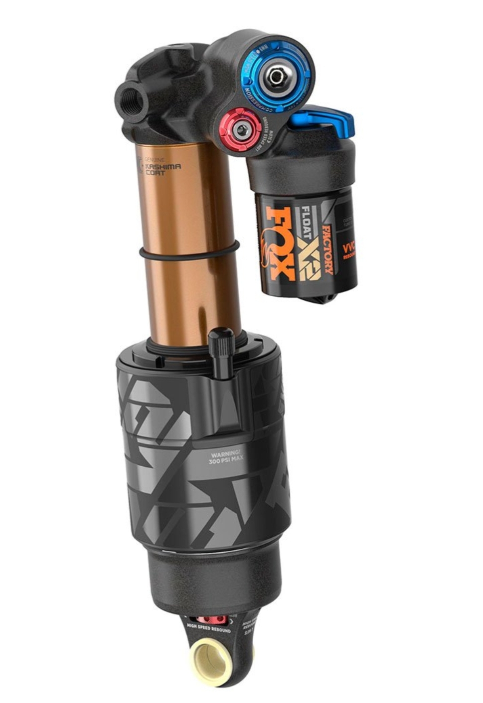

Does any one experience on S size 2022/23 rail 9.7, is it suitable fit on Fox Float X2 Kashima Trunnion Shock 230x60 ?
Beside,
S size 2022/23 rail 9.7 is same geometry?
