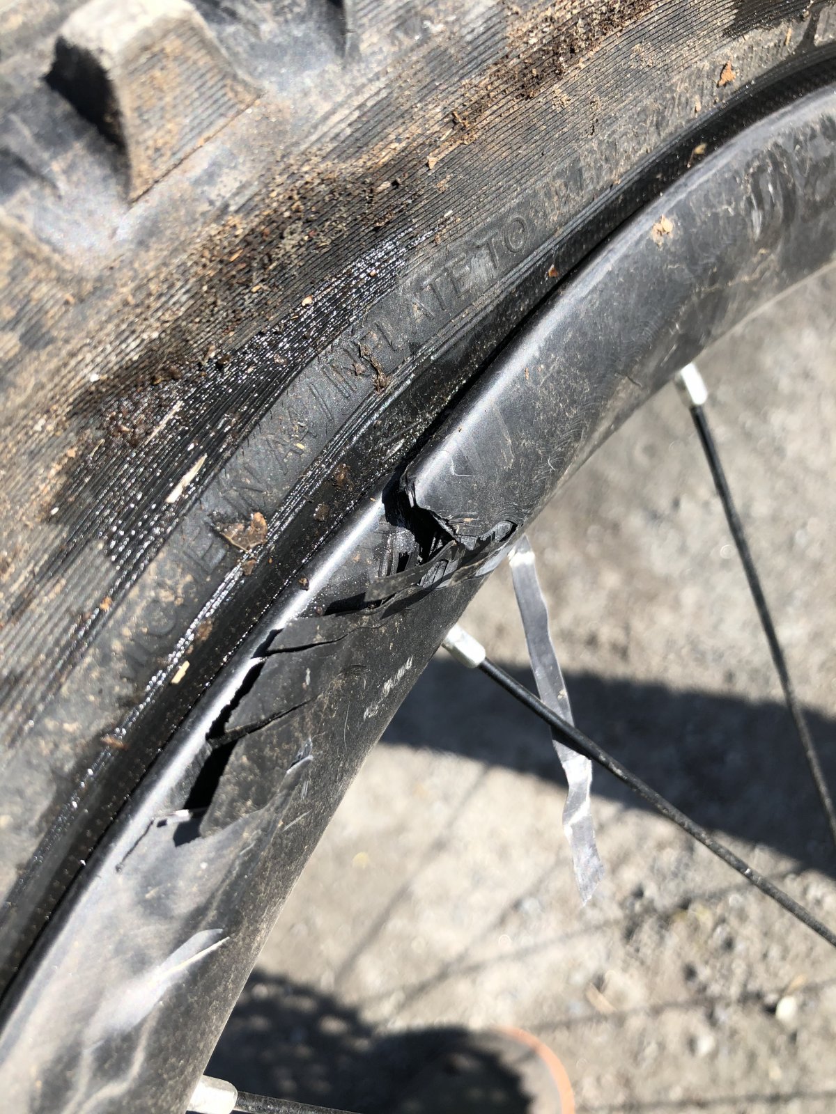

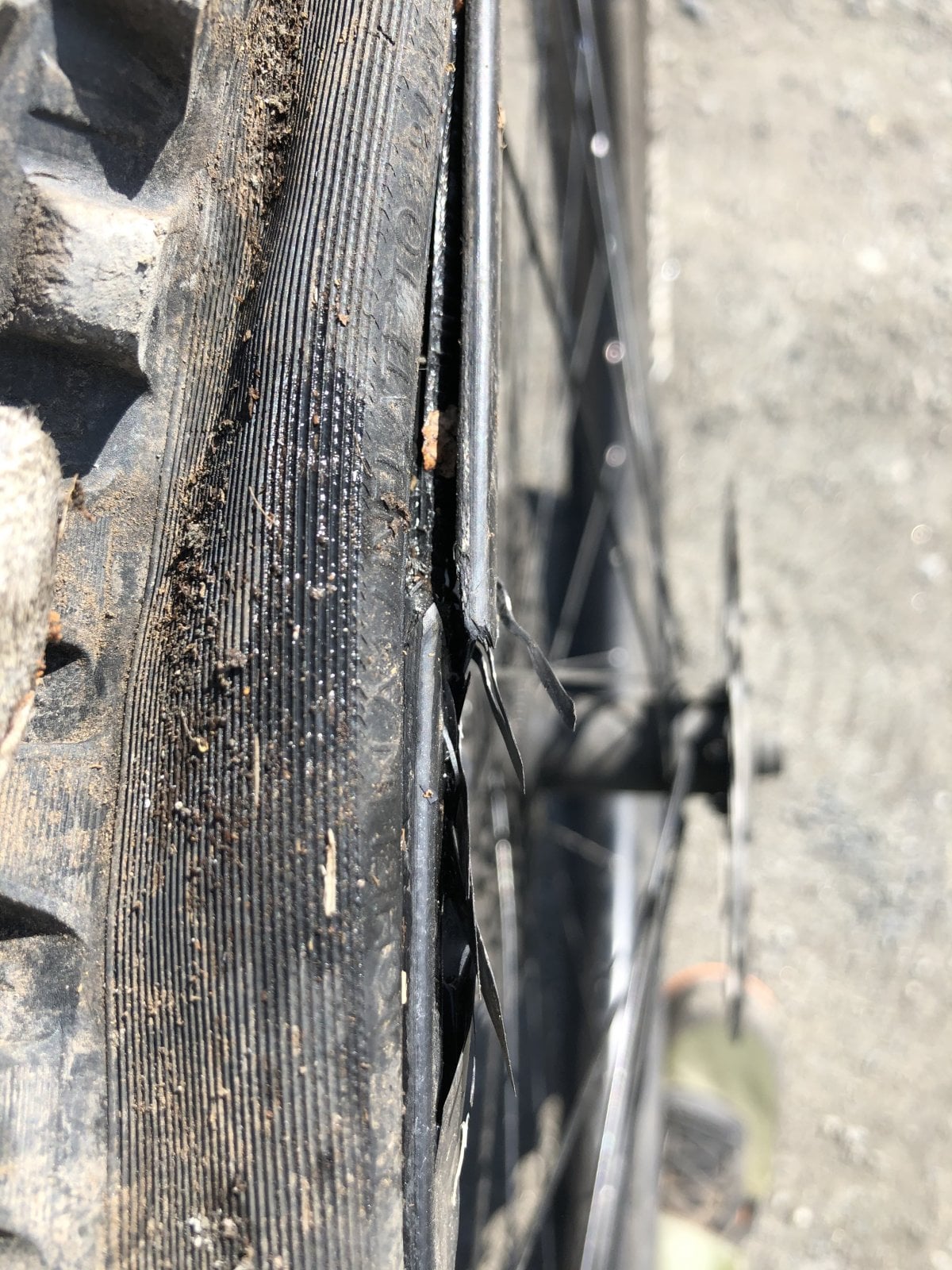

My original Alu rear looks like a mess after a 8 months. Bought a set of Carbon Bontrager for a very good price. Was very happy with them for 5 weeks until I blew the rear one apart yesterday.

Yup. My friend trashed his first set as well. Should probably put some cushcore in the replacement rim when it arrives

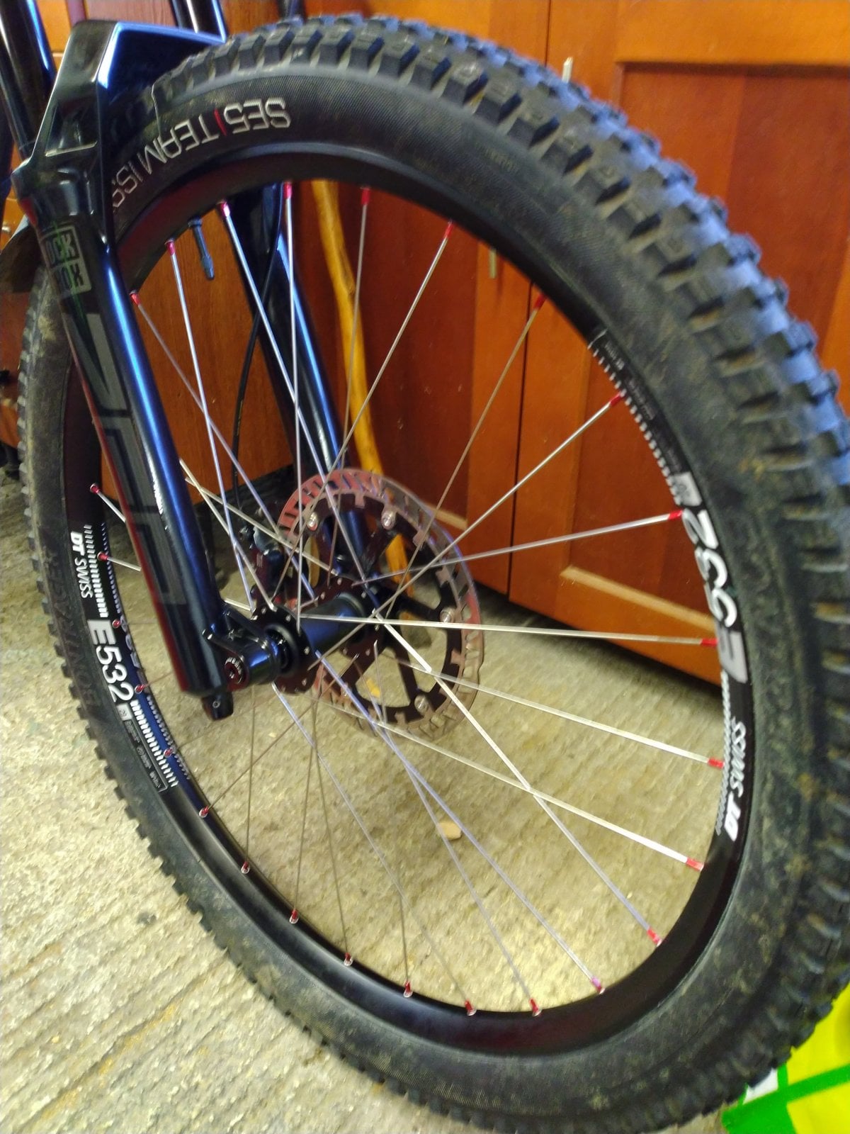

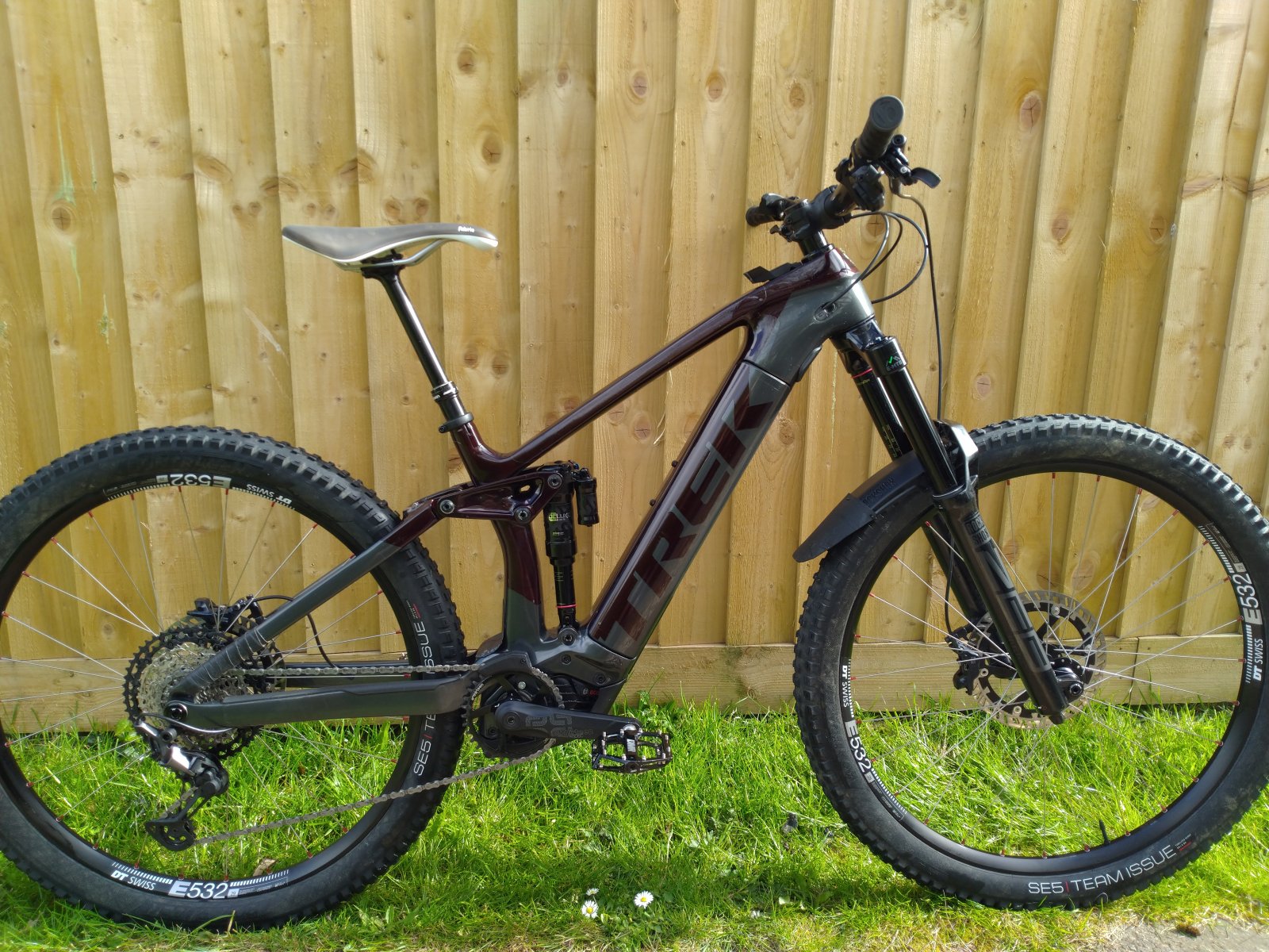

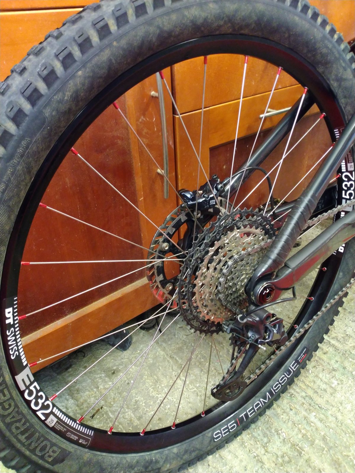

So a quick update, replaced the line comp 30 rims with DT E532. Used the bontrager hubs, DT double butted spokes ALL of them at 284mm long and 14mm DT alloy nipples. I always oil the threads and eyelets when building. Was a nice easy build and the silver spokes with red nipples look old skool cool ?
At least now if I demolish a rim I can get one off the shelf.
While I was putting the back wheel on I noticed the chainring was loose, like really loose. 7 months of trouble free riding and the bloody thing has decided to start playing up! At least I caught it before it chewed my chainstay to bits.
