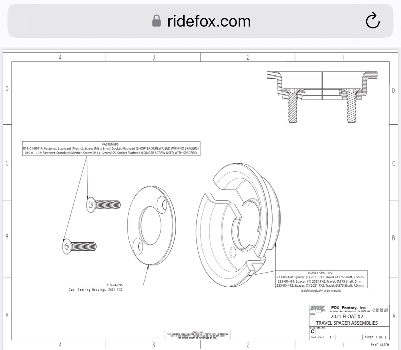

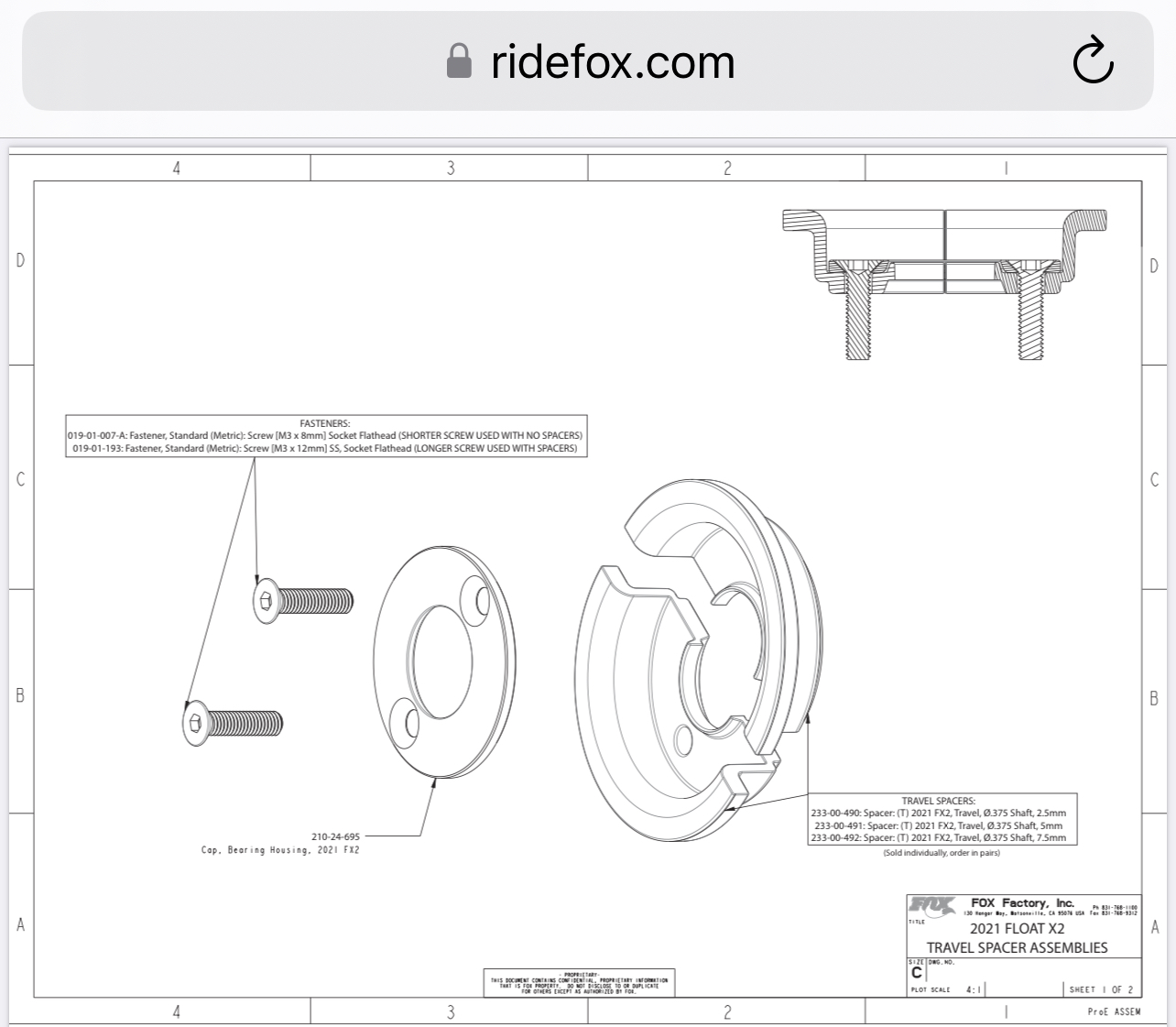

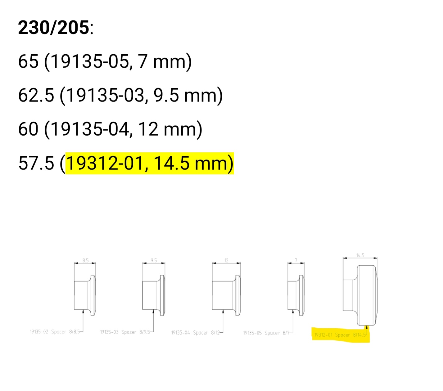

Can anyone give me a place in the USA that would sell the travel spacers individually and not in a package of 5. This is the style I’m needing. Thank you

I have read every single one of these posts. 60 is the confirmed I was asking if anybody recently has done 62 1/2. Thanks
If you had read through them you would also realise there's sometimes a can fitment issue between frames as the X2 can runs extremely close to the seat tube not all bikes but some
Personally I find the X2 far to unreliable to use and would go for something else.
And here's the result of a two second search 😁

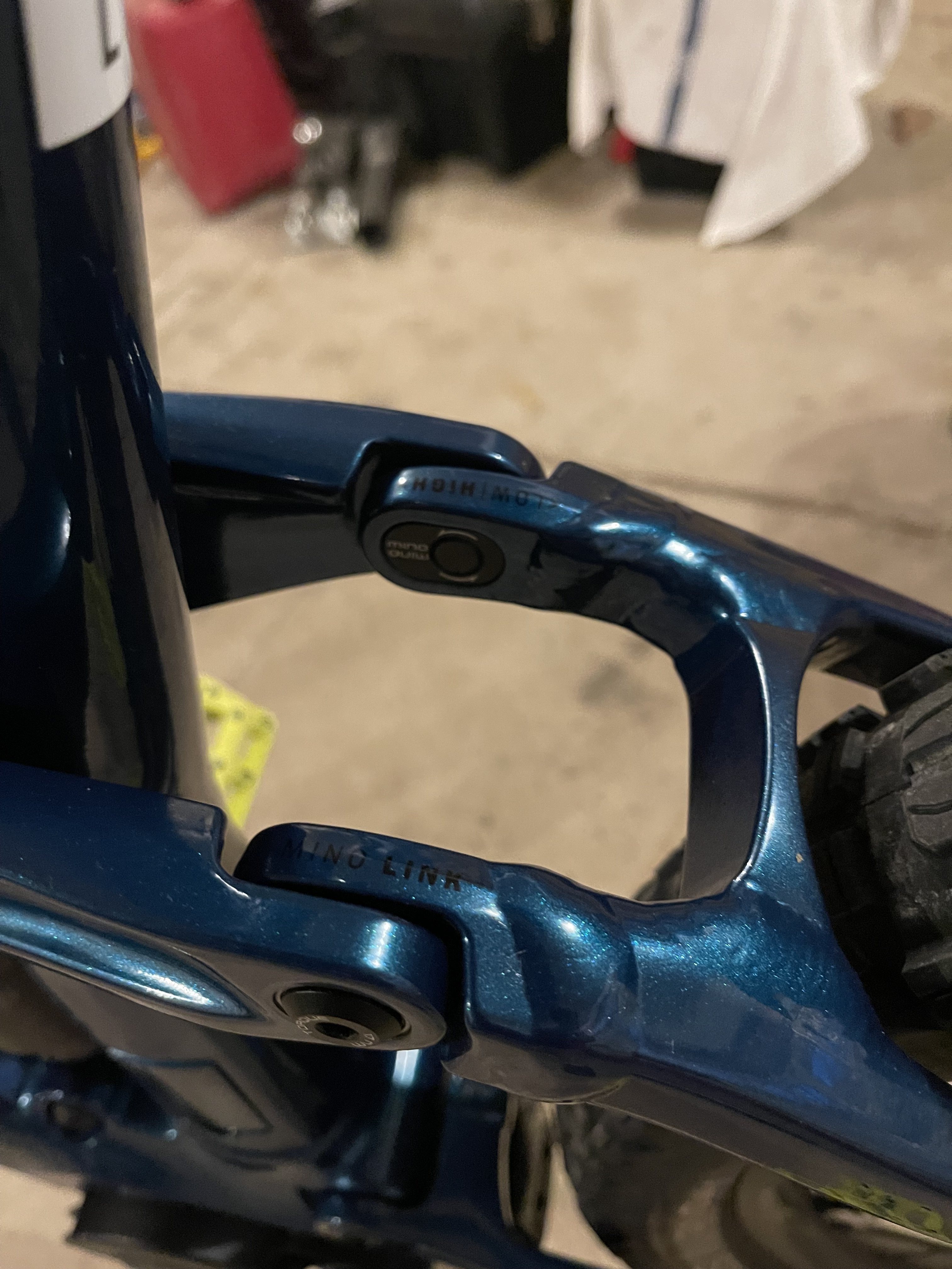

I’m assuming now my flip chip is in high. Here’s a photo of the position it is in. Not really sure how to read it but with the set up that I am running I have no issues with clearance.

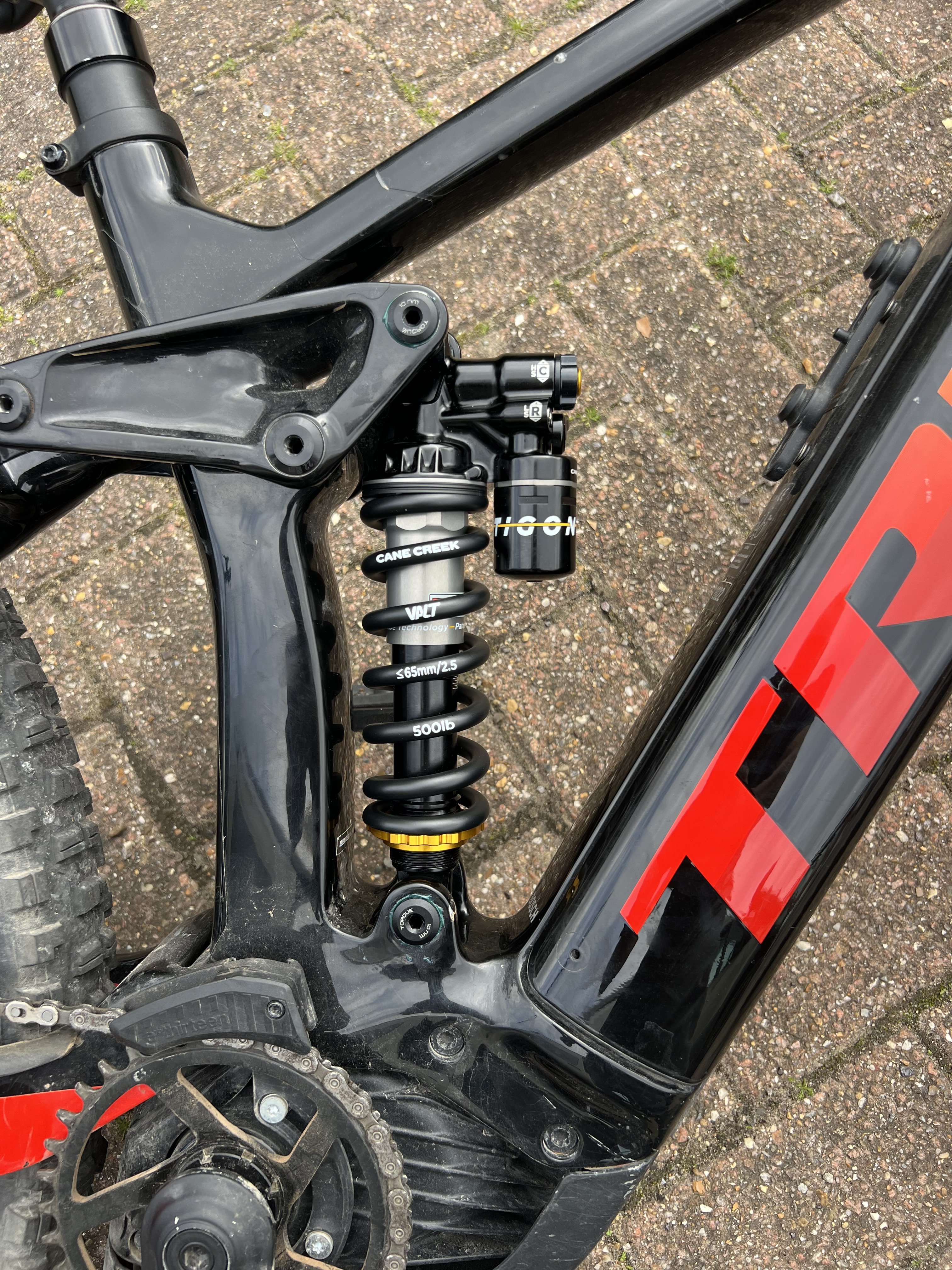

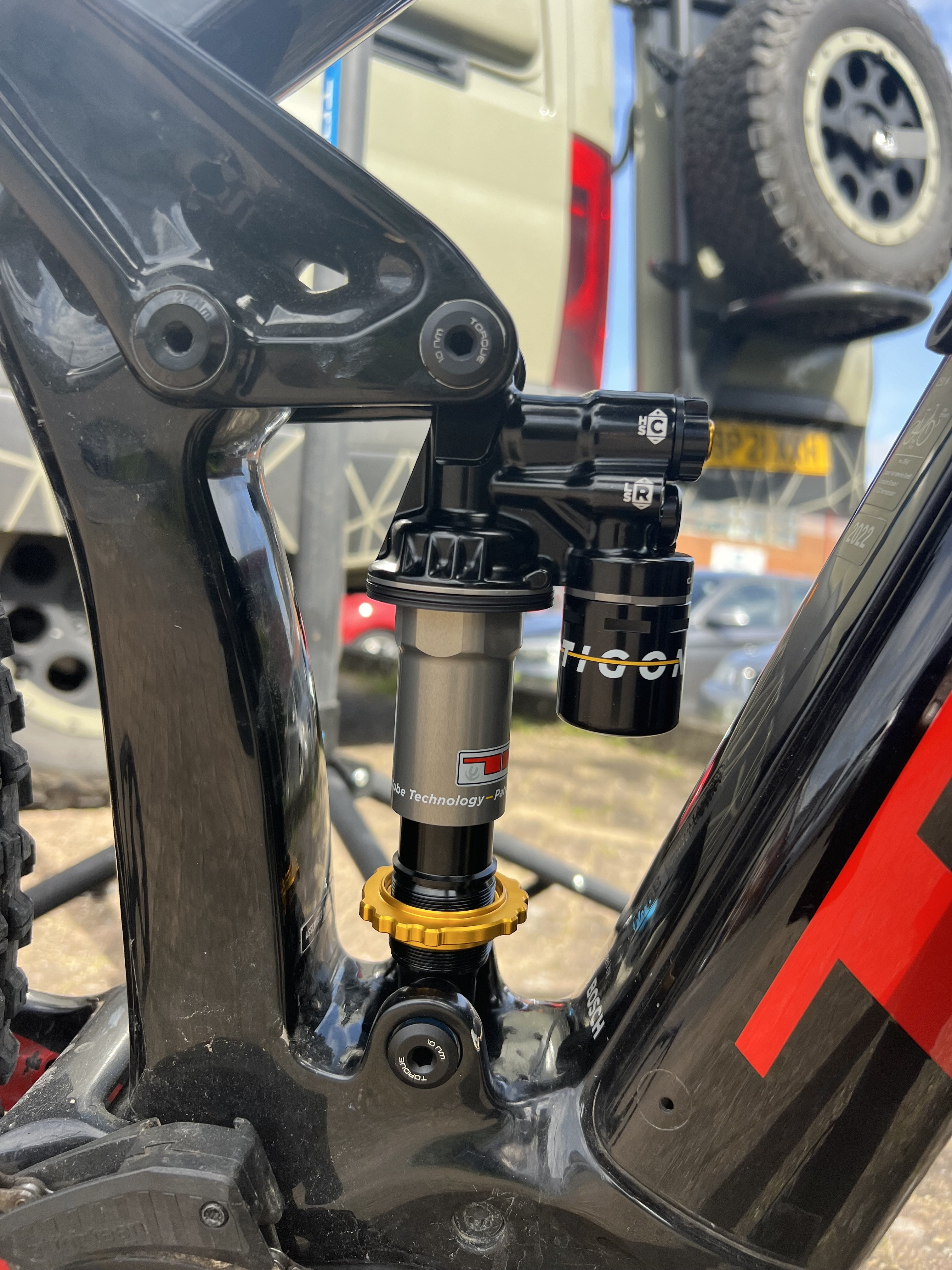

irie
May 2, 2022
3,117
3,216
Chichester, W.Sussex, UK

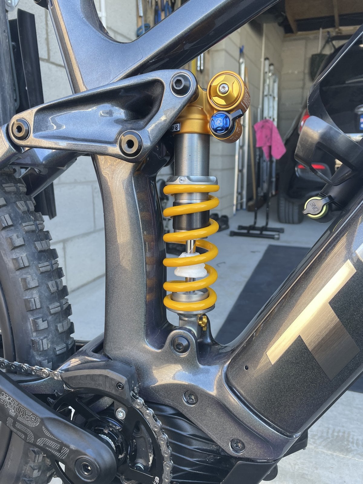

Hiya, hey what size frame did you put this in and wat hardware/adapters do you need to install? Cheers
Put a TTX22m.2 230x57.5 coil shock + hardware supplied by TF Tuned on my 2022 Alloy Large Rail. Can not fault it. Am 80kg ready to ride with a 525lb spring. Tried a 500lb and much preferred the 525lb paired with Zeb A2 160mm up front.

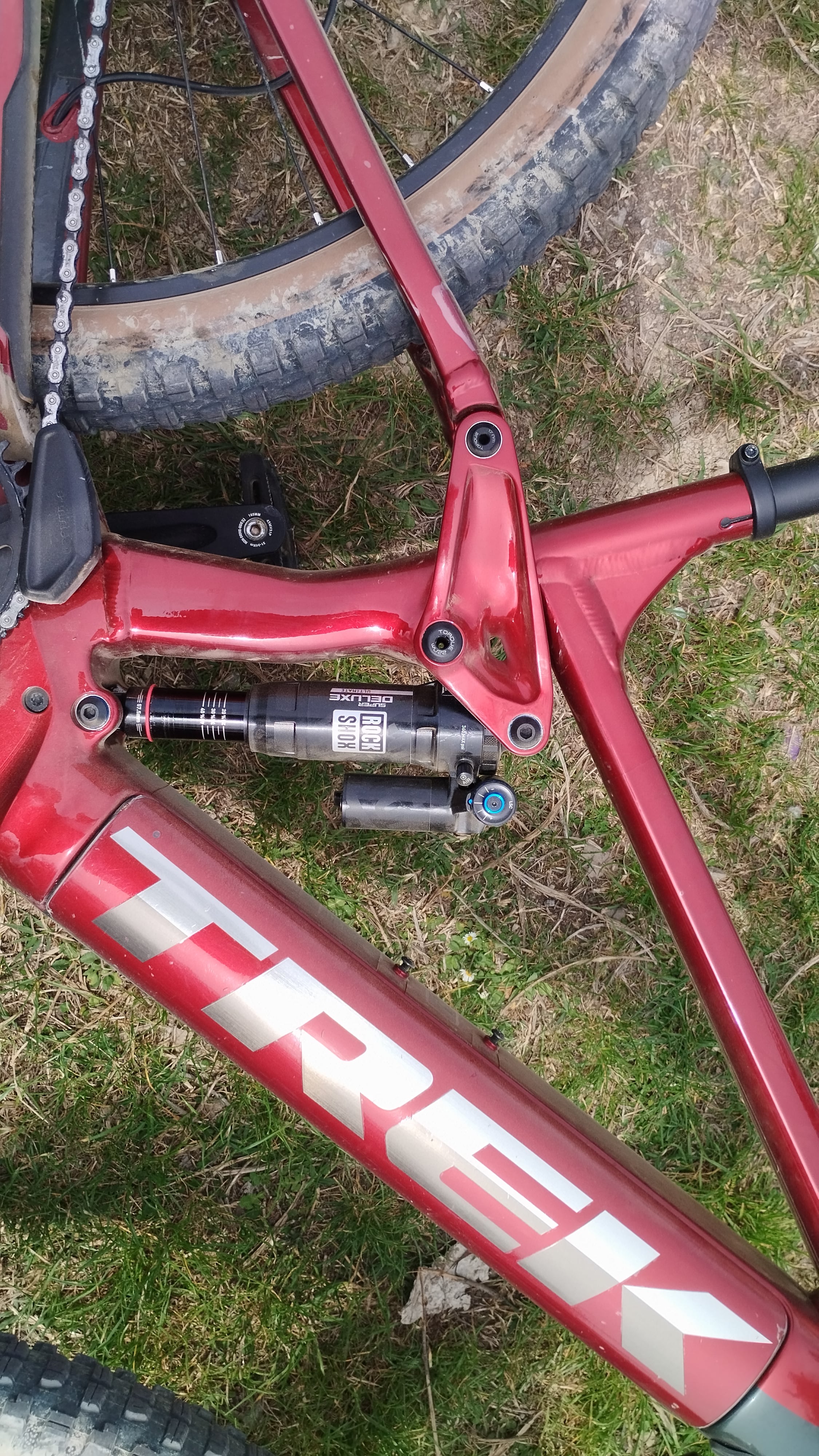

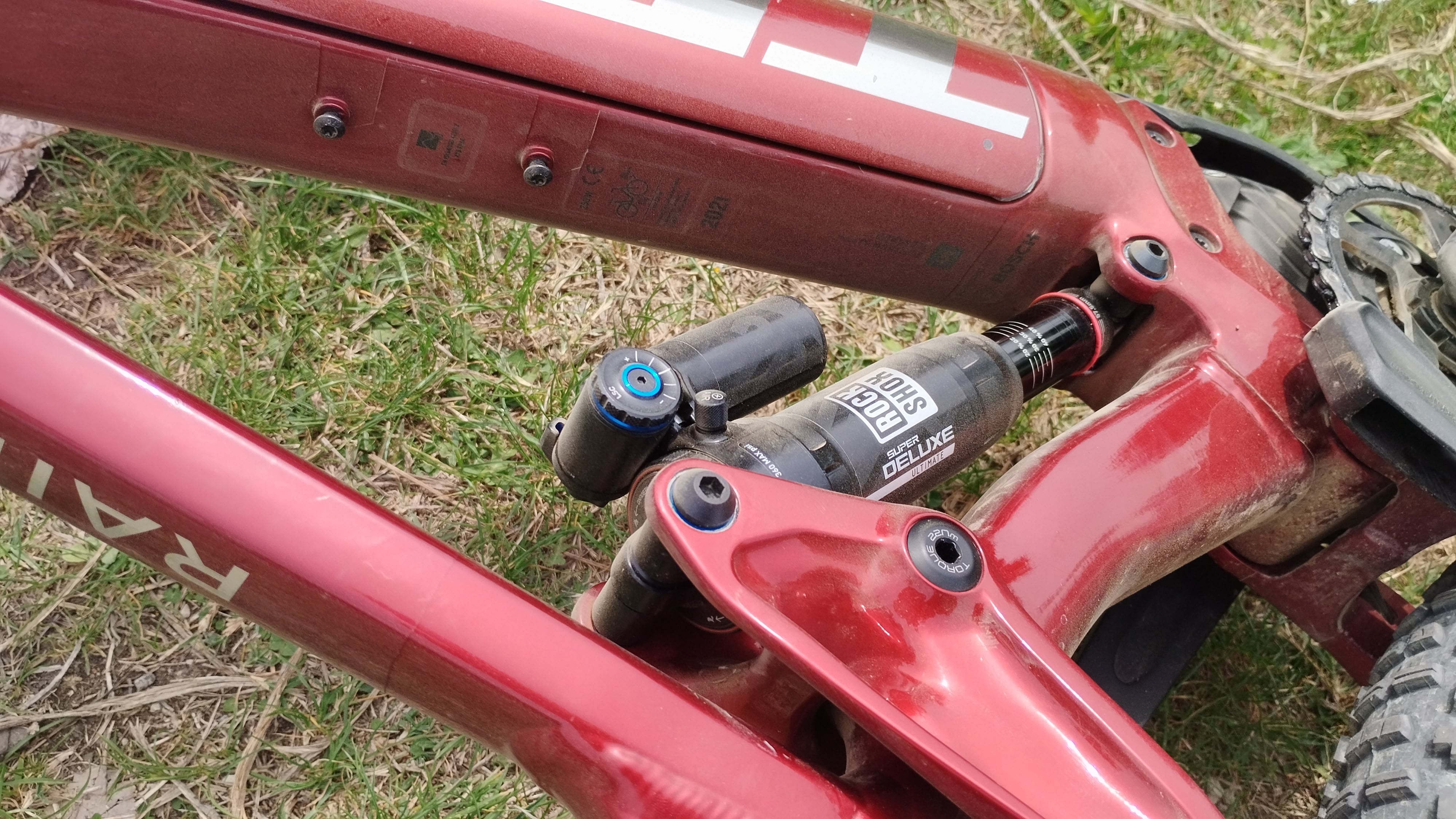

I'm going to tread into murky waters next weekend, trying a Manitou Mara rear damper on my Rail5:oops:
back story, I have a gen3 Nukeproof Mega 290c (Wiggle discount frame set & self build) that runs Manitou Mezzer forks (180 travel) and was good with it's origonal-fit Rockshox Super Deluxe Ultimate damper (230x62.5). I tried a Manitou Mara (260x65) rear damper & found it excellent as back-back on the same day & trails in BpW...
I've been running the Rail with another Manitou Mezzer fork (set @ 180 because I can🤡) and an Ohlins TTX M2 coil damper (230x65 with 708Lbs spring🐷) for a few rides and found it good BUT how will the Manitou's Mara air sprung damper compare:unsure:
hopefully I'll get answers this weekend🤞

That Mara has got a very long reservoir, what size is your Rail?
Rich.
Seems that from year to year Rail seat angles can change quite a lot, so no harm in trying it (in the garage of course).
Rich.
Don't know much about the Mara shock, but one of the best rear air shocks I ever owned was the Manitou ISX-6. If you had the nerve and a couple of special tools, that shock could be manipulated to be as close to a good coil shock that I have run across. Overall it was a super tunable shock.
I agree with comments already made that the piggyback on that Mara looks way too long to fit an aluminum Rail.
