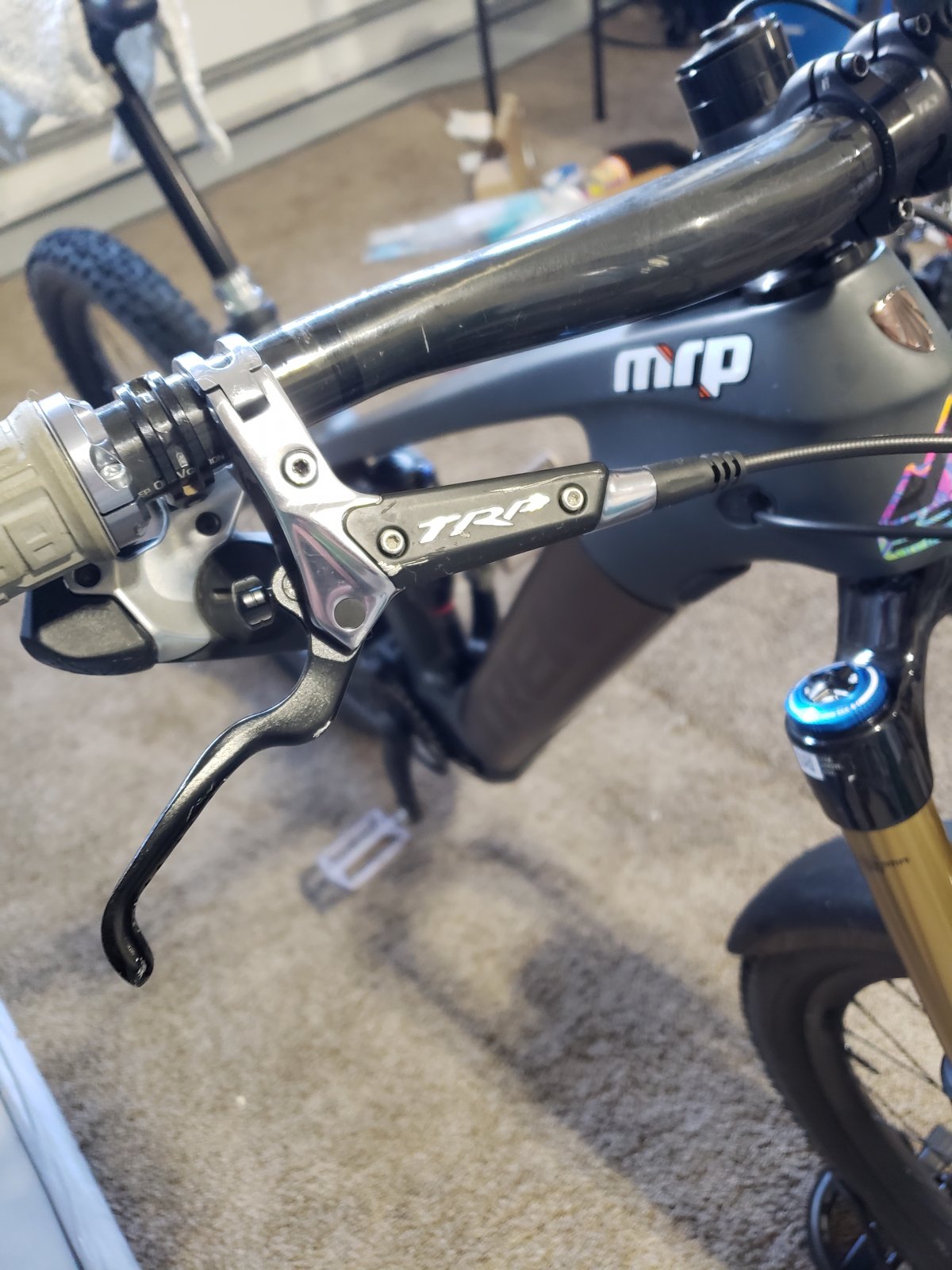

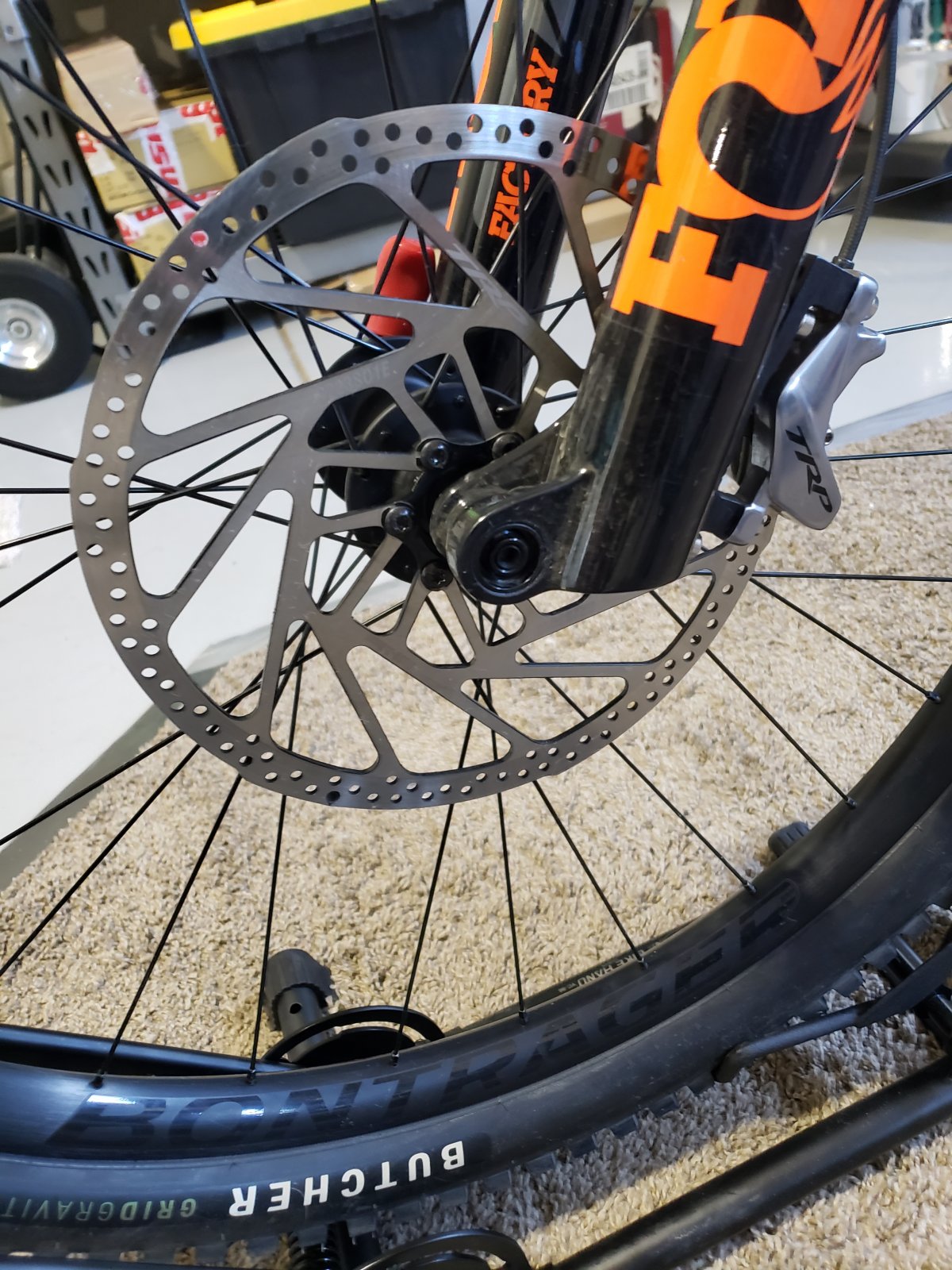

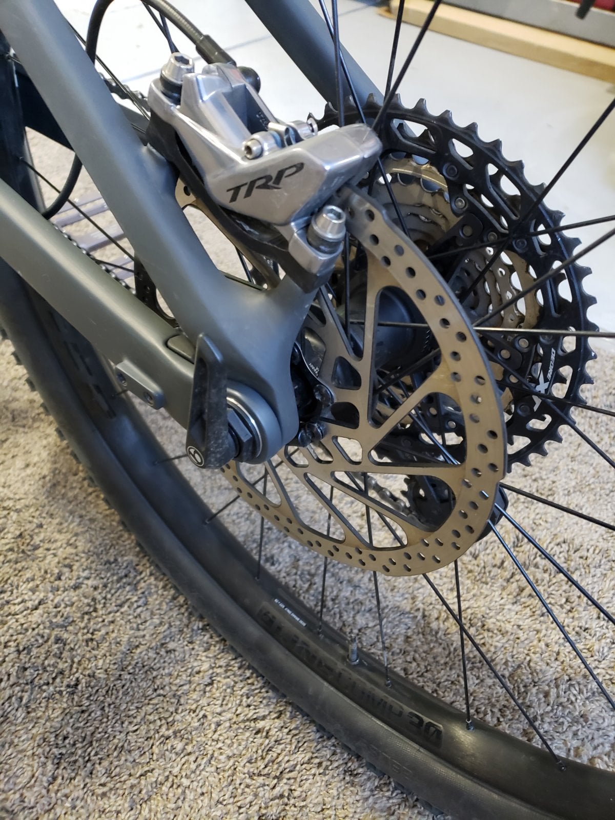

Jaybee59
Jul 1, 2021
21
7
Reno
I have upgraded to TRP 2.3 thickness rotors. 223mm front and 203mm rear on my 2021 Rail 9.8 AXS. These are extremely effective...very powerful, great modulation with no fade. I rode yesterday in 100F heat...20mi/2500 feet with long steep downhills...they feel great from the first to last. Super smart installation design... I purchased them from Spokex.com (Temecula, Ca). These would be perfect for a guy your size.
Also, take a look at the extensive Loam Wolf reviews on Youtube of these brake...they love them.
This is my opinion only...I hope this helps
Good luck!
