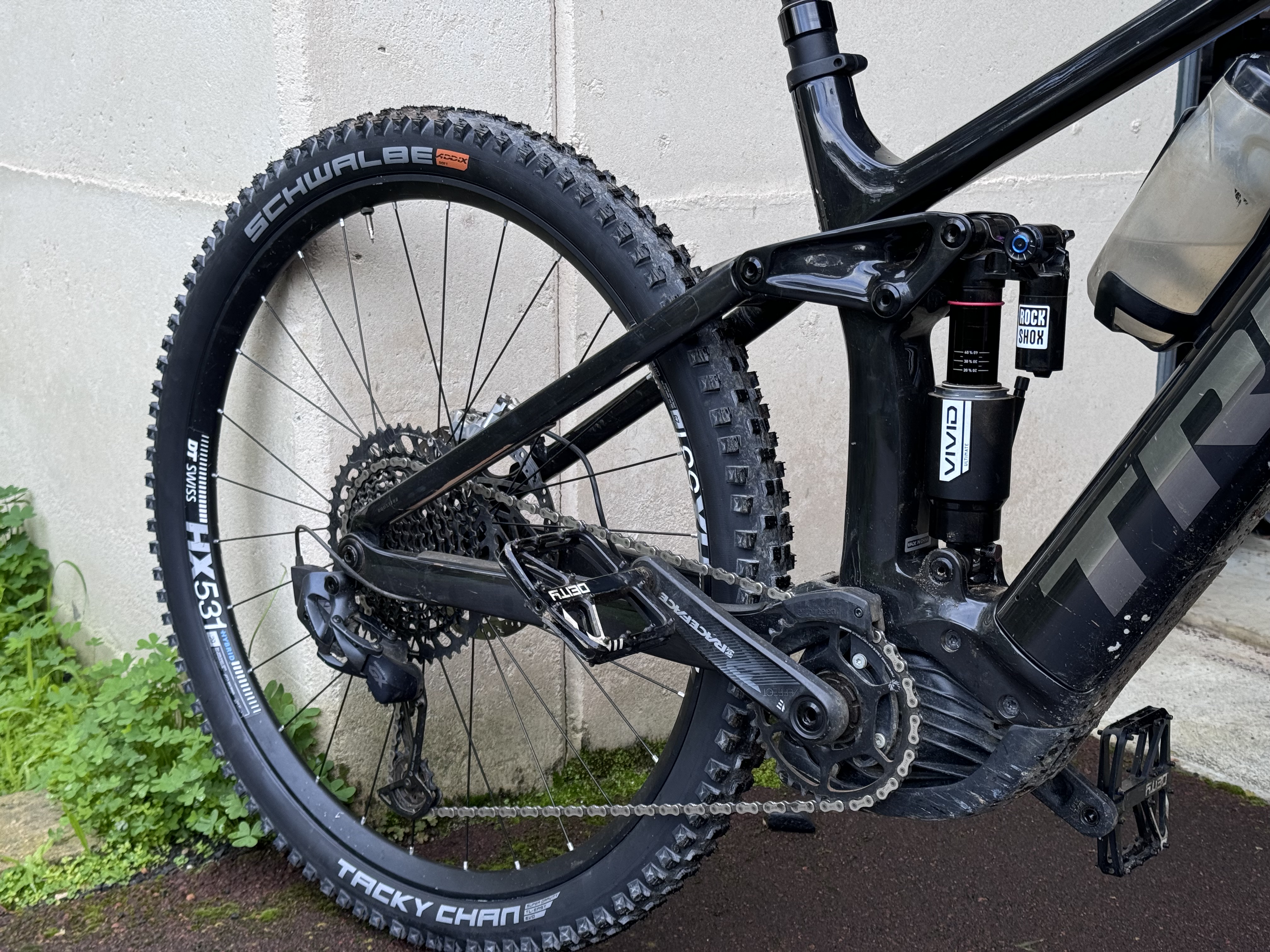

I can confirm this Rockshox Vivid Ultimate fits nicely 230x60. Gen4 Rail 9.8 size L.
Only a few rides in and it feels great. I've had plenty of coil shocks before and this feels very close. It's fantastic having proper compression adjustment and hydraulic bottom out.

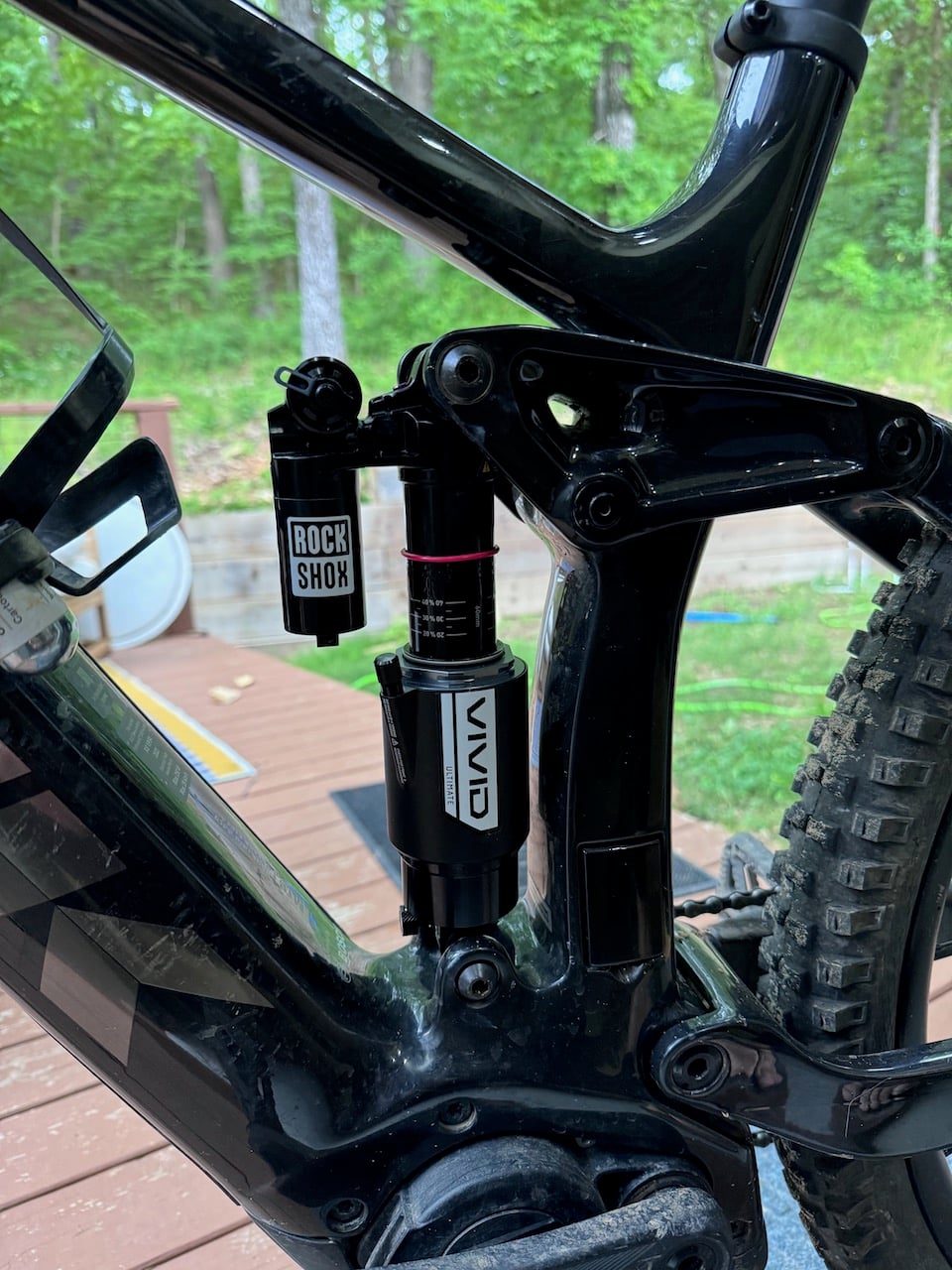

Sort of... that 2.61 is an average - see the graph of leverage ratio from Rob's Rail review
By the time it hits 150mm, the progression in the frame design means leverage is roughly 2.4
So my extra 5mm of stroke is adding 2.4 *5.0 - about 12mm

Have a few rides on the Vivid, not done much to it other than set sag, but main thing I've noticed is that I don't bottom out, and the bike feels that little bit calmer at speed in the rough, maybe a little plusher. All in al,. very happy with it so far.

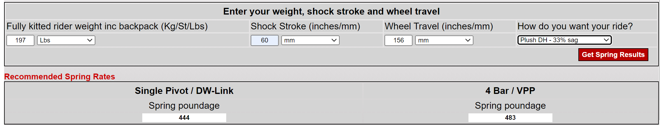

I want to upgrade to a DVO Jade X. I have read through this thread, but given the variations on Rails and my lack of experience with upgrading shocks, I want to double check I have this right. Here is the setup I am considering:
2022 Rail 7 alloy, size Large, 625wh battery
Rider weight (fully geared up) is 177lbs which is 80.3kg
TF Tuned suggest adding 5-7kg for ebike weight, but my Rail with a full water bottle is 56lbs/25.4kg, so I added 20lbs/9kg to my rider weight in the spring calculator. The result was 444 in/lbs:
So, I am going to order:
DVO Jade X 230x60
DVO Prorate 425-500 progressive spring
Shock bushing kit for the Trek Rail from Offsetbushing.com
None of the calculators I could find agree with each other, so that's fun :rolleyes:. But hopefully a 425-500 progressive spring with give me something plush and supple, but that doesn't bottom easy.
Lost Co - 529
Suspension Lab - 469
S4 Suspension - 461
TF - 444
There are conflicting posts in this thread about hardware. Some seem to say the stock hardware will work with new DU bushings, other posts say the hardware needs to be modified to work. $43 to ensure I have the right hardware seems worth it.
Anything I am missing here?
