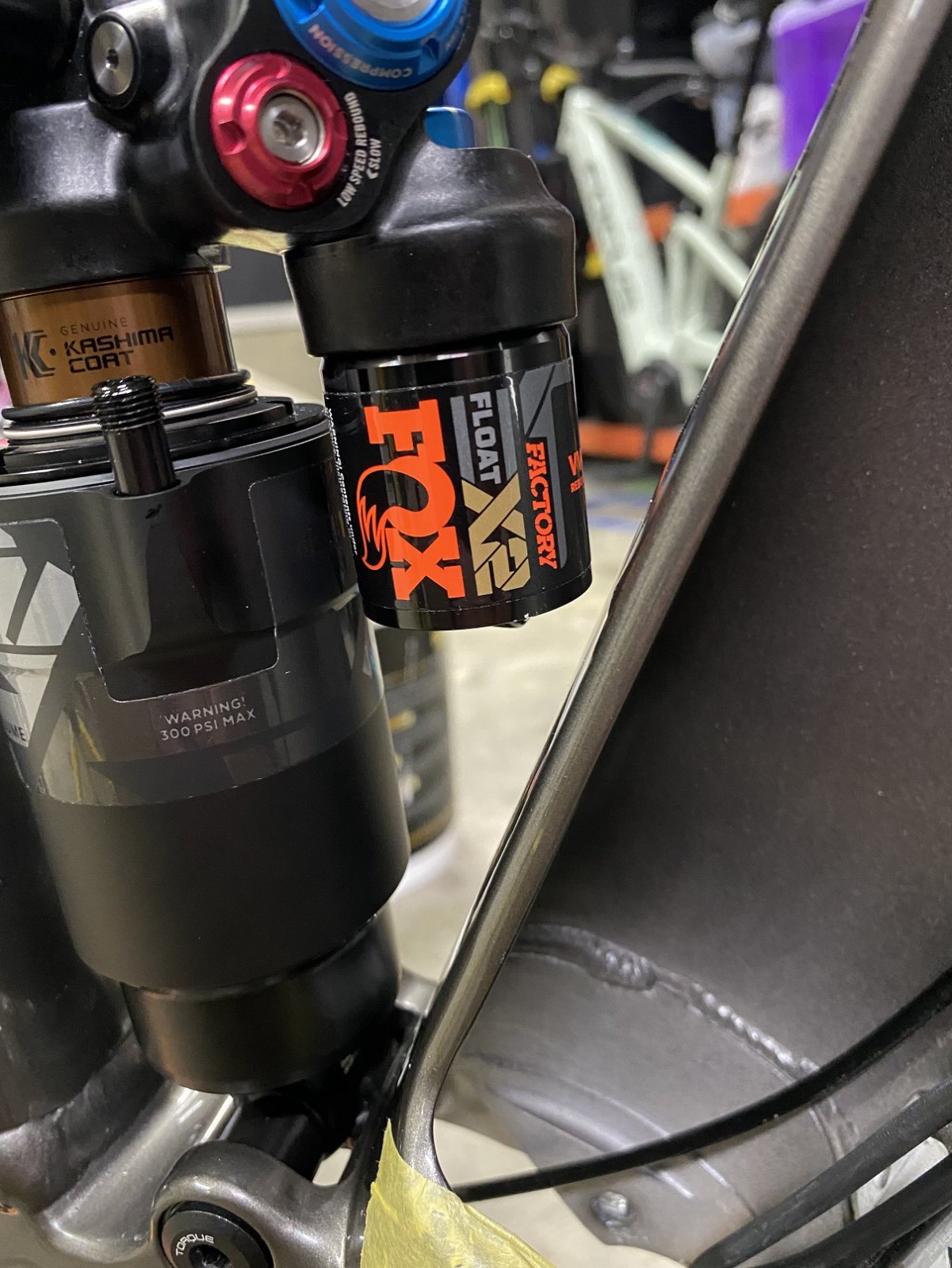

I put a '22 Fox Float X2 230x60 on my '21 Rail 5 XL.
Not much clearance when unloaded but works great.

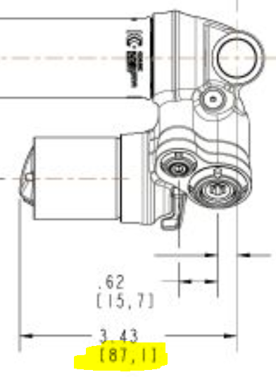

Below are some reference images for anyone wanting to use a Fox Float X2 on a medium size aluminium Rail, in this case a 2022 Rail 7. The shock size is 230x57.5. It is at full compression with all air removed. Stock Trek hardware was used, and new DU bushes installed.
As can be seen from the images, the clearance is incredibly tight, therefore stroke lengths greater than 57.5mm are not acheivable. If you wanted to increase that, an alternative air shock or a coil option (Ohlins or Jade X) would be required.
With coil shock options, the Fox DHX2 has the same 87.1mm high (from eyelet center) control/resevoir/piggy back as the Float X2, therefore theoretically it would have the same limitations as the Float X2. That same measurement on the Ohlins TTX22 is only 42mm, and Jade X 73mm. For reference, this is the dimension I am referring to:
I think you could probably actually go a little more on the stroke. Although it looks close, if you were to measure in a straight line directly down from the bottom corner of the resevoir you've probably another 10mm there. Food for thought...
i just mounted my shock at 65mm stroke. Will post in a minute.
Agree. Although I think it’s prudent to leave a buffer for any frame flex, if any. I’m not sure the juice would be worth the squeeze.

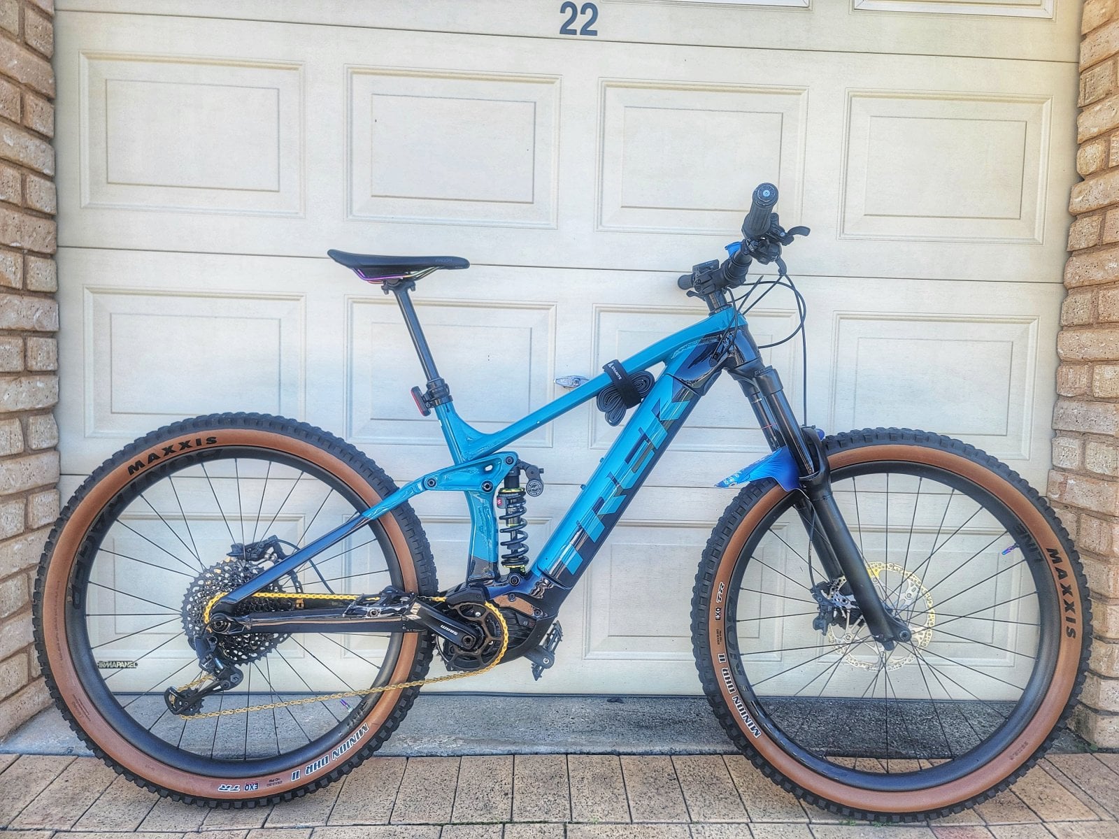

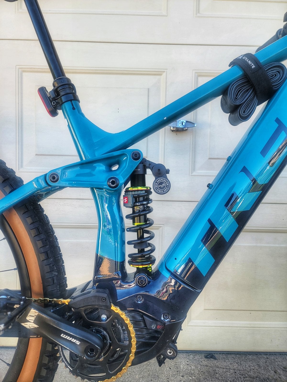

I went with a Jade X Coil 230 x 60mm for 156mm rear travel, and jumped to 170mm on the front courtesy of a Fox 38. Very happy first ride out, about to test next ride with the flip chip in the high position which I think should put head angle right back to where it was stock, but with increased travel. *note the 38 wasn't fitted for these pics
View attachment 85510 View attachment 85511
Did you need hardware to fit or was all the standard stuff God to fit it?

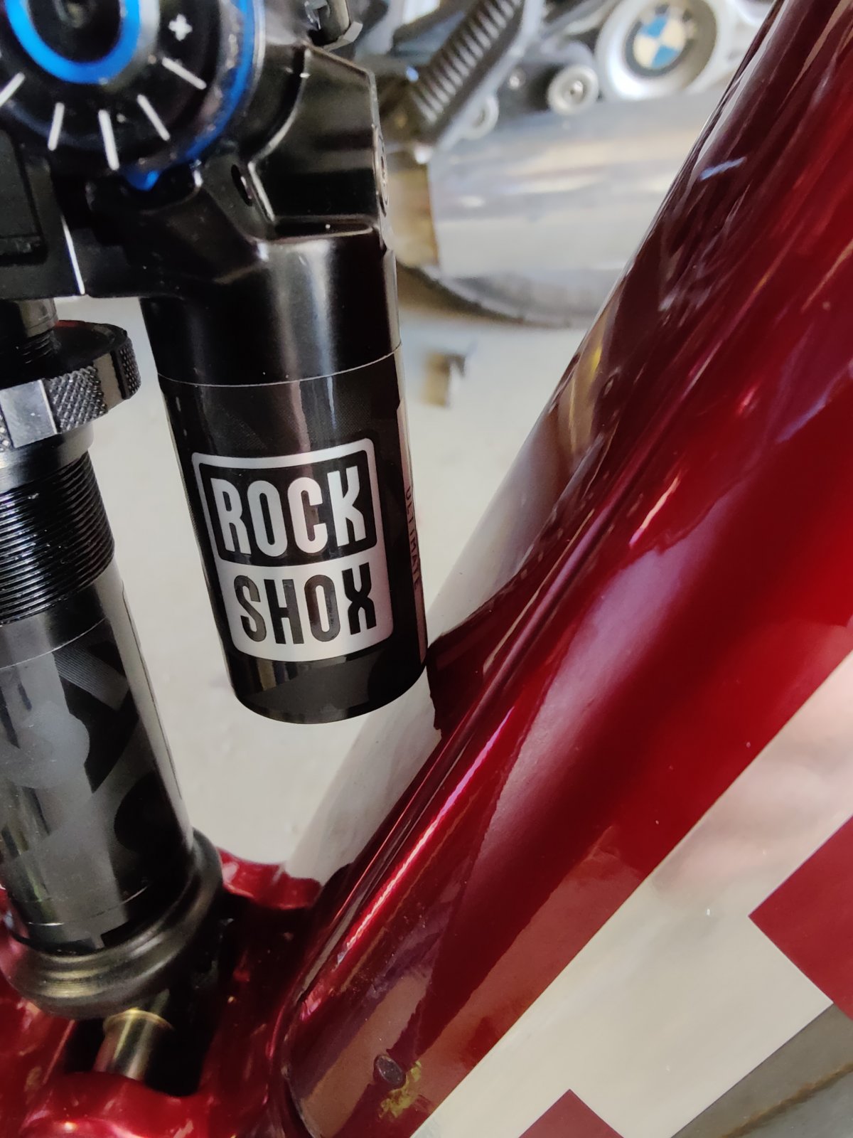

This is the shock just resting on the bump stop and bump stop is about 18mm tall. The gap from shock to frame is about 6mm, so I think 57.5mm stoke will hit the frame too. Somebody need's to try it with the 57.5mm stroke shock to confirm this.
