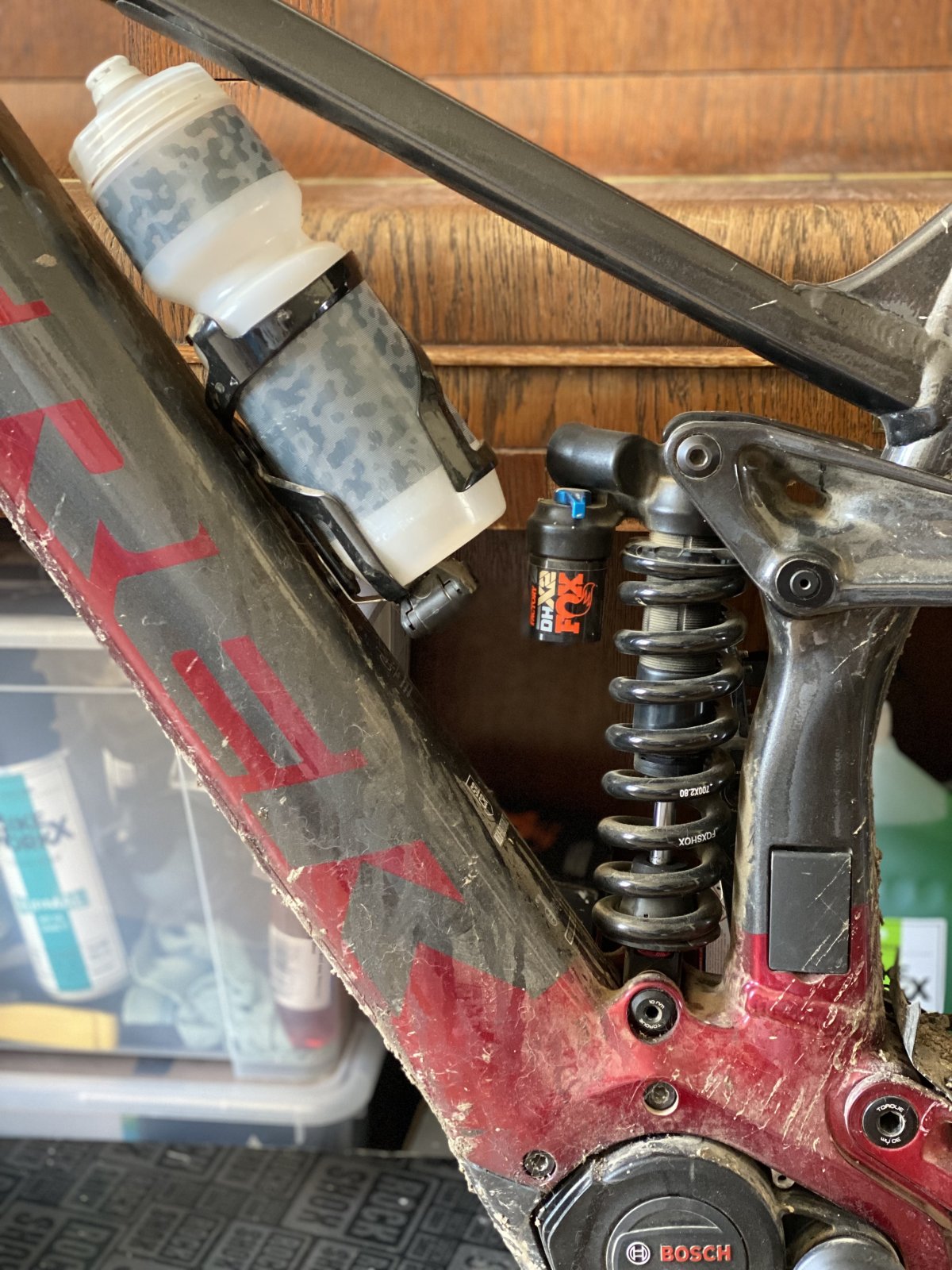

should add that theres lots of good information on this thread that helped me install the dpx2 on my 2021 med rail 7. i used the existing DU bushings from the fox but sanded down the lip so they were flush with the eyelets. once i did that it was pretty much a straight swap using the existing stock hardware.

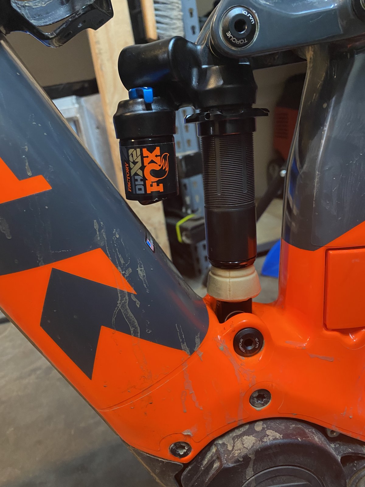

Putting all the info I found in one post.

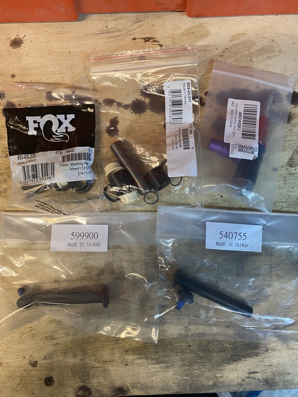

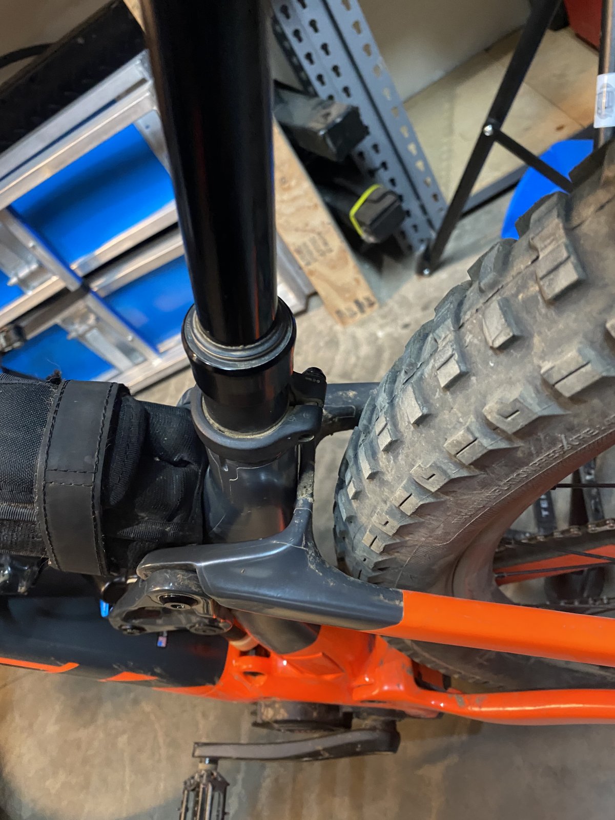

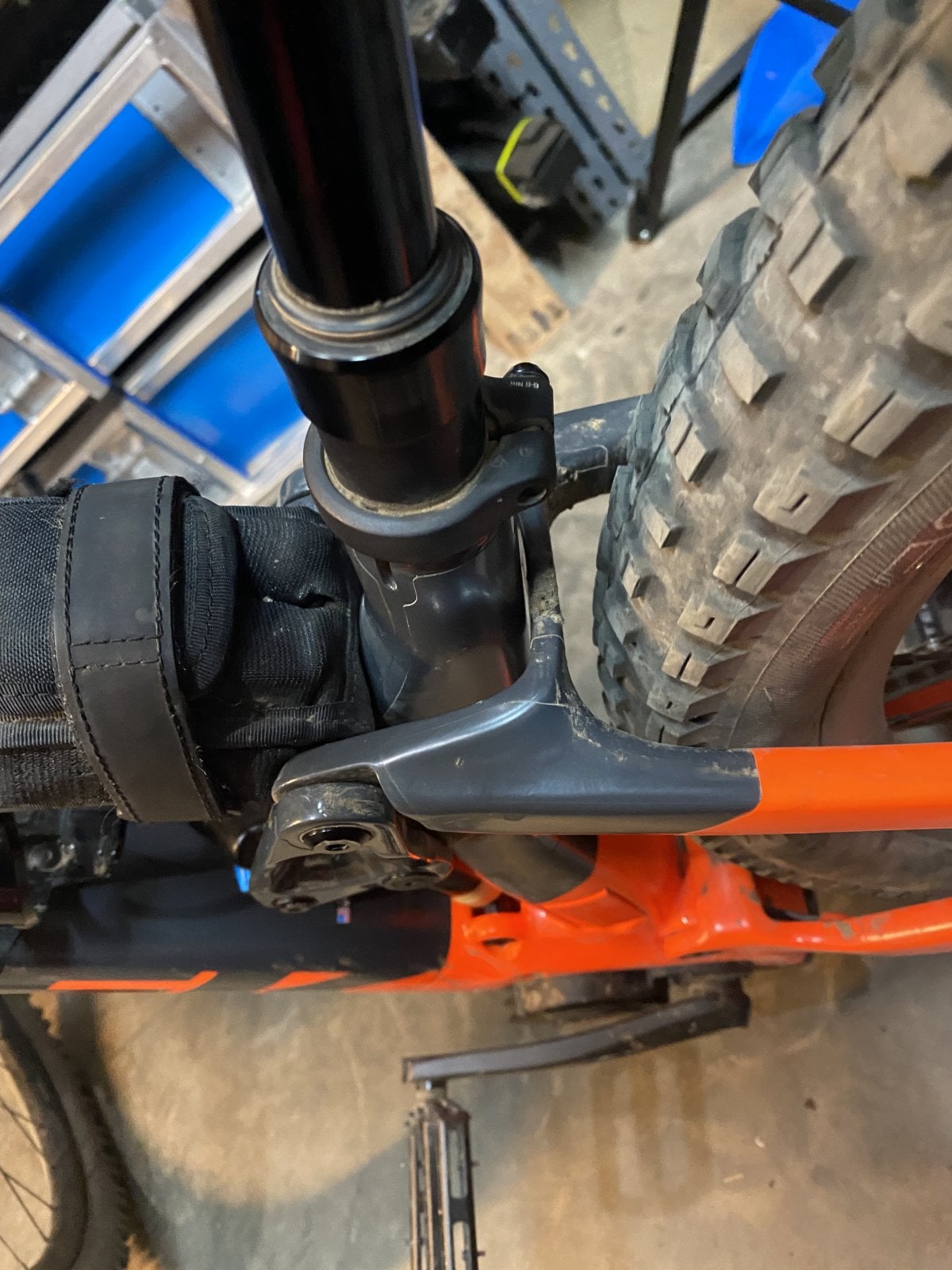

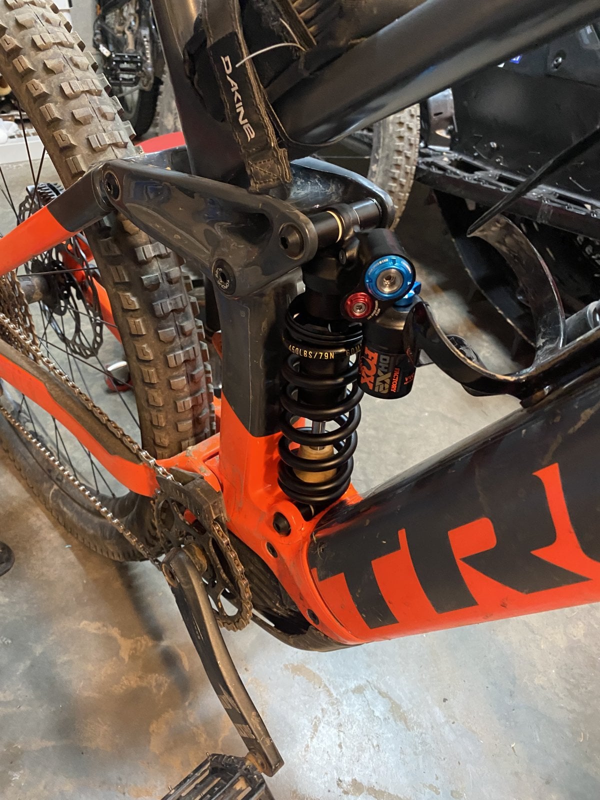

Trek rail 9.8 2021 Large Came stock with trunion rockshox shock which started leaking in a week.
Installed fox dhx2 230x65. Cannot run in low setting seat post hits. Reservoir clears in both settings.
bolts are 1mm shorter than shock + spacers
Fox mounting hardware. Upper shock bolt is 54mm shock width + 2x8mm spacer plus linkage = 70mm but 69mm bolt
Bolts
TR540755
TR599900
hardware
• Upper: 10mm x 54mm 803-03-311
• Lower: 10mm x 40mm 803-03-329

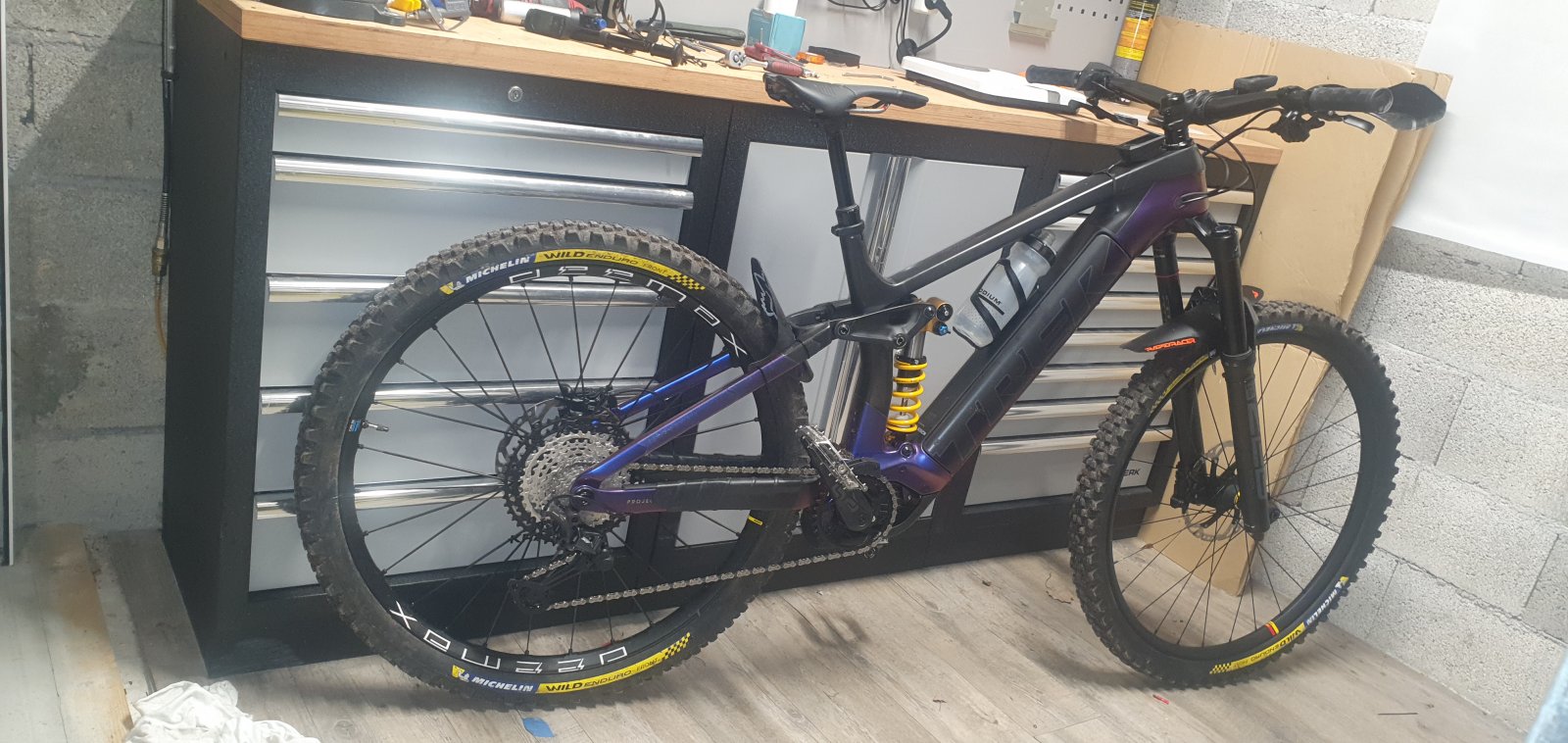

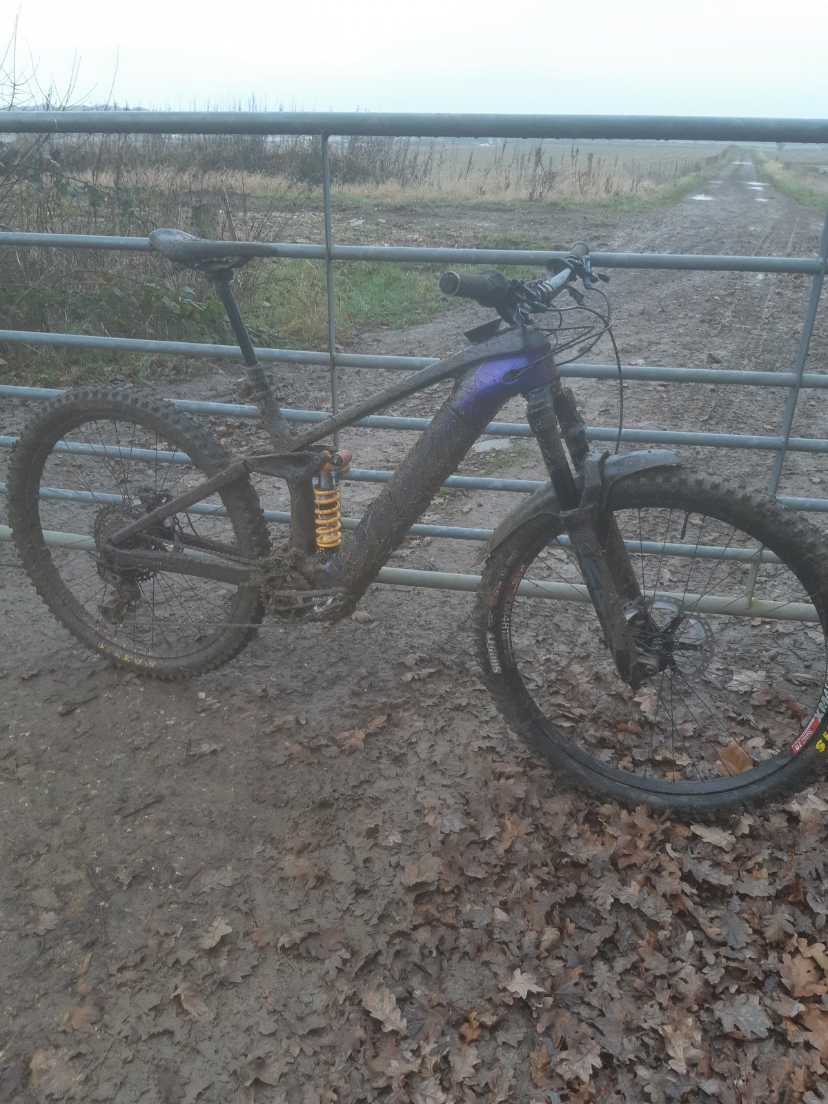

Hello, I went for the ohlins ttx, imo worth the extra cost, 60mm stroke and it works a treat. Rail 9.8 large.

Hello, I don't know, I wanted to have a shock I can just take off with all it's fittings, so I know have the original and all it fittings in a box, and I can just swap shocks over with no faff, not that I've taken the ohlins off since I put it on, it's a great shock imo, no faff, set n ride.
Here's a pic from todays ride.
Here's a pic from todays ride. View attachment 78711
Thanks for your reply, my TTX22 is arrived at the shop, i will pick it up Monday and will see!!
Muddy time !!!

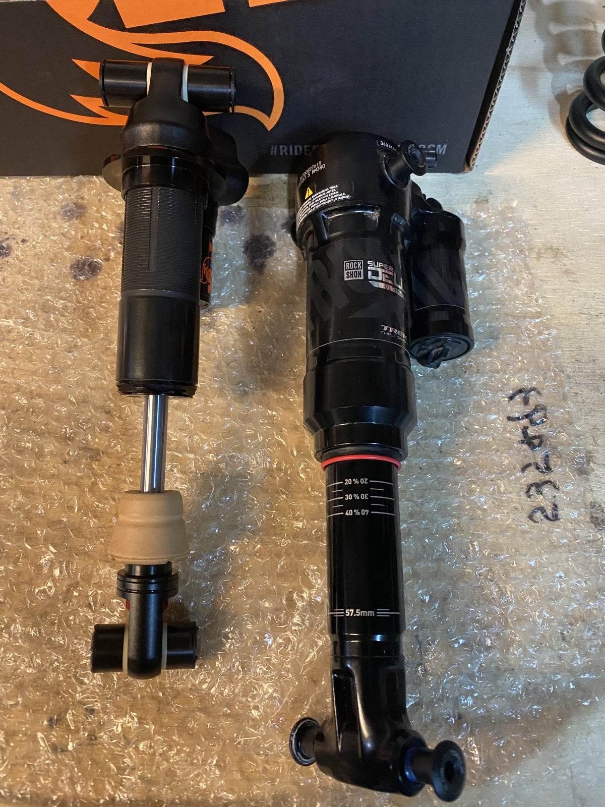

This thread has been very helpful informing my suspension upgrades to my Rail (9.7 XL 2021) so I thought I would post a few observations. Recently first upgraded to a Zeb Fork (Ultimate 160mm) followed by Jade X (650 LB DVO coil, 57.5 stroke with -7.5mm clip) and I’m pleased to report the combination is brilliant. Frankly I was a little disappointed in the results with just the Zeb upgrade and the old RS Deluxe. LSC was far improved and steering was more responsive, but it still was a rough ride and I really wasn’t any faster. Add the Jade and the results were undeniable. Long standing Strava times on long rocky downhill sections were destroyed on the very first ride, including one challenging black segment where I mistakenly left the compression setting in the middle as opposed to open. The combination is so buttery smooth and confidence inspiring, and will only get better when I dial-in my settings. If I had it to do over, I probably would have started with just doing the damper replacement to the Yari and saved a few bucks, but I’m starting to appreciate the Zeb now that it is paired with the Jade.

Neither the stock shock nor the Jade would work with the thru bolt without adapters (an inner bushing and spacers on each side). Basically the mounting hole in both shocks is bigger than the thru bolt and needs a bushing to size it down. After removing the stock shock you could try to remove the the adapters/mounting hardware from the old shock and put them on the Jade, but this takes some effort and perhaps special tools. I also believe the bushing for each shock may be different and needs to be replaced regardless. I opted for all new fox mounting hardware and posted the part numbers on another thread. They work great and are very easy to install.
