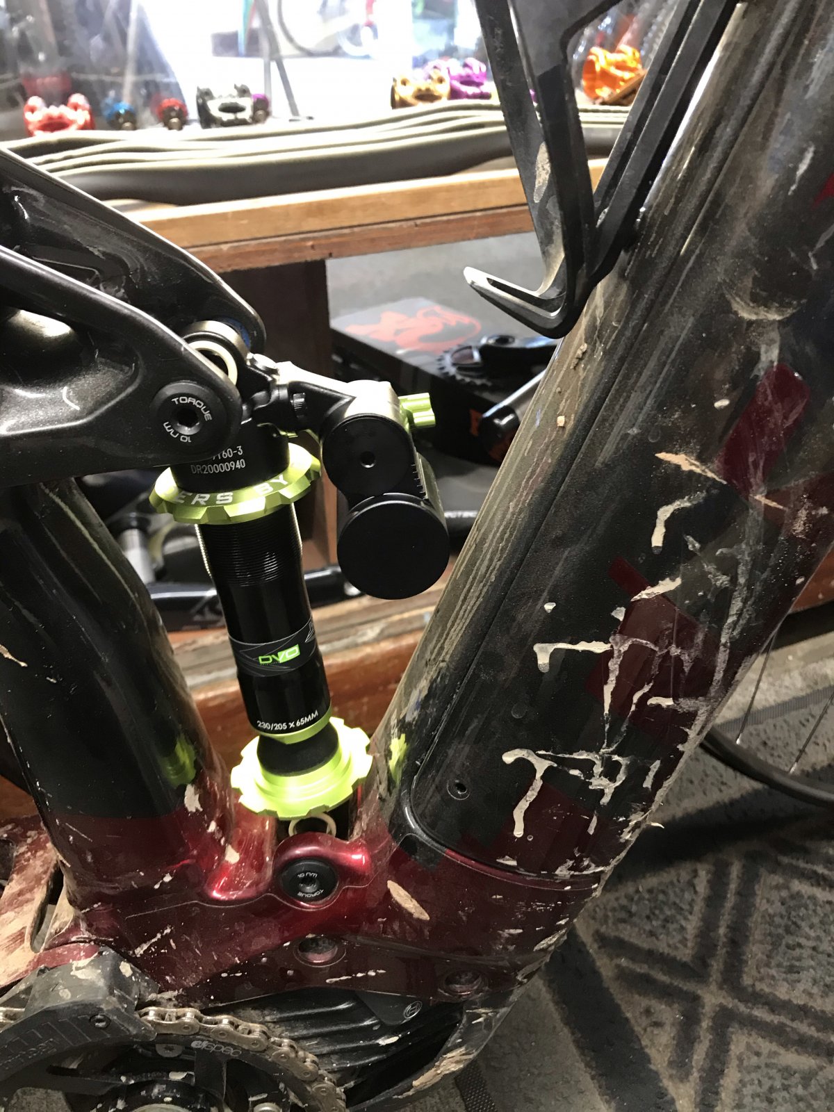

I see that Topaz 2 230x60 should fit then
what about 230x65mm (or at least 62.5)? do you think there is a space for additional 5mm? (and flip chip in high position)

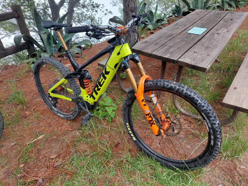

So the Zeb and Jade X upgrade are a fantastic combo on my 9.7 XL. I can bomb down chunky sections faster, with increased confidence. My settings are dialed pretty firm as it feels more responsive. It's definitely a bit plusher than stock, but I personally think $2K of upgrades might be a bit of overkill for what you have described. I might recommend starting with a coil then going the RC charger route (or vice versa). This will give you a lot bang for your buck.

since trek runs with the dimensions 230x62.5 and the dhx2 coil is only sold in the dimension 230x60, you have to remove a spacer so you get a 62.5 stroke.
then you also have to change the hardware on the coil from trunnion to metric. if you live in england it is possible to buy dhx2 from tftuned with ready trunnion hardware

I think I read some posts on here about over stroking the Rail. I have a 2021 Large with a Jade X, thinking of going from 57.5mm to 60mm. It looks like I clear the frame but hard to be certain. Anyone done this?
zerofunds
Nov 30, 2020
63
53
New Zealand
60mm works no problem, 62.5mm works on an alloy large but I think 60mm is the sweet spot

In my undertanding the rear frame cross "beam" and seat tube are same in all sizes. So 65mm travel shock fits when mino link high. When mino link low 60 mm is really close but should not hit the seat tube (depending on manufacturing tolerances)
The frame size mainly affects the room for nitrogen can when suspension is fully compressed as the lower frame tube/battery tube is steeper angled from the bb.
If there are People with small frames i would be happy to see verification if you have the possibility to do so?

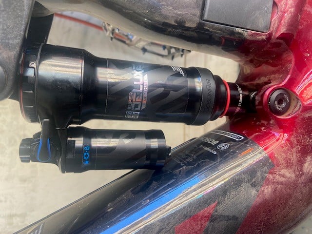

Hey Guy's - I just installed a RS Super Deluxe Ultimate on my Rail 7, looks like it won't fit. I let all the air out of the shock, and the canister hits the frame.. When the shock bottoms, will it go all the way to end of the shaft?
That’s no bueno at full compression.
Only Super Deluxe that will work is the trunion mount.

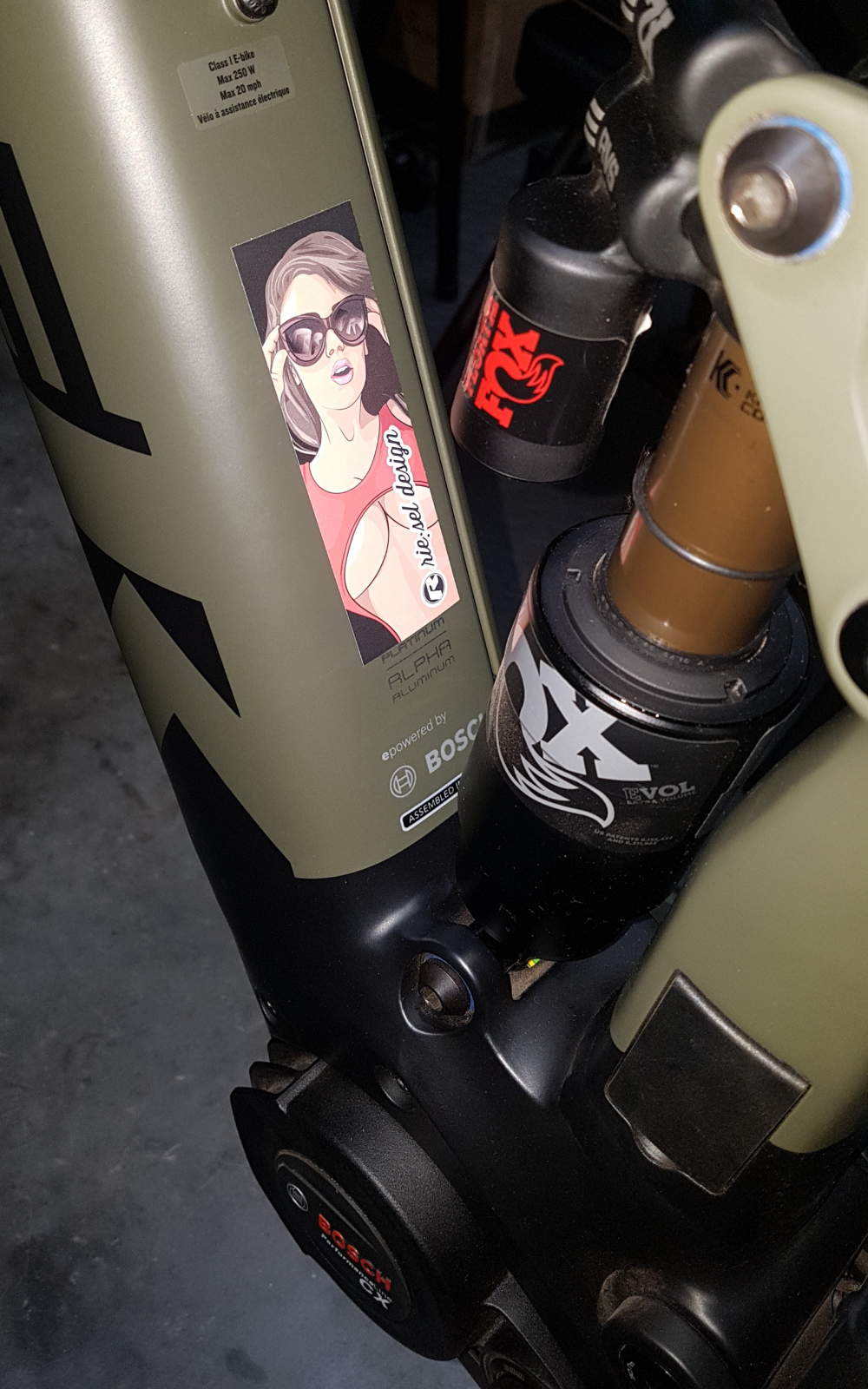

How is the clearance from the seatstay bridge to the seat tube on the ‘22 rail carbon? I have a L frame and it looks pretty close with the stock 57.5 shock fully compressed.
