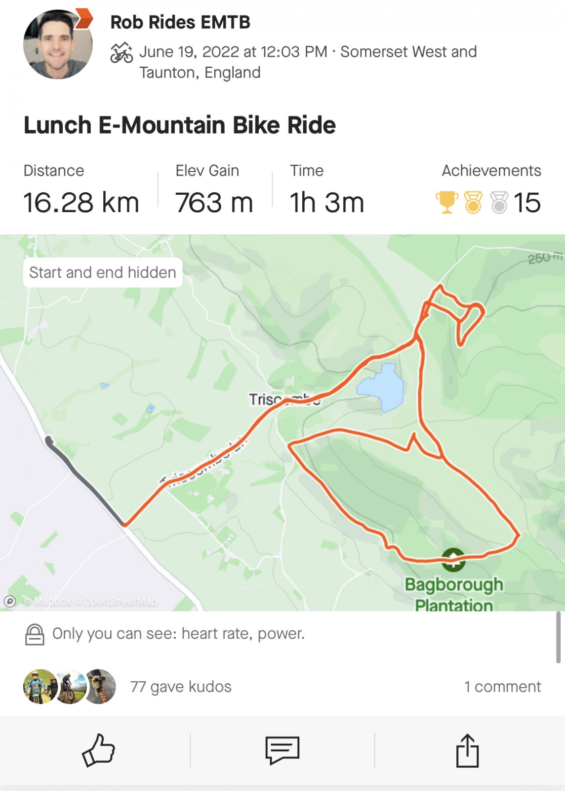

Fuel EXe range This was 100% turbo with long some steepish climbs. I used all the battery. Riding weight 87KG. Michelin Wild Enduro Tyres.

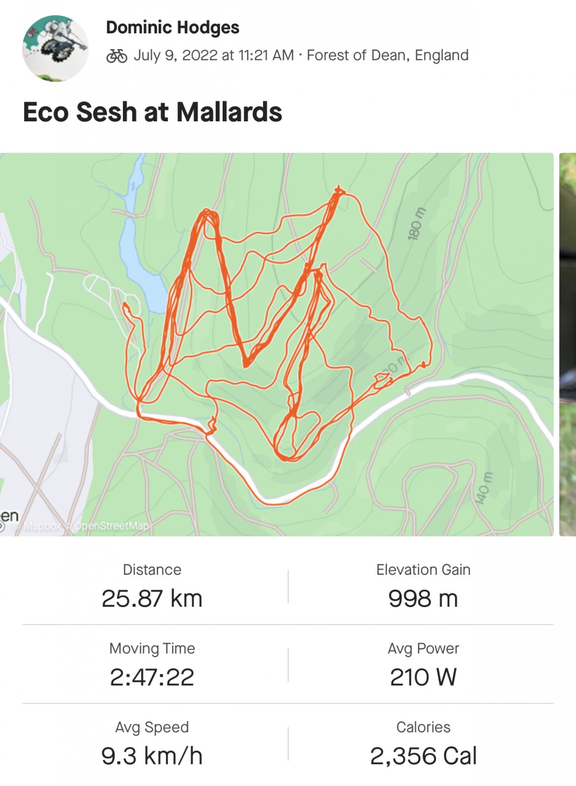

I would believe 450 meters high gain with that small batterie on a truly fun ride.
Doomanic
🛠️Wrecker🛠️
Jan 21, 2018
8,702
10,342
@B1rdie Did you even look at my post? That was a really fun ride with 998m ascent and corresponding descent. Turboing up fireroads isn’t fun; it’s a means to an end.
