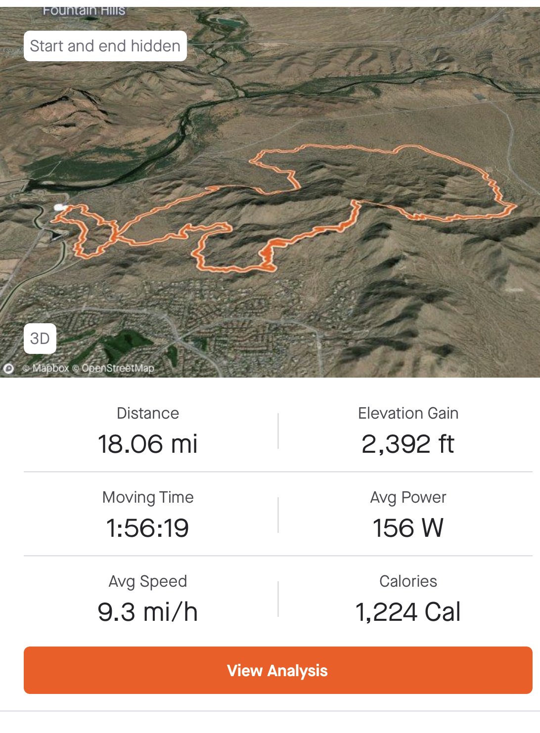

Yesterday’s ride. I am fine with the range being a little less than the other mid—weight EMTB’s. I’ll trade the natural pedal feel and silent motor over the little bit of range. The bike is awesome.
This trail has a lot of tech, so I’m am sure that ate some extra battery. I finished with 17% and was using high mode frivolously at the end of the ride, when I was sure I had enough power to make it back.
