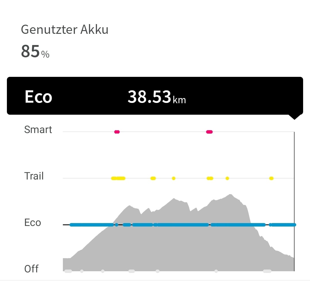

Third charge,
98% of battery used. Most in eco (recalibrated to 80W and super slow response).
Maybe 50m of altitude was pushed up the hill (by the way walk assist sucks), and 50m in recalibrated turbo mode (all settings max).

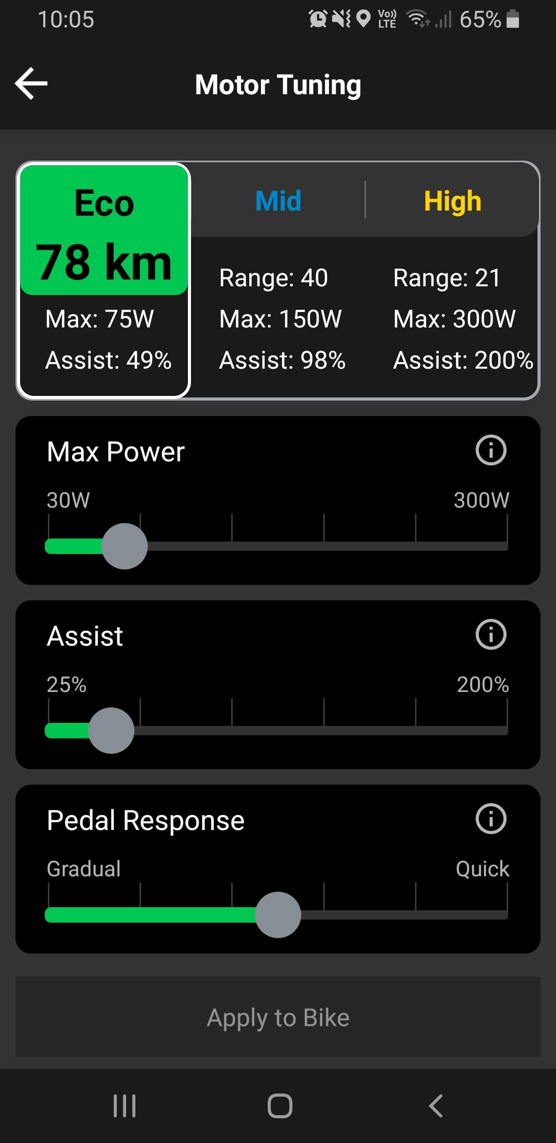

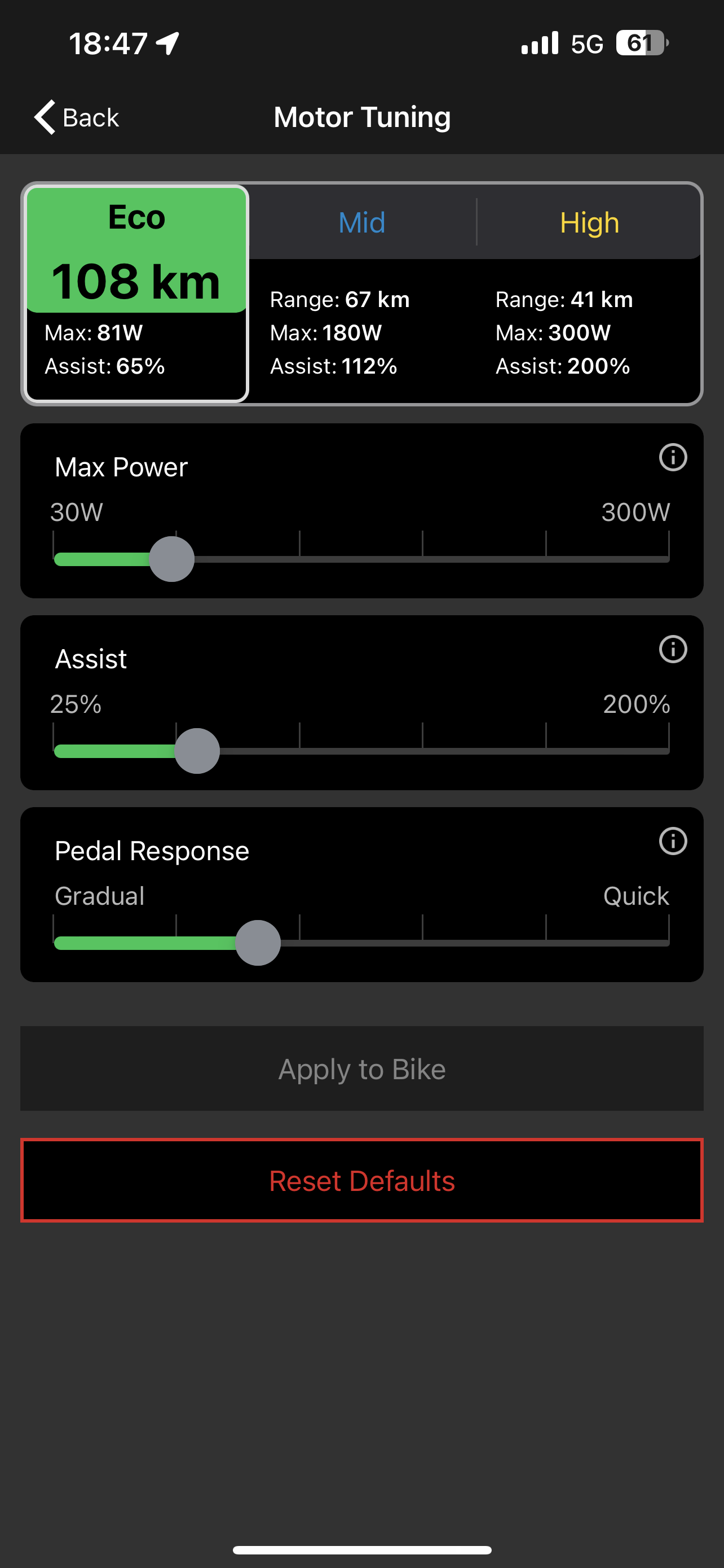

I went now below that (to 72W and 49% of support)
👍 have set mine very similar to your settings.
Thinking about using this setting for longer tours to maximize range and altitude. Maybe even lower max power for ECO and MID for then like having ECO1 and ECO2 but keeping HIGH at 300W for the short moments where the extra boost power is needed to tackle a technical climb. But most of the time just switching between the two very low assisted Modes.
Great thing about the bike is if you are not in a hurry you can even ride without any support in the flat terrain. I personally dont feel any drag compared to my old xc-bike. Maybe brand new xc bikes pedal better than my old one🤷‍♂️ 😅
Make sense, I did not touch Mid settings, but also did not find it very usable.
In my area trails are rather long (40-60km and 1200-1600m of altitude) so have to save juice at least until range extender arrives (i hope for 2200m of altitude on 520Wh batteries.
Worth to mention I am riding on grippy heavy WTB tires (vigiliante and verdict) and coil on rear (no able to lock it fully)

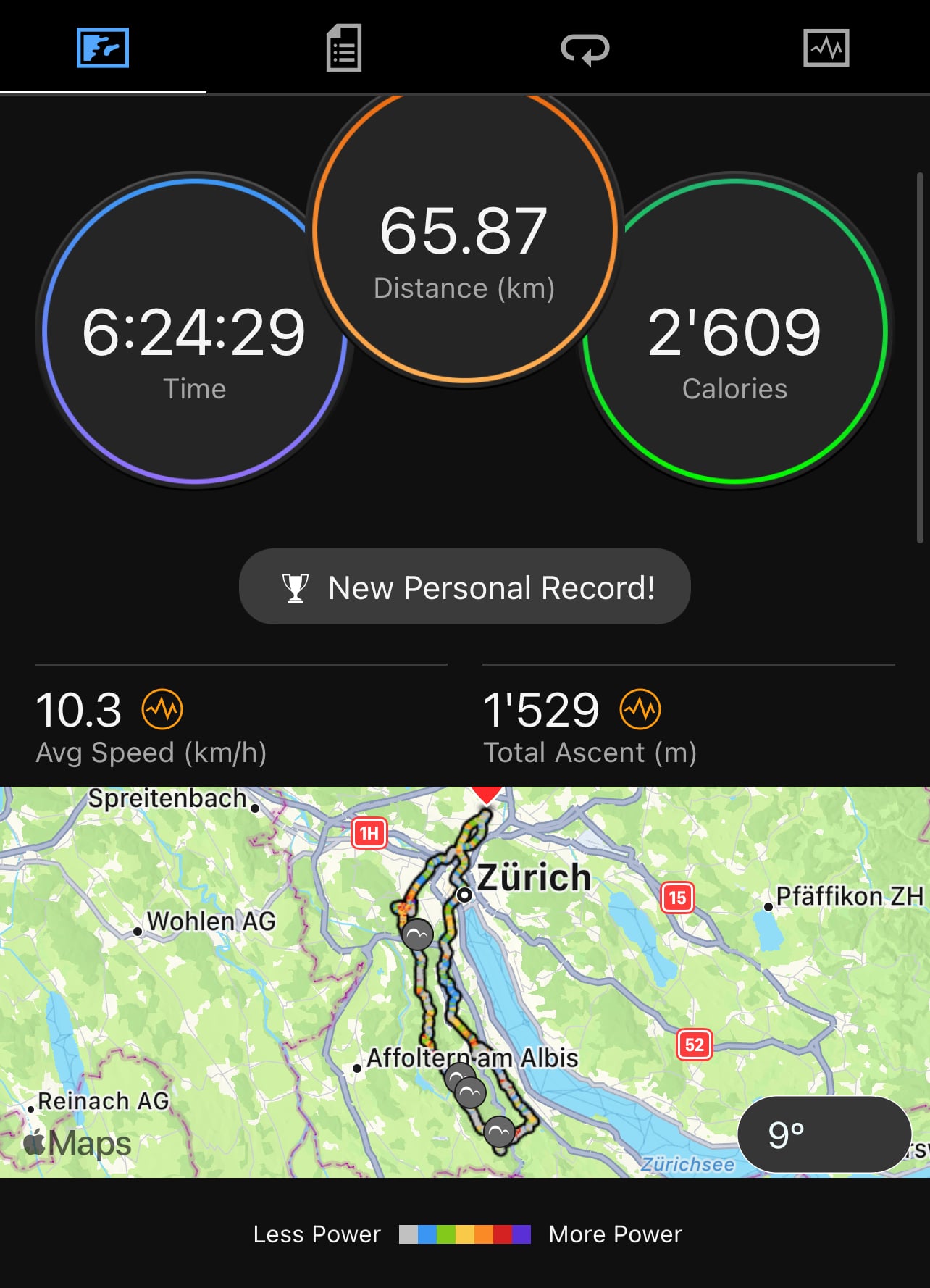

Did a drag up a fire road yesterday. 2500 feet of climbing in 7.5 miles then back down. About 90% in ECO and the rest in Trail. Got back with 40%. I was saving the juice as the road continued on for another 9 miles but it would have needed turbo ludicrous mode for the next mile and I was cooked. If you can use ECO this bike has plenty of range.

I did 1800 meters (ca. 5400 feet) over 16 km (ca. 10 miles) all in Eco (max 80 Watt and 50% assistance) and came back with 10%. It was all just uphill half on asfalt, half on gravel. this bike is made for ECO for long climbs and for mid assist for afterwork rides...and handling on technical terrain is great!

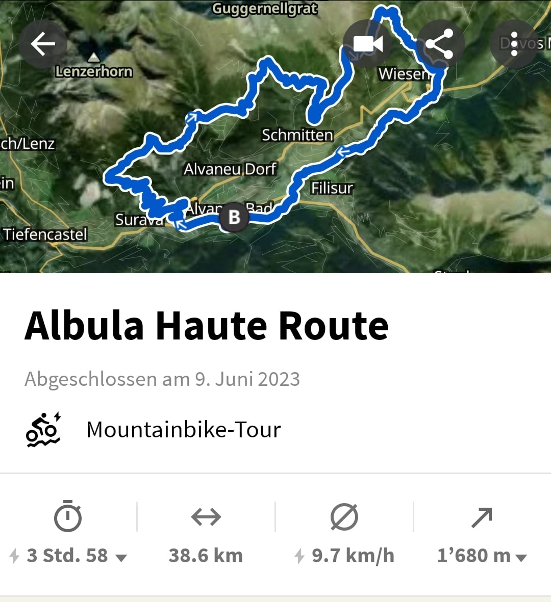

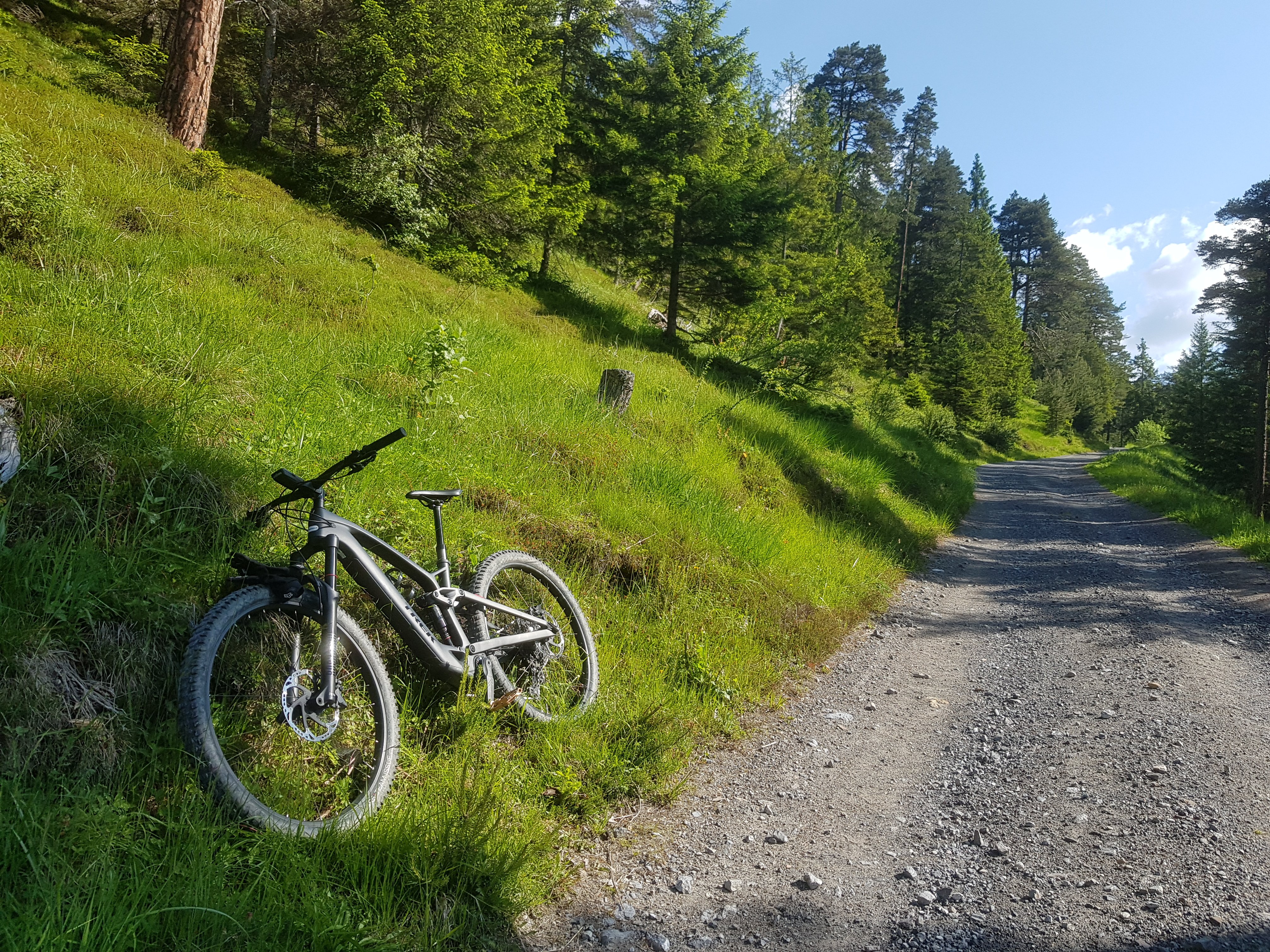

Today I rode the first alpine tour of the season. The so called "Albula Haute Route".
It started with over 800m climb on forest roads and then some pretty demanding single trails (not wider than a towel) traversing along the albula valley. In the end 1680m climb came together. Ended the day with 85%Battery used so almost 2000m elevation gain could be possible with my settings/fitness.
Used Eco most of the time. Trail and Boost only for technical or very steep sections.
My settings
Some impressions
I'm pretty impressed whats possible with the bike regarding range after some settings tweaking.

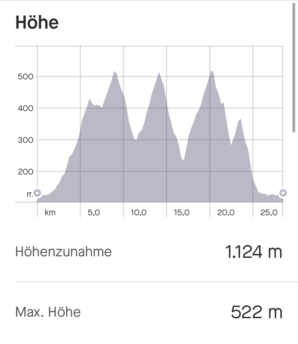

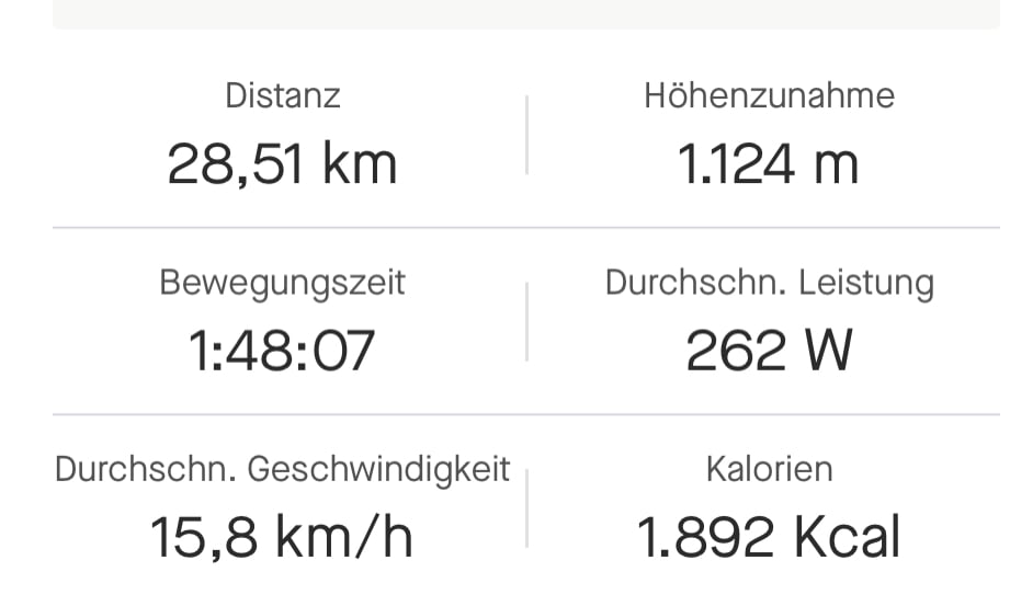

Did today Landwasser epic trail in Davos 1300m of elevation (starting from mid station of Jakobshorn) and 46km, used 125% of battery (whole RE and 75%) of main battery. Whole trip in trail (135W and 98% assist) and turbo (all max)
Seems with this way of using 3m of altitude on each Wh.

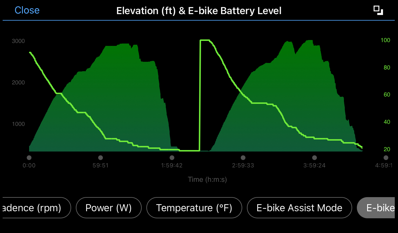

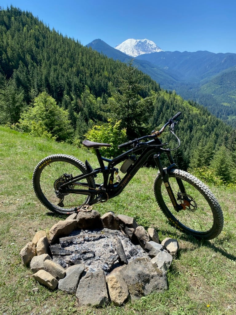

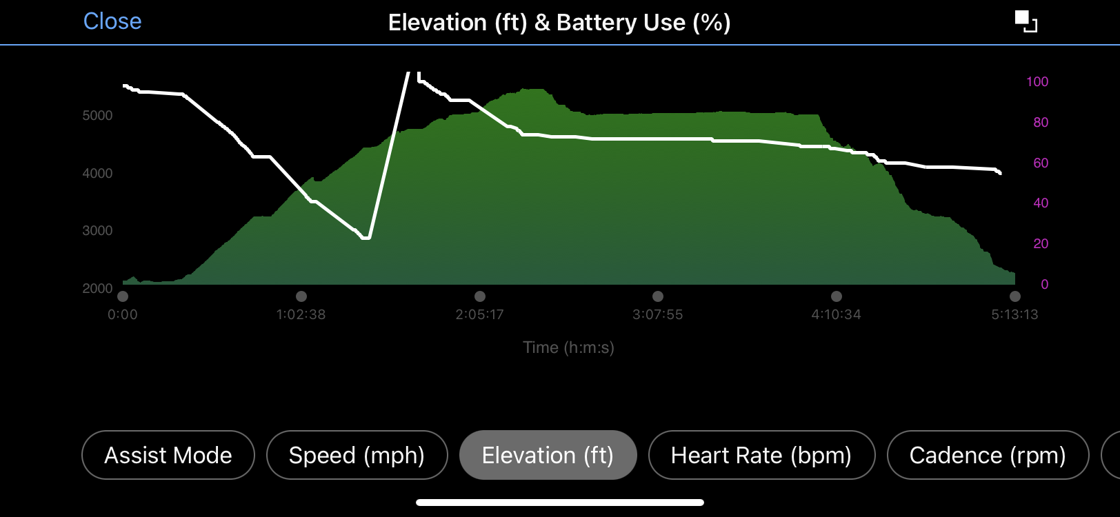

Todays dual battery adventure! 5,860 Up & down in 20 miles. So good! This was two separate loops from the same trailhead, so I was able to swap batteries at my car mid-ride. The first half was with 3 friends who were all on full-power ebikes, I was mostly in trail mode. Then they peeled off and second half was with another friend on a full power ebike. I was in trail/boost for lap 2. The descents were steep loam and conditions were incredible.
It’s been such a fantastic 3 days. Thursday I got 3000’ in, and last night we did a social ride with a mid-ride BBQ with a view of Puget sound. Pure joy.
