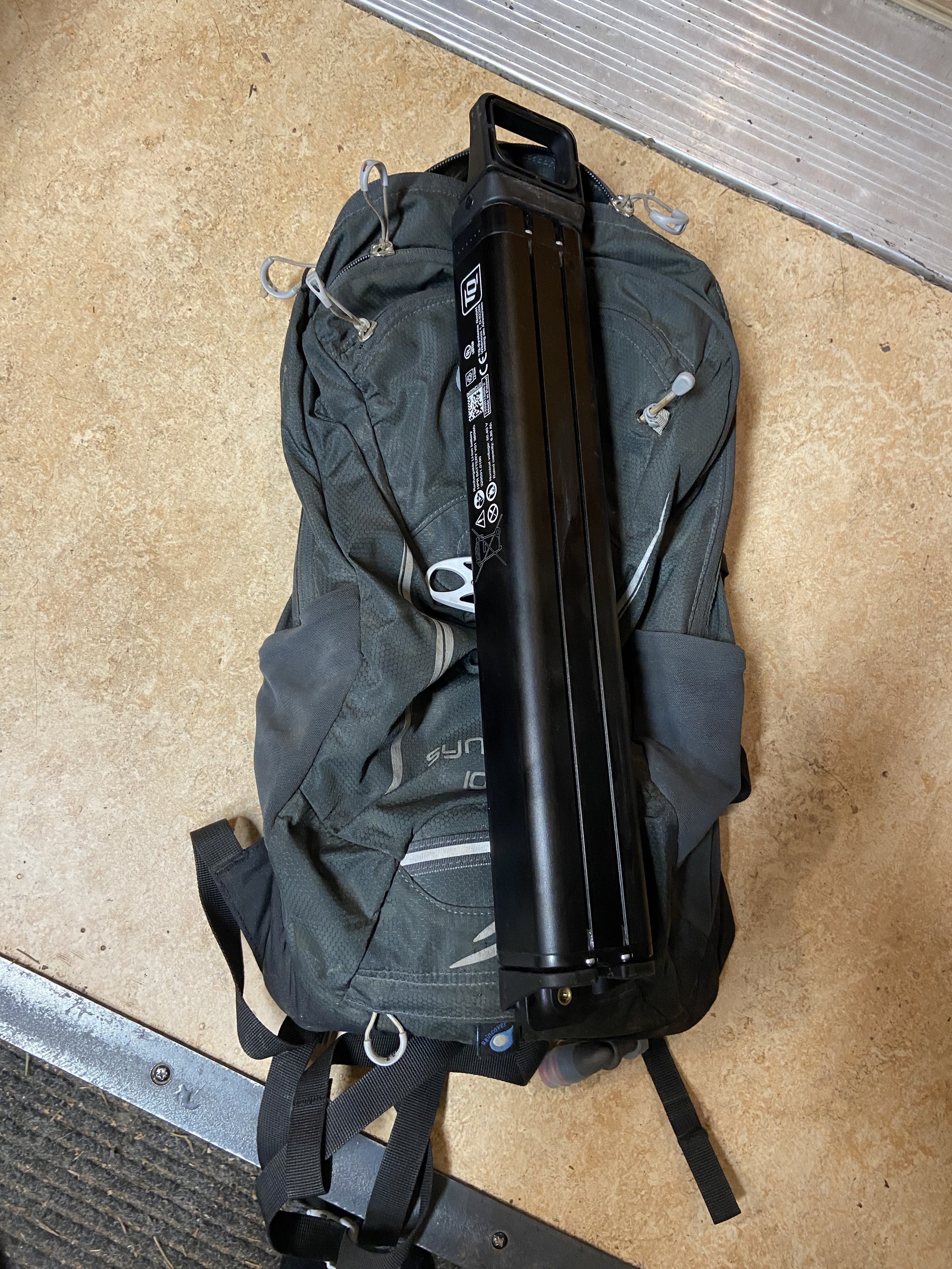

I got fed up of waiting for the range extender to become available, so I bought myself another 360wh internal battery. I'll carry it in my bag on extra long rides and swap over when the previous battery hits 10%. So with two 360wh batteries I should be good for 4000 feet over 40 miles in 100% max mode, or twice that distance/height when being extra frugal.
I'll still probably get the range extender when it becomes properly available, and then either sell the spare 360wh battery or just keep it for mega long rides.

So if you ride with a backpack it does not make sense to buy the range extender - IMHO
I suspect it will become a bit of a pain to swap the main battery over when is empty, vs just carry on riding with the range extender - its only 2 bolts though . But yes I think for a lot of people just getting another internal battery will be a better option than the range extender, especially because it give you another 360wh versus just 160wh with the range extender. so total of 720wh should be all the range anyone could ever need.
The main advantage of the range extender (for me anyway) is that fact that it can be used on its own without the main battery, and is small enough to take on a plane, that opens up the possibility of taking my ebike when I go to places like southern spain, madeira,finale, where its mostly uplifted, but does have the odd bit of pedalling. But its still not available, so I currently class it as vapour ware.

Got the battery from je James ,and the end caps/ handle from AJ cycles. All in the uk
Forgot to say you also need some mounting bolts to fix the end caps to the battery,and handle to end caps,but I didn't need to buy these as I already had some that fitted.

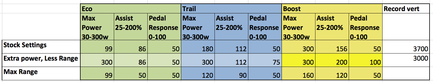

That's what I did too. Extra battery all the way. the extender doesn't have that much extra juice either, making the battery a lot more attractive.
It certainly seems that way, much better Wh/$ value and availability sooner. I was 100% in, but I have read a few horror stories about injuries where people fell on their backs with batteries in their packs. That's why I was experimenting with strapping the battery to my downtube, even though it easily fits in a small back pack. This Osprey raptor 10 shown with the battery is the smallest hydration pack I've owned.
So for my use.... under 3500' vert, stock bike in mostly Eco works.
<4500', I'm experimenting with these "max range" settings which basically brackets the 3 assist modes between/below stock eco/trail modes. These may still be too thirsty. My thought being if I can get 4500' in detuned Eco/limp mode, I'd rather do that then carry the 2nd battery for local rides on blk/dbl-black trails where I don't want to risk falling on a battery.
>4500', for some local "stacked loop" rides I can stash #2 battery. But most >4500' rides I'll attempt will be higher elevation backcountry rides, which aren't so technical so I don't mind carrying the battery & a water filter, and taking fewer risks.

I went for a ride today with two batteries , having an enormous amount of wh available does change the ride , due to the fact that you don't need to be keeping it in eco as much as possible to get the range means that you can just use mid or max modes most of the time, average speed is higher,more like a full fat ride.
It was good,nice to not be watching the watts all the time.

What about strapping it to the top tube? One won't need to read the display since remaining power is no longer an issue?

I am still waiting for my bike to get delivered, but the settings I was thinking of were:
Eco: 50% max 75 Watt
Tour: 100% max 150 Watt
Boost: 200% max 300 Watt
Can you tell a little on changes on pedal response how this impacts on pedalling?

Expect to have fun experimenting! The 3rd screen option, which shows rider output (Watts) vs motor output is really helpful. I have experimented with more assist/lower max wattage and vice-versa, and not really noticed a difference assuming the settings are balanced against each other (I use projected range to figure balance out).
What does make a difference- is motor output (in Wattage) and how it affects range. Let's say you set it up for only 10% assist max but full 300W, and then proceed to pedal your brains out. The motor will put out 300W and your range is greatly reduced. I'm still experimenting but my hunch is that capping wattage at 100 or below is the trick to increase range over stock settings. On one recent ride, I saw I was definitely going to kill the battery, so I reduced the eco settings to "limp mode" and was able to get a good bit more range and it was still a whole lot less work than a meat bike. I'm just adjusting the settings most every ride to get either range or power depending on my route. If I'm doing under 2500' then I can leave it in trail mode at 200w and that works awesome. Otherwise I'd rather tune all the modes down, rather than stay in Eco all day.
Pedal response, the one thing I've noticed is that as it's increased, there is more of the jittery grinding sensation some people have complained about. I mostly keep it in the middle, to keep the natural feel.
