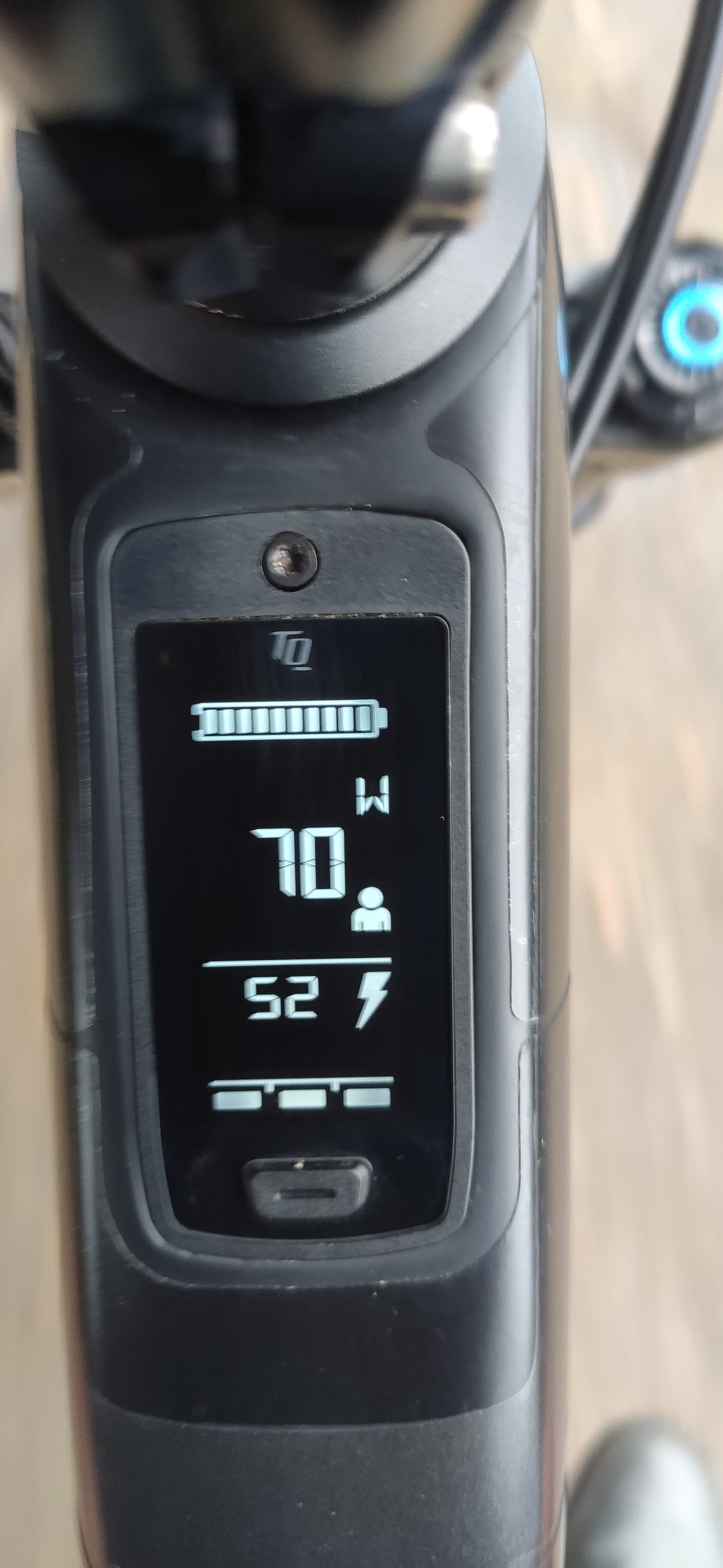

How do I get Cadence to display on the bike?
I saw that I should be able to configure the information that is displayed In the various Menus on the bike.
the setup menu comes up by pushing the ‘on’ button on the display and the ‘down’ button on the handle bar remote concurrently but I can’t figure out how to change anything beyond the mile vs km or the beep vs non-beep settings.
Has anyone successfully changed it?
Mteam
Aug 3, 2020
1,920
1,855
gone
I can't change mine either. the tq phone app (as opposed to the trek central app) has options for configuring the different screens,but it doesn't change anything on the fuel exe- maybe it only works on other tq bikes?
BBFII
Nov 4, 2020
14
12
Madison Wisconsin
For now, this has to be done by your bike shop with the service tool.
The bike is always broadcasting ANT+ data to be read by a cycling computer.
-Cadence
-Power
-Speed
-Battery level
-Etc.

My Garmin 530 has been invaluable for its Trailforks info and things like cadence. I tend to leave the TQ display to the wattages.
I keep mine on wattage also. That is the most useful display. I don’t really look at range or battery details much. Cadence would be more useful to me as the motor is quite cadence sensitive.
Cell4soul
Jul 11, 2022
518
1,327
Mesa, AZ
I also keep mine on wattage. I have my Garmin 830 on my stem cap. I ride with a screen that has the following data fields:
Assist Level
Battery percent remaining
Riding Gear (AXS drivetrain)
Gear Battery level (AXS)
I think my data screens on my 830 and the TQ display showing watt output gives me all the info I need.
